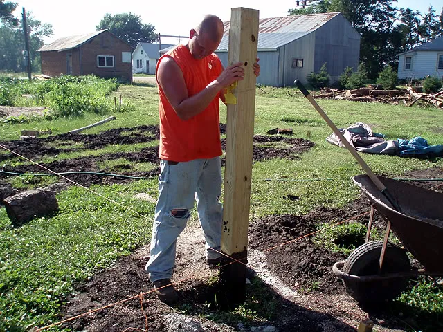

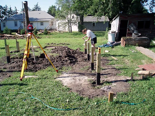

Drilled the holes for the piers last weekend, and started setting the posts last week.
I did 12" diameter holes 4' deep, and then poured a concrete footing in each hole.
I set 8' posts and then cut them down.  The laser level came in handy again.  ;D

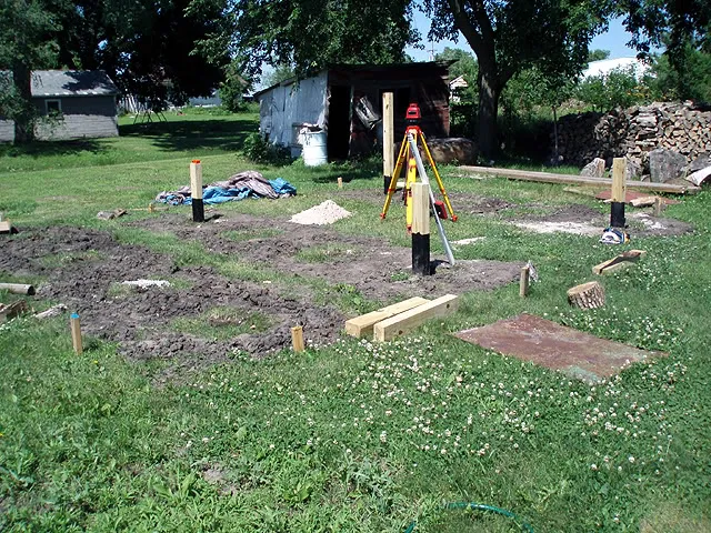

Got the rest of the posts set today, and all cut to height.

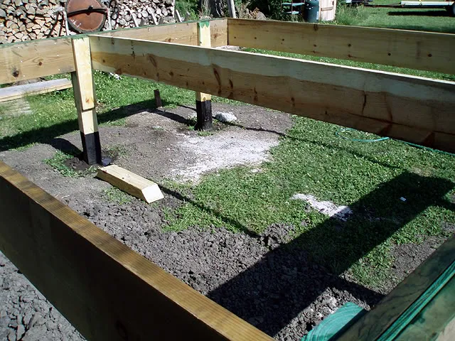

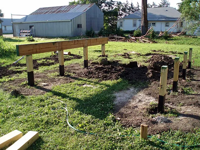

Set the first beam, should get the other one set tomorrow.  Then spend the rest of the week working on the pier and beam bracing.

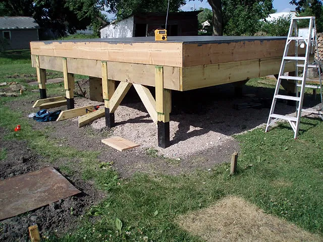

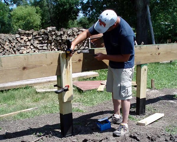

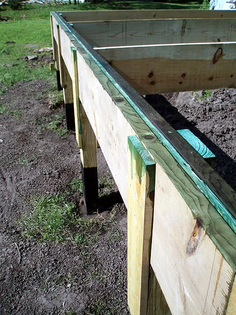

Got almost a full day of work in today.  Both beams are set and braced.  Also got started on cutting the 4x6 braces for the piers.
I didn't want to use Simpson brackets for the pier to beam connection.  I decided to sandwich the beam with a 1x6 on the outside and a 2x6 on the inside... seems beefy enough to me.
I dug the hole the other day for the water and septic lines.  Figured it would be a lot easier to build the enclosure for them before the floor is on.  What size pipe do I need to put in for the septic?

Chapter 30 has the words to the "I hate plumbing" song. It depends on fixture units but a 3" ought to get it.
I'd say your tie is better than a simpson.
One other way to brace this would be a treated 2x between posts horizontally and treated ply wrapping the skirt area. It would take cripple studs from the beam to the 2x to keep the ply from buckling under lateral load but this would be a superior form of bracing, basically shear walls wrapping the posts. If the ply breaks halfway up on the beam it would allow the wall sheathing to tie down onto the beam as well.
This is stand alone? I don't see the other piers.
I type slow, I see Scott answered.

The shear wall idea sounds like a great way to combine the bracing and skirting.  I all ready bought and started chopping up the 4x6's for the bracing so I'm committed to that route now.
Yes the 12x16 is separate from the 16x28.  I'm trying to build this thing cheap and fast, not really the kind of quality I want attached to the main house.  After we move into the larger house the 12x16 will become a shop/hobby building.

The joists are going to sit on top of the beam, with hurricane clips to hold them down.  The 2x12's that I have in now are just to brace the beam, and give me some place to attach the 4x6 braces for the piers.   From the pics I have now, I know it looks like they are the floor joists.  ::)
You can use joist hangers and attach the joists to the beam if you want. Might not work with your required flood elevation though.

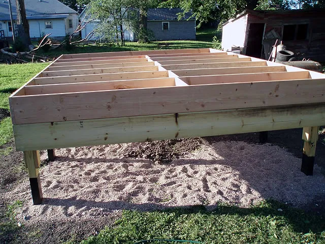

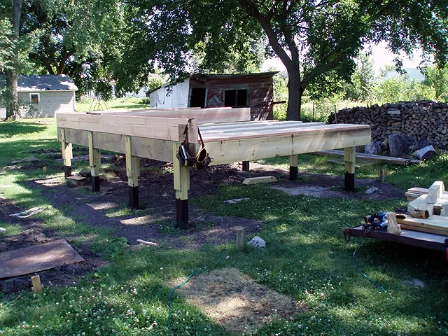

Got the floor joists done today.
After doing nothing but concrete work on the other house I'm thrilled to be working with wood now.  Framing is actually fun!  ;D
I'm using 2x12's at 24" OC.
I left one joist out to give me room to work on the plumbing enclosure.  I had to get creative a couple of time trying to hold things in place since I was working by myself.

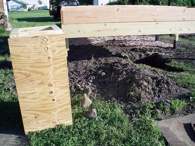

Here is the lower part of the plumbing enclosure.  Going to drop it into the hole tomorrow and get the plumbing stubbed out until I rent a trencher later to run the rest of the lines.
Also got the rest of the 4x6 pier braces cut, going to get them installed tomorrow along with the subfloor.

Laid the subfloor the other day.  I went with the cheap OSB and painted it.  Just hope I don't have too much trouble with it de-laminating.

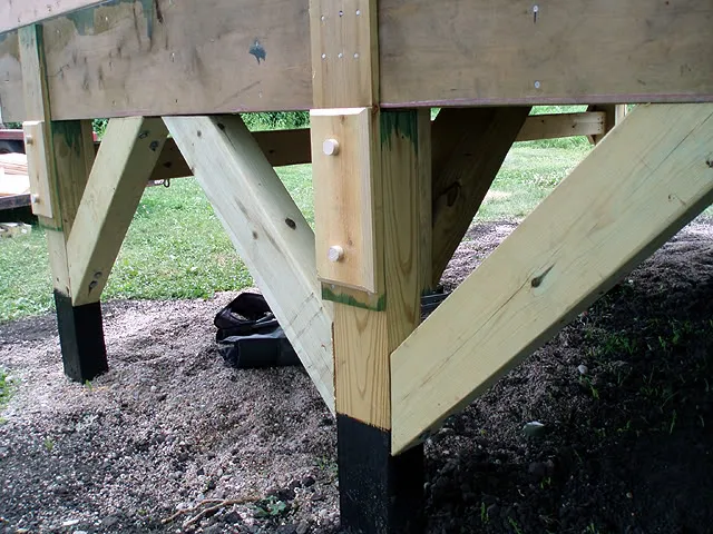

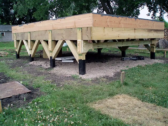

I finished up almost all the pier bracing today.  All the north-south bracing is in, just have to add three more east-west braces.

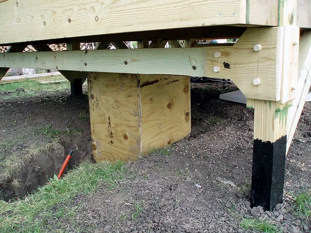

A close up of the bracing.
Here is the lower part of the plumbing enclosure.  I'm going to make the top half easy to remove incase I need to work on it down the road.

Interesting bracing.  What are the fasteners on the corner bracing?  They look like wood pegs.  And how are you attaching the diagonal bracing?
Just curious, because I haven't designed my bracing system yet.
Beavers
Quote from: poppy on July 03, 2009, 07:43:16 PM
All the bracing is PT 2x6's.  I attached it with 3/8's lag screws... still have to add the plywood gusset's on the back side.  I countersunk the ones on the end braces and glued in a piece of 1" dowel.  I thought the timber frame look, was better than a bunch of lag srew heads sticking out everywhere.  The angle bracing thats heads back up under the house is sanwiched between two 2x12's that also brace the beam...I'll see if I can get a better pic of it.

Thanx for showing such detailed pics of the bracing Beavers,  I had an idea of how to do it but yours looks so nice, I like the timber frame look with the wood pegs, very crafty [cool].
Is there any reason why you brought the beams out the whole 12' as opposed to say 10' with a overhang like a lot of people here do?  Just curious, because I kinda want to do like you, but most people here do it the other way...     Thanx Helen
Beavers
Thanks for the compliment Helen.  ;D
I've read on this website a few times that it is better to have your walls sitting directly over the piers.
I'm in tornado country too, and I want to be able to tie everything together good, to get as much uplift resistance as I can.  When I sheet the walls I'm going to run the sheeting all the down to the tops of the posts.
I'm not sure how much strength this actually adds compared to having a 10' width with a overhang.

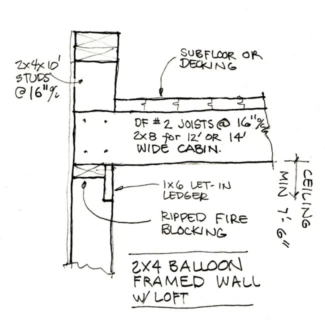

Here is what I think will work for a detail of a 2x4 balloon framed wall for a 12' and 14' wide Little House cabin. Any additional suggestions?
