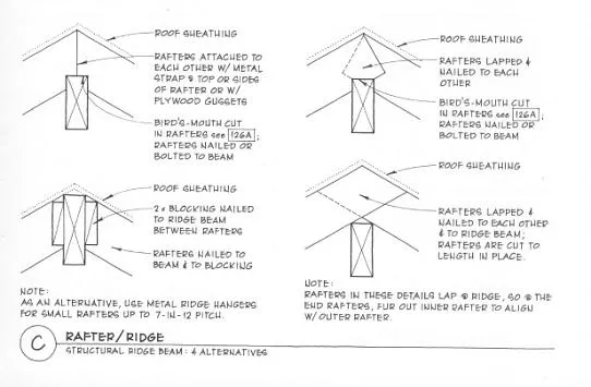

I guess I thought that with a ridge beam the rafters had to sit on top of the beam.  The double birdsmouth thing is one of the things that has been tripping me up.  On the dormer the ridge beam is only 3" so I notched the top of the rafter 1 1/2" and then made a 3 1/2" notch on the bottom...doesn't fit.  To make it fit I end up with the birdsmouth inside the top plate.  Thanks for the link to your calculator I'll check it out.
Face hanging the rafters sounds like it would solve a lot of the confusion I've had.  Have to go that route on the bigger house.  [cool]
I doubt that load is causing the post to bow, not to mention the load right now is diddly. Posts are usually made from core wood and there are bands of fibers within that juvenile wood that often shrink lengthwise. If there is a band of duller than normal looking grain on the concave face then as it shrank lengthwise it pulled the post into a bow, just like stringing a longbow. Happens less on 6x6's than 4x's but can happen on any stick of wood.
This is a scan from "Graphic Guide to Frame Construction", John has it on the book page and it is worth putting on the bookshelf. Instead of the "frieze blocked" face mount option I've used hangers or framing angles and straps over the top for that detail. In heavy timber it goes to through bolts, I've never been there but it goes to split rings and bolts at heavier loads in heavy timber.
