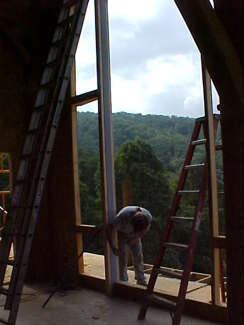

You had asked a couple of days ago what I meant when I mentioned a horizontal beam to help reinforce the tall gable wall. We've asked a few homeowners if we could build them a plant shelf on the gable wall ;) This helps to stiffen a tall wall. see if this pic makes sense;
Thanks Don, makes perfect sense now... a picture really is worth a thousand words!  [cool]

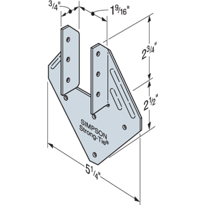

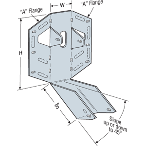

I like the old school hurricain ties too.  I've got more time than money, so ripping some 2x4's sounds a lot better than giving more of my cash to Simpson!  ;D

Great plant-shelf wall stiffener! A tall gable wall may face the view and be made mostly of windows - This is especially true of vacation homes from the 1970's. In a storm those window walls can flex and drum in a pretty frightening way.
Your horizontal beam could stabilize that wall and serve as an indirect lighting trough, bookshelf or any number of uses. Cuts way down on the flexing too! :D
