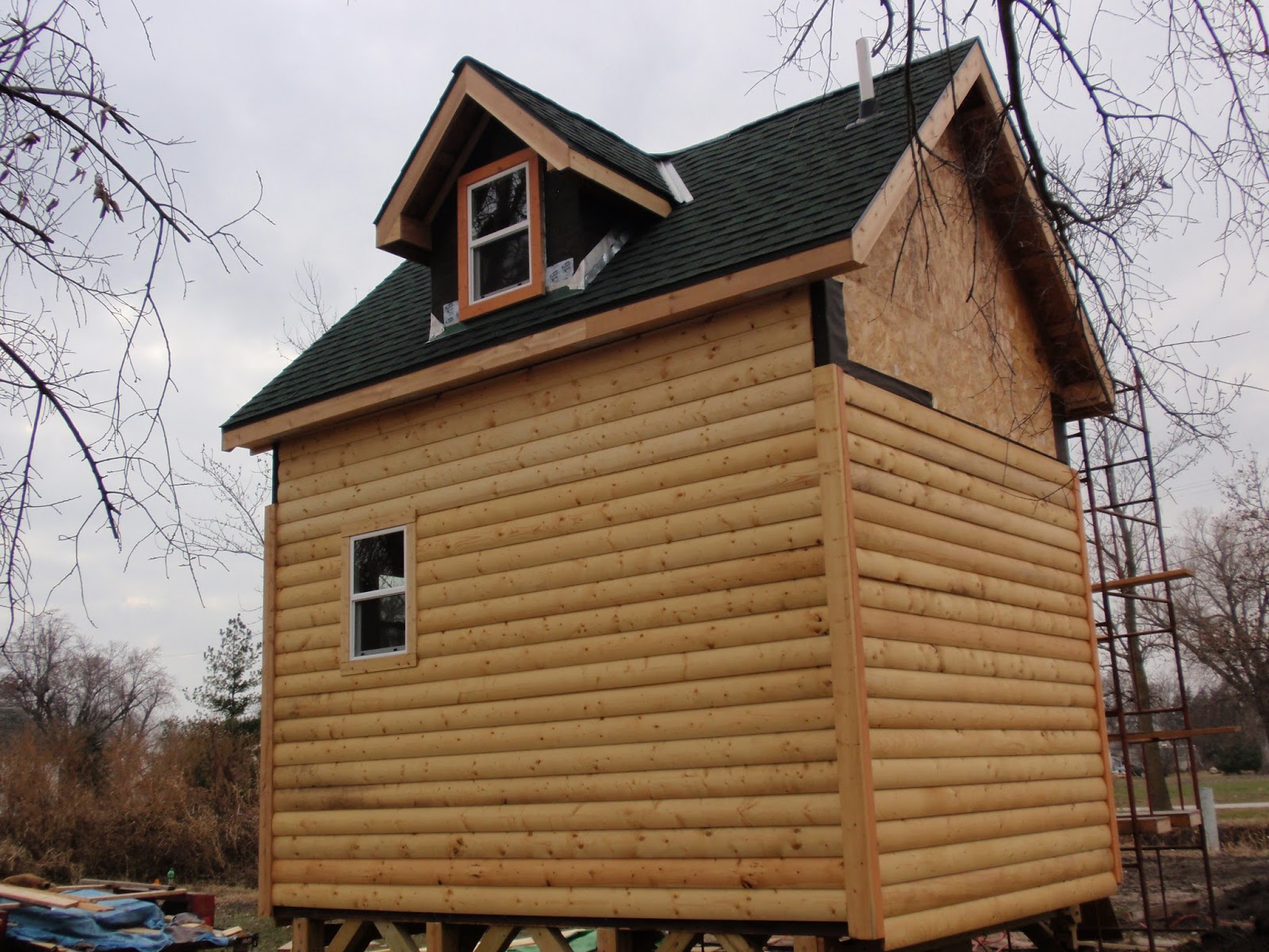

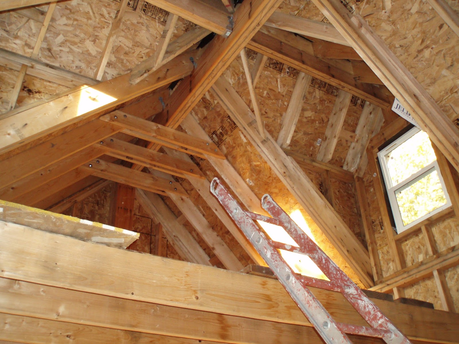

« Reply #125 on: December 08, 2017, 09:36:57 AM »
Offline Beavers
  • Senior Member
  • Posts: 388
  • Location: Nebraska
    • 12x16 House Project
Re: 12 x 16 House
« Reply #126 on: December 08, 2017, 09:42:38 AM »

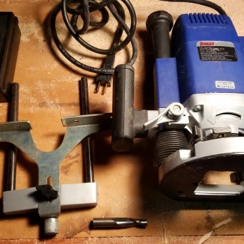

Started working on the 2x6 tongue and groove flooring for the loft extension.  Last time I bought T&G flooring from Menards it was pretty expensive and the quality wasn't very good.  I decided to get construction grade 2x6's and mill them myself.  It will be a fraction of the cost and can't look any worse than the over priced crap I got from Menards before.  ;D
Spent a couple of hours running everything through the jointer.
I think it cleaned up pretty good and after sanding should be even better.
Created a mountain of shavings ;D
I started working on figuring out how to cut the T&G.  Using the table saw to cut the tongue was pretty time consuming.  I'm not sure how I'm going to do it yet.  I have a router but no table.  I was also thinking of just cutting the shoulders on the table saw and then using a hand plane or chisel to remove the waste.  Anyone have any tips for me ???

If the router came with a fence that would work, but I'm guessing not. You can drill a couple of holes through the router base and make a wood fence that rides on the edge of the board, the outer edge of the tongue. A board with a cutout in the bit area and then screw the fence in place for whatever the cut width is. Align the holes and fence in a comfortable working position cause you will have hours of work to do. You may need to do it in several steps of either depth or width to spare the motor depending on the router power. Buy new bits, cheaper than a smoked router. For the groove a wing cutter and fence will work, again it may take multiple passes which means a lot of board handling. You may need to rip the tongue edge with the groove edge against the tablesaw fence to make sure your widths are identical after the jointing operation.

The router is pretty good sized and does have a fence. Also have a 1/2 straight bit. I never used it for much other cutting openings for the windows in the sheeting. Looks like it's time for some YouTube router education .

Good deal, and its a plunge. You can set the first depth stop at 1/4" and the second at 1/2" depth and probably do it in 2 passes per side. I would run down the board climb cutting, letting it pull you along, then come back in the "correct" direction against the rotation, drop to 1/2" depth and repeat. By climb cutting it will reduce tearout, just don't let it get away from you. There is a tradeoff, a larger diameter cutter has less tearout but requires more power and more control. Dull tooling is more apt to tearout, burn and get away from you and takes much more power. A diamond stone on the flat faces can sharpen minor dullness, never hone the narrow edge only the flat face. With any edge tool look down the cutting edge in strong light. A cutting edge has no dimension and splits the light. If you see a white line reflecting back at you from the cutting edge, that is a flat land, dullness.
There are also matched T&G router bit sets available. I would do that in two fence depth settings.
With either take the time to set up a full length workstation like a 2x10 across 4 horses with a fence screwed to it away from you to stop the "off side" of the floorboards to keep them from sliding as you push the router and fence against the board.
Hearing protection...huh whatcha say? Routers are screamers.
A router is probably the most versatile tool in the shop, I have 4 or 5 worn out ones and 3 live ones down there. One careless homeowner burned up 2 of those in a week, I can get years out of one, take multiple passes if the machine is bogging.
