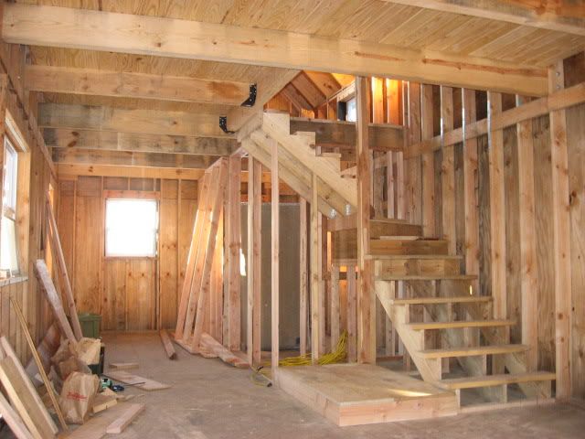

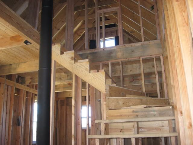

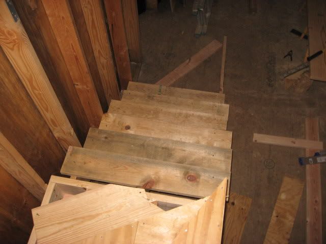

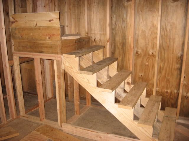

Got a little slowed down by the holiday's but back at it now.   I've started on the stairs.  Got the first set of stringers hung up to the landing and I finished the winders today.  I've got temporary 2x's screwed down for the treads.
I have a question about tread width.  The lower stringers are cut  7 9/16 riser height and 10 inch tread. Up top, the rise is working out perfectly but the run for the upper stringers is about an inch and a half too long.  Should I let the top tread (last step before reaching the loft floor) be a little wider than the others or give an extra 3/8th's to each tread.  I would think the latter but I thought that maybe it might be nice to have a wider step for the first one down.  Any opinions?

In regards to your stair...I don't recall if you need to follow any codes or your structure will be inspected....but the on your winders...the narrowest point of the winder cannot be less than six inches...it looks as if yours goes down to a point.  I believe the reason for that is so an individual who steps on it (in low light perhaps) always will land on soild footing.  It was a problem I had to fix with mine.  My structure had to be inspected however.
Hope this makes sense....I will look for a diagram.
...ok...I found a pdf file that explains things.  Look on pages 5 & 6.
http://www.stairways.org/pdf/2003%20Stair%20IRC%20SCREEN.pdf

John- thanks for the info on the stairs.  Luckily I don't have any inspector to contend with and while I understand the reason of not bringing the stairs to a point, I've finished mine and I'm very comfortable with them.  The natural path takes you comfortably and safely down the middle of the treads where there is adequate width to support each step.  Sometime in the future, perhaps at 2 AM, I may feel differently, but right now I'm happy!  :D

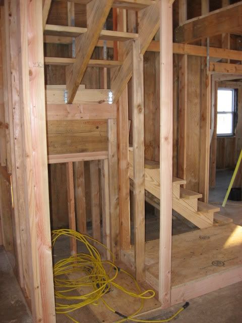

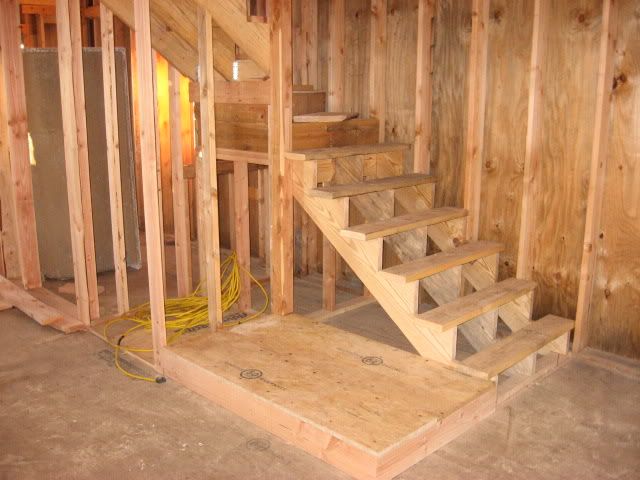

I completed the stairs today, framed in the closet underneath the stairs and framed the platform that will support the woodstove.
I'm quite pleased with the outcome!

Your stairs look good to me.
Is that a cedar post in the corner?  Whatever it is, it looks pretty good.  What kind of railing are you going to use?

Poppy- Good eyes! That is a cedar post.  I just set it in place to see if it would work and I think it's a keeper.  I haven't finalized plans for the railing yet.

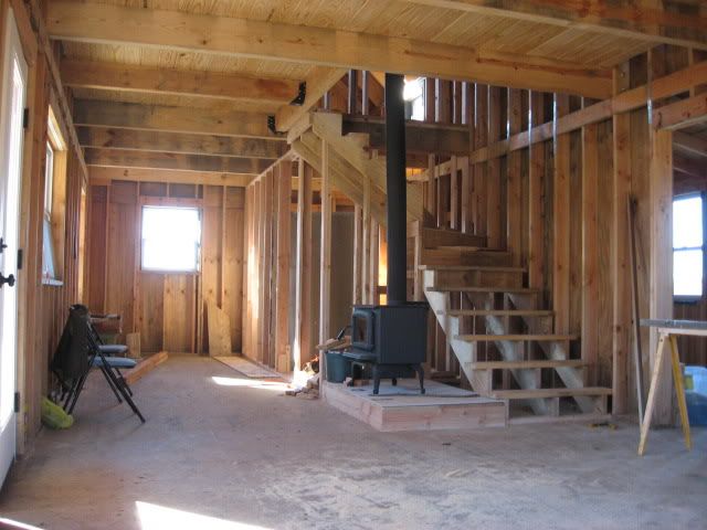

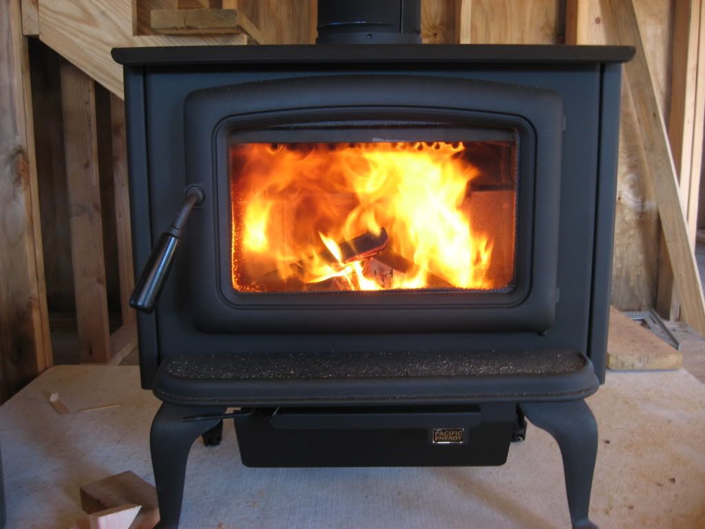

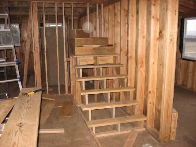

I got the woodstove installed just in time for the severe cold snap to end!  Still, even when it's in the 40's it's nice to have something to warm you hands by.
I've temporarily installed it on top of the platform which has a 1/2 inch sheet of hardibacker board.  I still haven't decided how to treat the area surrounding the stove but the heat shields on the sides and back keep excessive radiating heat from making the wood on the stairs too hot.

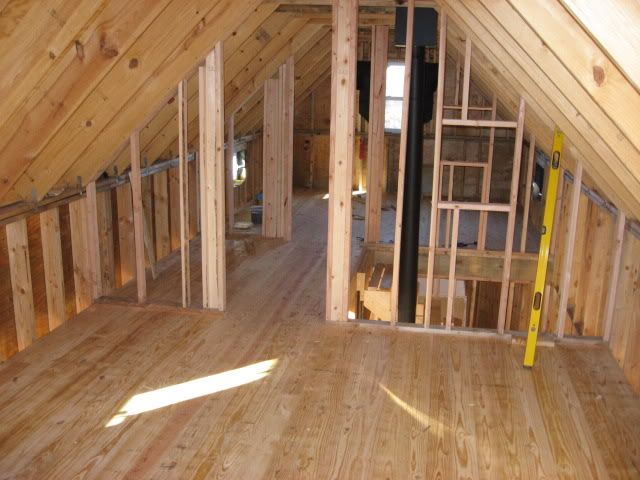

I'm almost done with the framing upstairs.
You'll note the excessive use of wood on the second wall from the camera on the left.  I wasn't sure what door I would use so I framed for one that I didn't end up using.  I added a T for the future closet wall then ended up moving it all forward.  I just left it instead of pulling it out so now I have about $15 of extra studs where they don't need to be.  Nothing like framing on the fly!

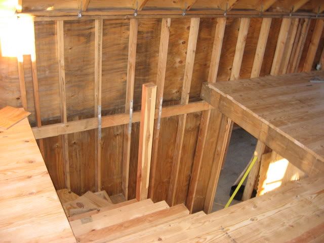

A shot of the stairs

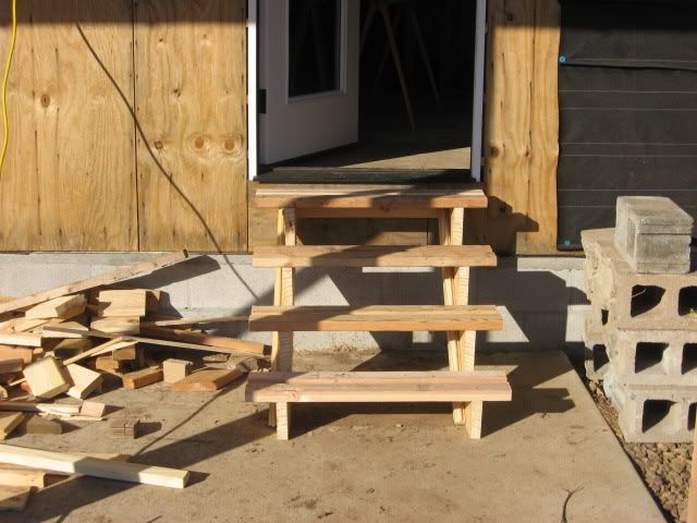

I feel so confident with stairs now that I decided to add a temporary set to the front door.  The concrete blocks that I was using have come close to injurying me several times and my wife's Grandmother wasn't able to come inside because of the instability.  Something had to be done.
These feel much safer!

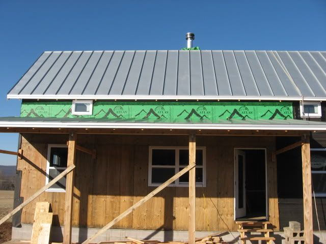

The roofers have finally started!  We've been battling the ice and snow but now that it's melted they can safely get on the roof.
I'm really pleased with the strong lines of the standing seam.

that woodstove looks fantastic.
