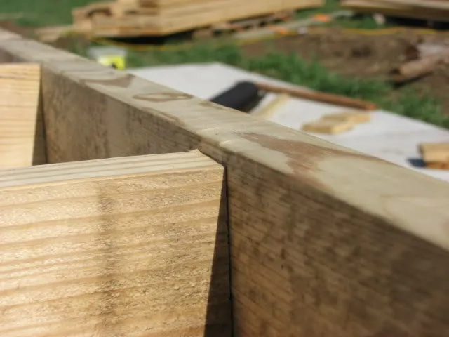

I started framing the floor today.  It's gone well for the most part but I'm having some trouble I need help with.
Last week the sill plates were reasonably level within acceptable tolerances but we had some heavy rains that caused some of them to cup and warp badly.  Now when I placed my band/ header joist it's not sitting flush because of the cupping and general warping of the plates. I picked the best straightest lumber I had in the pile so I don't think it's bowing that's causing the problem. I haven't been able to make it sit flush with toenailing or even standing on it (I'm not sure how that would work anyway as I'm working alone and don't think I could nail while standing on the joist)
In several spots there's a gap from 1/16th up to close to 1/4 inch between the sill and band joist.
I'm guessing it will settle over time but in the mean time it's making the band and the floor joists not sit level.  Some of them are either lower or higher in relation to the band.
For the ones that are higher, do I lift them flush with the band and end nail them and expect them to settle over time so that they will bear on the sill plate?  Or do I shim them?
  For the joists that sit higher than the band (only a few do this due to asymetrical cupping of the sill) do I chisel out the difference in the sill plate so that they sit flush with the band?
None of the joists are nailed in yet since I wanted to wail until I figured out the best way to proceed.
Thanks!

Don't take this wrong.
Repeat after me:   "I am not building furniture".
A quarter inch proud might be a bit of an issue, but how many of those do you have?
If the deflection is only near the rimjoists, the amount of deflection reduces quickly as you move away from the joist.
I would shim the ones that are not in contact with the sill plate, and ignore the high ones (okay, it might be hard to ignore 1/4").  Once you get your deck down you'll never notice them again.  After the whole thing is loaded down, and it dries out and stabilizes, you'll be fine.
You could chisel the sill out for the high ones, but guess what... as the moisture changes, the amount of cupping will too.

   Shim the low, and undercut the high floor joists so they are all level . . . Otherwise you will have "high" spots when erecting the walls.  This will transfer all the way up through the roof.
I had a place where there was a gap between the rim joist and one of the 2 floor beams. It was because the floor beam was a little warped.  As the cabin progressed, walls went up, roof went on, that gap disappeared....probably from all the weight.  It was a gradual thing, and sort of fun to watch the progress.  My floor is still level.  My guess is that the same will happen with your lumber.

Thanks for the replies.  I did buy some shims today and will use them to set everything level and will keep in mind that it doesn't have to be perfect and that some things will resolve as the building progresses.
