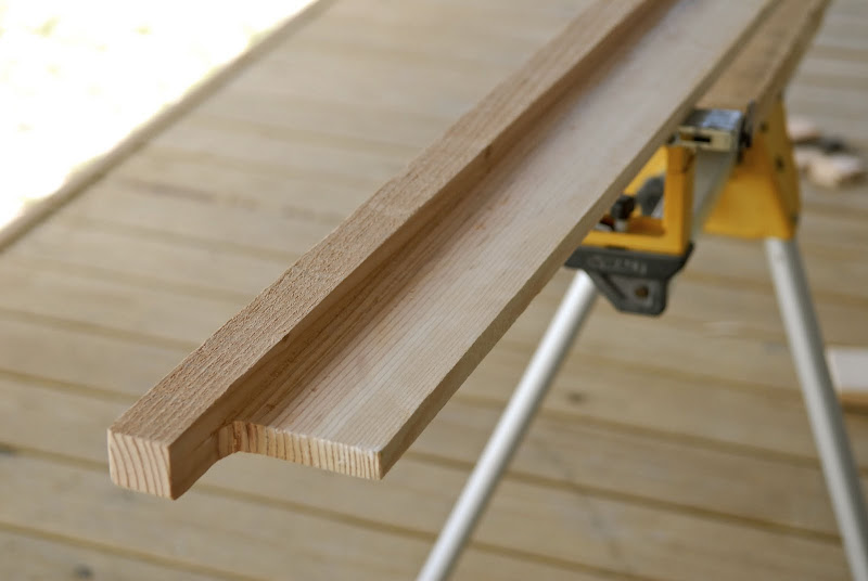

I started building some of the window sills out of rough sawn pine. I had to mill it out some to make it work, which would have been a lot easier if my table saw would cut 3 & 3/4 inches, I had to turn it the other way and rout out the last 3/4 inch a kerf at a time. I suppose there must be a better way to do it.-
A perfect fit!
If anyone has any good ideas as to how to attach the sill as unobtrusively as possible I'm all ears. I was thinking of construction adhesive and finish nails? A friend suggested screwing and then plugging the holes but I'm not a big fan of that, plus I only have 3/4 inch material to work with so I'm not sure that's a possibility anyway.

It's too late now but if you had fixed the sills before the drywall you could have hidden the fixings with the drywall. (I hope that makes sense!)

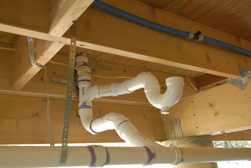

Some pictures of the dirty work under the house-
possible future toilet-
Shower drain and vent, I'm not quite done with this part because I have to fix the wall above that I messed up-
It took some time and head scratching to get this shower drain connection to come out right and I had a premature celebration in my mind about the ice cold beer I was about to enjoy as I was glueing the last piece. As I was surveying my work I was nearly brought to tears when I realized I put the sanitary tee (the last piece) on upside down!  d* Couldn't figure out how to fix it so I hacked the whole works out in disgust and resolved to try again the next day.
A consolatory beer doesn't go down nearly as smooth as one drunk in victory. As with other trades I have attempted to tackle, I have a newfound respect for plumbers.
The offending piece-
