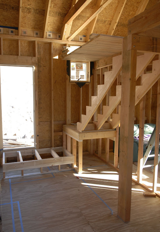

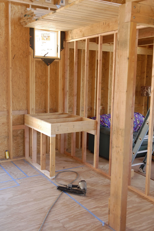

I got the loft stairs done, or roughed in at least.
There are 2 landings on these stairs, I started with this one-
Lots of math, and checking my measurements twice I still managed to screw it up. I had to disassemble it and rip the 2 by 8's on top into 2 by 6's.  d* Glad I used screws!
All fixed and top stringers installed. Also got the second landing height figured out and in place-
They didn't turn out perfect but close enough, all treads should be within about 1/8 in. of each other and everything is reasonably level. Lots of different things to factor and 1000 ways you can mess up, I picked a few of them.
Mini stringers complete and temporary treads in place-
Funny how something like stairs, taken for granted by most everyone can be such a big deal when you are trying to put together something like this. "I can actually walk up to my loft!"   ;D Baby steps I guess.
I moved the wood stove in in anticipation of the chimney pipe arriving. Half the order came and the other had to be shipped from somewhere else. Another big step!
It's gratifying to see floor plans, previously only seen on flat paper or imagined in your mind begin to transform into 3 dimensions.  8)
Dug you had me worried for a minute when I saw your first picture showing the flooring laid in the loft over the stairway but I figured that you were laying it and later would cut it flush with the stairway wall.  If you don't have codes to contend with you can improvise to make it work out for you.  Thats the way it should be but some think different.  Making progress is the fun part. Enjoy.

Looks good.  Stairs can be a head scratcher.  d*

i am with ya on using screws.  SO nice to not have to hammer that apart when you screw up.  I like the stairs and the landing ...gives it a lot of dimensions to interest the eye..
nice job

I used screws on the landing I assembled but was careful to make sure that none of them were carrying any weight. All joists are blocked, and supported by jack studs that extend to the subfloor. In other words I basically built a box using screws, but the box rests on top of "legs".
Am I still relying on the shear strength of the screws? I'd take a photo to show what I mean but it's still dark out.

dug, your method is good.
Your screws only serve to hold the wood 'legs' in place so the legs take the load. There's virtually no load on those screws.

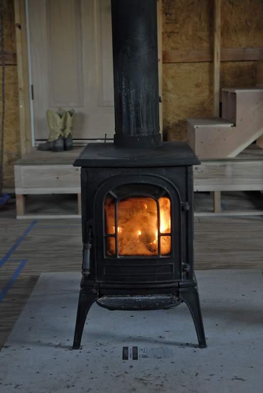

Also managed to get the wood stove installed. I had a hard time making myself cut this hole.-

I'v never lived in a home with a wood stove before and found it totally counter intuitive to light a roaring fire inside. Sure is nice though!  ;D
It is not in it's permanent resting place, which will be a few feet to the left. I am going to build a hearth, hopefully brick, before I move it to it's final destination.
