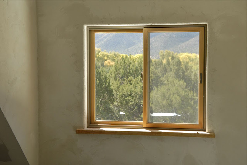

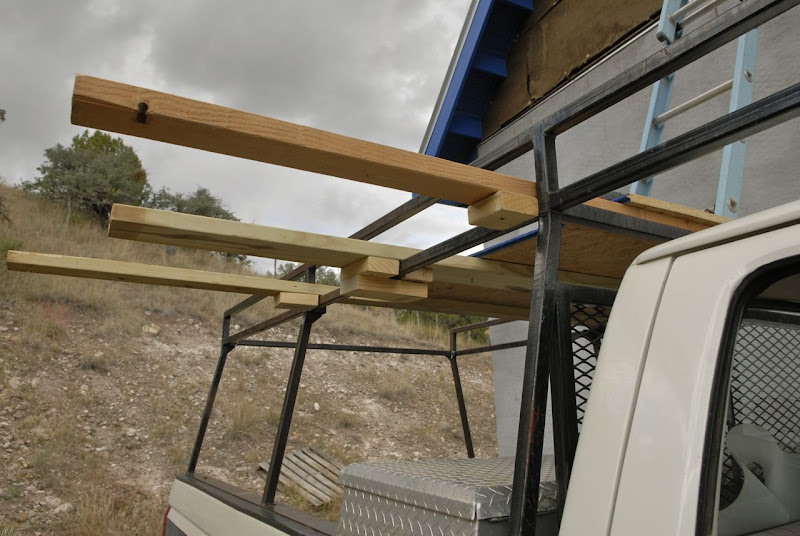

Thankfully I didn't come up with a winner and the window was successfully installed without incident. I borrowed a 24 ft, extension ladder from a friend that reached from the ground but it was a lightweight aluminum one that was so flexible I felt like I was on a carnival ride. Jenny thought I was being a wuss so I told her to get up there and see what she thought and she returned to solid ground in full agreement.
This setup felt really solid and was not as sketchy as it may appear. Everything was well secured and little left to chance.
We were going to put a non operational stained glass window there but after seeing how heat builds up near the ceiling this summer I thought it might be wise to put one in that opens so we could allow it to vent out. I may try to figure out a way to attach (glue?) some stained glass at a later date.

beckhamk
Dug,
On your dbl hung windows did you use screws through the jams?  If so did you end up removing the plastic side panels on the jams to place your screws?
Thanks,
Kyle

dug
QuoteOn your dbl hung windows did you use screws through the jams?  If so did you end up removing the plastic side panels on the jams to place your screws?
Thanks,
Kyle
I just shimmed and put a few finish nails through the wood casing. They are the only windows I have ever installed so take it for what it's worth, but it seemed to work well.
