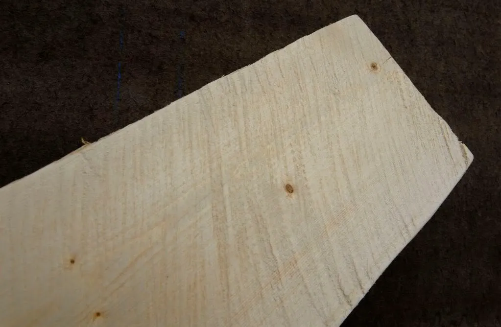

I made a discovery today while "adjusting" a window opening (note to self: a bit large on the opening beats a bit small hands down!) with a sawzall.
I kind of like the look created by dragging the blade, flat across the board. Kind of like rough sawn, if you squint your eyes.
I laid the blade flat like this, and dragged it back and forth-
In a few minutes I had this-
lightly sanded with a little polyurethane sprayed on-
Not exactly authentic but it creates a rustic look very fast. I tried a few other methods and found that by angling the blade one way for a few passes and then the other way, you can create a checkered pattern. I may end up trying it for some interior trim if I can't find what I want around here.

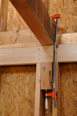

I have been assembling the loft beams. Some of you may have heard, because I posted a question in general forum, but I experienced an unpleasant surprise when I unbundled the beams. I knew they had twisted some, but they were way worse than I thought.
I was a little depressed because I figured it was pretty hopeless to expect to get them any better than just marginal. With a few tips from folks here and several clamps, bottle jacks, hammer, prybar, a decent vocabulary of swear words, and a little faith they actually came out surprisingly well.   ;D
This was the worst one. I enlisted the aid of a bottle jack and I swear that I had to crank it harder than I would if it were under an F350 with a full load of sand! Maybe it was because I had a  short lever though. You can see that my clamp is on the verge of death as well.
I blocked everything real good so the whole wall wouldn't fly apart. I wonder how many pounds of pressure that beam is loaded with? On second thought, maybe I don't want to know.  [shocked]
Can wood explode?
I like clamps-
This was the worst one. I didn't come out perfect, but I'll take it-
Overall I am quite happy with the results. I really blocked it all tight so I am hoping that they will stay pretty close to the same (and the beams don't explode!).

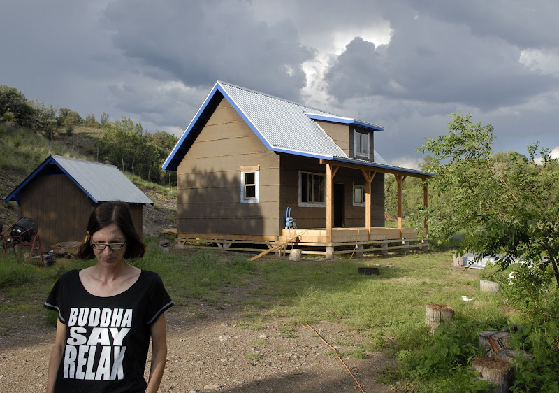

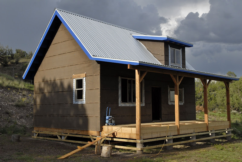

Well it's been awhile. I thought I's better check in, I don't want anyone thinking I gave up on the build and bought a singlewide instead.  ;)
Been doing a little of this and that, trying to get ready for the big stucco job coming up. I've got the porch mostly done except the stairs. The decking will wait until after the stucco.
In this photo you can see the fake lintel beam over the small window. I like it and intend to do the same with the rest, though I think I am going to cut a small angle on them.
I have all the windows installed except the one that will be a bump out, which I have so far successfully procrastinated. It's the one with the custom rain tarp.-
Kids enjoying the view from the loft-
And this one pretty much says it all-
