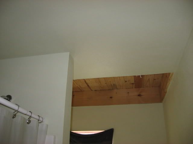

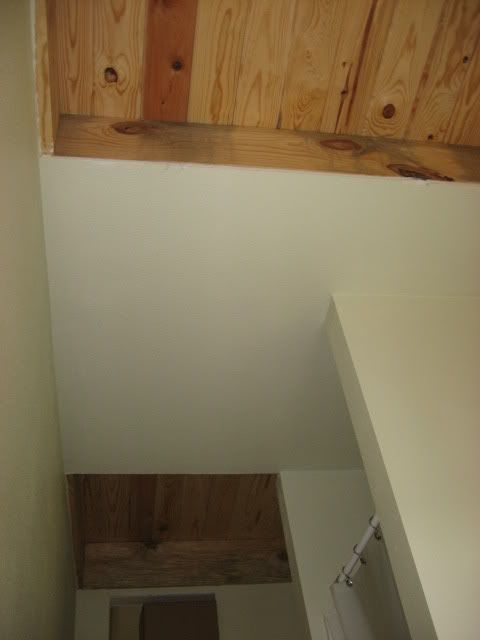

A few more questions, did you leave the t&g exposed in the bathroom, or did you box it in? If exposed is there any "special" varnish required for a high moisture area? How long is the first section of your stair case before it starts winding?
Shawn
Shawn- I closed in one bay in the bathroom because I ran the plumbing vent between the two beams. It's not easy to photograph but from these two pics you should get the idea.  I still need to trim out the transition between the drywall and the beams.
I'm not big on varnish (mostly for the chemical off-gassing) so I've just left the underside of the T&G natural.  So far, so good.  I'm told the wood will darken somewhat over time.  I'm not too worried about the moisture.  The wood will take it up and give it off.  We keep our windows open most of the year and in the winter the wood stove will do a good job of keeping the humidity low.  We've also have the interior windows that vent out to the living space so I think the moisture won't build up too badly.

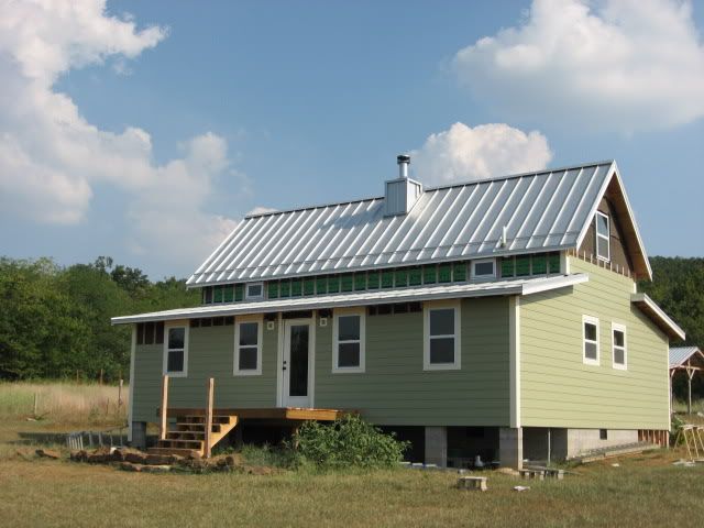

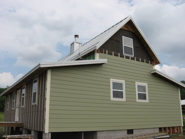

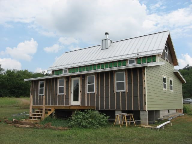

We're back at it again.  My wife and I are near completion on the siding for the west side of the house.  The gabled ends will be filled in with cedar shakes.
We are very pleased with the pre-painted hardie siding.  It's gone up much easier than I thought it would.
We finished the deck off the north side but have yet to add the railings.  Great place to watch sunsets, though!

The house is looking awesome!! And so do the sunsets!

Jdhen,  Thanks for posting the pics! That shows me exactly what I wanted to know. I plan to box in above the tub/shower and leave the rest of the beams and t&g exposed. I'm trying to cut out as many of the V.O.C. producing elements as well. Not always sure on how to do that though  ??? You used turpentine and mineral oil on your floors right? 61" for the first flight of stairs sounds good to me. I'm trying to squeeze in a code compliant stairway in my 14 x 28 plans. The hardie plank siding looks good too. I'm considering that or T1-11 non groove w/ battens.

jdhen, what are the wood slates running vertical under your siding for?
it looks like it would hold the house wrap down good.

Shawn- We used truly boiled linseed oil (organic even!) mixed with turpentine on the pine floors upstairs.  The hardwoods downstairs were treated with the Rubio monocoat, a mix of natural oils and waxes.  We're pleased with the results on both of these.  The linseed oil was more difficult because of the necessary 7 applications!

astidham- the wood furring strips are part of the rainscreen.  It creates a 3/8 in drainage plane between the house and the siding so that any moisture that will inevitably migrate into the space, will be easily removed as water vapor.  The technology got it's start in Norway when builders realized that you could prolong the life of the siding and the building itself by preventing the trapping of moisture.  I understand that it also equalizes the pressure between the outside and inside thus limiting the capillary action of a raindrop.
I first read about it in a Fine Homebuilding magazine and it just made sense to me.  It really didn't add much to the cost.  I had a local mill cut and plane some local cedar furring strips and nailed them up over the studs.  And you're right- the other benefit is that they held the builders felt in place quite well!

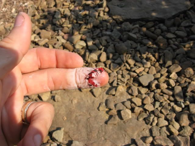

The bad news is that I almost cut my finger off yesterday!  ( I suppose it's good news that I didn't)
After more than a year of building, I finally lost a battle to the worm-drive saw.  It was just a routine siding cut......that went terribly wrong!  The siding began to fall off of the horse after the cut and I tried to grab it but found the saw blade instead. Doh!  d*
  The fiber cement blade mangled the cut pretty bad.  A few hours later the ER doc apologized that he couldn't make it prettier but he didn't have a clean cut to work with.  His main goal was to keep the finger pad sitting flat.
Now, all of a sudden, I can't meet anyone that doesn't have a finger story!   The mailman showed me his half a ring finger.  A guy in Lowes offered to help me load some lumber when he saw me struggling- then showed his battle scars and told me that both of his brother's are missing digits after similar accidents.  I don't feel so stupid anymore!
I was going to take some time off from building but the insurance company has recently informed me that I better get a railing in the deck....or else!  Must press on!

I did similar damage to the same finger, same hand years ago. Instead of a saw it was a glass fiber reinforced hi performance polymer model airplane propeller that nearly sliced the pad off. Good thing it was idling.
Jdhen sorry for the finger.  But an old woodworker once told me that there are two kinds of woodworkers.  Those who have and those who will.  Hope you have a speedy recovery but from past experience I would say it will be a while.  Really awkward trying to work with a hurt finger.
As for the railings I am sure that you can whip up something with one hand. Hey make it temporary with scrap 2X4's for now and plan on doing the finished one later.  It shouldn't fail because of asthetics from his standpoint.
SkagitDrifter
I have been looking forward to your posts enjoying your thread- until now.  That is quite a battle scar, it sort of makes my own finger hurt to look at it.  Sorry that happend to you and I wish you a really speedy recovery.
Your place looks great- get back on that horse and continue the good work (when you feel up to it).
All the best-
Abraham Lincoln
bayview
   OUCH!!!   Sorry about your accident.
  Me - Table saw - other hand - same finger - lost 1/4" off the tip. . .   The tip and the nail did gradually grow back, but have some nerve damage.
  Keep your finger well wrapped with plenty of antibiotic cream.   It will take a good month to heal. . .
  I've learned to take a little extra time when working with power tools.   And to make sure my work is well supported.
  A friend of my dads years ago lost 4 fingers on the left hand with a radial arm saw.  My dad mangled his 4 left fingers in a combine accident about 40 years.   UofMinn sewed them back together.   Was really hi-tech for its time.
  Hope the rest of the build is a little more uneventfull for you . . .

Commiserations on the finger - and welcome to the club. :(
- Left index and middle crushed by anchor chain in 2006 - nerve damage, left index tip 3/4 cut off by rock(!) whilst filling gabions shortly afterward. Last year 11 stitches in palm of right hand from metal roofing ... currently have herniated disc, sciatica from years of misuse...
Perhaps there should be a thread for work related injuries as a warning to others...
P.S. just found many a cautionary tale in this thread ...

Oh - Ow!....Sharing your "lesson" is good for all of us!   :-\
Tom
A little fear is a good thing. Since shaving my leg with my chainsaw several years ago, I've found a healthy respect for it  [chainsaw].
That looks like a sore finger. The joke around here is that if you hurt that particular finger, you're unable to drive  [shocked].
Hope you feel better soon
jdhen
Actually, Tom, when I put the large white dressing on it makes for an even bolder statement  ;D   In fact, when I'm at work I tend to keep it extended so it's out of my way and it's the first thing everyone notices!
