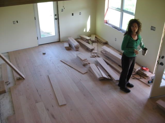

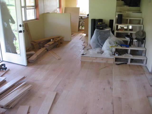

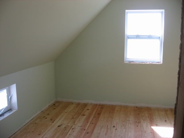

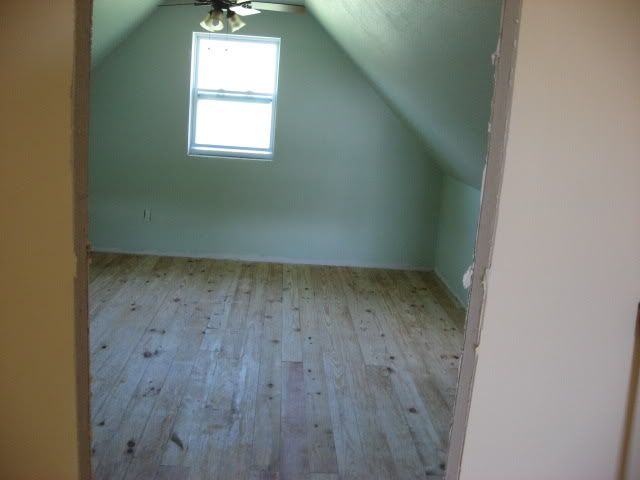

We bought 6 inch wide ozark mountain red oak t&g planks.  $1.60/ sq ft.  Really good price and very good boards!  I'll have more pictures but we were so beat I only took a few.
I'm using a reconditioned manual bostich nailer that I bought on amazon for $50 bucks and it's working great!
While a friend and I layed floors downstairs, my wife sanded the upstairs deck with a belt sander and put the first coat of linseed oil/turpentine down.
Smells a bit like an artist's studio upstairs but that will fade as the turp evaporates.  So far we're very happy with the results.

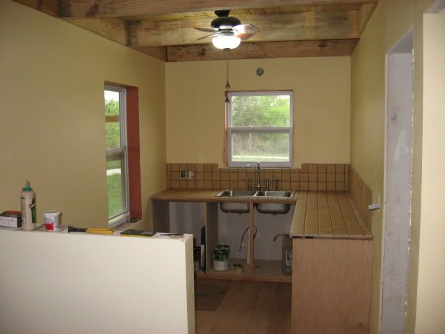

I was all ready to post some pictures of the new floors and tile work.  I took one photo and the camera's batteries gave out!  :(
Here's the kitchen tile.  Will grout on Sunday.  Not perfect tile lines but good enough for us!
Guess I'll have to post more pics after I sand and finish the floors early next week.

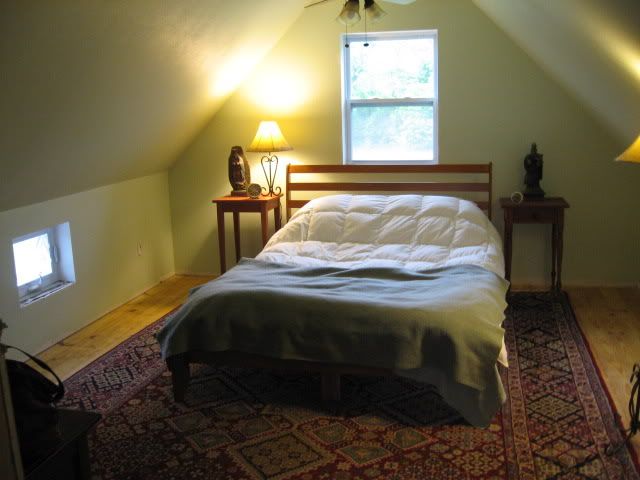

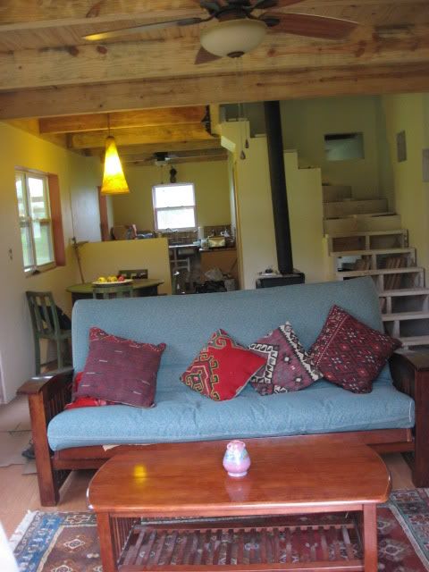

We're in!   :)
It's been a wild past week and a half with tying up various details so that we can live here with some semblance of normal living.  Still have lot's of boxes around and tons of detail work to do but at least we don't have a daily 70 mile round trip or a rent payment anymore  [cool]
Getting ready for siding is next on the list...after we stop and take a few deep breaths!
Jesse
jdhen you are going to be like TexasJim and work yourself out of a job.  Looks real comfortable.  Thanks for posting.
