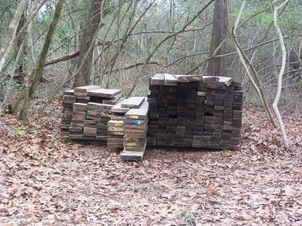

Today I rented a trailer for almost $50. Then loaded a huge pile of pressure treated lumber on it and loaded the bed of my truck with the 2x4s.
Hauled it to the site and unloaded it all, then returned the trailer, then filled my bed up again with the last load of 2x4s.
I found an ad on craigslist for the wood. It was a walkway trellis in a nice townhome complex, about 5 miles away. All total, I bet I drove 200 miles today and moved 4000 pounds of treated wood. I got 32 4x6 posts, probally 10 2x10s, 25 2x6s, and 200 2x4s. Almost all the nails were removed by the seller. Wonderful deal, all of it for $180. So, plus the $50, its $230. Some will need to be cleaned up and all, but most everything I bought is in good condition. I guess 3 years old. Some tags still, wolminzed (sp) above ground contact on the 2x6s, and .4 on the 4x6 posts.
All I need to buy is the ridge boards and rafters and my frame will be ready to go up.
Oh and dont want to forget and tell you, how beat I am!!! LOL, goodnight..I need the icy hot and bed after a long hot shower.
That was a great deal.  You have to take advantage of the deals when they are there.  If passed up they will be gone.  A bit of snap decision making. :)

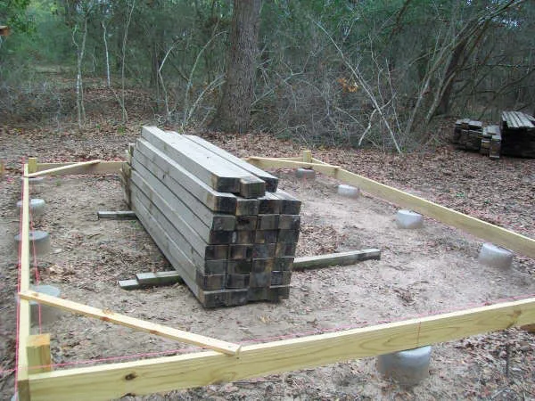

Abbynrml

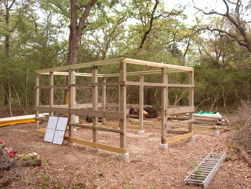

Heres a couple of pics of the wood I got. Got it all stacked and sorted.
Also bought a chainsaw. A McCulloch Timber Bear 610. Not new, probally an early 80's model. So now I hope to down that tree that was hit by lightening.

Got a bit more done this weekend. Cut the limb above the shed site and dropped the tree that needed to come down. Also burned a little, alot more to burn tho.
Got the 3 piers set in place for the porch. There is a 1 1/2 inch drop in the elevation where I plan to slope the 6 foot wide porch floor, to allow rain/water to run off.
After measuring the wood I got I easily have enough to do the porch framing now.

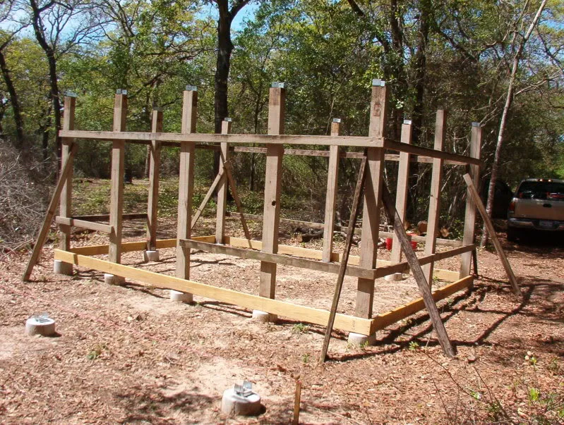

I got a little more done this weekend.
Came back home to clean up and rest, then back again tomorrow.
Need to buy the wood for the top plates and ridge.

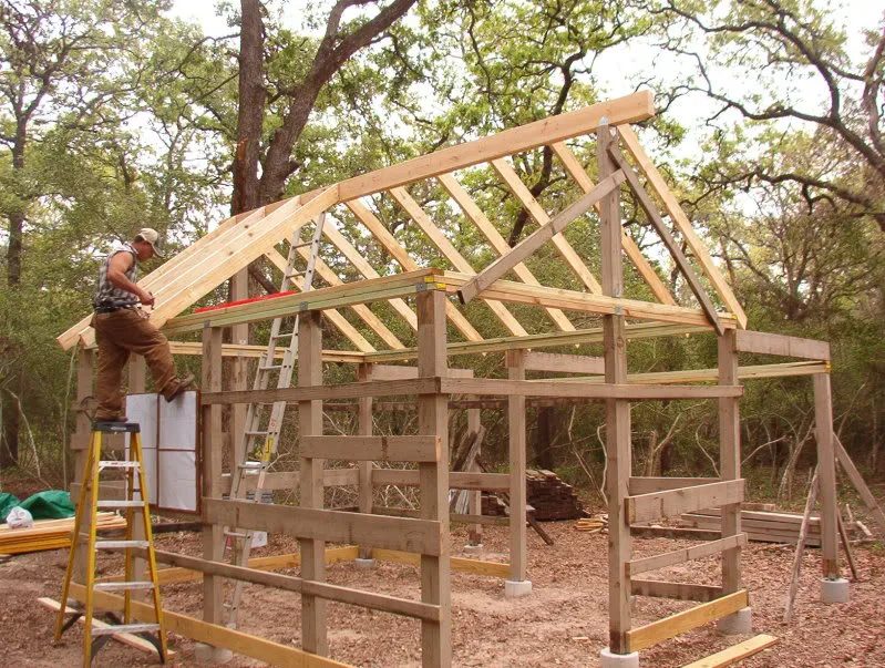

Abbynrml

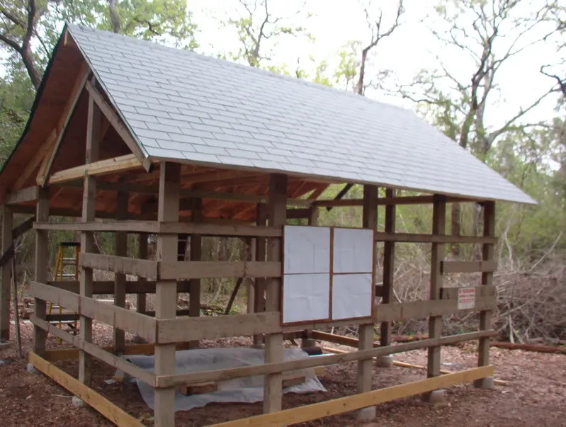

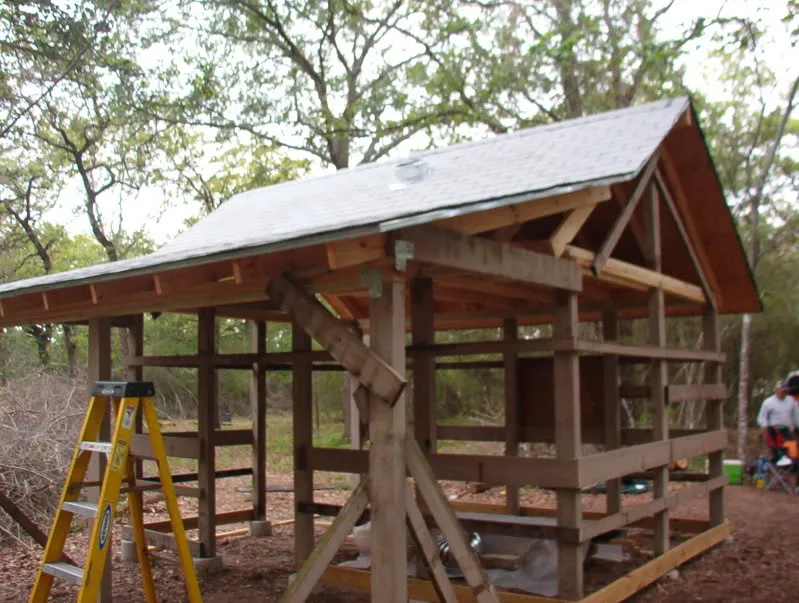

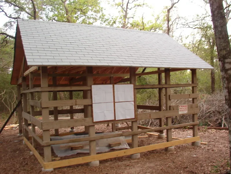

A few delays, a few problems, and alot of sweat and hard work, 6 days later this is where I am at....
Looks like 6 productive days.   :)

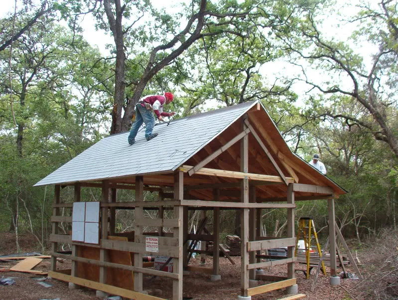

Abbynrml
Thanks guys. As you can see, I did not use the tin roof.
I shingled it instead. Its a very long story...but lets just say it is shingled.
I still really like the tin roof look, but shingles were the best option for several reasons.
I have a lot left to do, but now I can take a break. One day to rest up then its back to my real job. Gotta eat too you know. lol Oh, and need to save up some bucks for the rest of the materials.
One more thing. I hired 2 guys to do the roof. Best investment yet!

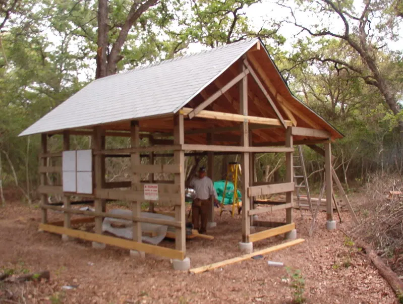

Abbynrml

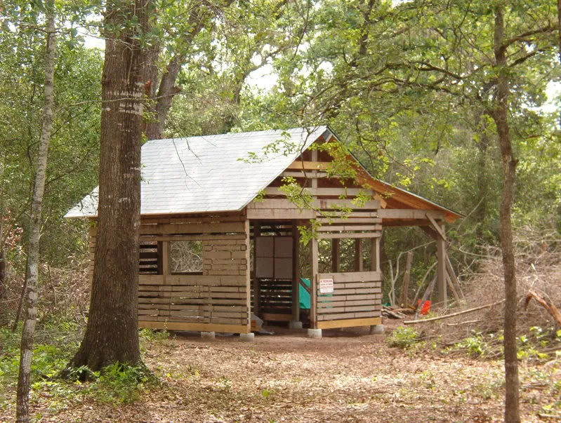

Another weekend and I got a bit more done.
Also returned the extra roofing materials.
It rained hard saturday morning. Sunday was beautiful.
Heres what it looks like now:

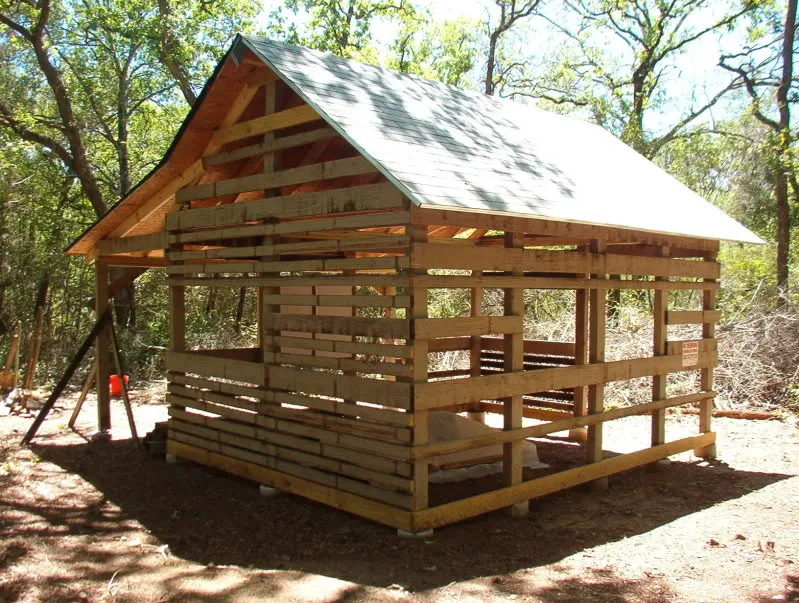

Abbynrml

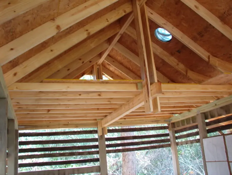

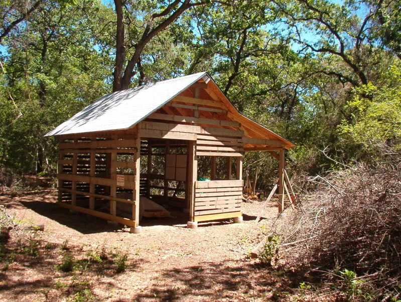

Time is flying by. Last weekend of april, here's where I'm at now.
I also rethought the loft idea. I added a 8 1/2 foot wide by 8 foot long hanging loft.
I used 2x4's 12" on centers. Then hung 2 2x6's under it for support.
speedfunk
Looks really cool!
I'll be watching ,  I'm also thinking of soil cement floor for our house.  I like the idea of a dirt cheap floor that is strong but a bit softer on the feet then pure concrete.
have fun!
Peace
jeff
Looks good but you are carrying about 1/4 the loft load as a point load at the center of the ridge board. (Which is doubled).
I wouldn't store a ton of bricks up there, ;) but it should be fine for hay and such.
PS: You might want to reinforce the rafter to plate connections for at least the immediate rafters that will transmit that point load from the ridge. Use straps or anchor plates that lock the rafter against outward thrust.
Abbynrml
Thanks for the kind words.
I intend on using some straps to tie the rafters into the top plates and posts.
Kind of like the hurricane tie down straps that are sold.
I have several feet of very heavy metal banding material, I will cut and nail it in next time. Attach to rafter, twist, attach to inside of top plate, twist, then attach to post.
What kind of weight limit do you think the loft would hold?
I am thinking 400 lbs or less.
I had 200 lbs on it overnight, no problem and no shake.
