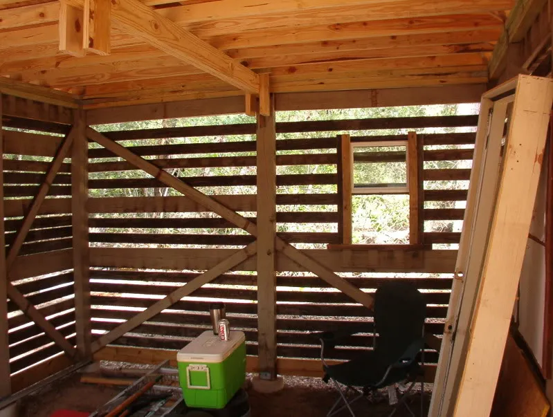

That's cute.

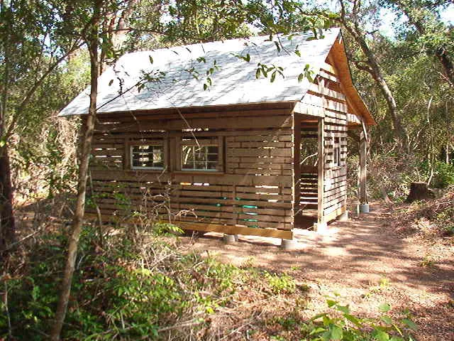

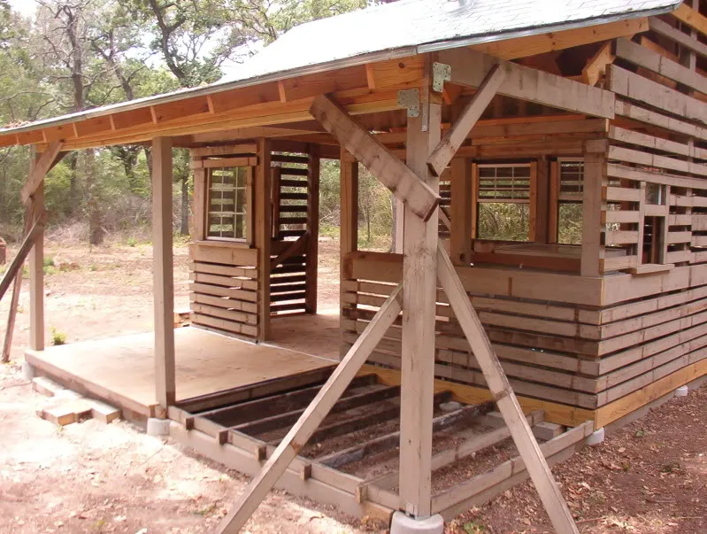

I like the fact that there isn't a hinge point like you'd have with a short post under a floor beam, the walls can stabilize the posts.

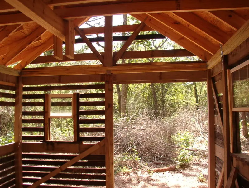

I hope you're open to a couple of suggestions. You can pick up more wall rack bracing if there is at least one X braced bay in each wall. We get the same effect nowadays normally with plywood or osb on at least the corners of a building but the old timers either let in or framed in "wind bracing". Sliding in a sheet between posts on the inside and securing it to the horizontal girts well would do it too. Also it looks like the top plates are 3 flatways 2x4's spanning about 4' and carrying the roof and part of the loft load. It is a small building but thats alot of work for flatways lumber to do and not sag over time. If you can sneak some headers under the plates on the bearing walls it'll strengthen that (it could be I'm not seeing it all clearly either). I look forward to your floor experiences.
Abbynrml
Next weekend I will add the tie down straps then 2x6 braces under the top plates, set between the posts.
I had not intended on using x bracing. Do you think it is nessary?
I will wrap it with tar paper then add siding, but thats not until june.
Hopefully, the trees will break enough of any winds until then.
Also it is open, so the wind will go thru.
On the inside I will add insulation, thinking of foam board, then just paint it. Leaving the 4x6 posts half exposed on the inside.

I don't think 400 lbs in the loft would be a problem. Your suggested addition of straps will help a lot.
If you tell me the total length of your ridge beam, its real size and the point along its length that the load is hung then I can run a quick calculation to see if I can get an estimate for you on the loft load.
As to your second question about lateral bracing. In short you don't have much. You do have a sturdy roof diaphragm, which means that in hurricane force winds the roof would likely stay together long enough to exert enough force to push over the walls. :P It also looks like you are well protected by trees, which probably means the place will be lost to a falling tree before it blows apart. :D :D :D
All lovely thoughts, of course.  But better to think them while you are still building.
If you are going to turn this into living space sometime in the future, then you will want to brace the walls with something more than open horizontal boards and probably clear a tree or two on the windward side. Personally, I would keep it as a covered corral or shed - it's built fine for that use.

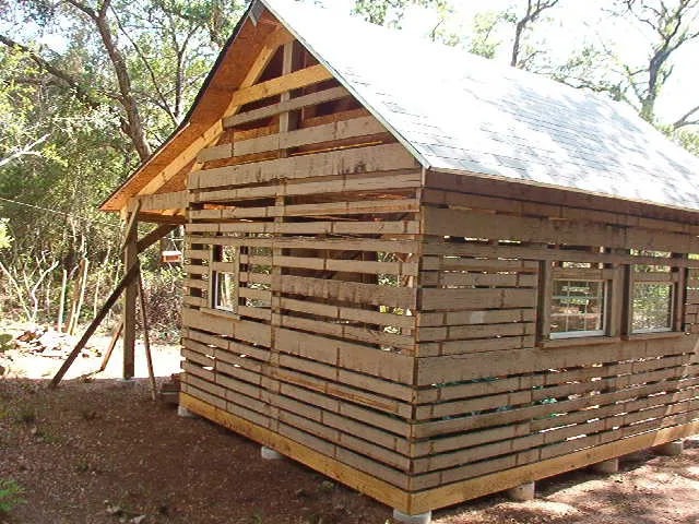

Another weekend, I cut it short because mothers day is tomorrow.
Got three walls ready for siding, next time I'll finish the last one.
Got the x bracing in and the tie down straps added.

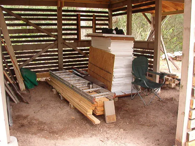

Just got another deal off craigslist.
I got about 100 sheets of styro foam.
1/2" thick and 2'x3'. The guy said he has more too.
Hope he remembers to save my email and let me know when I can get it.
It was packing for the end caps from a store rack.
I will put this up on the shed for insulation.
Abbynrml

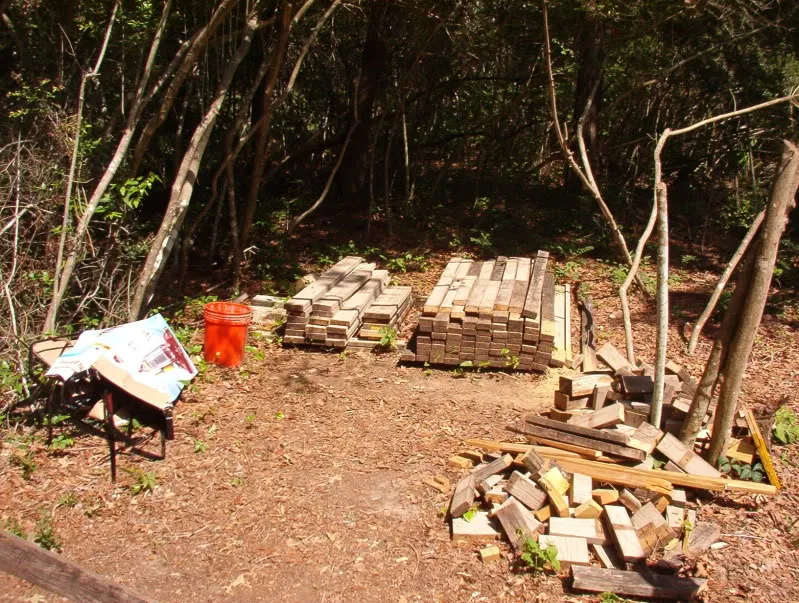

Got the styrofoam hauled to the site. We also burned alot of the cut brush this weekend. If I can keep it mowed it should start looking nicer.
Here is a pic of the supplies on site as of today.

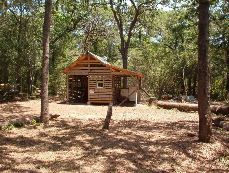

Abbynrml
Well, spent friday burning and cleaning up.
Here is what it looks like now.
Much better for fire safety.I hope I never get as close to a fire as Don did.

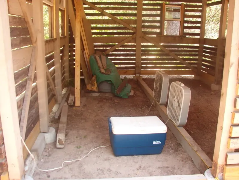

Once again I have changed plans.

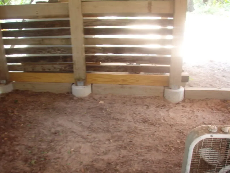

I intended to use a soil cement floor, but now I will do a wood floor instead.
The more research I did changed my mind. Seems most people have found that the alternative just does not hold up for long term use. And I already have enough wood to frame it all. I will only need to buy the subfloor decking. As others have pointed out, my crawlspace is only a few inches. I think that a roll of tarpaper between the joists and subfloor would help keep the floor dry. Any suggestions or comments??
A few pics from yesterday, got a little done, but not much. It was too hot to stay and work all day. It was 102F, with the heat index added it felt like 105. I about melted. LOL

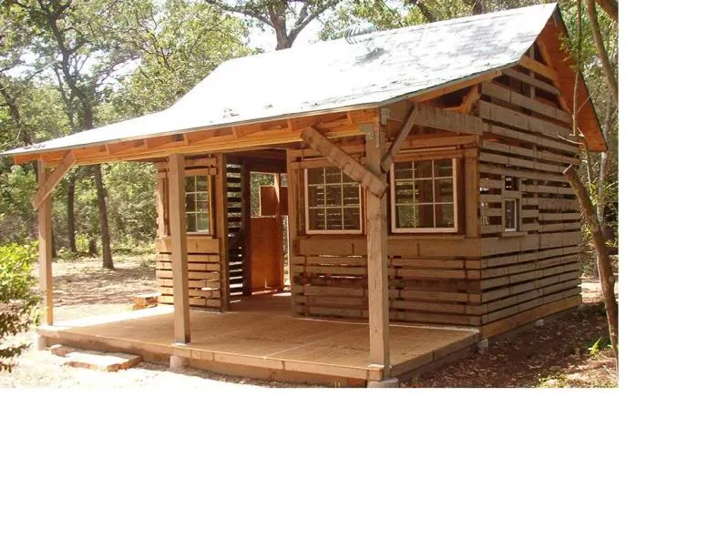

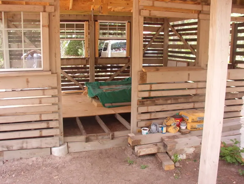

Got a bit more done on the shed. All decked finally.  ;D
Abbynrml

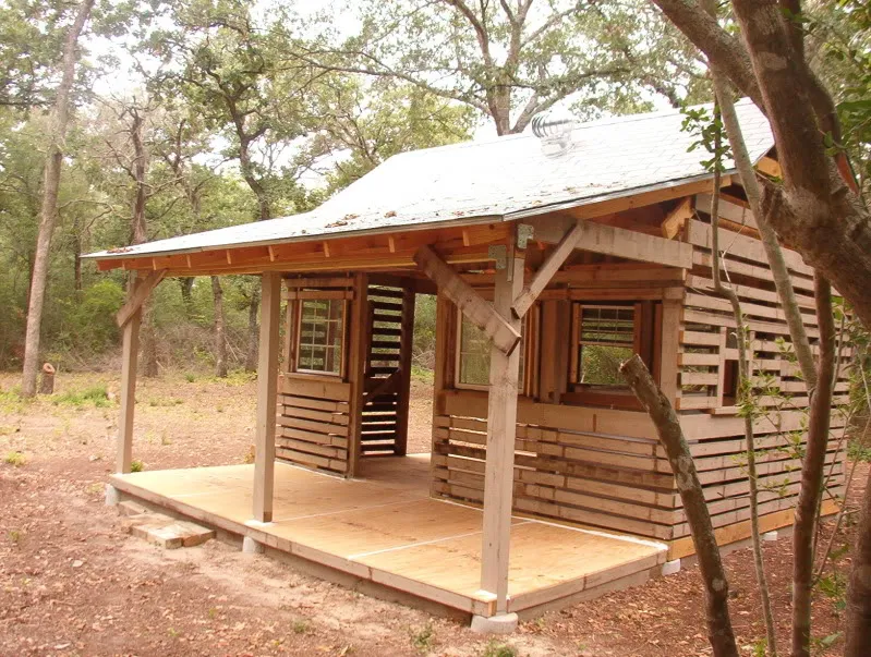

Got all the windows in finally and finished caulking the floor.
Also framed a double door and covered it temporaily with some leftover plywood.
The siding is next.
seems to be a never ending list of stuff to do next....
