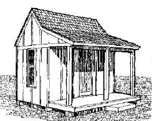

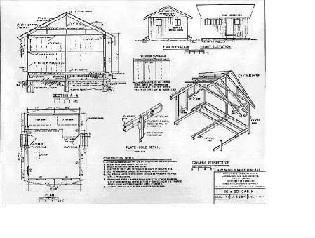

First, I based my plan on this design I got on the net:
I bought these plans on the net and used them also:
After many designs and changes I came up with Phase 1 plans. Phase 2 will include a shed roof porch and bump out....much later, lol.

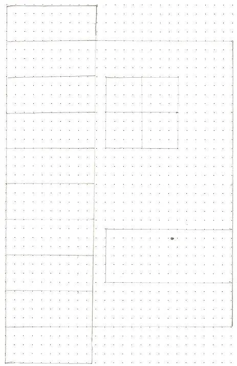

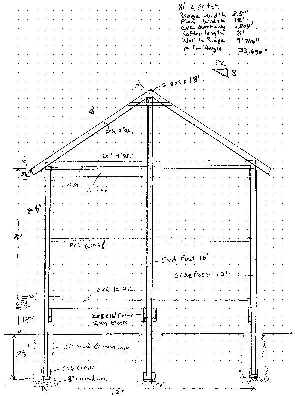

My basic Phase 1 plans look like this:
I hope the plans look good to everyone.
Where I am building no permits or inspections are required. Only approval from a deed restriction office, which has already been given.   :)
Tomorrow I buy and haul crushed rock for the post holes.....Wish me luck! lol
It's great to get a project going, isn't it!!   :D :D

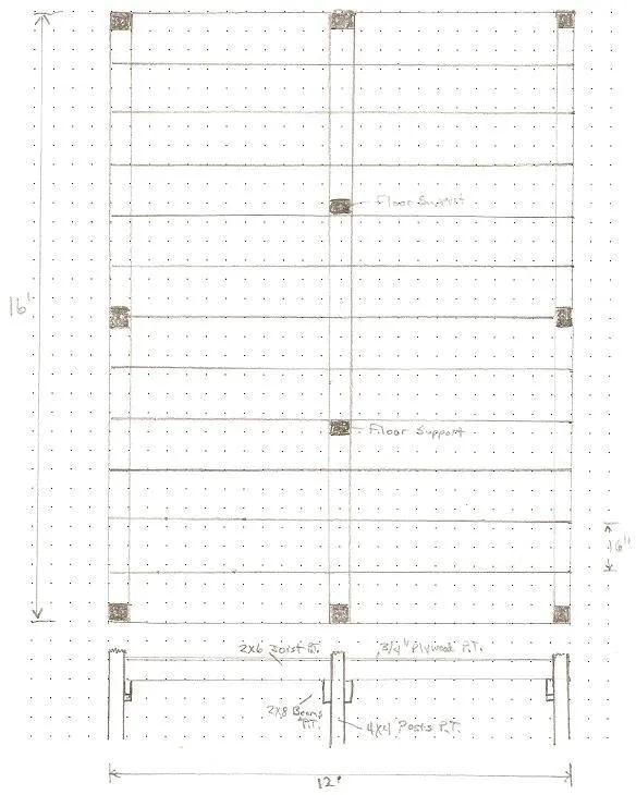

The only thing I question is with the 2x8 beams and floor joists. It appears you have the beams secured to the sides of the posts. I've built decks like that; no problems. However I wonder if that is the best way to build even a small cabin. Beams placed on top of the posts will be much stronger. On the side means everything is held up by the shear strength of the fasteners. Maybe it's just me but I prefer the beams on top of post method. You can build the beams up from 2x8's.
If you used 2x8 #2 or btr for floor joists you could dispense with the center beam. You could also move the 2 outside beams together a foot or so. John's Little House plans do that. It actually stiffens the floor and means you don't have to be quite as precise in locating the posts. If they are off a little it's okay as you square the floor up at the joist layer.
And being as conservative as I am, I'd use more posts down the sides, where the weight of the building will be mainly concentrated. But again, that may just be me.
Just some thoughts.  :D :D
Abbynrml
Hmmm, more to think about...Thanks Don. lol, I think anyways.
I could change the floor support posts and put them under the center beam, That would be easy.
And I thought about adding 1 post to each side wall, but when I do add the porch and bump out, I felt it might just be overkill. Still could do that tho. I'll keep thinking about it.

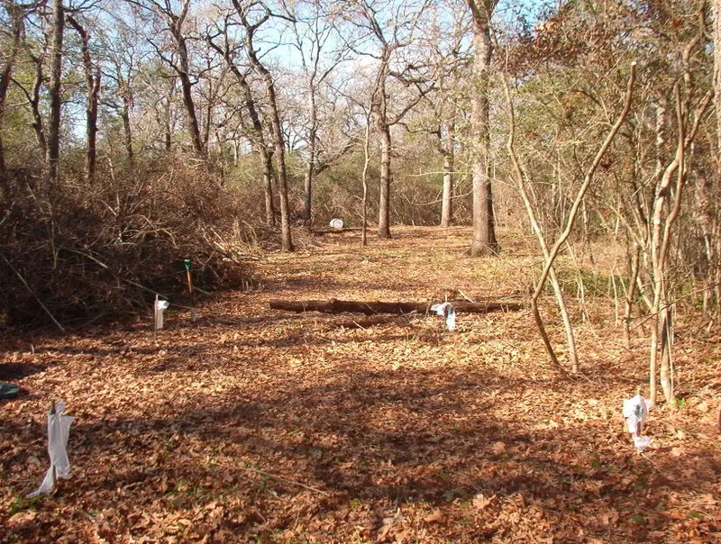

Oh yeah, I meant to add one more pic. The site. looking west:

FYI, John's plans in the Little House series (10'x 14', 12'x 18' and 14'x 24') use a 4x8 beam down each side, inset a bit as I mentioned. Each beam is supported by 4x4 posts at 4 foot spacing. That may be overkill; John is conservative in his plan specs, but he's been designing for years.
So more posts to begin with would be to err on the  side of conservative design.
Adding a porch or a bumpout won't decrease the loads the main posts will be carrying. They will need their own supports.

How much land do you have? Looks like you have a lot of trees.   :D

I bought just under 1 1/2 acres. When I build my house, in several years, I intend to buy the land next door. That would make it almost 3 acres. Plenty for me.
And yes there are alot of trees....Oaks, cedar, pecan, and tons of yaupon and vines.
The latter two will be removed, in time. lol
I dont believe it has ever been cleared. Man what a job that is.

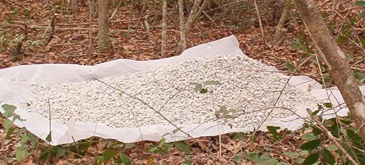

Abbynrml
My crushed rock is at the site. Actually about 30 ft. away.
$20, done deal, and can pick up a bit more if I need it later to finish.
The guy also had 13 tons of the stuff for $370, or milled asphalt for $270.
I need this for the driveway, but that can still wait.
Still looking at the plans and thinking. If I add one post to each side wall the math gets flakey. If I add 2 posts to each side, its totally simple. I am a simple man, lol. So, 2 more posts will be used. Putting the side wall posts at 4 ft O.C.
I dont want to notch the 4x4 posts for the beams. I could add a simple 2x4 block under the beams.
Any thoughts on this?

I don't follow that. With a 4x4 post you can sit a 4x8 or a built up beam from two - 2x8 on top of the post.

Abbynrml
#12
I would have done like that if I balloon framed the shed. However I am using the pole barn type frame. The side wall posts go to the top plate. 12'
The end wall posts go to the ridge beams. 16'
I will use center floor supports that hold the beams, and add a single 2x8 to the top of the floor support post being under the joists. 2x4 blocks added to the posts under the beams. That should do the trick. ;D
I should add that after the posts are set, top plates added, and floor joists and sub floor done. I can do the roof complete and enclose the walls last.
No exposed wall framing waiting on the roof to be done. I really like that idea, because it will take me awhile to get to that point.

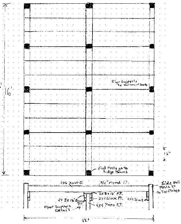

Abbynrml

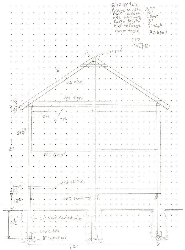

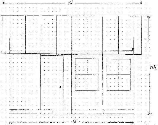

OK, now I have the final Phase 1 plans revised, probally not the last time either.
Hope these pics make it clear to everyone.
Any suggestions or comments are appreciated.
The 2x4 blocks will be worth very little that way.  If held with 1/2 inch bolts, each bolt in each block is only good for about 450 lbs due to wood fiber stress.  If you dont want to set your beams on top of the 4x then the 2x4 blocks shoud be foundation grade and go clear down to the bottom of the footing, however if you just put your beams in top of the piers as shown above, they the 2x4's would not be required at all.
Abbynrml
hmmm, ok. I didnt really think the 2x4 blocks would help much. Thanks for the input on it. I guess they are rather useless. Sure dont need that then.
Once again I'll state that it is based on a pole frame design, not home framing.
Correct me if I am wrong, but, the pole/posts actually support the whole structure. The floor only needs to support itself and the weight of any contents in the building.
With 5 supports on each side wall, 2 ridge posts, 3 center supports, headers, and girts to brace it all. Surely the beams would be fine.
If you dont think so, How would you support the floor in a pole frame design?
Notch the poles for a ledger board?

If you are going to use a circular saw that is all it takes.  Measure the offset of you saw plate to the blade.  Set the depth of cut on your saw.  Measure  on either side of the actualy cut area to the offset meaurement. Clamp a board on that line. Keep the saw foot plate against the board on the offset line.  Then just make multiple saw kerfs until the area you want to place your ledge is gone.  You really only need to clamp to make the upper and lower cuts. The rest can be done freehand.  Clean the area with a chisel and you are set.  You should not loose any strength as the ledger will just replace the amount of material that was removed.  If you have ever used a combination square you can actually use it to square your cuts allowing the saw foot to ride against the square.
This should be done after all your post are set and an accurate level is established on all your post.  Don't attempt to pre-cut in the ledger and then set the post. Chances are that they will not come out level.
