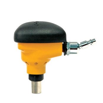

Al by blocking off the air flow  you will have no venting for your house roof.  How much clearence is there between the tip of the rafter tails and the shingles on the porch roof?
Can you get into that space with a palm nailer?
http://www.amazon.com/BOSTITCH-PN50-Mini-Impact-Nailer/dp/B002RU94B2/ref=sr_1_4?ie=UTF8&qid=1379010838&sr=8-4&keywords=palm+nailer+cordless
And are there nails that can be used for roofing with a palm nailer? That I don't know.
