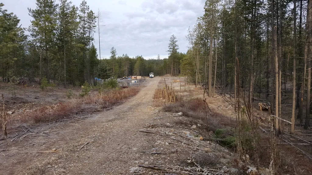

Day 1 Clearing brush and making room
Day 2 Cleaning up the clearing and making way for the excavation this weekend for the footings.
Can't really tell with the following picture (on the ridge) but once the cabin is built off the front deck will overlook a 54 Megawatt Windmill turbine project nearby... (hope the pictures post properly)
Full photobucket picture album of build project ( http://s1156.photobucket.com/albums/p566/ColchesterCabin/Cabin%20Project/ )
