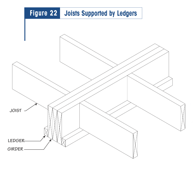

The contractor that did my foundation put the piers the same height as the crawlspace walls. He said I should use 3-2x10s(piers are 8' apart) to build the beam,and put a ledger on the bottom, and 2x8s as my floor joist 16"o.c..Some of my joist will be 12' long(bedroom),but the main build is 10' because Ill have a center beam.
When I asked him how the beam and joist meet up,since theyre 2 different sizes,he said to notch the bottom of the beam at the pier.
I checked all this out and sounds right. Actually I think youll helped me with that.
But I think Id rather use 2x10 as joist as well and not have to notch beam. I should be able to go to 24"o.c. andit shouldnt be that much in cost difference. Id still have to notch joist at ledger.

Why not just use joist hangers no matter what size you pick? they are easy, cheap, and hold a crazy amount of weight.
rocking23nf
and I would not personally do 24" centers, the cost is minimal in the scheme of things, your adding what, 7-8 boards? 10 tops?
I agree about the 24" centers. Then you will probably want to go to heavier sub-flooring and all cost advantage is lost.
At 16" o/c a DF#2 2x8 will span 12'-9". A 2x10 will go 15'-7" (If 24" o/c then back to 12'-9" on the max span.)
I would probable go with 2x8 @ 16 as your max span is closer to 11' and that in the bedroom. The limits of these spans are in the deflection not strength.
#2 SPF is what is commonly available here, that'll take a 2x10 @ 16" o.c. I would agree with using joist hangers.

A ledger has pretty much fallen into disfavor, they can "roll" out putting the connections into withdrawal rather than the intended shear. Notches are allowed and help with the ledger rolling but the square cornered notch, called a re-entrant corner is prone to splitting. If you look at well done old timberframes the notch was swept in an arc down to full thickness avoiding the stress concentration at that notch corner, never seen a stick framer do that. Subfloor glue is supposed to help prevent hanger squeeks. If it is a hanger squeeking some baby powder would probably work as well. Often a squeek is a nail that just missed the joist and is rubbing.  If the finish floor isn't down yet they are usually pretty easy to fix.
