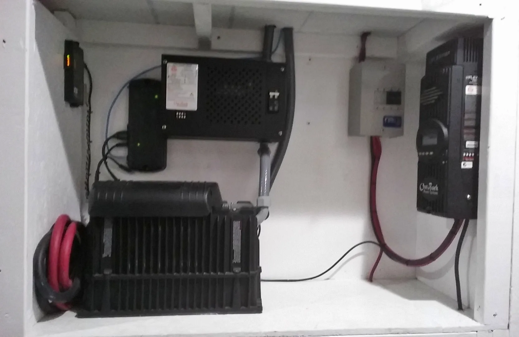

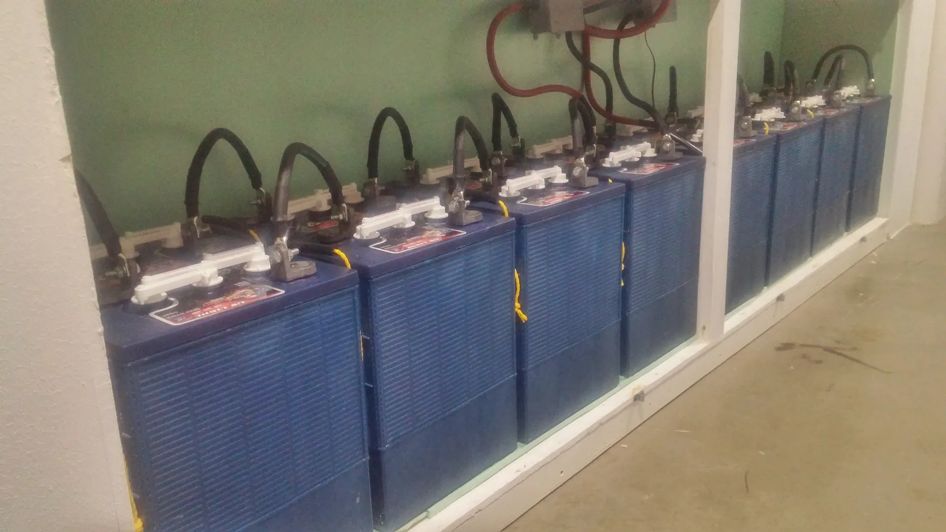

We now have a 4.1kw array and we are running 16 US battery L16s 48v 840ah total capacity. Just finished installing an outback 240v transformer to power our newest addition which we have longed for forever. Air conditioning! I installed a 24k btu 3 zone mini split system. We opted for the ceiling mounted models and hopefully the system will be up and running this week. HVAC guy is supposed to come tomorrow and hook up the lines and vacuum/charge with refridgerant. The rest of the work has just been framing/drywall to finish out the entire basement. Our little 700 sq ft a frame has grown to a 2400 sq ft house in just 8 years time. This will likely be the last of the building on the house itself.
Without further ado, here are some photos.

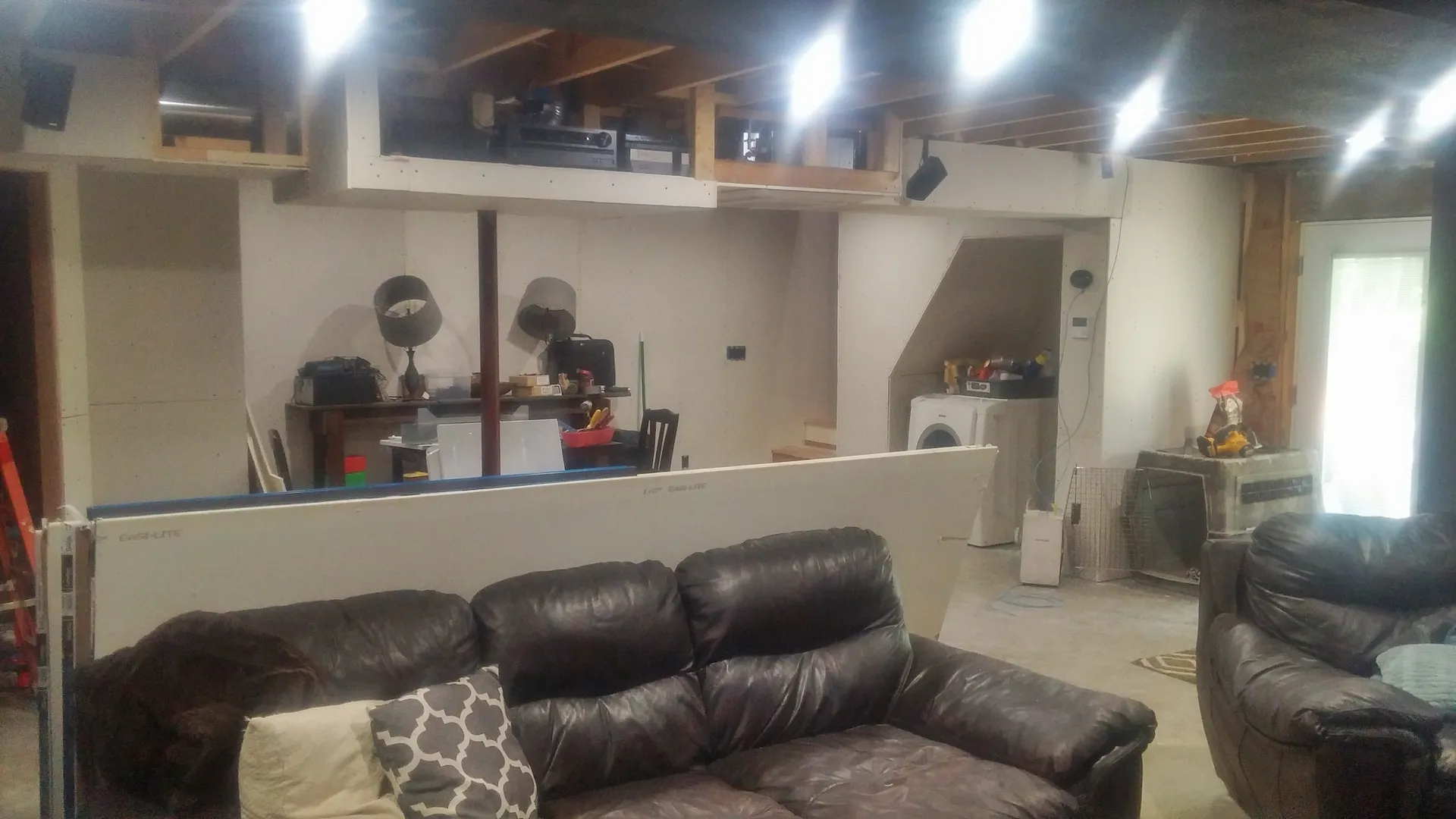

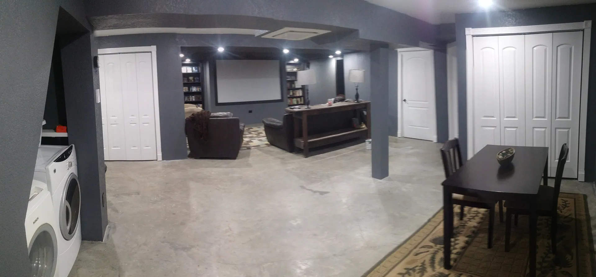

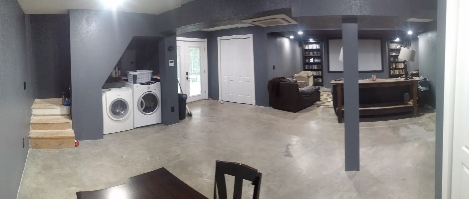

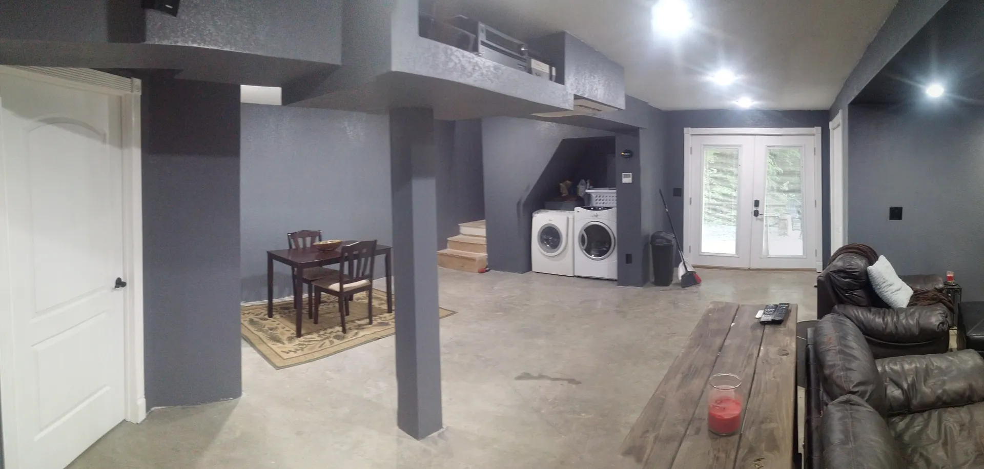

A few updated photos post painting. Sorry for the slightly crooked pano shots.
EaglesSJ

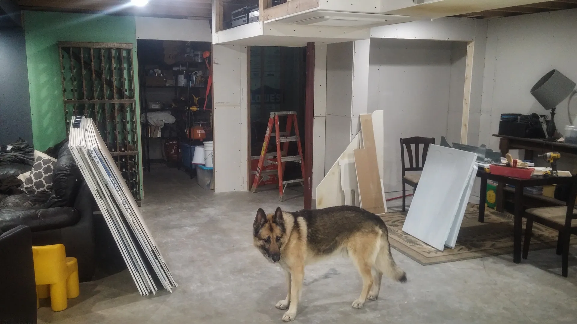

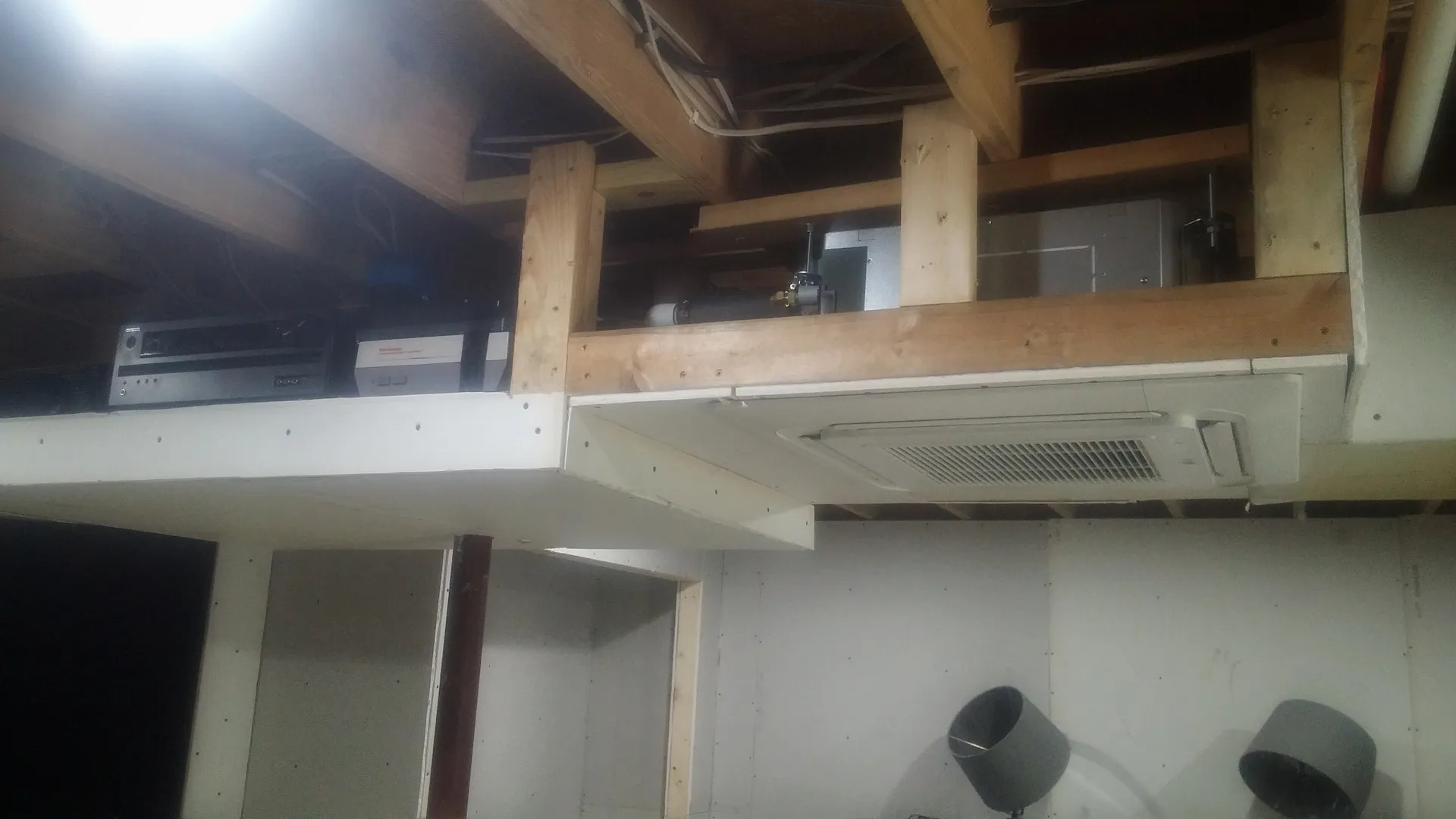

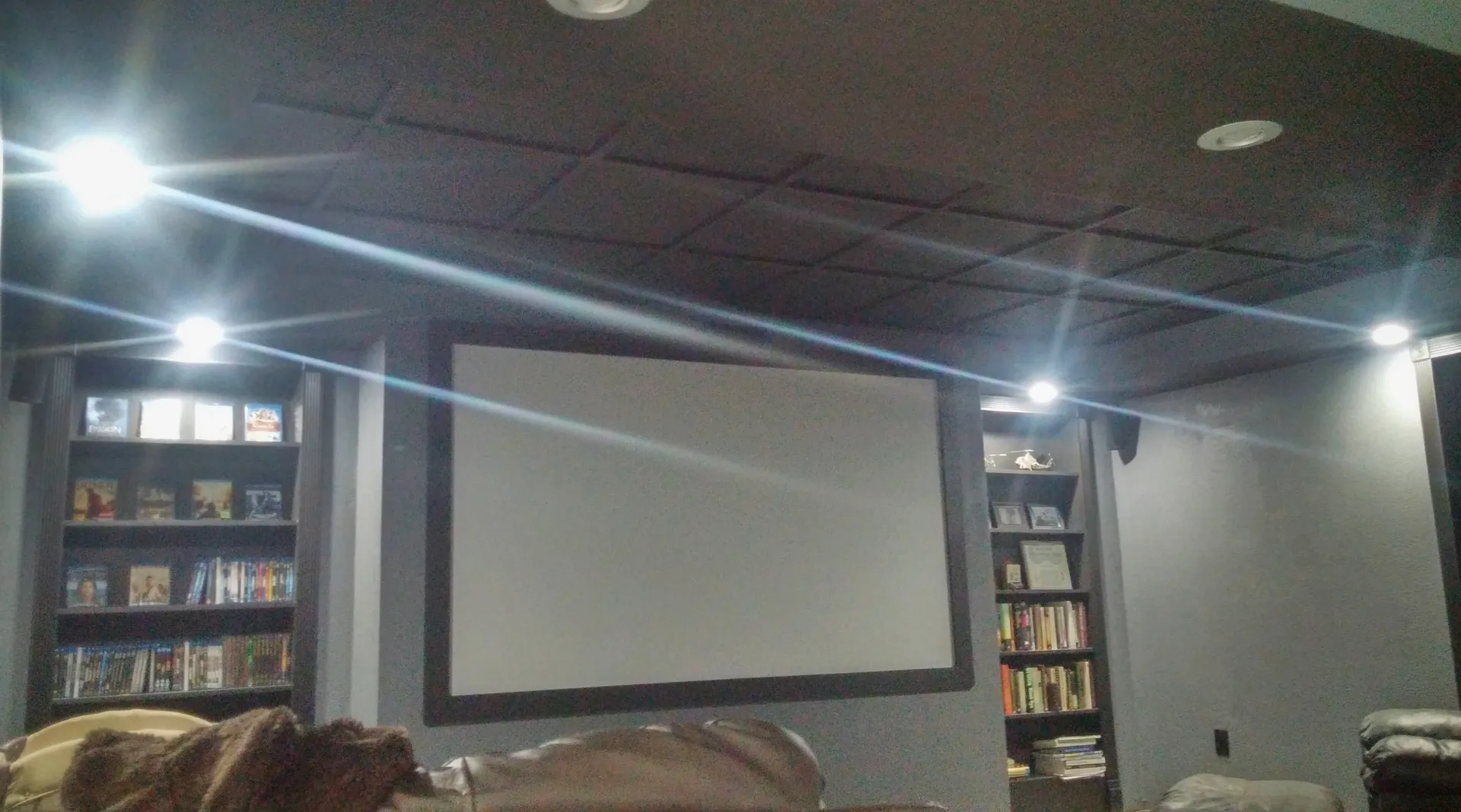

Here is one more of what I consider a "unique" ceiling idea. My wife actually came up with this one. I took sheets of 1/2" OSB and ripped them into 3 equal parts each being 4 feet wide and roughly 30" long. Then I used 1x2 stripping to make the rectangles. This was all screwed to the above floor joist with drywall screws. This created a simulated drop ceiling tile effect without losing any headroom and also makes it very easy to remove a small section of the ceiling to access wiring and plumbing.
Quote from: EaglesSJ on July 02, 2018, 11:50:06 AM
Your pics didn't come through for me so I pulled out the [ IMG] codes. That's a nice modern look to the A-frame cabin. I like it. Functional too with the ability to have access to to the house's system.  [cool]

Yeah, we decided to go more modern in the basement. We will likely update the rest of the house to be a bit more modern as time progresses, Lord willing.
Quote from: EaglesSJ on July 03, 2018, 10:46:43 AM
Rustic outside, modern inside. People around my area of SC pay the big monies for that combination.  [cool]

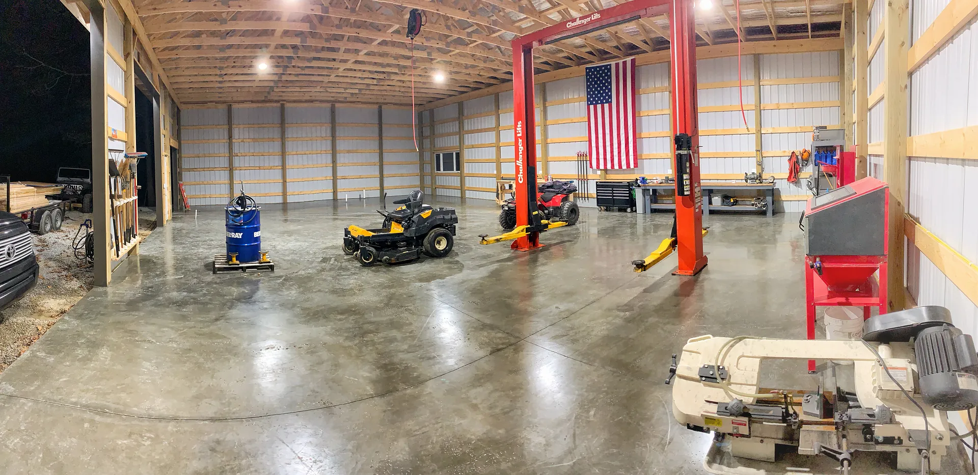

Just wanted to provide a quick update. We have recently added a mate3s to our solar setup and for anyone on the fence about it we have found it well worth the cost. It's wonderful to be able to simply check my phone in the morning and see how much our solar panels are sending to our batteries or what our current SOC is. We have also built a new 40x60 shop. Pics to follow if anyone is interested in seeing it.

Great to hear you are happy with the newer mate.  That is another good reason folks should give more thought to using one brand for the hardware. The CC, inverter and all work together and as improvements are made you can take advantage of them.

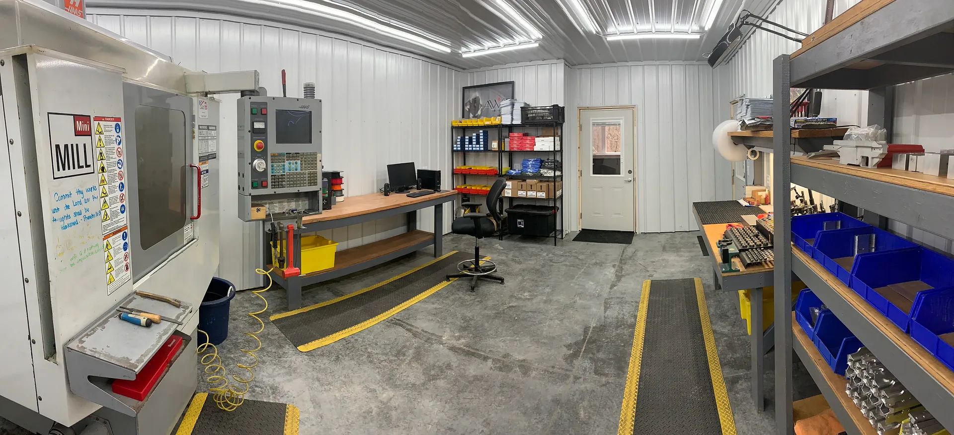

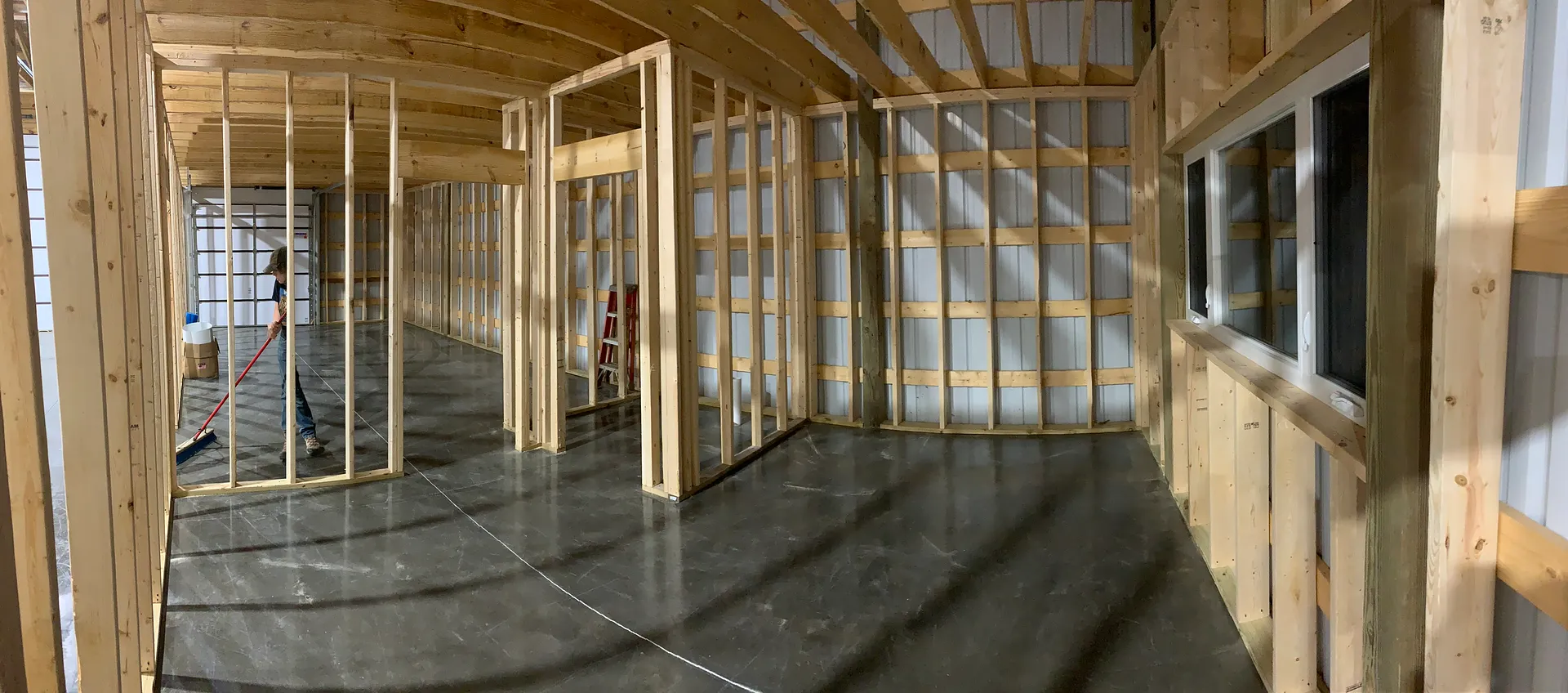

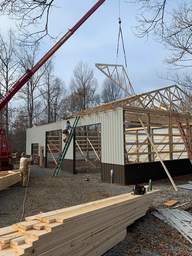

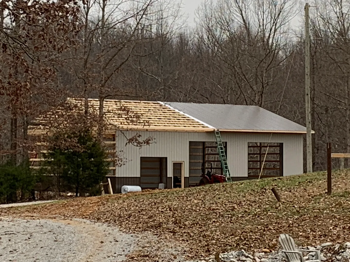

Here a few for you. This was built start to finish by my dad and I. We did have a crew come and pour the concrete and a crane operator come to help set the trusses. Other than that it was us doing the work.

Most of the images do not appear for me. The 10th and 11th show as does the last one. From what I can see the shop is quite nice. A CNC mill?
EDIT... a Haas

Ahhh, I never thought about the winter conditions there. Do you run some sort of small heater to keep pipes from freezing or just drain everything when you leave? Also yes that is a Haas mini mill, I use it for my business. I sold my old shop so we could use the funds to build one on our land. Really wanted to be within walking distance of the house so I could spend more time with my wife and kids. Its also very nice having all my tools and such right here close to home. I cant count the times I had to make a trip to the old shop to get a tool I needed here at the house or vice versa.
