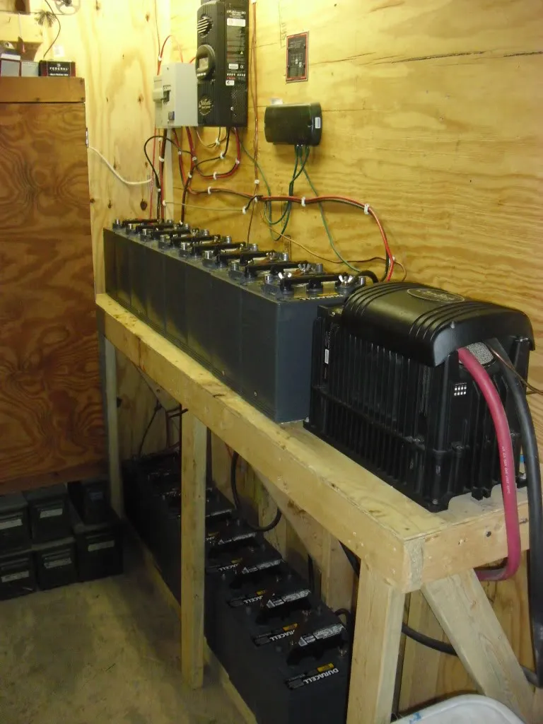

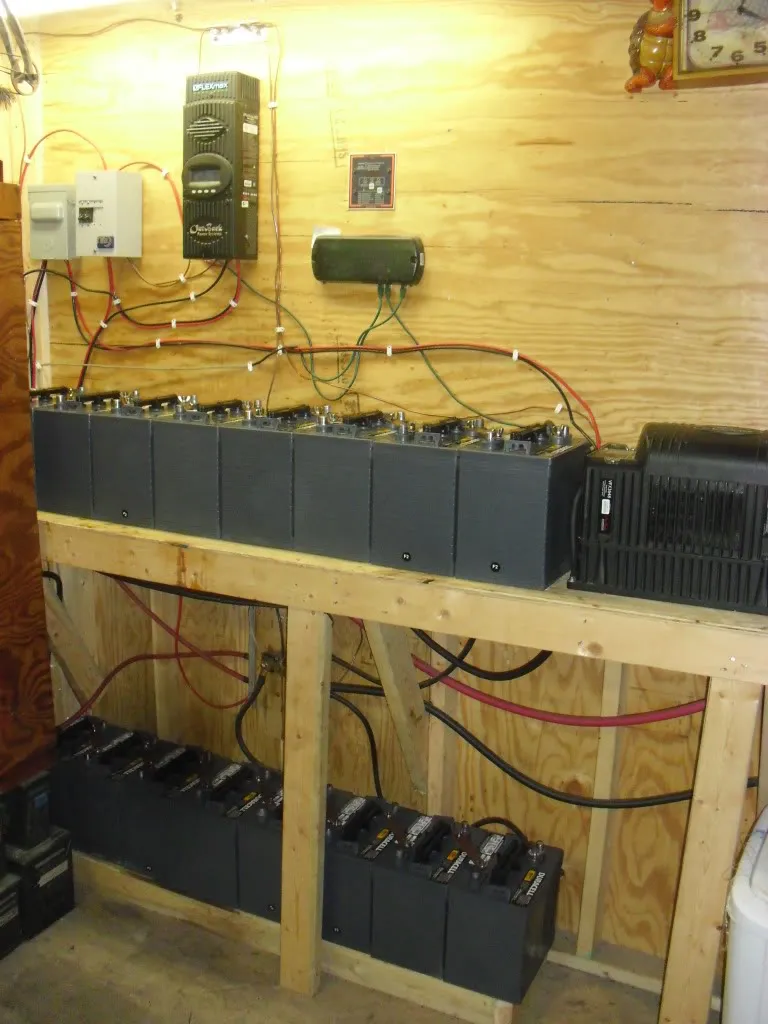

Got a new battery bank installed today. The walmart Maxx-29s only made it 9 months!!!!! Luckily I got a full refund on them and was able to put the cash towards some golf cart batteries. With the first set lasting about 15 months and the second lasting 9 I can say that I DO NOT RECOMMEND them for off grid use.
Now onto what I bought. I got sixteen 6v 230aH golf cart batteries from Sams that say Deka on the top. Ive read that deka makes alright batteries. These weigh 67 pounds each and from a quick look under the caps have much thicker plates than the last set I had.
Thinking about getting another 8 of them to take my bank from 460 ah to 690ah at 48v. This would give us about 4-5 days of back up. Here are the pics. I like the fill cap setup. Twist one lever and all three come off.

Ok so I have installed the new batteries however I have been unable to get my battery voltage up past 53.2V My amp meter shows that I am charging at 36amp and my  outback mate shows that I am charging at 2100w however my voltage never goes up. I let it charge like this for 5 hrs with the same result. My float is set to 55. My bulk and absorb is set to 58 and eq is set to 61. I would like to eq these batteries but for some reason its just not wanting to happen.
Squirl
I am not as familiar with 48v banks.  I don't know what the voltage is supposed to be at 100%.
If the voltage is consistently just lower regardless of the amount of power put in it and you can never get a full charge, you may have a bad battery in the bank.   My recollection from Trojan's website, was they recommend charging the battery, disconnect everything from all the batteries, and if there is a voltage drop after a few hours without the batteries connected to anything, you have a bad battery.
http://www.trojanbattery.com/tools/faqs.aspx
EaglesSJ
Ok so after my panels pumped 13kW into the batteries and the generator pumped another 10kW into them I finally got them equalized at 60v for 2 hrs. I took a SG test and all the cells came out to between 1.230 and 1.250 From reading this should be between 1.270 and 1.300 for a fully charged cell. What gives? Should I equalize again?
Barry Broome
How much do those batteries cost a piece?
EaglesSJ
Top is stamped DEKA east penn manufacturing. Call to them cleared that all components are made here in the US as well as being assembled here. Pretty cheap for a battery that people claim to get 5-10 years from.
http://www.samsclub.com/sams/shop/product.jsp?productId=prod3590220&navAction=push
EaglesSJ
after 6 hrs of equalization at 63v as directed by deka I now have readings between 1.255 and 1.75  on all cells with 80% falling between 1.260-1.265 I guess this is as good as I am going to get for now. I have spent alot of time with these batteries trying to be good to them and treat them like a little princess. Its now time to treat them like an ol team of mules and just use em until they wear out I guess. Im disappointed that I can not get them all up to 1.275 but there is little left to be done at this point. I have eqed them 3 times for a total of 10 hrs.

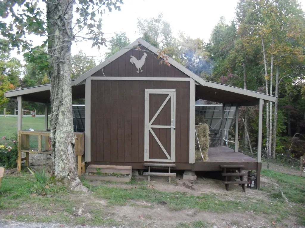

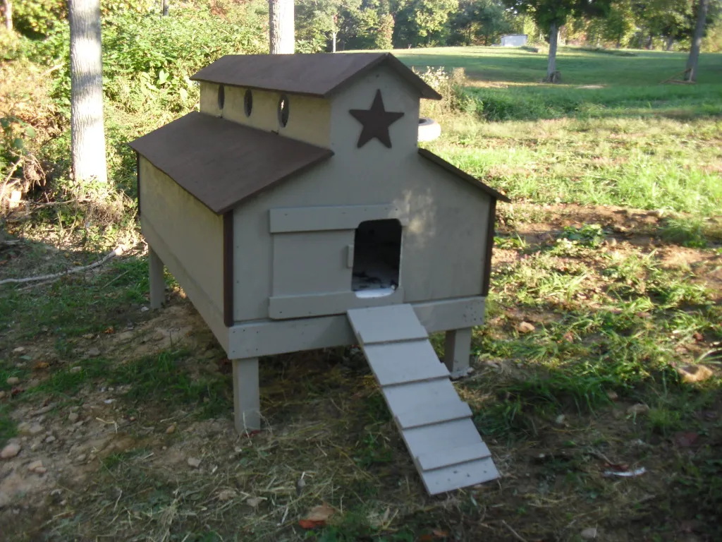

Built a new chicken coop and painted our shed as well as building a little porch out from it for additional storage.
