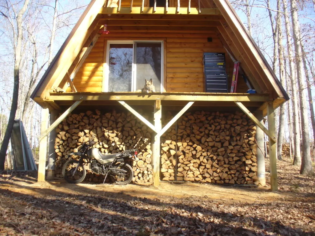

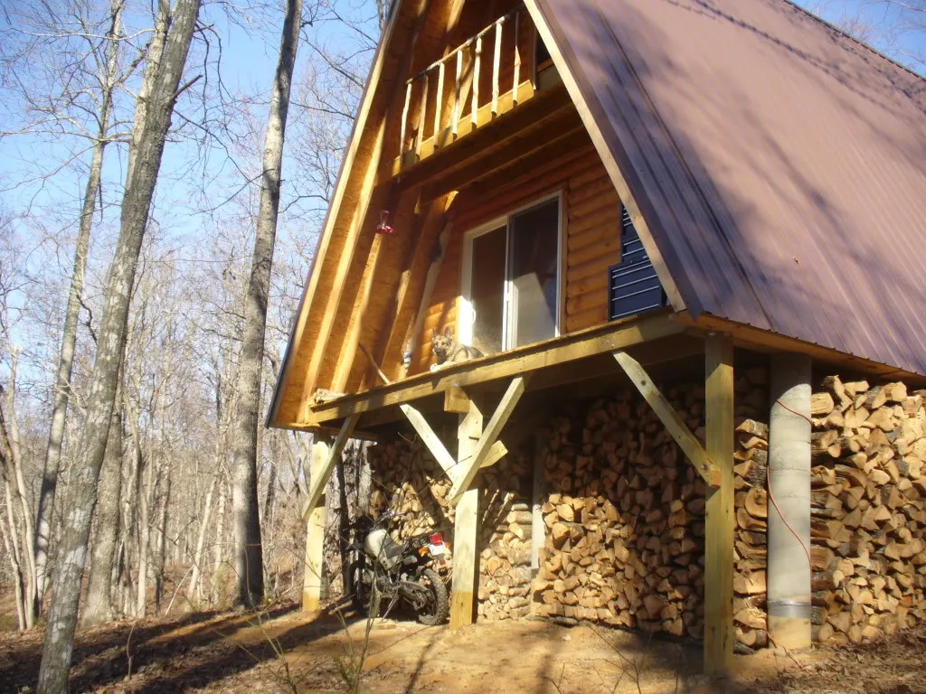

I'll be a wet blanket... Get something up to triangularize the piers before winter. We have mud, wind, frost, snow load... this is the trying time on the piers. I had been watching a barn for the past 15 years and commented on it here this past winter. It fell the day the frost went out.  Do anything to cross brace it and then do what you gotta do, just don't leave the bugs under there for warm weather, rake all the bark and junk out. A day of yard birds in the spring would about sterilize it under there.
poppy
I'll also be a wet blanket.
First, the firewood is not going to help or hinder the piers.  I agree with others; don't stack it under the cabin.  Use a tarp.
Second, even with bracing, that cabin wants to go downhill.  It will eventially settle and/or slip or creep down.  The combination of gravity and water plus add some breeze from mother nature and something is going to move.  Take a close look at your trees in the area; they want to grow vertically, but soil creep will tilt them and they will straighten themselves by bending vertical again.
Whatever you do, divert surface water as far away from the foot print as possible.  That requires an uphill swale or french drain or something.  A shallow ditch won't do the job with heavy rain.  Even if you don't see surface water actually flowing under the cabin, it will weep in from pretty deep.
There are plenty of stable cabins/houses sitting on stilts, but their piers are well anchored with pilings or continous concrete footers and would be deeper than 3' expecially for those downhill piers that are 7' out of the ground.
I'm not trying to alarm you; just trying to look into the future at what water can do.

The cabin does not want to go down hill. It wants to push straight down in the ground because that is how gravity works. Also these piers are in basically pure sand so drainage has not been a problem. Even in the heaviest of rains. I plan on adding 3 6x6 post sunk 4 ft in the ground to the rear of the house this week and triangulate them in both directions.

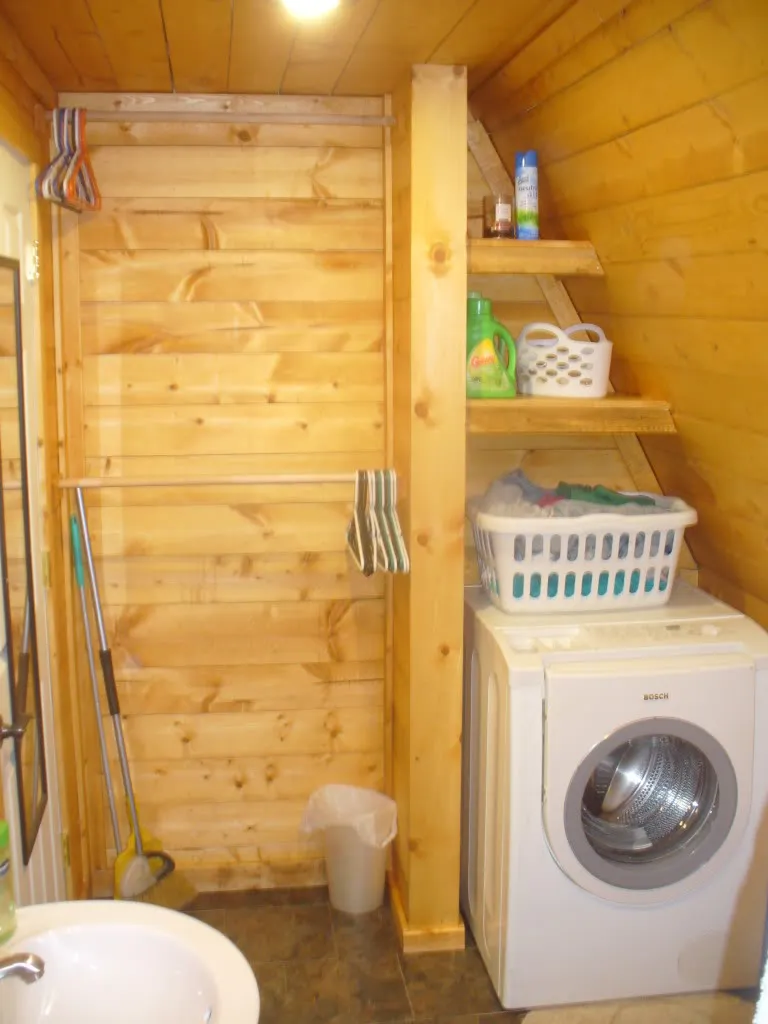

Killed my first chicken and had Lindsay cook him up. We had 5 roosters to 7 hens and so the hens were getting mauled so Im gonna kill one a week until we get em thinned out a bit. Also built a storage shelf/closet area in the bathroom so she could hang up clothes this winter to let them dry since it will be too cold outside for the clothes line. Headed out tomorrow to buy the supplies for pier bracing and a front porch. Will update when complete.

I hadn't kept up with the thread for a little while. Piers resist two loads. The first concern is gravity, vertical, loads. The second is lateral, horizontal, loads. These come from wind or seismic. When I get back engineering these have been analyzed, then they go on to check various combinations of those loads. Poppy's concern of slope movement is something that can be seen as you drive around and something I look at when we get to a new site. If you see trees with "pistol butts" the slope is moving and trees are straightening up as the slope moves.

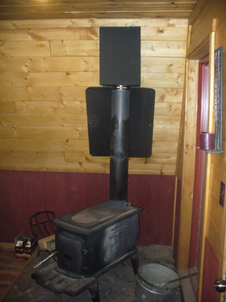

Woke up this morning to a light dusting of snow. I was more than happy to sit by this cozy little fire with the stove door open and watch the wood pop and crackle while I ate my breakfast and looked out to the white woods. Why anyone would want to live in the city is beyond me.

Finished my front deck and the rear support post and bracing. In the upper 20's here so it made for some cold working days.
I used 6x6 post sunk 3.5 feet in the ground and 4x4s for bracing with the exception of the middle post where I added  a couple of 2x6s to brace against the center beam. I bolted all of this together with 1/2" bolts 2 per joint.
