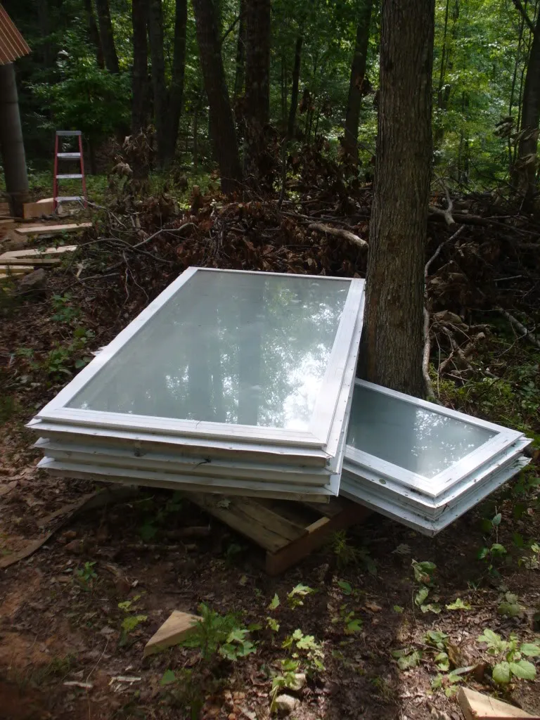

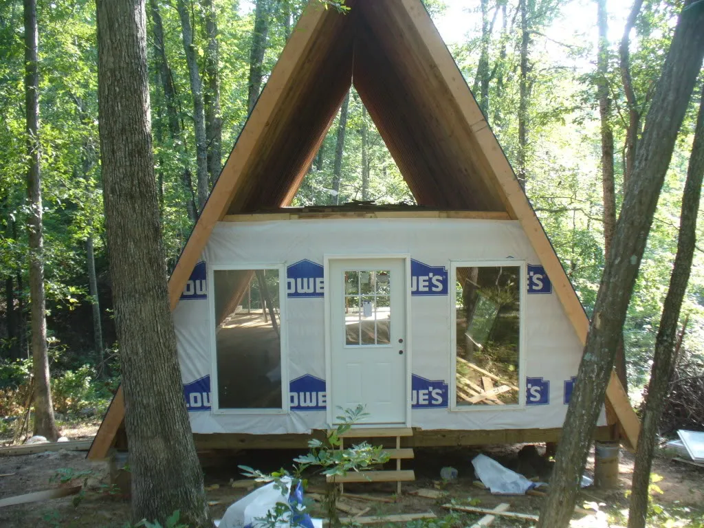

scored these double pane argon filled windows for $200 for 5 of them. 2 of them are 2'x5' and 3 of them are 3' by 5'. They came out of someones sunroom. they are foggy looking because the dew was on them.

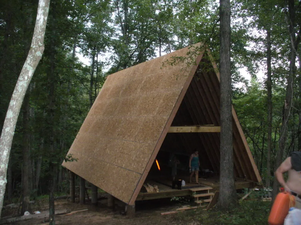

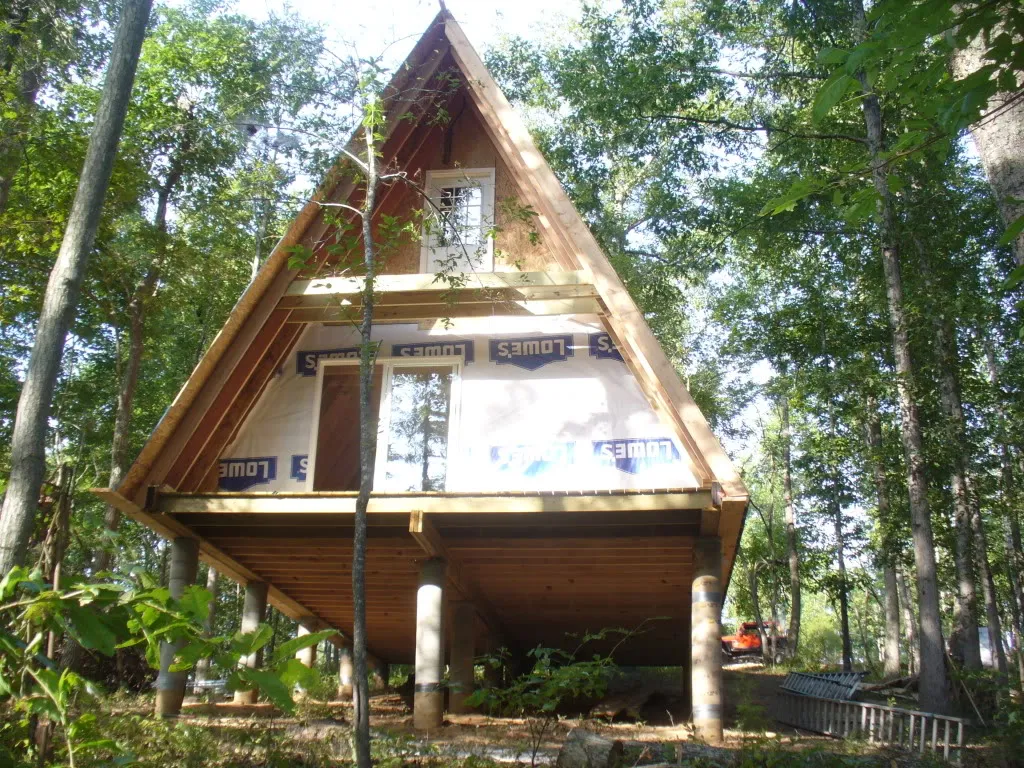

More from today. I also got the rear deck leading out of our room done.

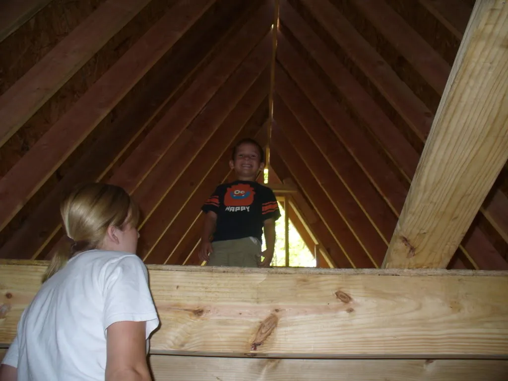

more from today. Only worked about 3 hrs today. Im tired. been going for 3 weeks everyday.

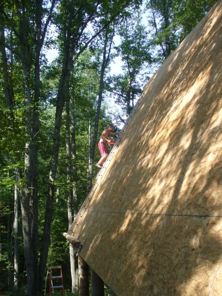

yeah putting on that sheeting has been the scariest job yet by FAR! Glad its behind me. Now onto the metal roofing :(

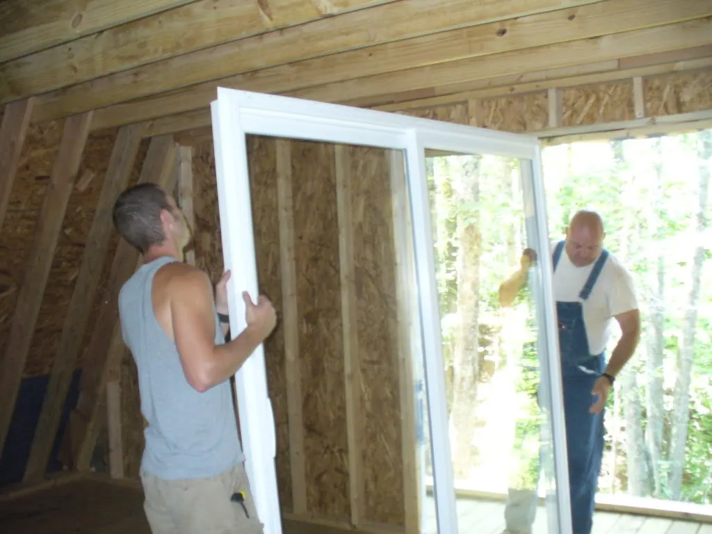

I appreciate your kind words. This is my first construction experience as it is my friends also but were doing pretty good all in all. I am not that bitter over the whole ordeal although my fiance and I have thought about all the nice things that we could get for the new place with the money we spent on this one lol. Bought lessons are always the best lessons though. My only concern for them is now the entire family has turned on them because of how they have done us and when they get a bit older and no one is there for em Im sure they will regret alot of things. Oh well, no use in living in the past. Were getting the chance to build OUR dream home now instead of fixing up someone elses to make it livable. Anyways I will report with more pictures later. Its off to lowes for a patio door!

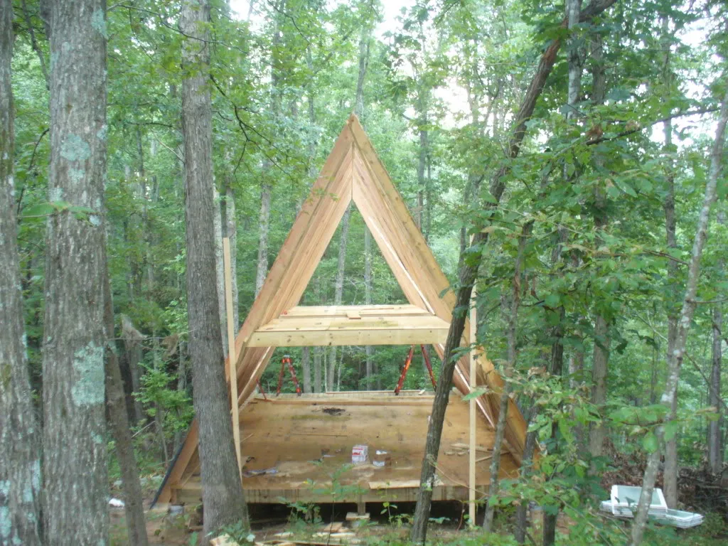

Texas Tornado

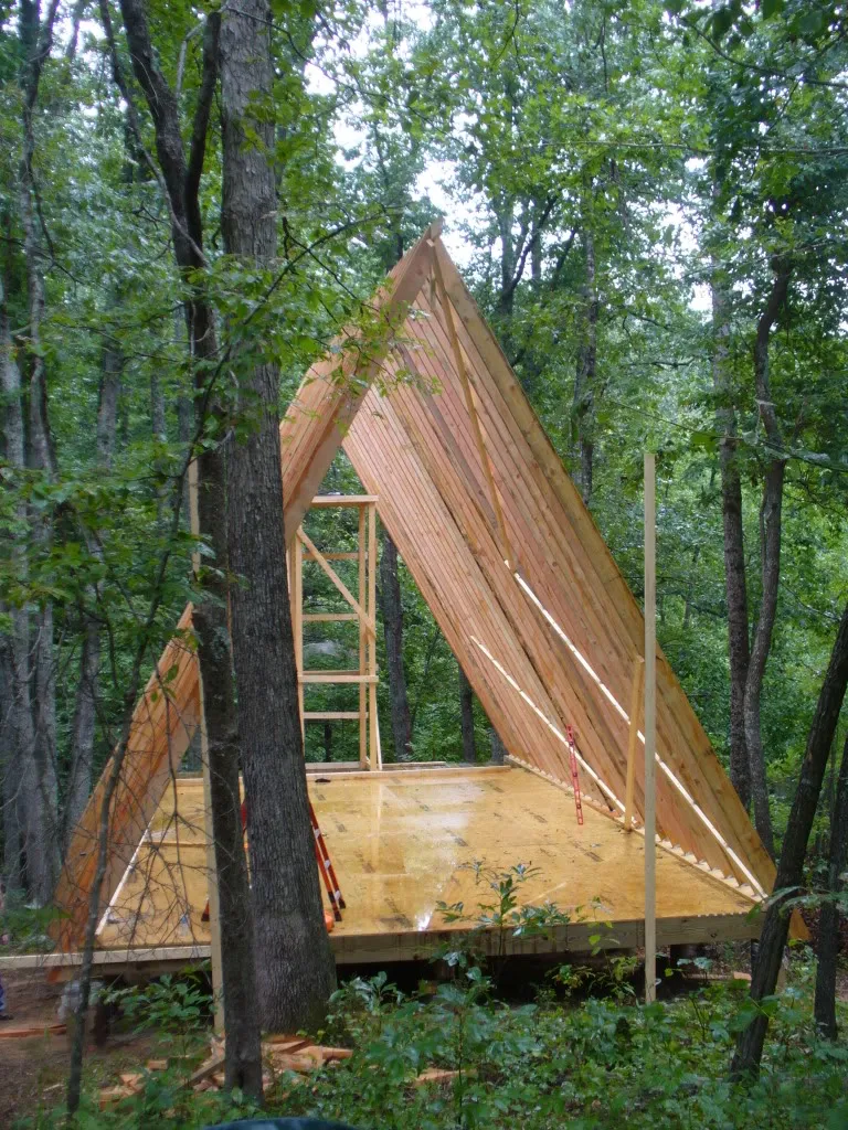

Quote from: Don_P on August 12, 2010, 04:59:39 AM
Drinking my coffee, avoiding the plans I'm sketching and looking at others pics  c*. Do fill the ridge before you're done. You're bearing on the toes of the rafters up top, that'll split them over time, they need to bear on their heels.
Can you post a picture explaining this?
Quote from: Texas Tornado on August 16, 2010, 06:26:18 PM
Good question...
Here is what Don_P was referring to. In the early photos the rafters had their points (toes) resting on the ridge board. That is only the toes.
Another board should be added below the first one in order to have the heels of the rafters supported.
This becomes even more important as the roof pitch decreases. Eventually the rafters may split if the heels are not supported.
MD got it while I was drawing and looking up stuff,
Last first,
table R503.2.1.1(1)...now howcum you can find anything in the Bible with less than half that many numbers, but I digress ??? gives the maximum span for roof sheathing with and without edge support (clips). Very few applications actually require clips...I always use them having seen enough ugly spots on roofs that didn't. I was sticking them on 5/8 sheathing that was framed on 16" centers today, way overkill for edge support, but they are cheap and also space the sheets so I just go ahead and do it. This is a screenshot of that table, pay attention to the max live loads as well;
This is a sketch of 4 pairs of rafters,
the upper one is correct, the entire plumb cut at the peak of the rafters is fully bearing on the ridge.
The second from the top is bearing on the toe half of the plumb cut, the ridge isn't tall enough, I've drawn where it can split the rafters if it is heavily loaded. It isn't code but if the ridge were slipped down to the bottom of the plumb cut it would be fine.
The third one from the top is a bad plumb angle leaving a gap and bearing on the toe of the cut. It will fail by "feathering", splitting into many soft edges until each bears against the ridge. Shim this cut and correct your pattern.
The bottom is another bad angle cut but is bearing on the heel... if you're going to err this is the better way to be, it won't split the rafter, it will crush into the ridge until it has enough area to take the load. But again fix your pattern....unless you are framing with green material then it becomes an art, you cut this way just enough so that when the rafter is dry it become like the top drawing, think about how a miter dries.

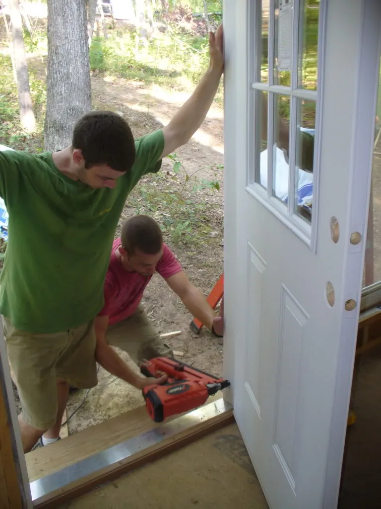

Pics from today.
our room 12x16
Coltons room 12x12
a days work
