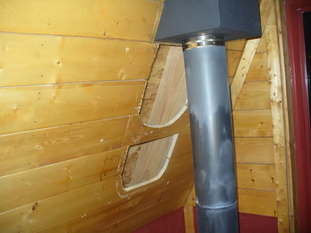

Eagles you might want to put hardy backer concrete board on the wall behind your Shield, that should stop any radiant heat that passes through!

I did one better. I cut out the wood behind the shield and now it has a nice cool breeze that fills the pocket from the cooler air behind the knee wall. And there is no wood left to burn. I did leave a small piece of wood so I would have something to screw into for my little spacers in the middle.
If you don't have one, smoke detectors are mighty cheap insurance.

On the chimney...
Removal of combustibles is good. But a piece of cement board or similar material, even solid brick, over combustibles is not recognized as proper heat protection. It may slow down the heat transfer but eventually with a fire burning long enough the same issues with wood charring will be encountered.
Note, NFPA rules do not permit fasteners through the heat shielding in the area directly behind the pipe. Fasteners and their standoffs should be off to the sides according to them.
But what you have there is much better than before. The air gaps are smaller than what NFPA calls for, but you have two of them. That may count for something. Do you have a means to measure the temperature behind the heat shields? Perhaps one of those indoor/outdoor types with the outside sensor on a thin cord could be used?  I have measured the temperature behind the heat shield in our gazebo. It never goes above 100 degrees while the metal itself gets to be blistering hot.
Also what is inside that chimney box? Does it pass through the wall with the rest of the box on the outside? Insulated pipe in the box? Any combustibles is what I'm asking.

I have 4 smoke detectors one on either end of the house upstairs and down. We also have 2 big (2 ft tall, 6-7" diameter) fire extinguishers just in case. Inside the chimney box is just a piece of triple wall pipe that extends out the ceiling. Even with a scorching fire you could put your tongue on it if you wanted. even the box itself never gets about warm. I could crawl back in behind the knee wall and take a temperature I suppose. I do believe that it is much better than before though for sure. But after seeing how quick heat can take its toll on wood that is too close I dont want to fool around anymore.

Aluminum is a great conductor of heat. That is why most automobile radiators and heat sinks are made from aluminum. I would suggest using steel to protect the framing from the wood stove. I would be afraid that the aluminum would conduct the heat too much back to the framing. This may not be an issue with the extra air space you have, but it would be a concern of mine.

Sorry, all the pictures don't load for me most of the time. Judging from the rosin flow out of the wood, you are about to light   :-\. This setup is not good. Can you slide over and go out where the window is?

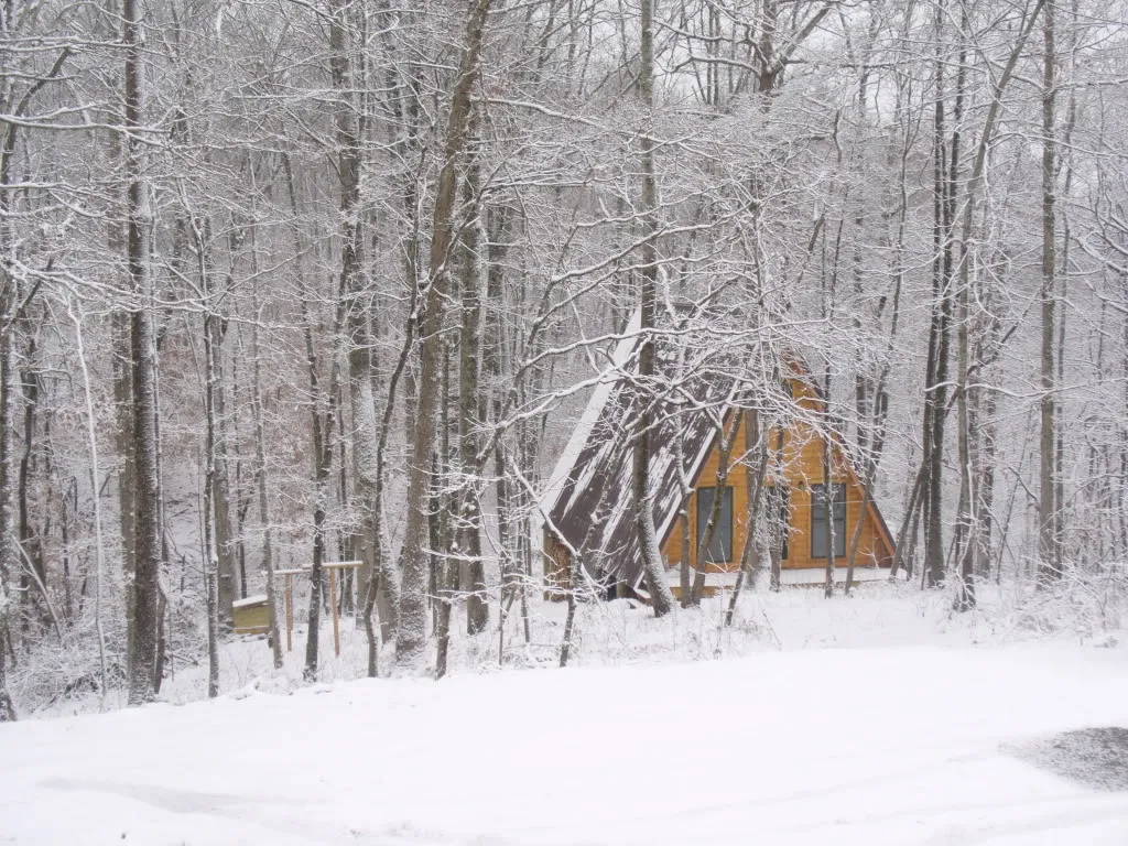

One nice thing about an A-frame is there's not a snow load to worry about. ;D  Nice pic
dollarcounter
That snow-covered exterior shot in the woods is beautiful.  It would be really great to see some interior shots of the upper level if there've been any updates.
