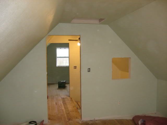

The wall painting is finished.  Still need to paint the trim on the window jambs.
We were expecting delivery of the oak floors today but it's been delayed until tomorrow.  I did a little sanding of the high spots on the subfloor and finished scraping up the last of the drywall plaster.  Also spent some time hanging some light fixtures and fans.
Ready or not...we move it at the end of this month.
