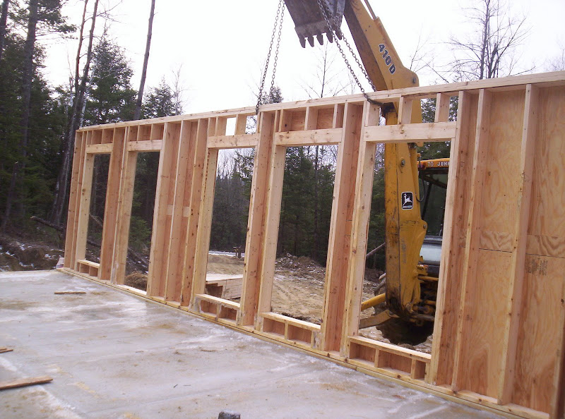

Backhoe worked great lifting the wall. No problems there. Runar nailed and directed me. We had to frame the wall a few inches off center because of the wood stove vent. The backhoe was able to pick up the wall slightly so Runar could push it over into position.
We framed this section without sheathing, then used a PT plate against the block and anchored it with 4" tapcon concrete screws. We sealed between the vertical concrete block and PT stud with sealant.
Since trusses will be going up next, we left some of the sheathing exposed to augment the end trusses and lend strength.
The west wall was framed the same exact way. I'll frame them for windows later.
Alternating the sheathing for strength

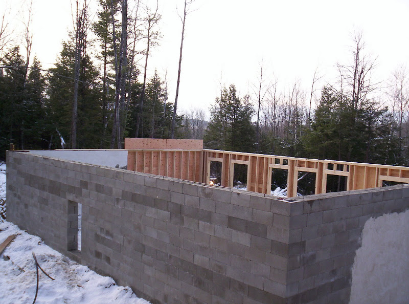

View from the driveway
This was taken after we mixed 20 bags of 80 lb concrete to fill the bond beam block along the top course. Runar mixed while handing me up 5 gallon buckets of concrete. Working in sections, we filled them half way, placed rebar, filled them, leveled them and then placed anchor bolts. We finished in just 4 hrs.
Applying the SBC cement went much better this time. The key is getting the right consistency. Its not like concrete, you have to mix it slightly dry and then give it 5 minutes to soak in and become thick and wet. Then trowel it on. The new area below took an hour to do.
Earlier today I set the PT plate since the bond beam block course had set. I measured where the anchor bolts protruded and then drilled holes and grinded off any showing above the plate.
A view of my SBC progress and midway through my top plate placement.
The PT plates for the first 16 ft of the back wall.

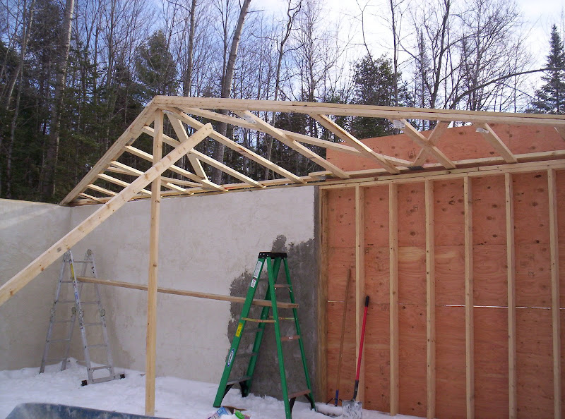

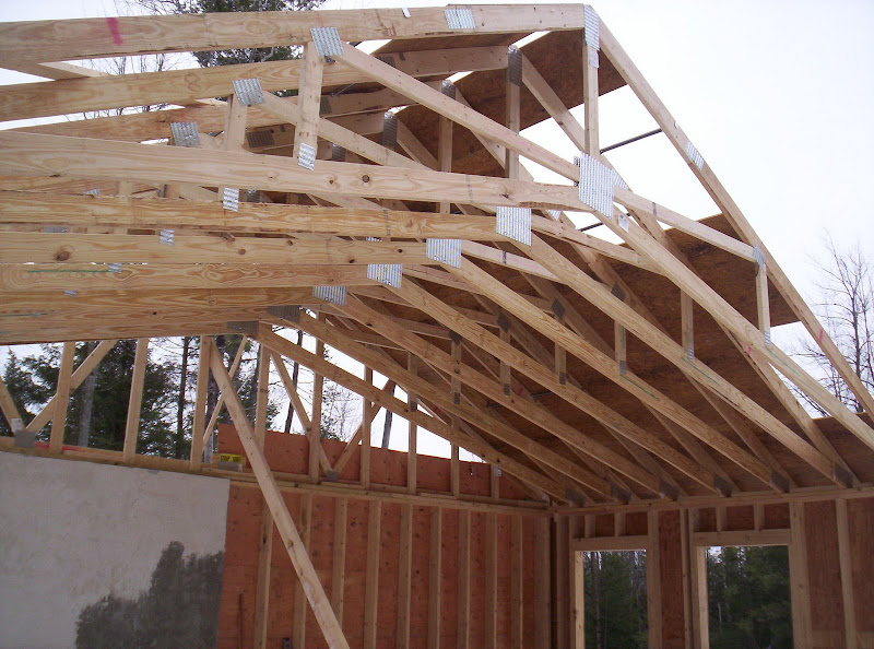

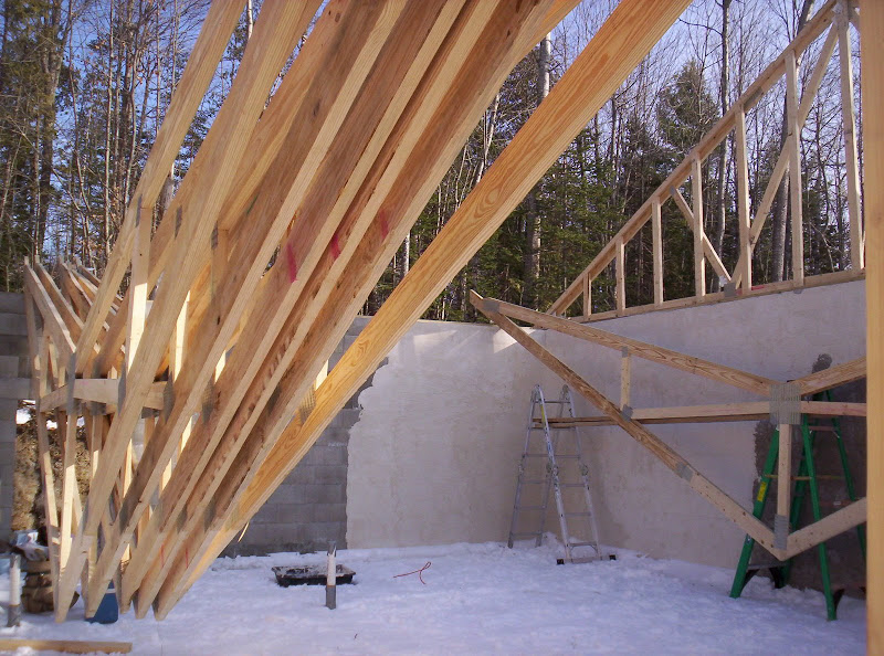

8 trusses were delivered this weekend and I had Sean and Runar help install them. Definitely a 3 man job. It was hard work. This is how we did it:
We brought the trusses in upside down so they'd fit through the doorway and sat them on the ends of the walls so they'd be ready. Next a 20" 2x6 was nailed to the top plate next to the OC marking. Then me and Sean got up on each end and held the truss ends while the strong guy (Runar) flipped the truss into place. Note: You get a sudden pull from the truss as it wants to slide away from you. Around a 50 lb sudden jerk. But one hand is enough to do it. Then when its flipped up, you take the metal truss bracers and lock the previous truss with the new truss, then nail the baseplate in place, then the bracers in place.
There's about 2" of snow and ice on the slab now. I want to get this shelled in before we get a big one. We're racing against the clock now. Crossing my fingers on this one. I just ordered the other 13 trusses so we're gonna go for it this weekend, that is, if mother nature will wait one more week for me.

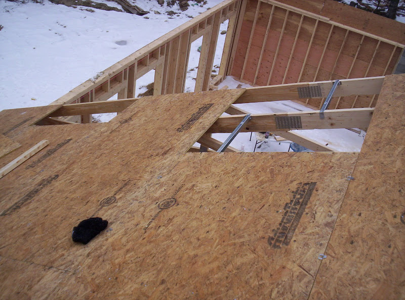

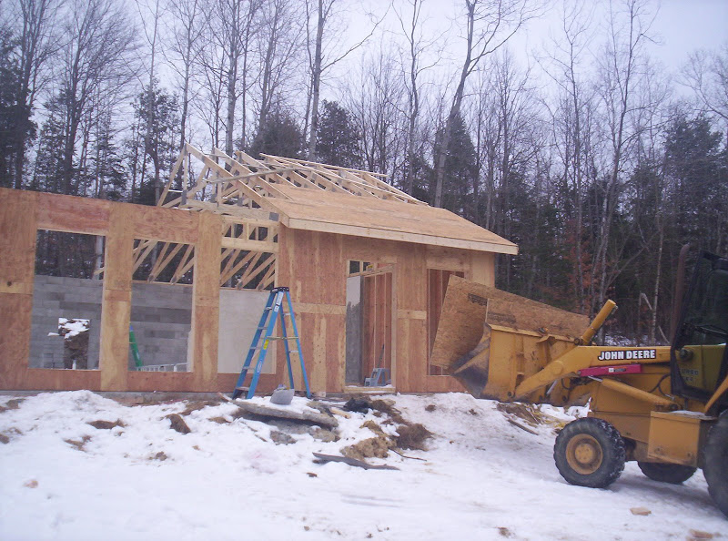

I used the backhoe to lift the panels up
Staggering the sheathing for strength.
This is the easier way to lift sheathing up. Don't get me wrong, this is still a dangerous job, especially alone.
I can really feel the extra height the scissor trusses give me. Its going to feel very open. At $118 a truss each, there is no sense in making them yourself. The metal join plates would cost roughly $30 alone.
