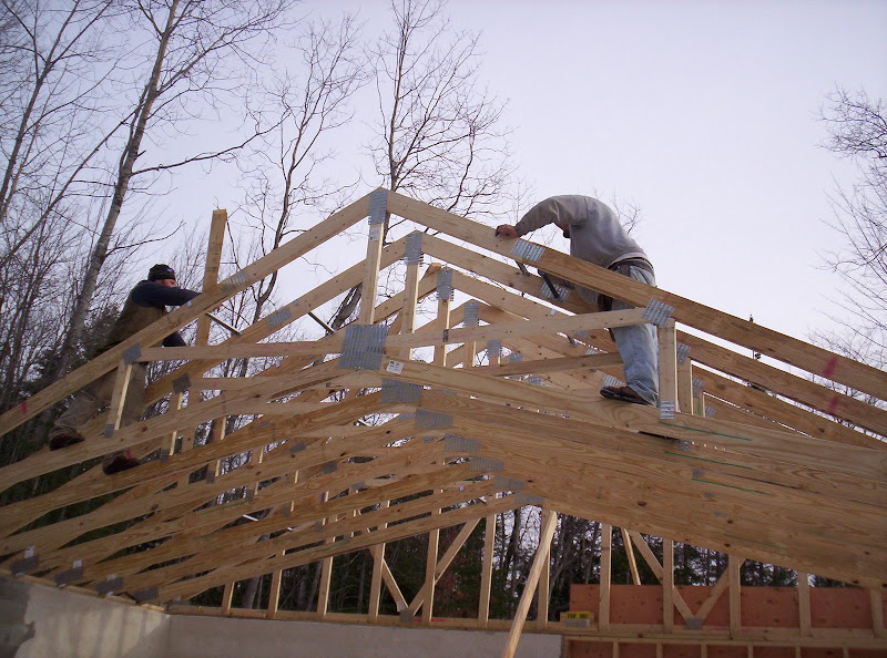

I am concerned about something and wanted to ask what you guys thought. What if Sean or Runar fell while putting up one of the trusses. God forbid. ( Don't worry they haven't ). But still if they did, at first they may not think of suing me, but after a while, if they have to miss work, they may.
Does anyone know of any insurance plan that will cover something similar to "workmans comp insurance"?
I just prefer not to take a chance if I can. Especially with dangerous roofing work.

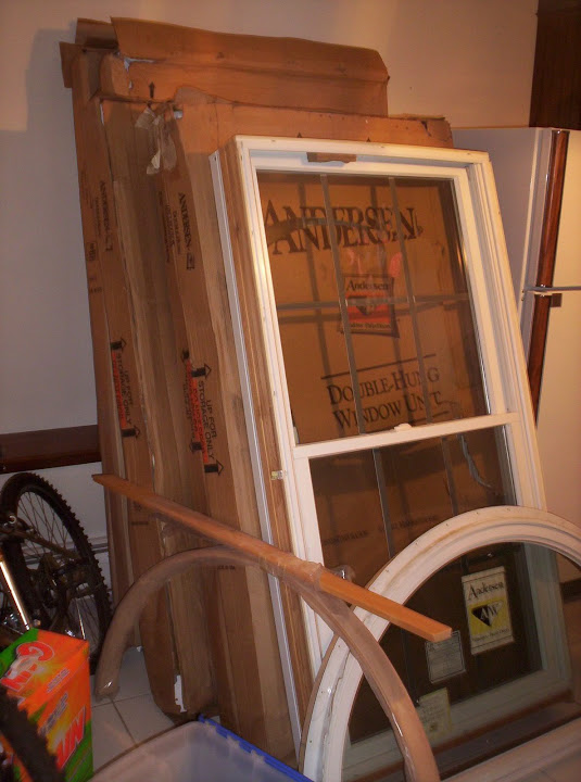

I'm picking up 5 Anderson Series 400 windows, still new in box, for at least 75% off retail price tonight. All 5 for $500.  One of them is a 4 ft , half round window which I'll likely put on the east side in the gable end. I think it will come out beautiful. Couple that with the 3 other windows I bought off craigslist for 50% off retail, I'm going to get all my windows for under $1200. I'm pretty estatic.

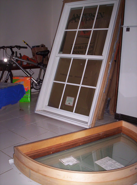

Got the windows tonight. 3 of the 4 still new in box, 1 not in box but like new ( few scratches ). The 4' half round came with unstained wood interior and 2x6 wood jamb. I spent $231 for each of the 3 new Anderson 400 Casement 6x3 windows earlier this month. There is a 5x6 Anderson 400 picture window Im considering also for $225.
I'm almost done 'window shopping' ;D

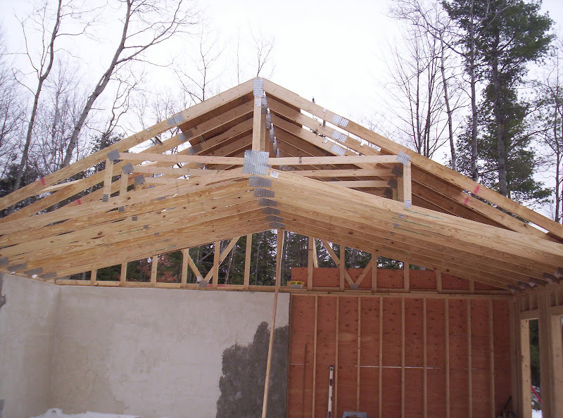

I might not have to modify the gable end support beams to fit the half round. It looks wider than 4' in this picture.

Are the guys tied off while doing the roof work- might be worth looking into.  I had a slip on a job site once and the saftey harness saved me from a possible bad situation.  They are a pain in the butt- until you need one that is.

Skagit, since the danger is most likely in tying the trusses together, there isn't much structural support to tie onto. I'm not worried about it during the sheathing because its 6/12.

These guys are up pretty high.
