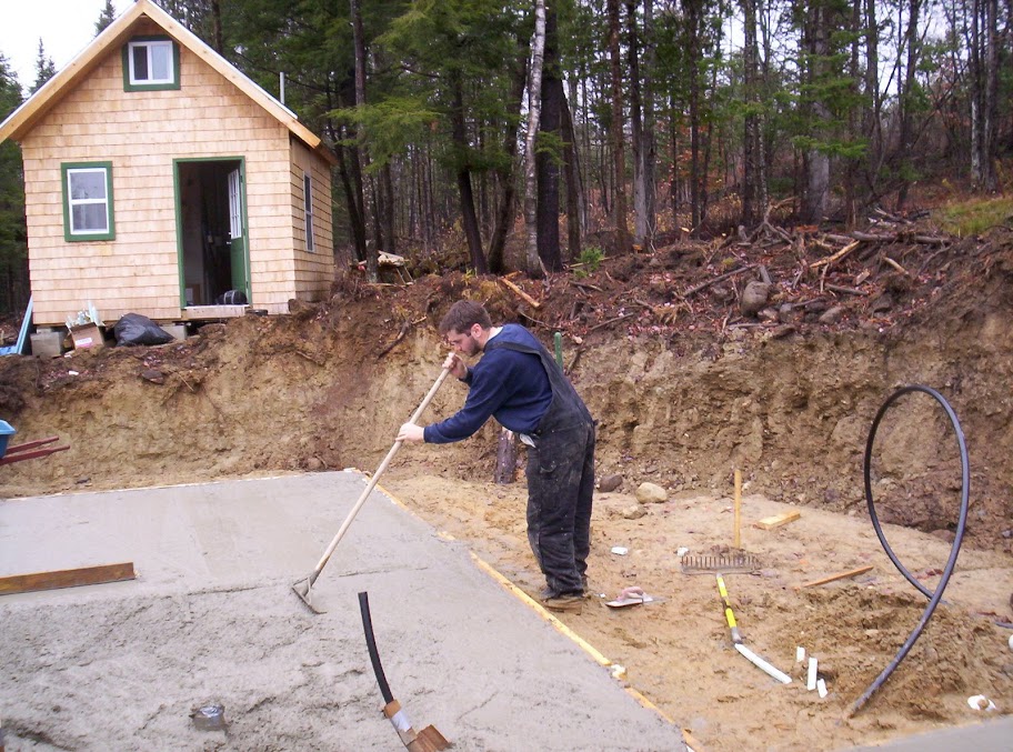

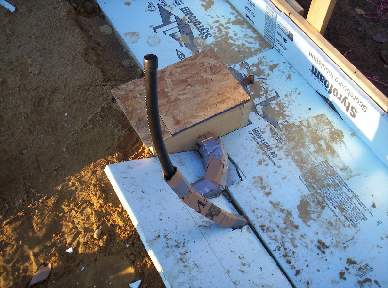

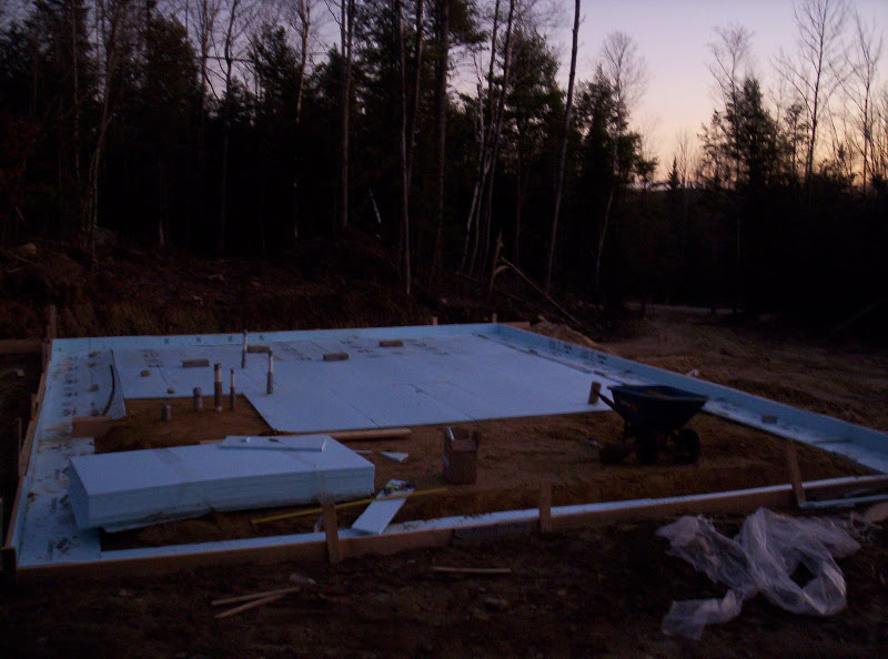

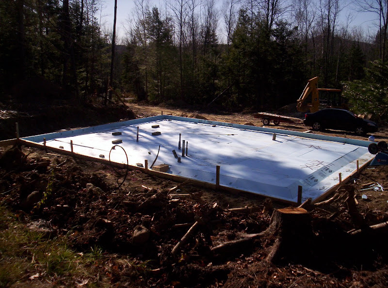

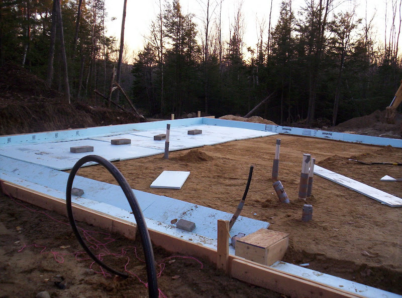

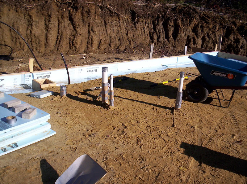

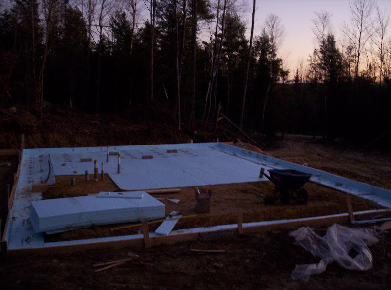

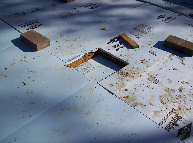

Got the plumbing covered up and wrapped with cardboard

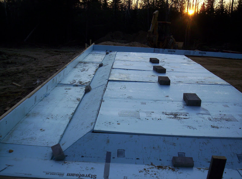

Then leveled/tapered the sand pad and laid out the polystyrene foam insulation

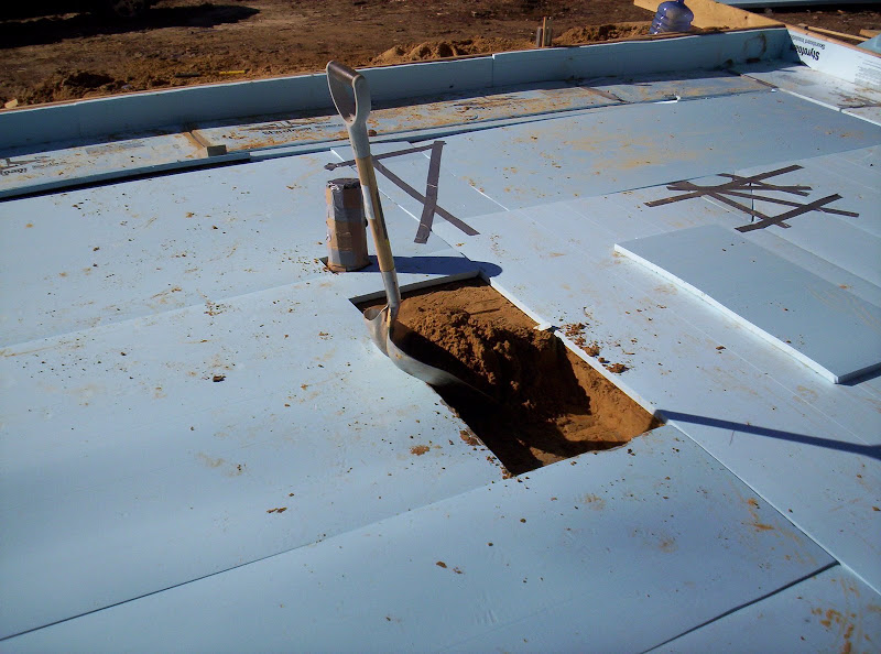

Then dug the recessed holes for a support column and the fireplace

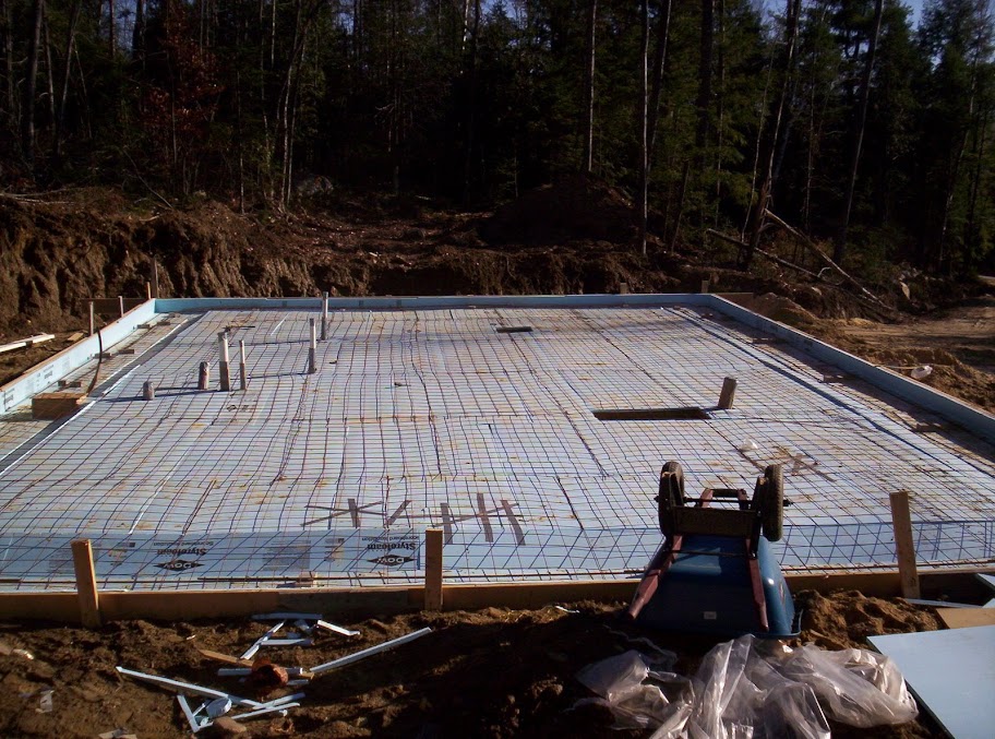

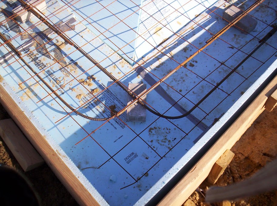

My friend told me a trick for bending rebar, just stick it in the bucket holes and pull.

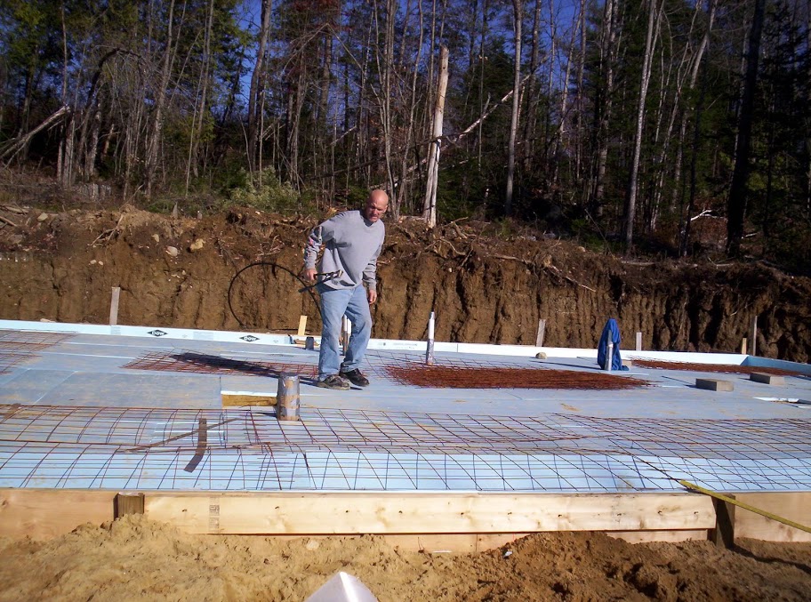

Eric came down and helped me with the rebar. I tied while he layed out the mesh.

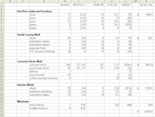

I've been trying to get an estimate of what it will cost to build/frame the first floor since its the next task ahead.
Its quite possible the project will be over/under $10,000 for foundation and first floor done. I'm estimating it will be another $10,000 to get the 2nd floor on, trusses purchased/raised and metal roof installed. I'm pretty happy with that overall price though for a 2200 sq ft house shell.  That would put me in the $9 per square ft range.  It could be as high as $25,000 for the whole shell but we'll see. That would still put me in the low $11 per sq ft range.

BK, I have a question regarding the column and the fireplace.  I see it looks like you are putting foamboard in the footing even in the fireplace and column load area.  Since it is a point load and not so much a spread load as a continuous footing would have, have you checked the foam to see if it's bearing capacity is sufficient for the load on it?  Or would you want to remove it in those sections.
I don't know - maybe it's fine -- just wondering if it is calculated.
Bishopknight
Thanks Soomb :)
Glenn,
Good point, its only 25psi insulation there. Maybe I should remove it in the fireplace and column footings altogether since I don't have extra 40 psi insulation. Granted, I could steal a little here and there from the footings if I wanted to.
Your thoughts?
Either way I should have a vapor barrier where any concrete meets sand because of moisture absorption.
A piece of 6 mil plastic would be fine.  The foam will crush and allow breaking of the concrete in my opinion.

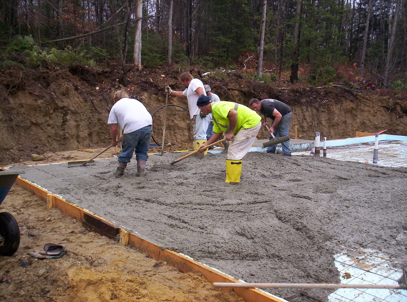

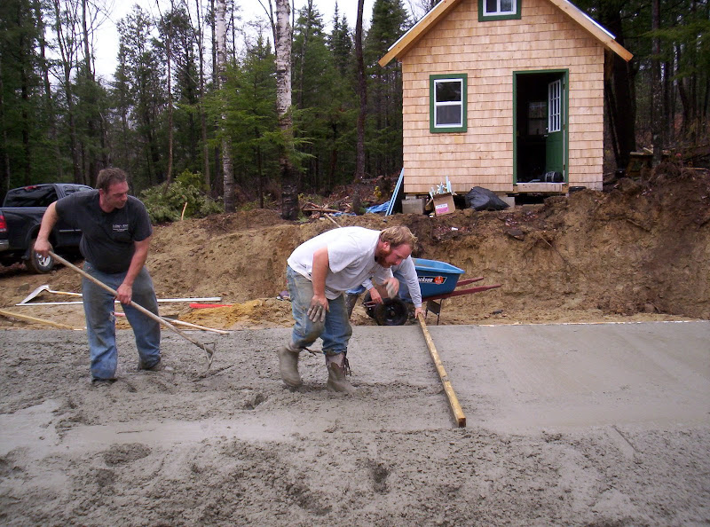

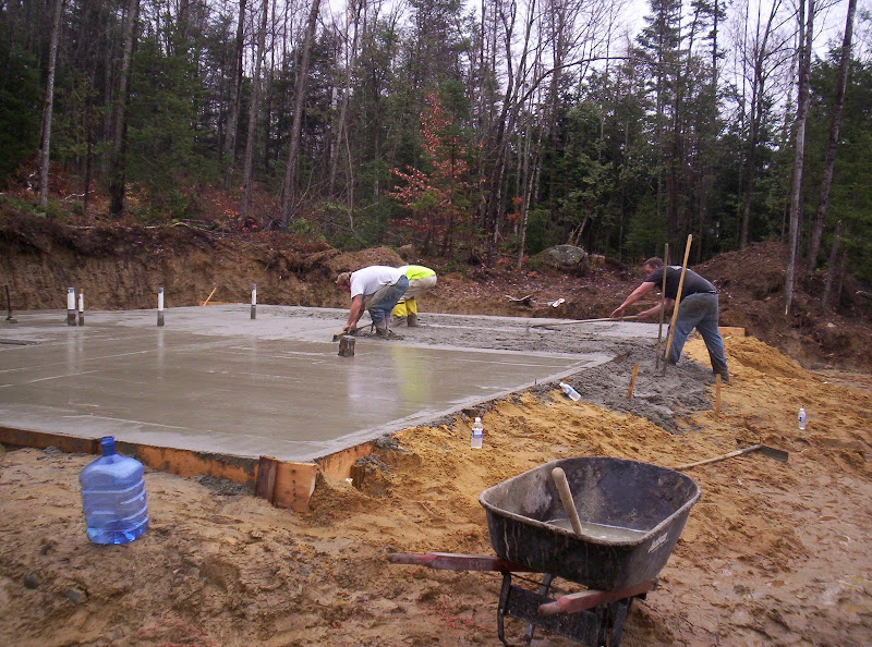

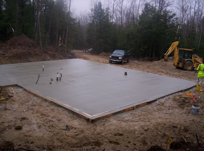

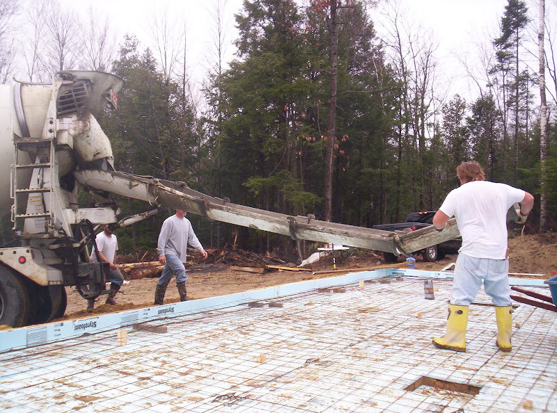

Did a few prep things friday and poured the 20 yards of concrete this morning. Hired a professional crew to do it. Everything went great. It was 60 degrees out thankfully. Only a little misty but we added calcium to speed up the curing.
They made fun of me for doing the "creme" (pictured below). That's where you shake the top of the "crete" to push the rocks down and make it smooth on top. Obviously I helped the entire time but when I got tired, I did the "creme".  ;D
Of course, I felt obligated to feed the troops and apologized for hotdogs not being very healthy, to which they replied, "Do any of us look healthy to you?" LOL
And here is the finished product. I was exhausted and soaked and the crew told me my boots will be ruined in 2 weeks because of the concrete seeping into the linings. You can see the wooden keyways I installed which will secure the concrete block to the slab later.

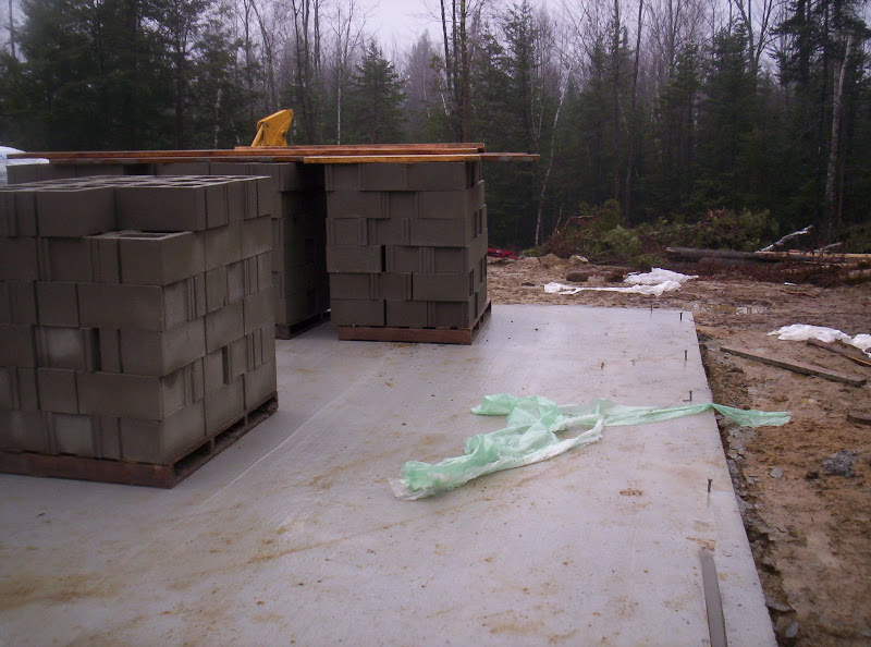

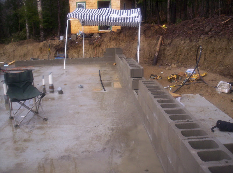

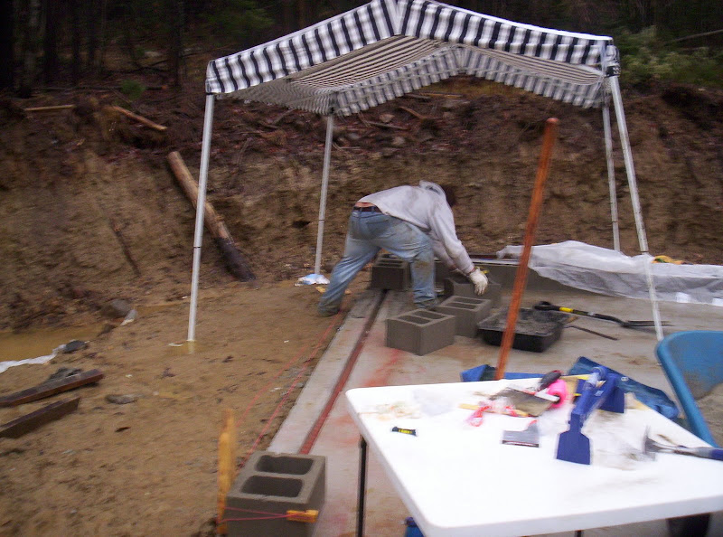

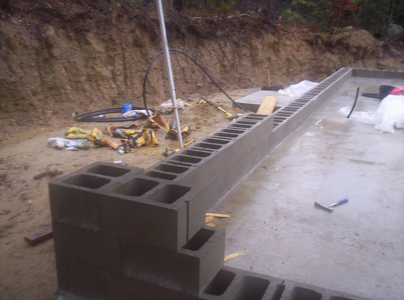

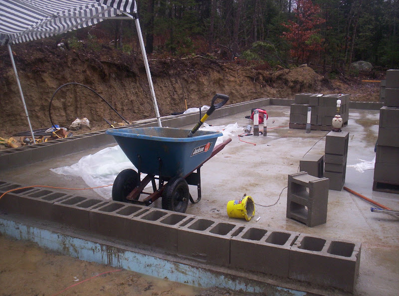

I ordered the concrete block for the back berm wall this weekend. I drove up friday morning to meet the the delivery truck. They were kind enough to gently place them on the slab. After that, I stripped off half the forms and got 2 blocks set before It was too dark to see.

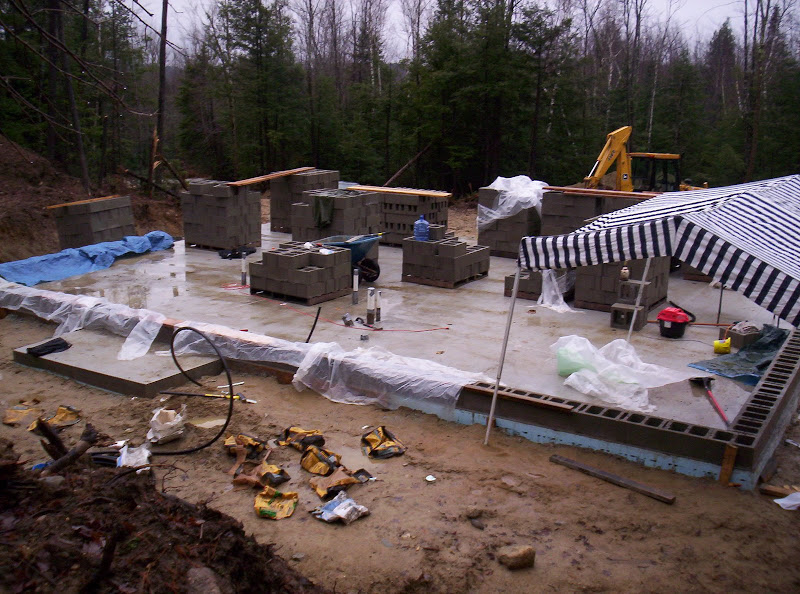

Saturday morning, I had some help arrive. He helped me lay the first course to the slab. I mixed mortar for runar as he leveled the block and I mixed the crete and filled the block and keyways working behind him.  This was the rainiest day of them all. I'm glad I got some help for this step, it was crucial to have a good first course. We covered all the block overnight with tarps/poly.
Sunday, the rain wasn't as bad. The first course had set strong enough overnight for me to start laying block.

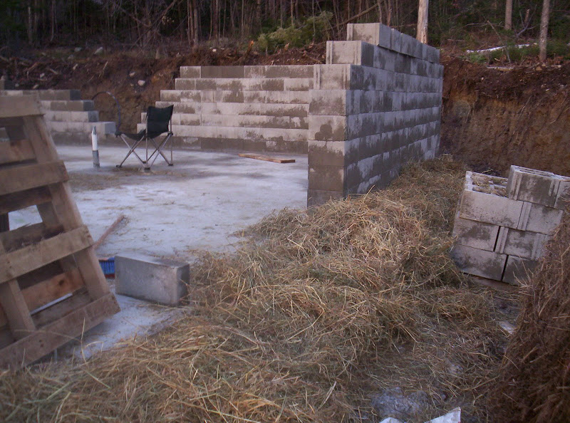

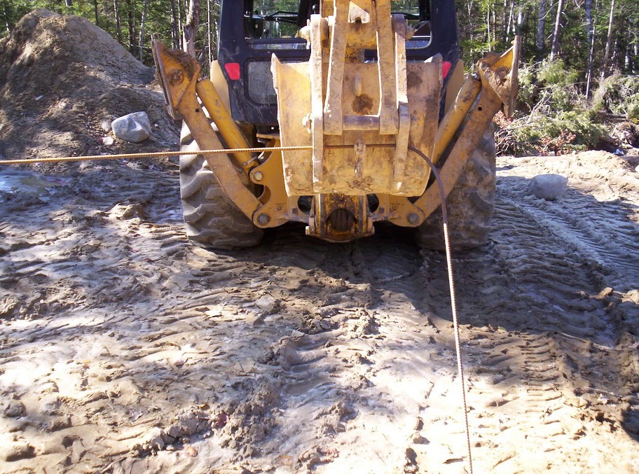

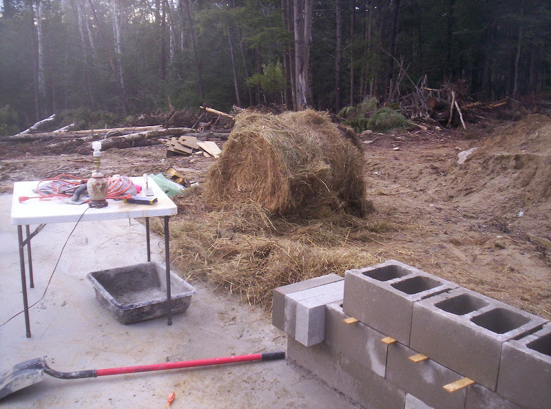

I used the backhoe and forks to go grab 2 bushels of hay from my neighbors field. I used a shovel to shred it apart and lay hay around the foundation perimeter. It will protect it from frostheave.

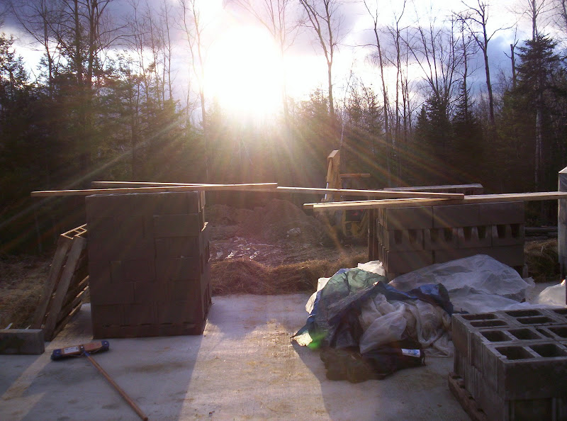

The sun finally came out so I took a pic. You can see all the saved footer boards I'm having mother nature wash off for me.

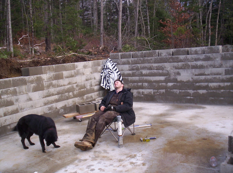

I was really tired, sore and hungry at this point so I called it quits at 4pm on sunday.

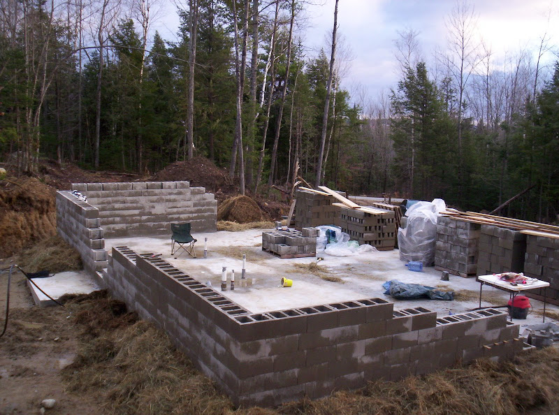

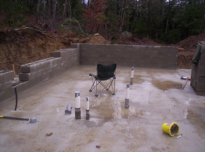

Here's what it looks like now.

Nice, I was looking forward to reading your update all weekend.  How much as all that block if you don't mind me asking?
Looks good, BK.  Are you mortaring all joints the coming back to grout the walls in later?  Rebar in the block horizontal and vertical?  That will be retaining wall and could have a lot of force against it.
Bishopknight
#45
Thanks guys.
The block order came to $1609. $165 of that is pallet charge, which I'll bring back. Delivery guy said it was a 75 ton load. Driveway held up good though.
No vertical rebar Glenn. Just a cemented keyway to 'lock' the first course to the slab. Surface bonded 'structural skin' cement ( reinforced with 1/2" fiberglass ) for both sides. And a top course of channel block filled with horizontal rebar, crete and anchor bolts.  This is per Rob Roys instructions in his book, Earth Sheltered Homes. I took a screenshot of why dry-stack surface bonded cement construction is so strong.
With 8" wide block, I would need reinforcing pillasters but with the 12" block, I should have no worries. To a lesser degree, there are also 3 interior walls bracing the middle.
Looking ahead to the coming weeks, finishing the block wall next weekend is my goal. After that, 2x6 framing will begin, weather permitting.
The reinforced surface bonding will take care of a lot of issues.  I don't see a problem with that.

I didn't think you would since you're into alternative building methods. I just wanted to mention it though because its unconventional. Plus I had a union block mason curiously drive up to my house this weekend acting very shocked I wasn't mortaring the block.
Also, the person I hired saturday has never done a dry stack surface bonded cement wall either.  I'm going with Rob Roys word and my common sense on this one.
