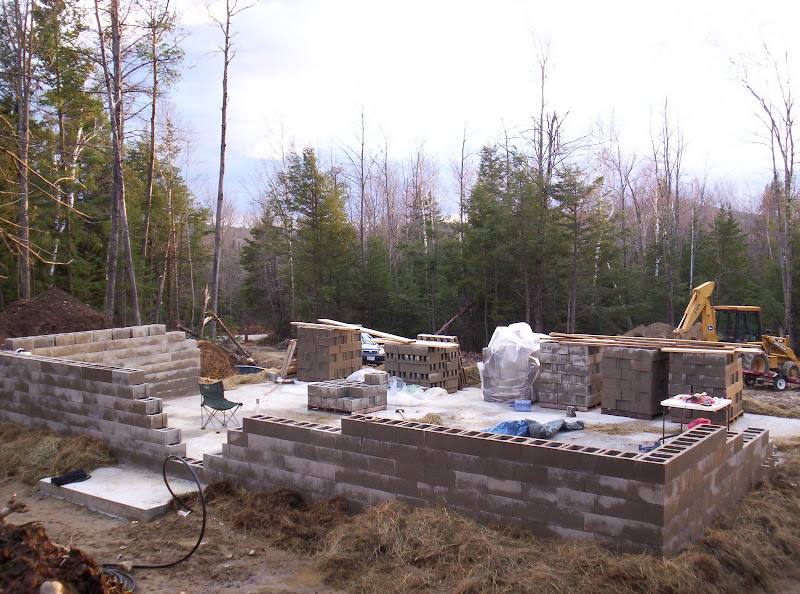

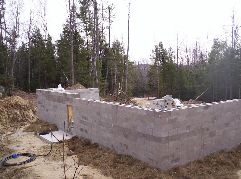

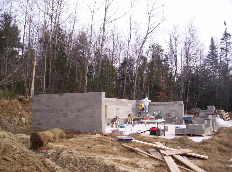

Here is another angle of the current progress
PA-Builder
Your walls are looking good!  Are those blocks specifically designed for surface bonding ?  It look like you are using 10" blocks ... are you aware that there are L corner blocks available so that you keep the proper 8"/16" spacing after turning corners??? Might make the project a little easier.
Bishopknight
#52
Thanks PA,
They're 12" block. Its hard to tell in the pics. Personally, I would never touch 10", I heard they're hell to work with. I planned the backcourse for ease by alternating the corner blocks 90 degrees. I'll have a small opening for the root cellar in the back but I'll use bond beam block and rebar to provide overhead support for that doorway.

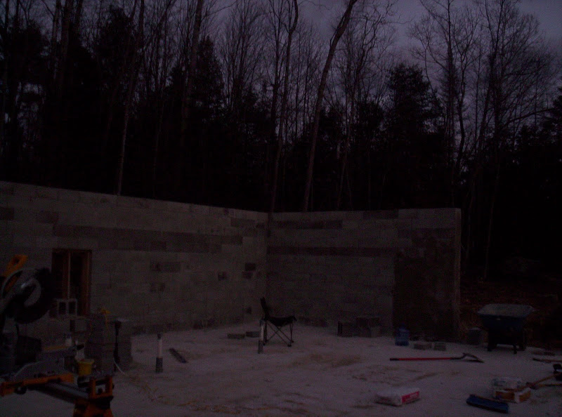

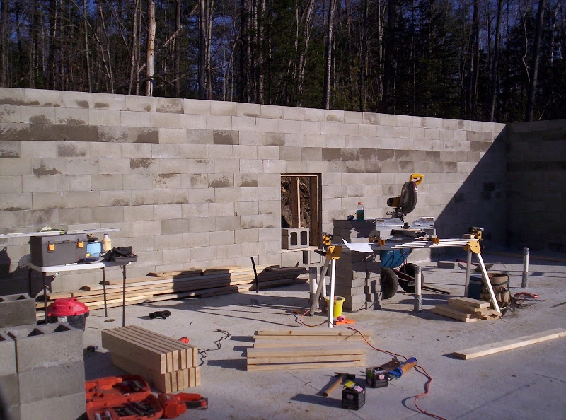

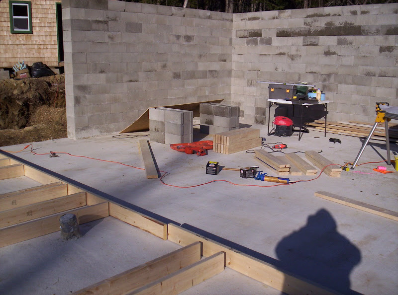

Some new pics from Saturday and Sunday. 17 - 25 degrees all weekend, below zero with windchill.
We finished leveling, shimming & dry stacking the berm wall saturday.  I used a ripsaw with a 7.25" diamond blade wheel to cut the concrete block. It did a great job.
For the root cellar opening, I used 3 course of bond beam block with rebar and concrete inside it. I also applied a half bag of SBC structural skin to one corner.

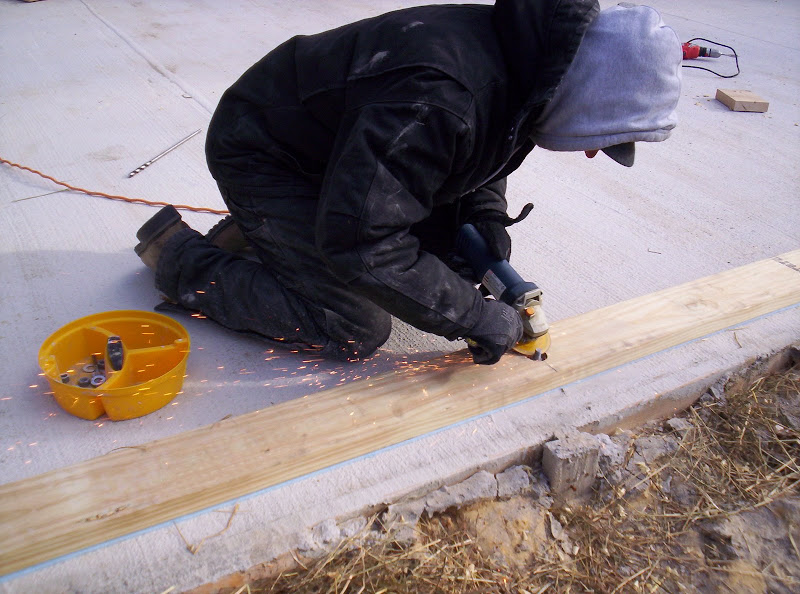

Sunday we measured and ran the chalk lines for the south facing wall and sides. Then anchored the PT sill to the slab via the anchor bolts and cut off the tips with a 4" metal grinder blade. We decided to frame the whole front as one single side. I'll use my chains and the backhoe to lift up the wall. It probably already weighs about 800 lbs.
Camera died around 2pm. We got the whole front framed by sundown. Later in the week I'll sheath it and start on the next walls. I still have to skin the block wall and rebar and cement the top bond beam block course. I'm going to have a yard of concrete delivered for that.

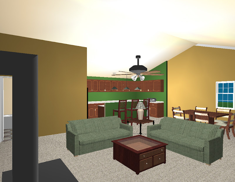

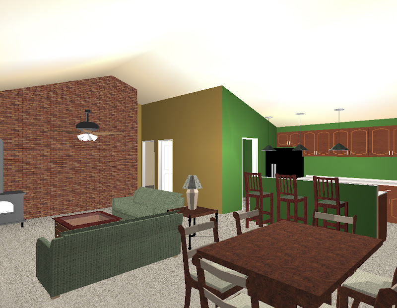

I'm still going back and forth on 1 and 2 story. I played around with 3d studio architect today and came up with a nice layout for the 1 story.
Notice the usage of scissor trusses to give me a cathedral feel inside. Scissor trusses don't need any support column bracing either. Wide open floor plan in otherwords.

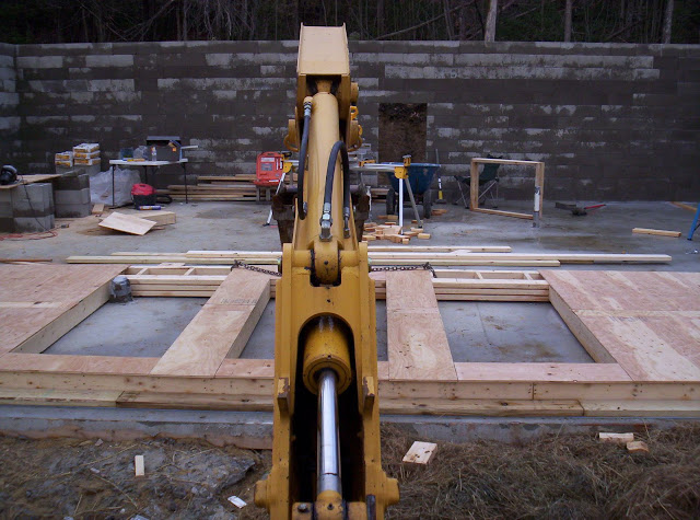

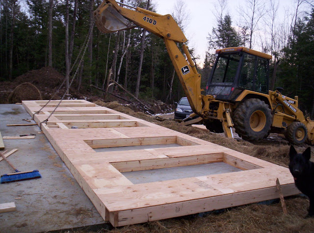

Thanksgiving Update:

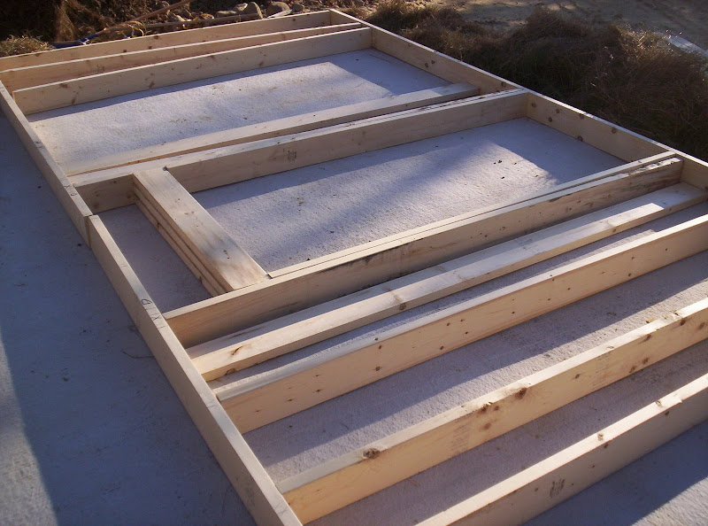

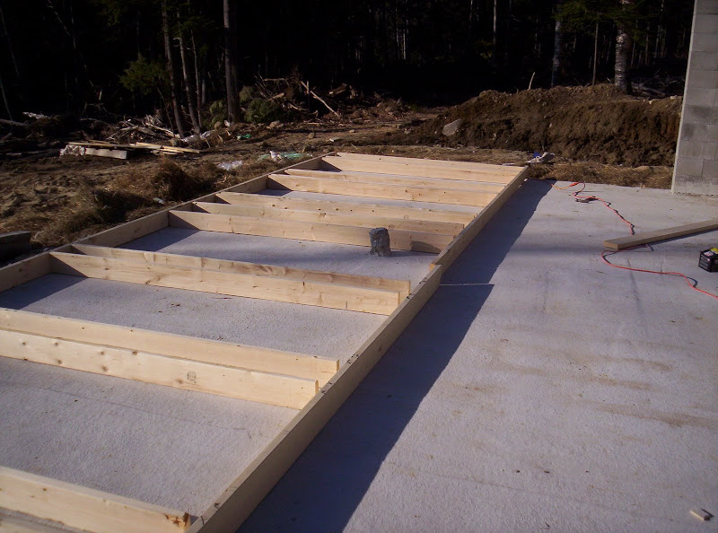

This morning I sheathed the framed front wall on the ground. I made sure to cover the top plates with the shealthing and also leave an inch for the bottom sill plate as well.
Then I rigged up the backhoe to hoist it up when Runar gets here tommorrow.

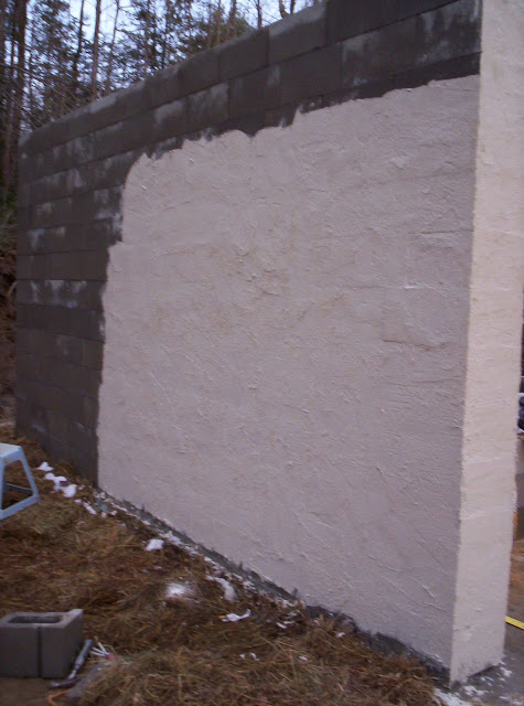

Lastly I spent about 2 hrs applying 1 bag of SBC to the west wall corner and back. It is not as easy as I thought it was going to be! Mixing it is 3x as hard as concrete and getting the perfect consistency where it doesnt run down the wall yet still glide easily is an artform. Its definitely a wrist workout. You also lose some off your trowel so I now use a board underneath to catch the drops and put them back in the tray.  At $17 a bag, you want to save any drips.
BK I have never done what you are doing but I have done a lot of parging and it seems to be the equivalent in the process.  I have found that if you use a float trial 12-14" X 6" and start at the bottom at a 45 deg angle laying the mortar until it feathers out.  Then reload and make a second pass adjacent to the first.  Then re-load again and take the first a little higher then the other section alternating as you progress to the top.  That blends the section together rather than going all the way up at one time.  Seems to bond to each other better and the edges do not dry.  Occassionaly I will start at the bottom of each run loaded but not at the same angle to lay a skim over and smooth out what you previously done.  It is easier if you have a regular trowel to load it onto the float off of a square piece of ply.  I use a metal 55 gal lid.
With mortar in warmer weather you have to dampen the block or the block will suction the water out of the mortar leaving a real rough texture which does not bond well.  But from the looks of you rain soaked wall and the drop in temps you shouldn't have that problem.
What is the recommended thickness of the application?
I use a hawk, BK working similar to what John mentioned.  I load it pretty full and even use it to start at the bottom tipping it toward the wall as I go up- using it as an applicator or applying with a swimming pool trowel- pushing an appropriate amount off of the hawk as needed.  I like it as it is flexible and has rounded ends to not leave marks as bad.  I run the hawk under the trowel as I work, fairly tight against the wall to catch spills.
I found that one of the big mud mixers maybe about 8 inches round or rectangular (like for powdered gypsum drywall mud) in a 1/2 inch heavy duty drill mixes better in a tub than it does using a cement mixer and having all of the mess to clean all of the time.  Much faster and mixes the fibers better too.  I use a Makita 1/2 to power it.

We got the main wall raised today. The backhoe did a great job lifting it.  I decided to go one story. Reason being, I would rather build a 2 story on waterfront property, then rent this house out for income in the future if I have kids someday. This whole house will cost between $12,500 - $15,000 to frame/shell it and get it out of the elements.  Thats includes my costs of hiring Runar and the pour crew.
It snowed 2" today, which means everything slowed down considerably. The ice on the slab became slippery with the snow flake on top. I fell once from tripping over an anchor bolt and almost a few times on the ice. Runar hit his thumb a few times with the hammer so I heard the usual swears ;D
I decided to just sheath the east/west walls for now since I've going to buy Anderson 400 used/like new condition windows on craigslist for a quarter of the price retail. Until I know the rough openings, its better to hold off. I already got 3 on craigslist last week for the front that saved me 50% off home depots price. They are 6'x3' casement Anderson 400s. High SHGC too. (Solar Heat Gain Coefficient )
I'm going to order trusses this monday from a truss manufacturer in Saco, Me called WSI Truss. Hopefully they can get them built and delivered next saturday. I'm considering 6/12 pitch scissor trusses. The nice thing is, they will fit right through the front door upside down and are only 109 lbs each. I'll probably get Runar and his friend Sean to do them, and I'll stand in the middle with a 2x4 to flip the trusses up vertical.
But first I need do a few more things this weekend. Fill the bond beam block course with rebar, anchor bolts and crete tommorrow. Then parge more SBC on the block wall. Thats alot of hard labor for the next 2 days. If I can atleast get the bond course done, I'll be satisfied.
