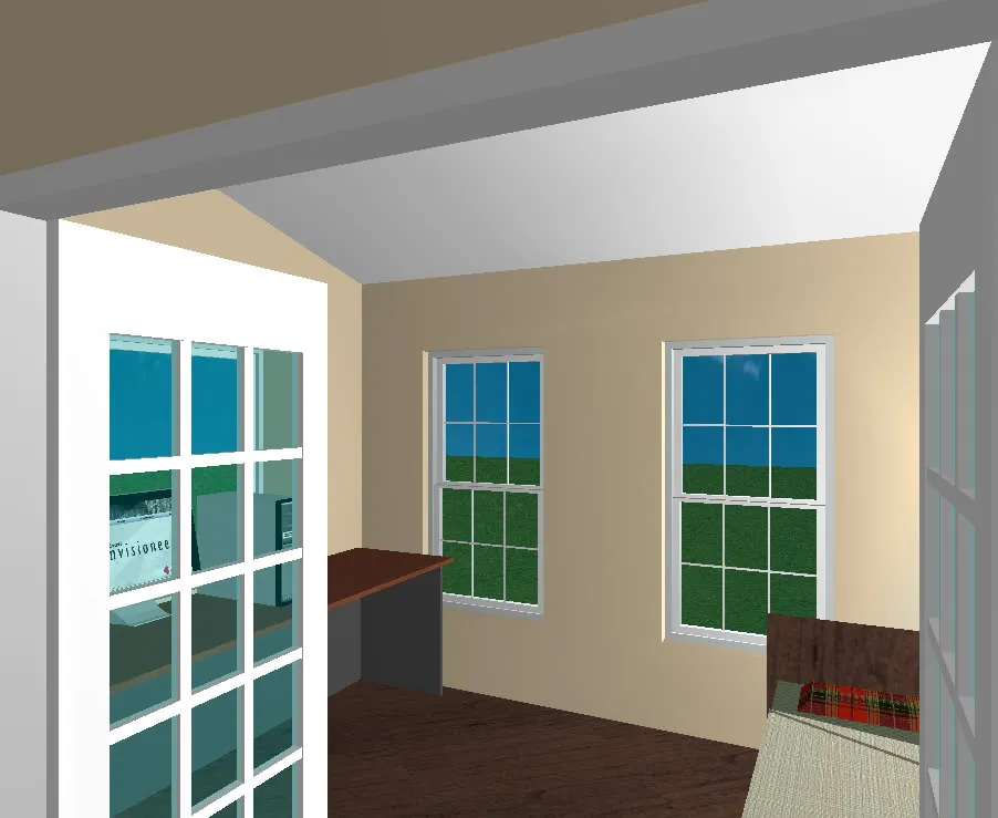

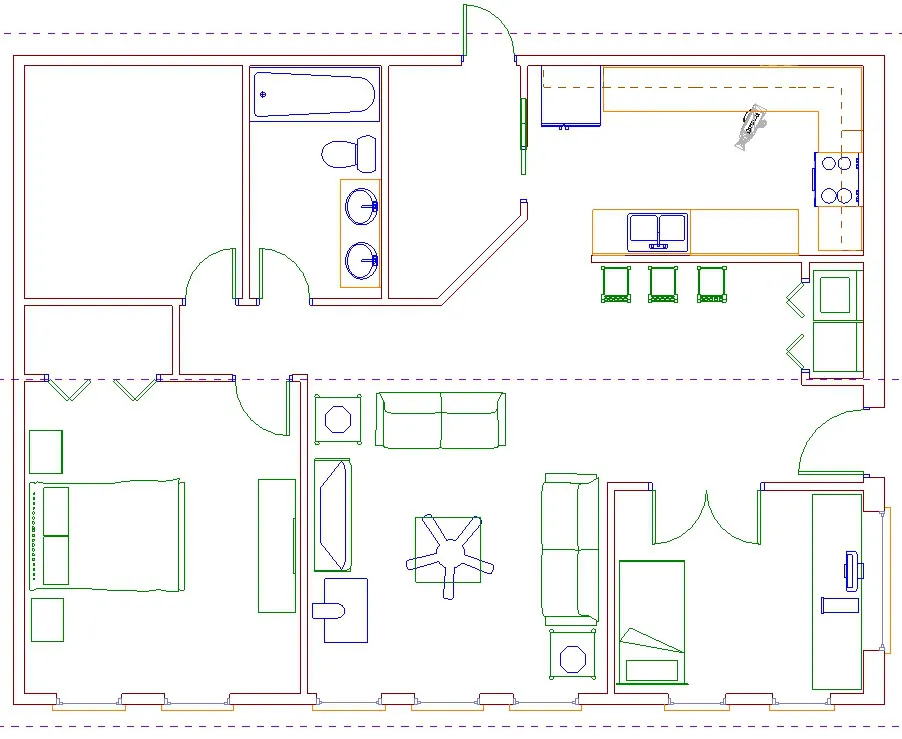

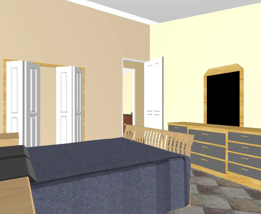

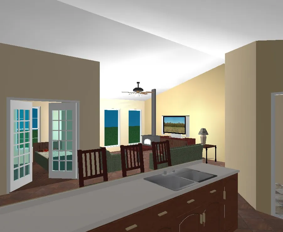

I changed my floorplan a bit today. Here are some screen captures. Its not set in stone but I like this layout.
View from Kitchen
Master Bedroom
Office
MaineRhino
Looks good BK. I especially like the kitchen pantry and rear access into the earth-cooled food vault!  [cool]
I would think about making the bathroom with one sink, building a corner cabinet for towels, etc.....
Does your sink have to stay where it is? It looks like it may get in the way if used much as an eat-in kitchen.
Bishopknight
I was thinking about that MaineRhino. Theres pros and cons to both sides. As a guy, I tend to keep a dirty sink  ;D
Either way, I have some flexibility with the DWV piping for either sink.

What program did you use for your layout?
Live- Phoenix, Relax- Payson
Bishopknight
Hey Soomb,
3D Home Architect Design Suite Deluxe 8.
