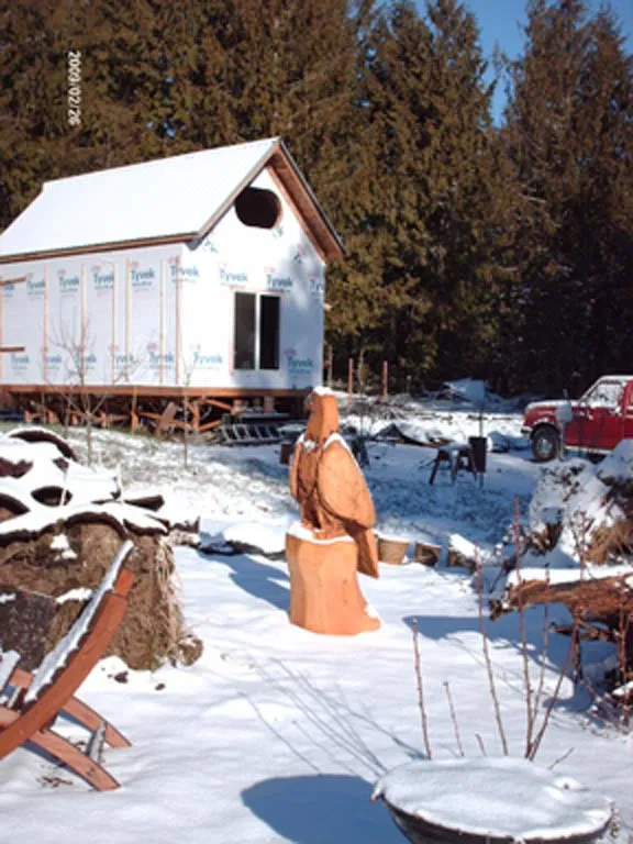

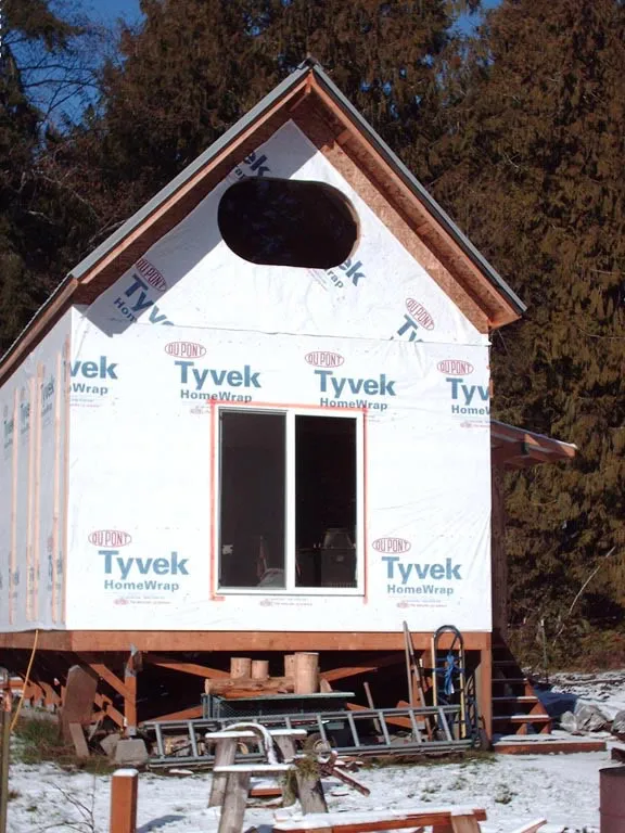

Let there be light!
Now I can start the upstairs flooring!  Yup, it snowed again last night.  This has been the snowiest winter here since 2000.  Fascinating.
