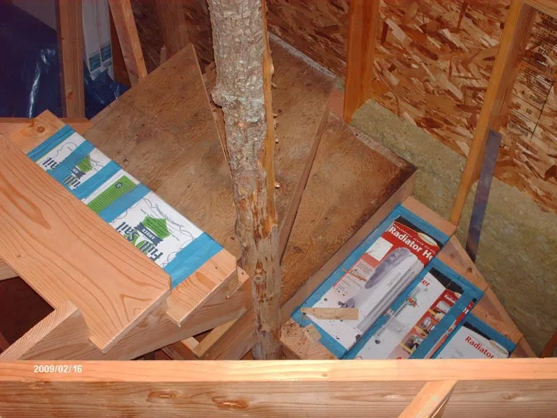

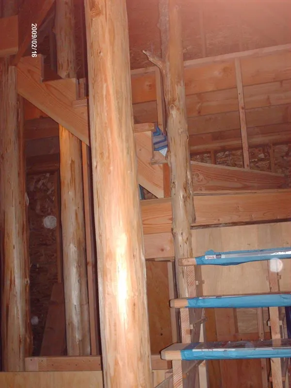

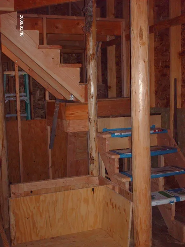

The stairs have been an agonizingly slow process, but a few more days and they will be done....except handrails and other frufru.
Yep the winders are temporary 3/4 ply...but not for long!  They are amazingly natural to walk, I was worried they'd feel weird or cramped.
Life keeps taking up all my time!   :D
Dog
Wow! Those stairs look awesome!  :)
