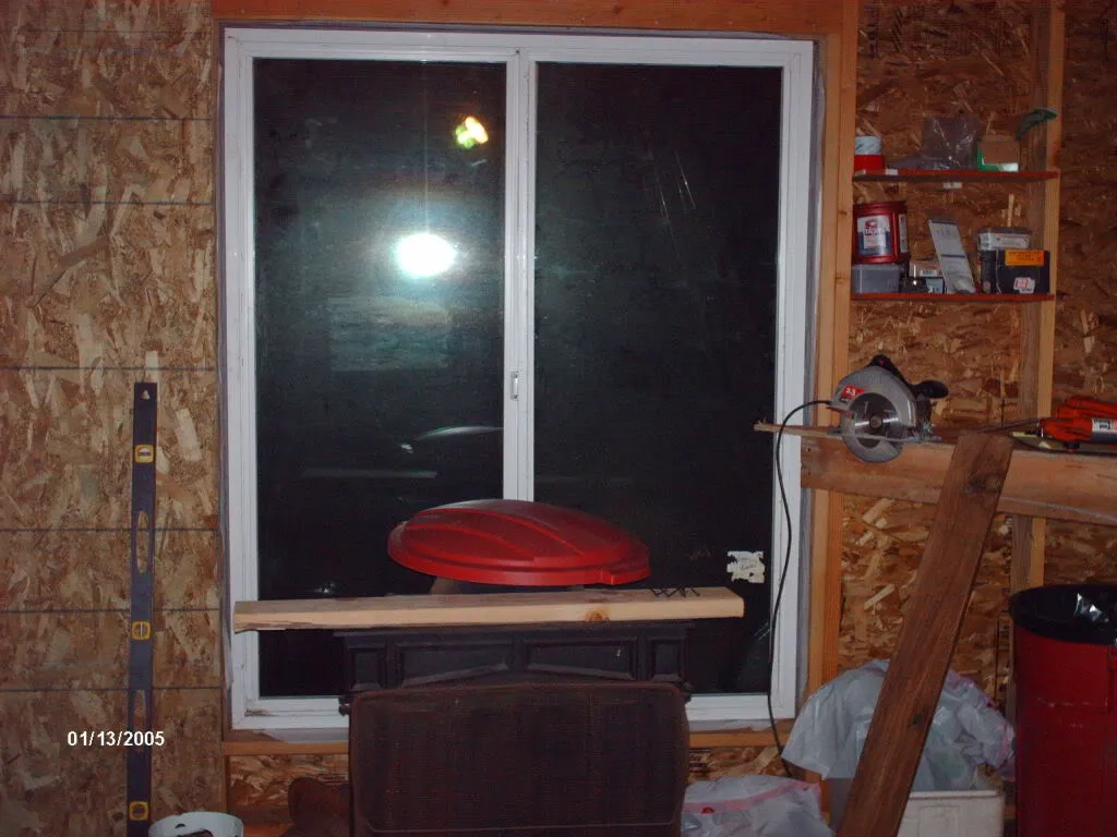

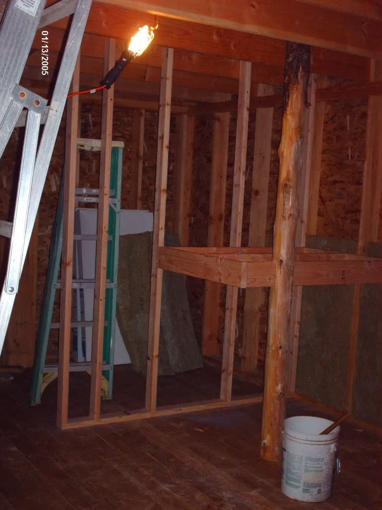

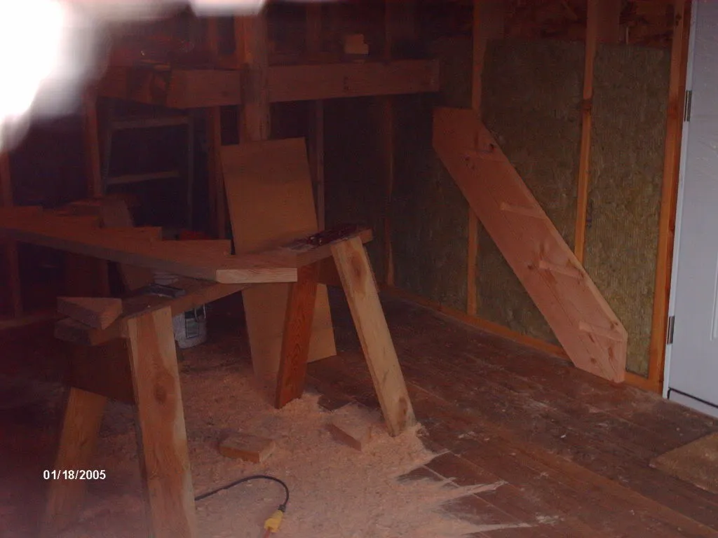

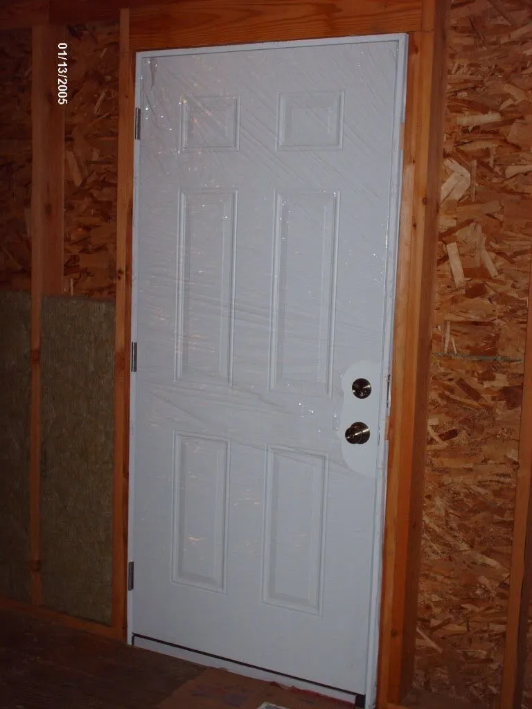

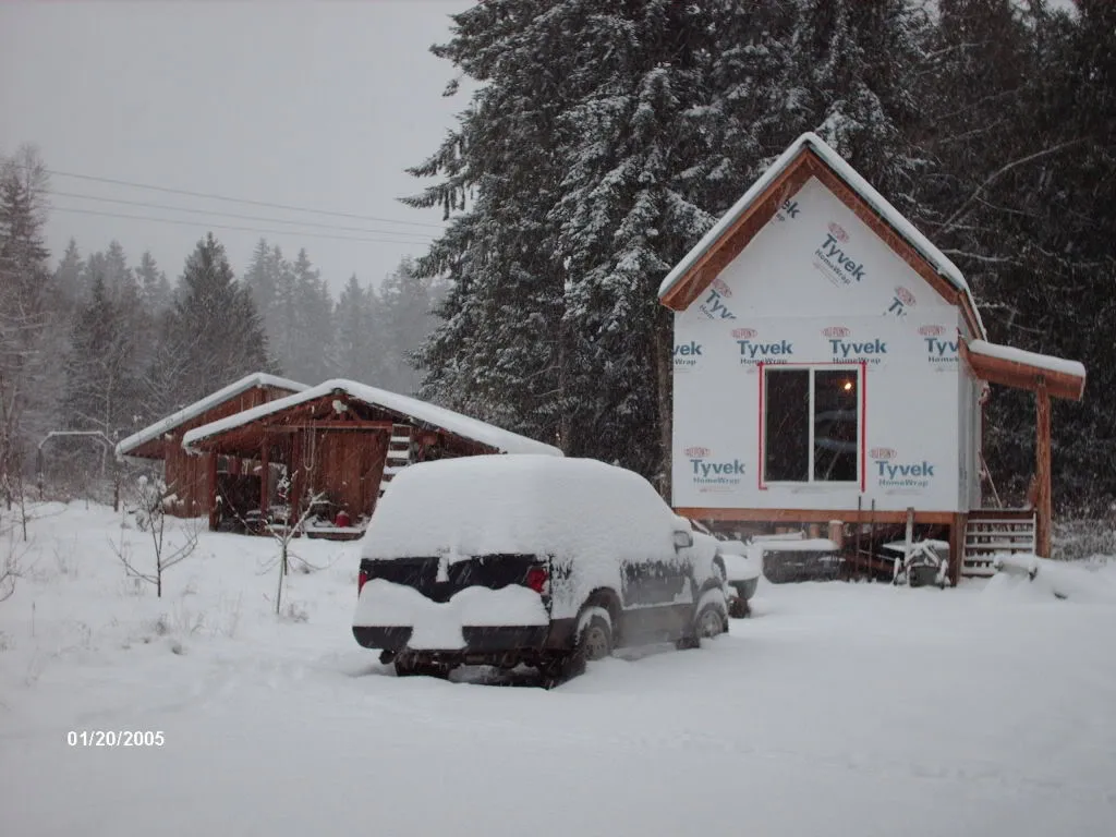

Is it really 2005 out there (date on the photos)!?  Looking pretty good...cold, but good.  I don't miss 3 hours of shoveling just to be able to go to work!
"Is it really 2005 out there?"  Yeah, back to the future.
No, it's just so cold that the darn camera batteries croak need to be swapped out of the charger.  Every time I do that, I'm supposed to reset the date, I forget. Yes the camera displays some little annoying message about it but I don't wear glasses outside because they just fog up from the cold, so I often don't notice the display.
Trust me, there wasn't anything out there in 2005 but scrub alder and scotch broom.

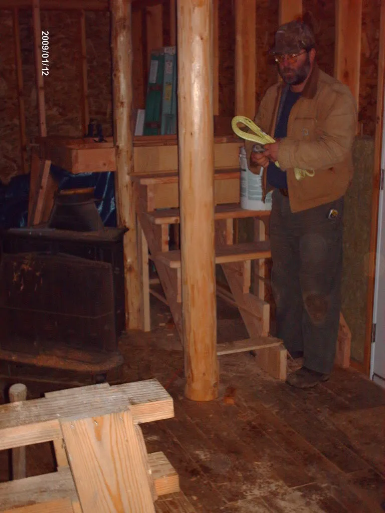

Oh yeah, I have to put 2 risers in the stair landing, erg.  My tongue got a cramp figuring out the angles....now I'm chipping away getting the inside corner to go gracefully around the tree trunk I decided to use for the inside corner.  Yagh I'm slow in the cold!  Pics soon, when I have something to show for the effort.
I brought in some help to make the corner....the second carpenter can never find a 90 degree angle.   >:(
However, progress is being made

I wasn't doubting you.  I used 10-14" locust for the short log wall supports.  Out of 5 there were three that were the but or stump end.  It looks really neat when it spreads out over the floor at the bottom.  The biggest challange I had was lifting and holding them in place while I squared the bottom to be level and then getting them back up again by myself.  Just guessing they probably weighed 200+ pounds apiece.  Then there was the porch post which were the same with the exception of notching out for the ledger to support the roof rafters.  I still have one major job left with logs and that is the stairs which I hope to use the exterior halves of a log to make the stair stringers and steps.  I don't look forward to that.
I always kept the chain saw, chisels, adze and anything else available to make the notches easier.  Lag bolts and wooden plugs are the easiest to work with.  But I fouond that predrilling was neccessity working with the locust.
Although you can't see alot in this picture this is one of the butt end log post.

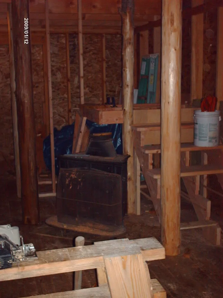

"The biggest challange I had was lifting and holding them in place while I squared the bottom to be level and then getting them back up again by myself.  Just guessing they probably weighed 200+ pounds apiece."
I'll say, it took both of us.  We had to lift them through the front window because they were too long to get through the door.
2 of them were 17' long and notched at the top to "meld" with the ridge beam.  The cabin is  only 14' wide and 24' long and 7'6" to the bottom of the ceiling joists , which are only 22.5" apart.
Threading (horsing/joist bending/cursing/grunting) the "poles" from horizontal on the first floor between the ceiling joists to upright and "visually vertical) from first floor to ridge beam was, well alternately exciting and challenging.
Anyway, since I didn't really plan for the weight of those two really long ones, I'm going to get two more concrete pads and piers and put a 6 x 6 post under the first floor to support each one.  The base of each post is lag bolted through the floor, so I know where the braces go.
Plus, I don't care what they look like when in the woods, no tree is straight.  There's always a bow or bend or even an "s" somewhere to some degree.  So it was a real accomplishment and even the guy I hired couldn't do it by himself.  I say the "guy"....he's actually a not very close neighbor and he and his "gal" are becoming good friends.  Certainly a handy person to know.
The stairs and wood stove is pretty much the "architectural centerpiece" of the whole cabin.  There is no room for any others.  :D
So I'm glad we did it.   c*

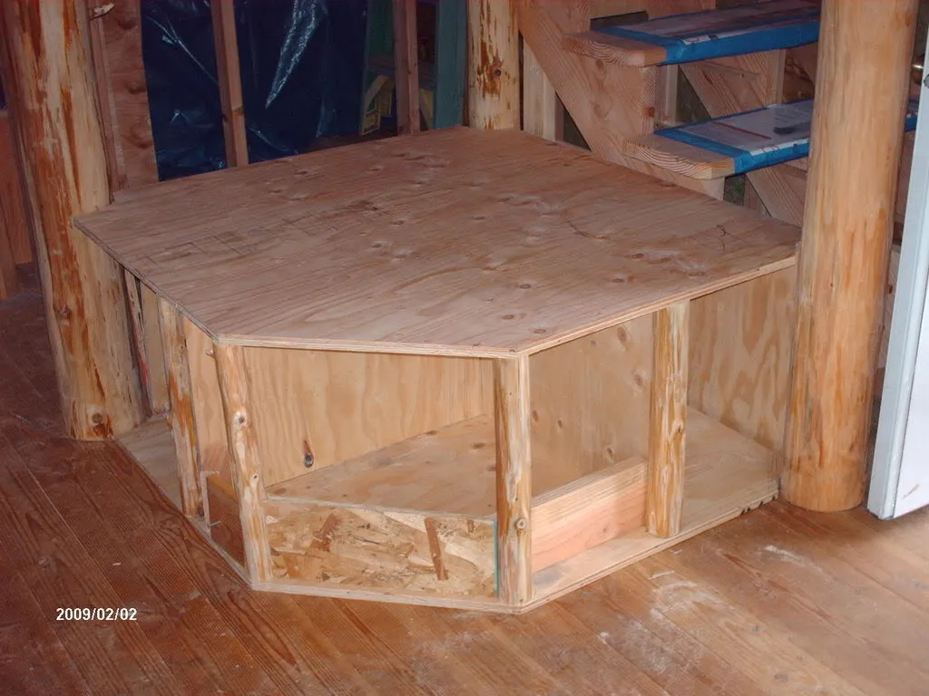

I'm building a wood box - don't fret, I just sort of stacked the pieces into place so I could see what it might look like really vs the picture in my head.
The top will be covered with that cement board and then tiled.
Anyway, now I'm thinking that it should have some kind of surface finish inside the box.
Working hard to be frugal, I have a can of Verathane Spar Urethane.  Its water based, and supposed to be for outdoor use, but from sad experience I can say that it gets wierd and cloudy when outside in cold weather.  So I'm thinking that it might be a good candidate for putting a couple coats on the wood box.
Does anybody think this would not work?  Easy PEG,  ;) I'm just trying to save money.  That can change if it's a really bad idea.
#448
I don't see any problem with using the finish.
If you are going to tile on that (w cement fiber backer board) you'll need to be certain that plywood has sufficient support to eliminate any sag from the weight of the stove. It looks like the stove goes on top; right?
"It looks like the stove goes on top; right?"
Yes
"If you are going to tile on that (w cement fiber backer board) you'll need to be sertain that plywood has sufficient support to eliminate any sag from the weight of the stove. "
It's 3/4" plywood and there are two vertical "walls" of the same in the interior, delineating storage for wood, kindling, and cast iron.  Underneath the top will be some 2 x 4 "struts" to stiffen it in a few places.   Then I'm going to reinforce the "critical" corners with 2 x 4's and lots of screws.
Basically, I plan to rivet it together (sorry PEG).
Please tell me if you have more ideas about how to stiffen the top.  I'm making this up as I go along.
