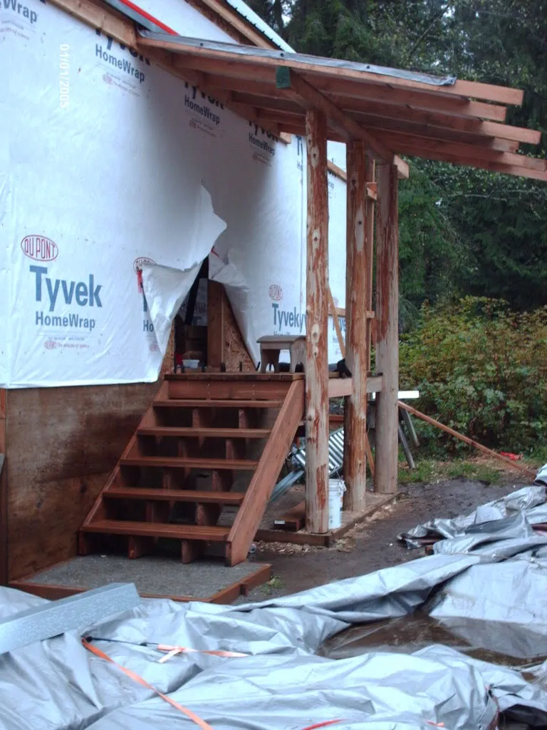

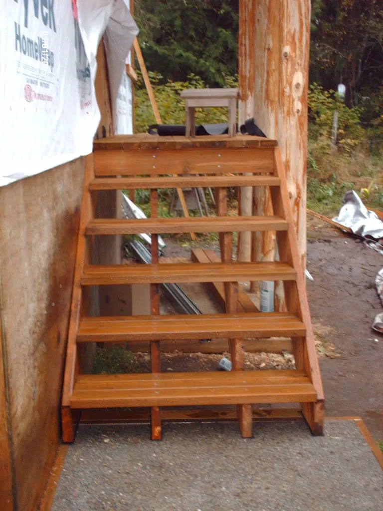

I got the steps done.  The deck is not fastened.  Have to figure out the curves around the posts... ???
At least the stairs are level and uniform.  All that, and then I find out there are little calculators that can do the head scratching for you.  Stubborn people often reinvent the wheel.

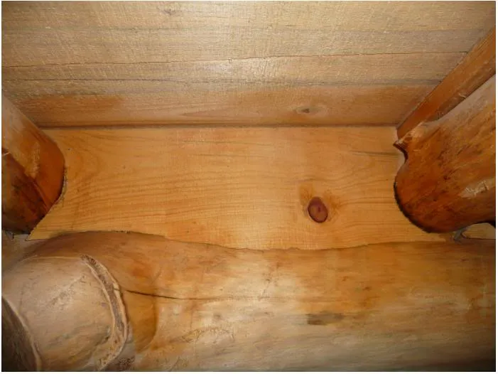

Here is one I used cardboard templates on to transfer the scribed marks to 3 sides.
I had forgot using the cardboard Glenn. You can use it either to freehand and just keep cutting out to make the fit OR use the cardboard in place of the deck board that you want to scribe.  Cut out the carboard and make sure that it pleases you then transfer it to the wood board once you are satisfied.  I have done it both ways.  The only problem arises when you are doing it to T&G and it takes on a new meaning of " attempts".
With the floor in the cabin where it met the post and logs I cheated a little.  I just kerf cut permanent section and inserted the flooring.  Probably wouldn't be a proper way for exterior with water but it worked on the inside.
As you do it and gain confidence you can do it right on the board but in difficult situations it can help.  I have cut slots in some places also.
Patterns and carefully laying out distances can work also.

Hey, considerations, those look like mighty fine steps!  Great job...  hope you're getting your lock in ok.  I was working for a week down in the valley & couldn't see the pix & sometimes miss a lot of postings.
PEG's step by step instructions are so clear even I could probably do it!   :D

PEG - that's pretty much what happened, except I came up a little short, and had to stick a PT 4 X 4 under the back side of the bottom of the stringers because I undershot the concrete pad by about 3 inches.
