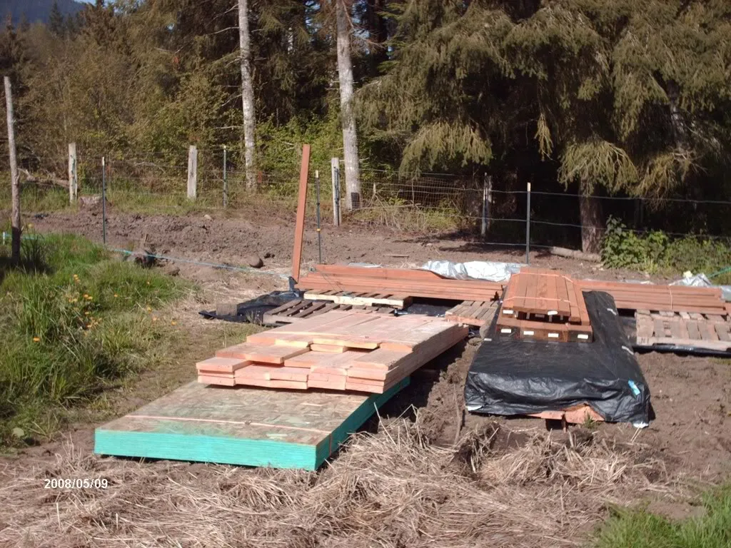

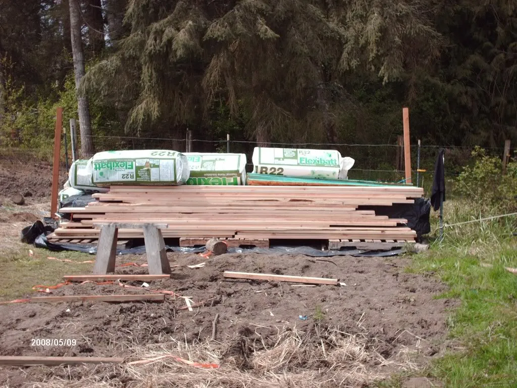

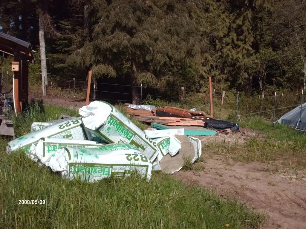

Lessons learned
The lumber truck offloads aft, not tharwtships (yagh)
considerations and to think you are just getting started.  But the journey is half the fun.  Before long you can say "I did it".
Yup -- that's a roll off lumber truck.  Untie the load, pop the clutch, get away from the crash and drive away.
One hot shower and an Aleve, and I'm fine.  Next time, however, I'll be set up for an aft drop.  I'd like to move the rest of the of building materials only twice, from the pile to the saw to the cabin.   d*   They only broke one piece, snapped it like a twig.  I love the smell of cut fir.
Today was a red letter day, the first Douglas Fir squirrel I've ever heard spent the better part of an hour giving me thunder for working near his luncheon tree and the nesting eagles are back.
The adventure continues.....
Yep been there done that.  I had a load of subfloor and roof sheeting delivered in this fashion.  It was dropped on the edge of the bank near the basement. When it rolled off the truck the bands broke and I had 15 sheeting slidding down the hill to the drive.  No fun carring them back to the stack at the top of the grade.

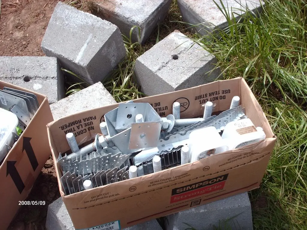

I dug 14 holes 30" deep and 24" square, filled them with 5/8"- and leveled the top of the gravel
Set 16" diameter concrete reinforced blocks on the gravel and then 12" pyramid shaped piers on top
Then put u-shaped brackets for 4x4" PT posts with threaded rods and washers and nuts in the holes.
Then put 4 x 4" pt post in the brackets.
Ok I have read this forum a lot, and read the read me first, and the plans, but don't see a clear answer to the following":
Question 1 = Do you drill holes in the 4" s 4" PT posts to match the holes in the brackets and bolt through?
If so, is that enough fastening?  Or are the other little holes in the brackets for nails, as well - or instead?
Question 2 - are the usual stamped sheet metal brackets for connecting 4 x 4's sufficient for connecting the top of the posts to the beams, or should they be as hefty as the ones at the bottom of the posts?  Do these get bolted as well ( I plan to set the beams on top of the posts, not try to bolt them to the sides of the beams.)
Question 3 - I don't know where the log trucks around here go with all those trees, but most of the local lumber comes from Canada. So, faced with a 14 day wait, and the obvious weight of 24' PT 4 x 8's, I got 4 12's instead of 2 24's for the beams.
That's why there are 14 piers, one for dead center under the butted up ends of the 12' 4 x 8's
Is there any thing I need to do to secure those butted up ends?   The bolt hole in the bracket (it is centered just like the butted ends) won't connect them, can I just nail through the little holes in the bracket?  does it matter?
The other end of the foundation beams are just hanging out there, not connected to anything.
If these questions have been answered before, I apologize for the repetition, guess I'm this forum's latest field test.
