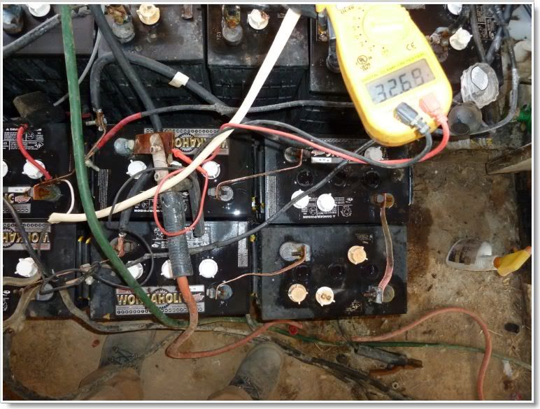

I checked my other banks of batteries and found 2 with low voltage in them.  These batteries are from 2004 and 2005.  I swapped one of the three good ones into the set with a bad one and took another one of the good ones to replace the one bad newer one until I get to the battery supplier in Fresno.
I have a meter that checks capacity as CCA so I checked it - around 250 CCA.  The newer batteries have around 800 CCA so a much higher capacity, but it will get me some use out of that bank until I get a new one.

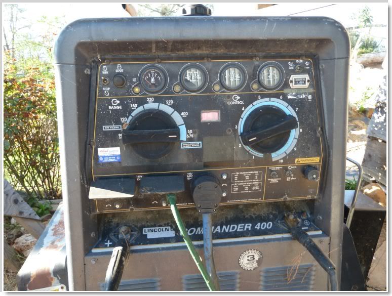

Here is my equalizer charger.
A 575 amp DC  Lincoln welder.  Works for welding too.  [ouch]
I monitor with a meter and try to keep a good watch on it when I am equalizing.  I had to repair both welding cables due to heating before I got a good start.  Problem areas make resistance... and resistance under power makes heat.  Enough for fire if it gets too bad.  A scan with the non-contact thermometer from Harbor Freight quickly tells if there are problems.  One problem was only that the cable had been run over and damaged.  It heated up enough to burn off the insulation.  Kind of unusual to see that happen inline rather than at a termination.
I had kept it under 32 volts for a while with little results, so I eased it up to 33.  Batteries must be full of water to do this otherwise internal arcing will damage the plates.  When it hit 33 it did not stay for long.  I was running about 90 amps and in a little while the voltage started dropping indicating that the internal resistance of the batteries was dropping, and capacity of the batteries were increasing.  I ran it for about an hour that way monitoring battery heat and voltage.  You can watch it increase in capacity as the voltage continues to drop and amp intake is increasing.
I will probably add some EDTA to the old battery and see how that effects it's load capacity also.  A bit of time to experiment again now.
Looks like all you need Glenn is some garlic bread and some Spaghetti sauce.   ;D
[rofl2]   That is the picture of the good side of my battery bank, John.... look at those nice buss bars.  heh
Power seemed better last night.... moving in the right direction.   :)

Made the trip to get new batteries today.  Tested the real old one with my load checker - voltage had dropped since equalizing it and load was at about 320 CCA.  The new one and the rest of the 2 year old ones ranged near 800 CCA + or -.
I realize that Cold Cranking Amps is not normally used for deep cycle batteries but it does give me a standard to check the batteries by with a high end battery checker.
I pulled out the real old battery and put the new one in its place.  9PM tonight I was showing 25 volts in the batteries.  That is better.  :)
I also picked up 4 new batteries so that will give me 12 new to 2 year old L16 batteries.  I will do some testing on the rest and see if they will be of value.
