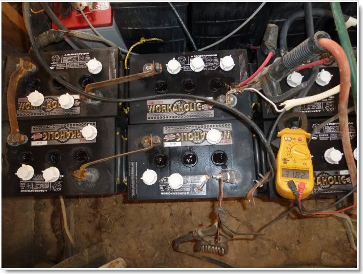

It seems that our batteries have been dropping a bit more at night than I think they should so since I finally got home for a day I thought I would look into it.
We have reasonably new interstate batteries  - a couple years I think so I thought I would test and equalize them.  Started on the first set and got reasonably good readings.  I equalize with a DC  CC welder and monitor voltage then drop it as the batteries start to come up to capacity.
I hooked up to the second set, put the meter on it and was getting high readings - 66 or so volts across the batteries.  Checking one battery from the positive brought the expected 6.5 or so volts - across the second the expected 13 or so volts - across the third in the series the voltage jumped to about 49 volts.  This indicates an open cell apparently.  Since the circuit does not complete through the battery to pull the open circuit voltage of the welder down then the voltage goes high indicating the open cell problem.  Voltage across the battery was 4.5 or so volts indicating the one cell was not contributing.
Hydrometer wise - SP of other cells were full charge -say about 1260 while this bad cell was no charge- 1100 or less.
Note that I have separated the battery bank to be equalized from the other batteries paralleled with them to control the flow of current so that it can only go  through the batteries I want it to.  Paralleled with another set the equalization voltage would go through the easiest path.  Which batteries got the equalization could not be controlled if all were together.
Gonna ditch the bad batt or replace them in a pair?I'm anal about stuff like that so I would probably replace the whole bank.  d*
It shouldn't have gone bad yet but their warranty is apparently up.  It is only a couple years old so a new one will work OK with it.
They are about $250 each so 4 would be a thousand plus tax.  We are thinking 5 for a replacement and 4 new ones to replace some of our 7 year old ones possibly.  [scared]
When one cell in a series goes bad the entire string in that series is non-functional.
The system is only as strong as the weakest battery.
That about sums it up, Ben.
I went back up and hooked the welder back up - rechecked everything - made sure there was no voltage loss between the buss bar and the lead terminal - same outcome - reading high voltage across that battery only - so - I guess Monday we go to the battery store.  It seems Interstate does not like to give much of a warranty on their batteries so I get to eat the whole thing - I found some limits of 90 days and up to one year on other things on their site.  Guess I go back to the other manufacturer with my money.
