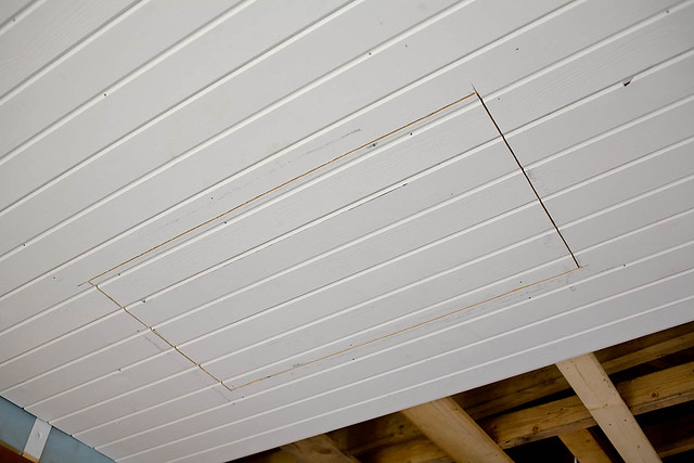

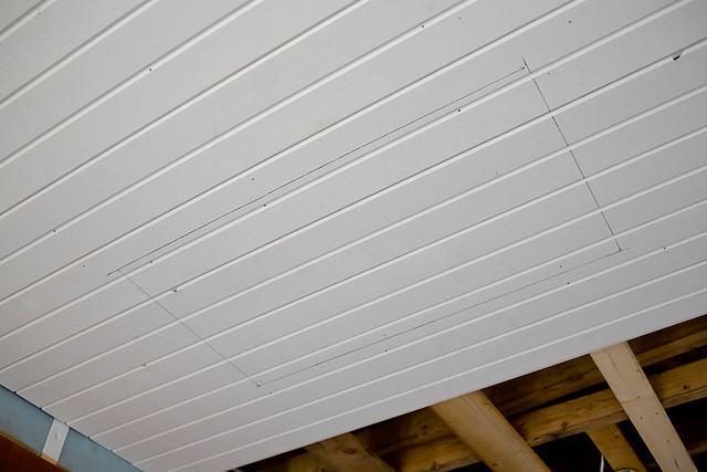

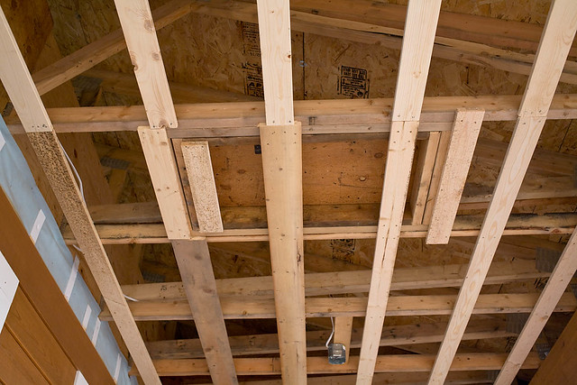

The plan for the attic hatch is to cover over it with the ceiling material and then cut it out with the circular saw. Hopefully I can manage to mark it correctly and saw a straight line so it will blend in nicely. Hopefully I can finish the ceiling tomorrow, or at least get close.
Alan
Alan Gage
The outline of what should be the attic hatch after taking some careful measurements:
20111013_003 copy_web by Alan  Gage, on Flickr

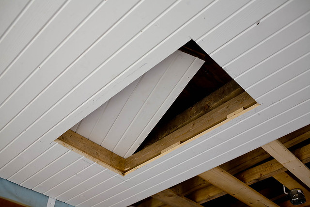

Triple checked everything before firing up the saw:
20111013_004 copy_web by Alan  Gage, on Flickr
And the moment of truth. What a relief!
20111013_006 copy_web by Alan  Gage, on Flickr

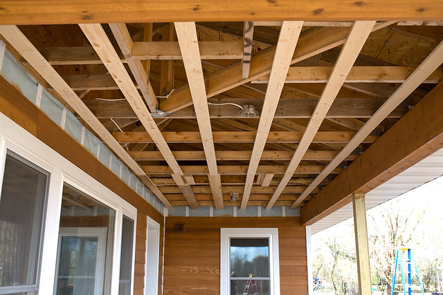

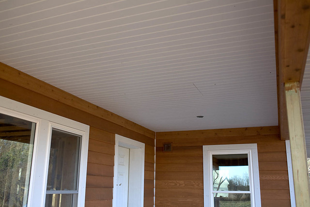

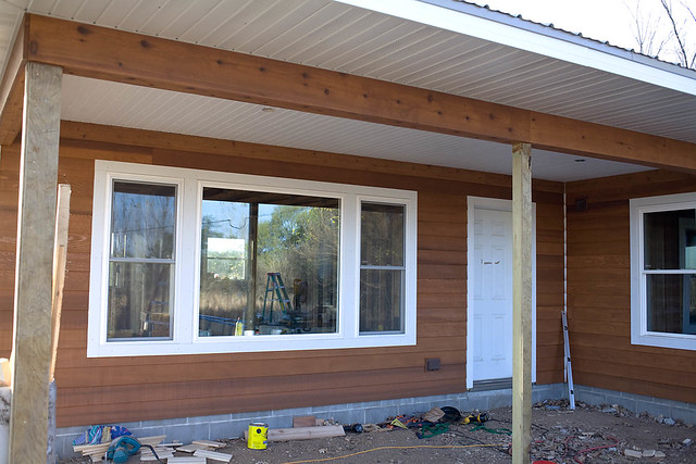

Finished up the patio ceiling on Friday and got it trimmed out too:
20111015_001 copy_web by Alan  Gage, on Flickr
20111015_002 copy_web by Alan  Gage, on Flickr

Lazy guy trick... I have a 1/8" by 12" drill bit I use to *exactly* mark the corners of a cut like that.
"Hey Y'all, watch this..."
Yep, I have an assortment of long bits from 1/8 to 1/2"  Invaluable for stuff like that as long as you can access the other side.

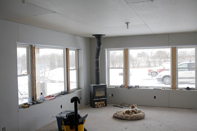

Let there be fire!! And a doggy bed.
20111017_002 copy_web by Alan  Gage, on Flickr
Starting to get pretty cold so I needed something to help warm up in the mornings. Cut the chimney through the roof a couple days ago. It can be a little bit of a motivation killer though. Hard to leave the heat and go to work.

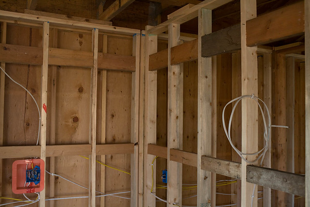

Got a lot of blocking done today. Kitchen cabinets, book shelves, coat racks, and other shelving/cabinet possibilities. I might be getting a bit carried away but it's going to make life easier in the future.
20111018_001 copy_web by Alan  Gage, on Flickr
20111018_002 copy_web by Alan  Gage, on Flickr

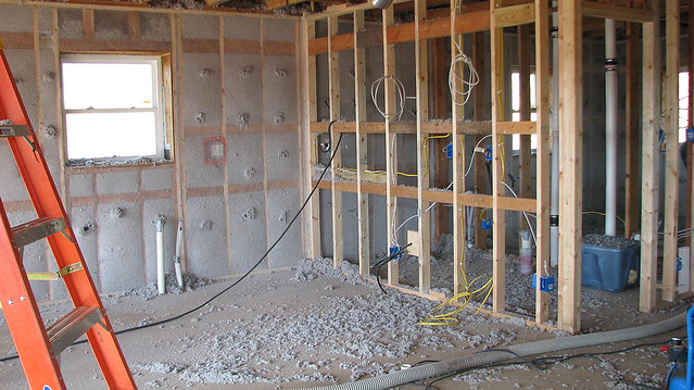

My friend Sarah came down for the weekend to help with the insulating. I went with dense packed cellulose in the 10" thick walls. Started by loose filling all the walls by just dumping through the top plate and then went around a couple more times, packing it harder each time. For the initial fill I just pumped it out of the 3" hose. For the dense packing I first stepped the 3" hose down to a 2 1/2" hose and finally to a 2" nozzle. Once we started stepping it down we started running into lots of problems with getting clogs, which ate up a lot of time. We kept the blower at 100% and cut back the flow so that we still had decent flow but kept the clogs to a minimum. Other than spraining my ankle badly things went smooth. It took all day Saturday and a good part of Sunday to get it done. I'm happy with how it came out. It certainly gives a different feel to the house.
20111029_006 copy_web by Alan  Gage, on Flickr
I put in 120 bags of cellulose, about 2700 pounds worth. Pretty sure at least 250 pounds of it found it's way onto me. It didn't get too messy until the final round of dense packing when it started blowing back out the holes into my face.

Looking good!  can you tell us about that insulation more? I havent seen it on CP before... looks interesting. Is it common in your area?
Alan Gage
Quote from: KWillets on November 02, 2011, 10:47:06 PM
It looks like a nice tight building envelope; are you planning on an outside air kit for the stove?
Yes, outside air for the stove.
Quote from: duncanshannon on November 05, 2011, 04:02:20 PM
Not common around here at all. Pretty much all anyone uses in fiberglass. I only know of one person that uses wet blown cellulose. I talked to an installer a few months ago who said he could do dense pack but in the end I decided to give it a go myself. Took a while but it wasn't too hard. I was worried about getting the correct density but it all feels firm (supposed to feel like a firm mattress) and I used more bags than I estimated from the charts based on wall square footage. Actually there are a few soft spots but I've marked them and will top them off when I get the blower back for the attic.
If my walls weren't so thick (10") I probably would have gone with wet blown cellulose but I was a bit worried about the cavity being able to dry properly.

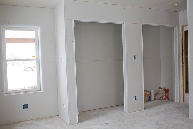

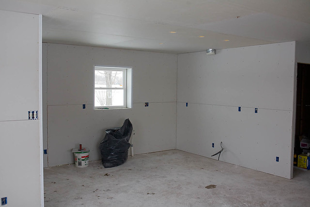

Alan Gage

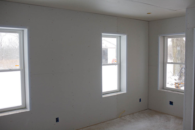

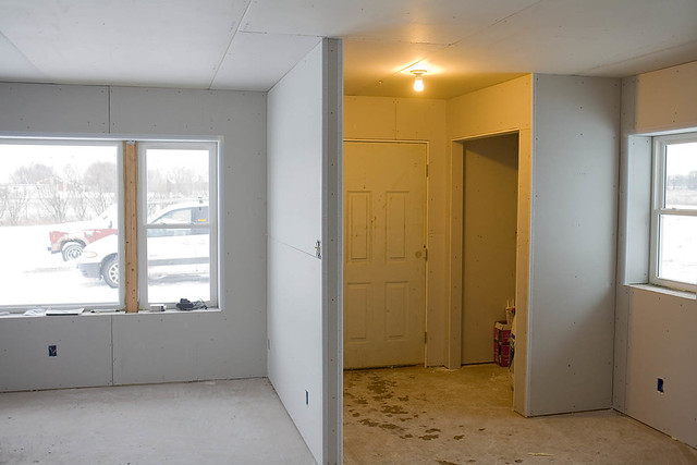

Finally done hanging drywall. Well, almost done. Still need to do the bathroom after I figure out for sure how I'm doing the shower.  Sheesh, that took forever!
But even without the bathroom being done the house finally has its final shape inside. I was afraid some places (like the entry) would feel small and cramped but I'm really happy with all the rooms and the general layout.
Today was cleanup day. Put up the last of the corner bead, went around and set any proud screws I could find, and moved everything out of the house so I'll have room to throw some mud starting tomorrow. It's nice to have a clean(ish) house again. It's been a mess for a long time.
Entry (living room to the left):
20111204_009 copy_web by Alan  Gage, on Flickr
Living room:
20111204_003 copy_web by Alan  Gage, on Flickr
Kitchen:
20111204_004 copy_web by Alan  Gage, on Flickr
Main bedroom (nook for desk on left):
20111204_007 copy_web by Alan  Gage, on Flickr
Another of the bedroom:
20111204_006 copy_web by Alan  Gage, on Flickr
Bull nose bead around the windows. Square everywhere else:
20111204_008 copy_web by Alan  Gage, on Flickr
We've had some cool weather the past couple weeks (lows in teens, highs 20's and 30's) and the house has been doing great. My little wood stove (1.1 cu. ft) has been the only heat and it hasn't even broke a sweat. It's nothing to bring the living room and kitchen up to 75 degrees (which is way too hot for me). It took quite a while to bring the slab up to temp but now that it's there it's holding heat very well. A couple days ago when I got to the house in the morning the air temp was 63 degrees and the slab temp was 65 degrees. Perfect! One of these days I'll shut the stove down and see just how well the house really holds heat.

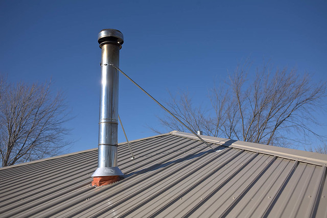

Alan Gage
Chimney supports went well. Used a couple lengths of 1/2" conduit smashed flat on both ends. Screwed to the roof and clamped to the chimney.
20111218_001 copy_web by Alan  Gage, on Flickr

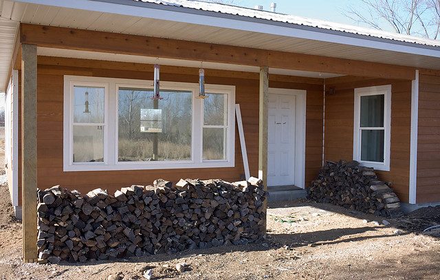

Also brought up a little under 1/2 cord of firewood and got it stacked under the patio. No more groping through the dark trying to find pieces small enough for the new stove. I was surprised how much this little act made it feel like a home.
