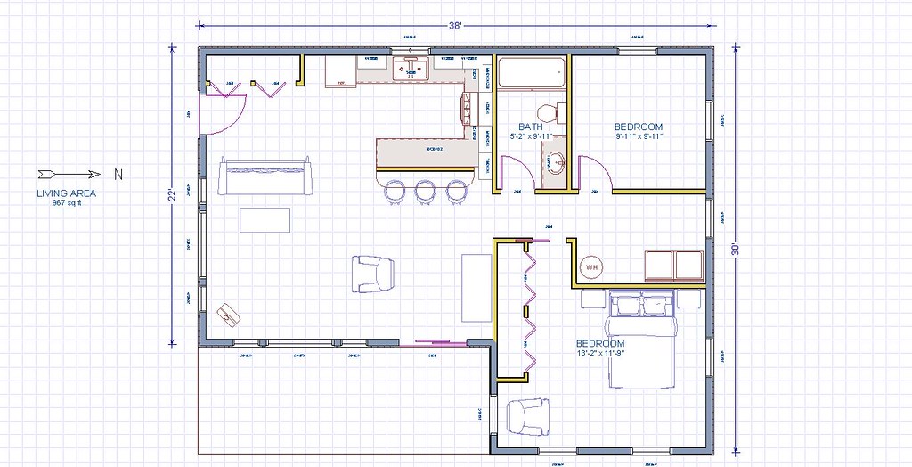

Since I'm past the point of no return I figured I might as well start my thread. The house will be a little under 1000 sq. ft. Single story, two bedroom, slab on grade, and heavily insulated.

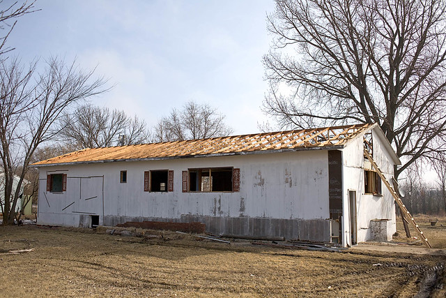

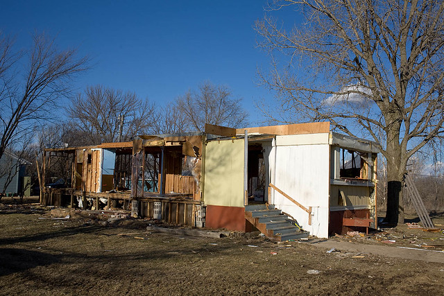

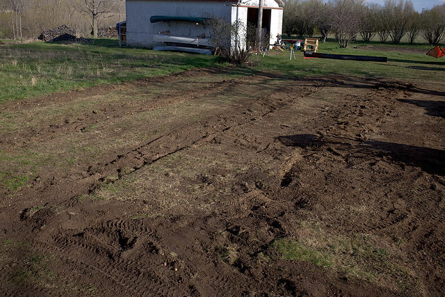

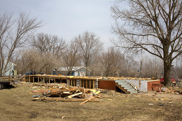

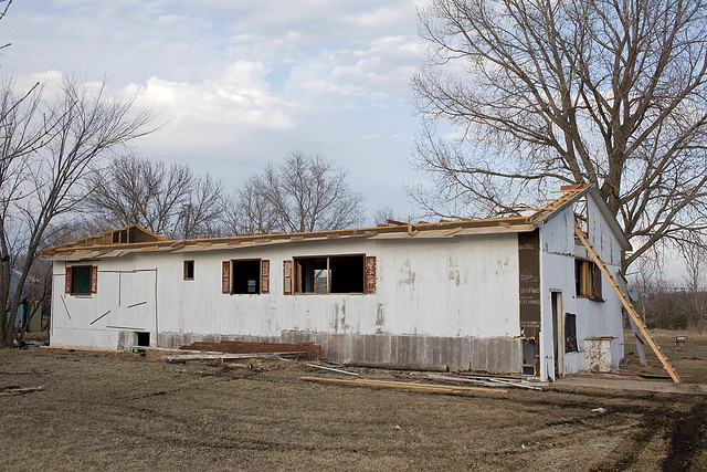

This is what the old house looked like when I bought it a few years ago:
And this is what's happened to it so far this spring:

And what the house will hopefully look like:

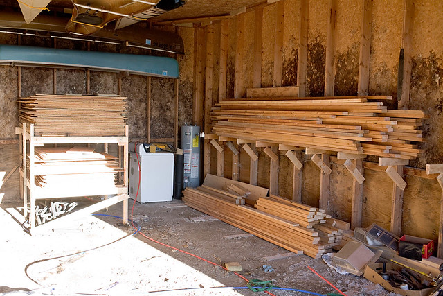

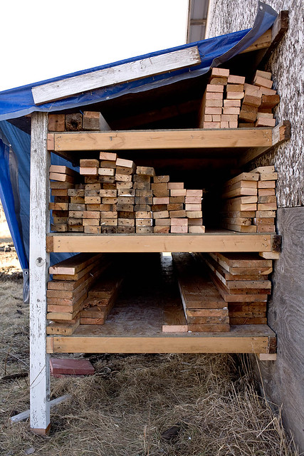

Alan Gage
The fruits of my labor up to this point:
Alan
nathan.principe
Looks like your off to a good start with all the salvaged lumber!

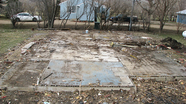

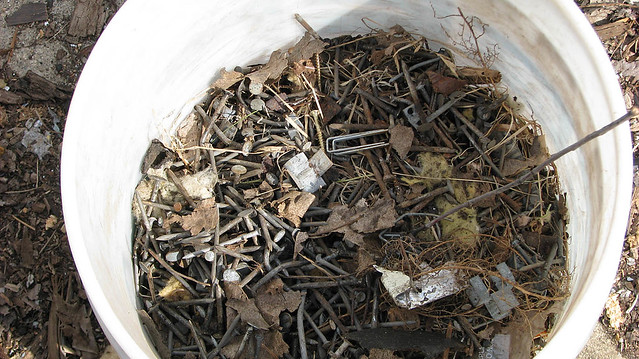

After lots of cleanup:
Nails by Alan  Gage, on Flickr
There was finally nothing left but the slab:
Down to the slab by Alan  Gage, on Flickr

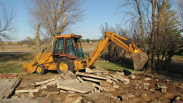

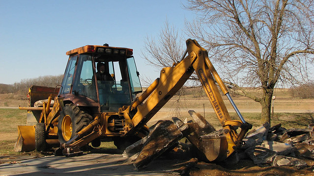

Then today the guy came in with his back hoe and made short work of it:
Slab destruction by Alan  Gage, on Flickr
20110410_004 copy_web by Alan  Gage, on Flickr
Most of the day was spent picking up and hauling away the concrete. A few more foundation walls to take out tomorrow and the deconstruction phase will finally be over! Then it's time to start making the hard decisions.  :-\

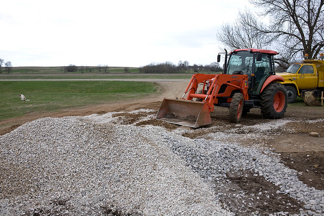

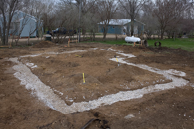

After the old slab and footing was removed it took over 100 tons of gravel to fill in the old well pit and bring the pad up close to where I wanted it. I had no idea it would take anywhere near that much! I've never worked with gravel before so had no frame of reference. I thought maybe I'd need 30 tons or something.

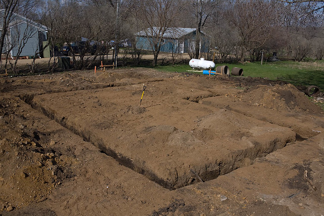

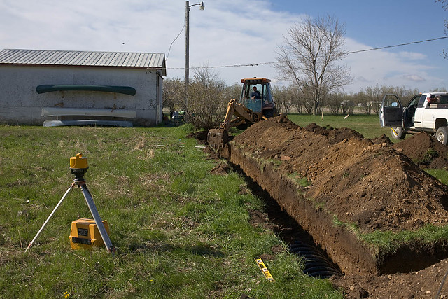

Then it rained and snowed for 1 1/2 weeks so not much happen. But happily it quit raining the middle of this week so my digger guy came out to dig the 4' deep (18" wide) footings yesterday and it went without a hitch!
Footing trenches dug! by Alan  Gage, on Flickr

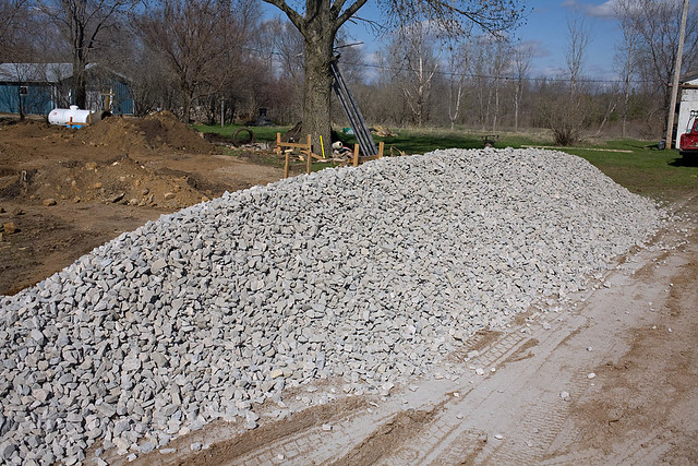

After lots of flip flopping I decided to go with rubble trench footings so had the first load of crushed limestone delivered that same afternoon. 26.5 tons of 2" washed. It was bigger than I thought 2" would be.
Crushed limestone by Alan  Gage, on Flickr
It was hard stuff to work with. It locks together nice but that makes it tough to move around in the trench with either foot or shovel. They dropped off the second load early this morning (27 tons) and I had them bring 1" this time. Much easier to move around for grading it on top.
All filled in! by Alan  Gage, on Flickr
20110429_004 copy_web by Alan  Gage, on Flickr
Very happy my dad decided to buy a new (to him) tractor this spring; it's come in very handy.
Next step will be digging in the sewer drain and pouring a stem wall on top of the rubble. Then the rest of the plumbing and the slab itself. Really looking forward to reaching that point so I can start putting up some walls.

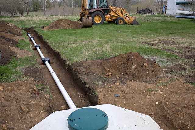

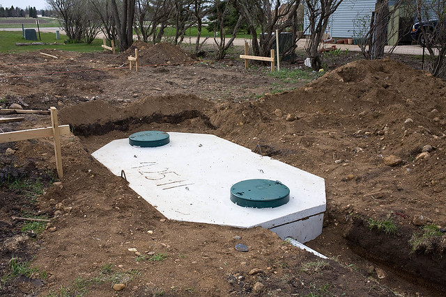

Septic installed over the last 2 days. I've got a great guy doing my digging, he's done beautiful work.
Septic by Alan  Gage, on Flickr
20110504_002 copy_web by Alan  Gage, on Flickr
Leach fields by Alan  Gage, on Flickr
20110505_018 copy_web by Alan  Gage, on Flickr
Put in 200' of leach field, four 50' runs. Used 3' plastic vaults. Went in very quickly.

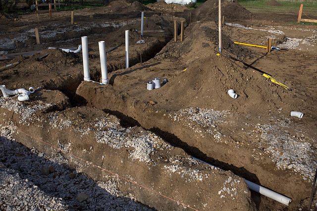

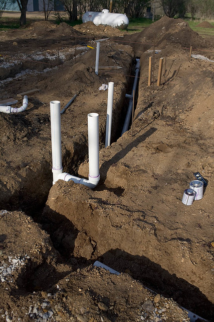

Spent yesterday measuring VERY carefully and doing a lot of digging. Today, after the rain quit, I started laying the pipe. First time I've ever done any plumbing but I'm really happy with how it's turning out. I ran short on fittings this evening so couldn't get it finished up. An easy run is all that's left though.
The real test will be if the pipes are in the right location when I start putting walls up.  :)
20110508_003 copy_web by Alan  Gage, on Flickr
20110508_004 copy_web by Alan  Gage, on Flickr
I got the bill for the septic that was installed earlier this week. $4500 for parts and labor. About what I expected.

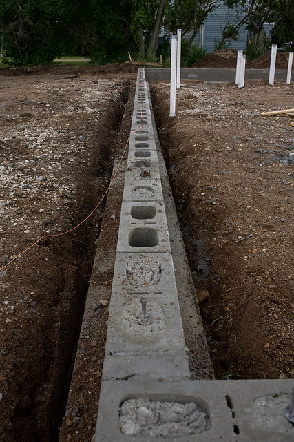

Alan Gage

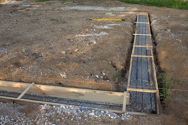

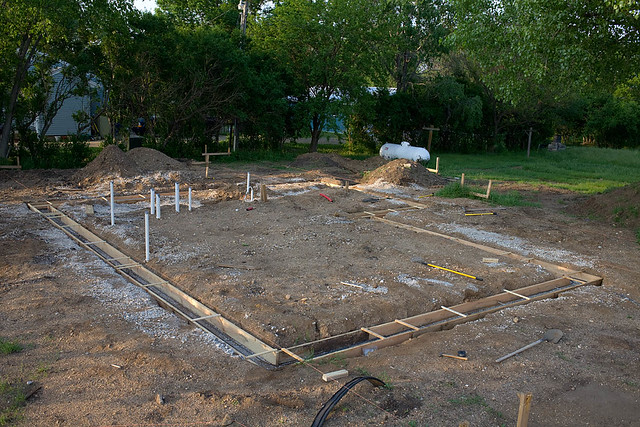

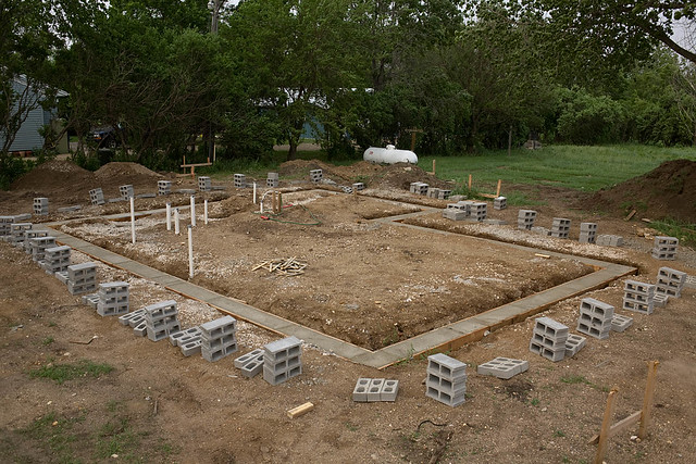

Re-excavated around the water line. Started worrying about it breaking under the slab in the future so I went to our electric cooperative and bought some 2" semi-flexible conduit they use underground and sleeved my water line. Came above grade with schedule 40. If there's ever a problem in the future I'll only have to excavate outside the foundation, pull the old water line out and slip new 3/4" pex through the sleeve. Filled the hole with crushed rock.
Spent this past weekend packing and leveling the rubble trench and then building and leveling footing forms. Poured today. Got the guy that will be doing my block work to come out and take charge of the pour since I've never done any cement work. I was happy that the forms held and everything went smoothly. Feels so good to finally get some cement down. If my sub-slab insulation shows up this week I hope to have the slab poured this time next week.
Forms by Alan  Gage, on Flickr
20110605_002 copy_web by Alan  Gage, on Flickr
20110607_001 copy_web by Alan  Gage, on Flickr

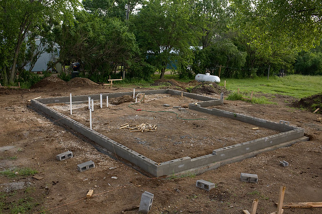

Saturday today so I spent the whole day working on the place. Took down batter boards, filled in with gravel around the footing, did some cleanup, and dug in the pressure water lines. I'm constantly surprised how slow things go when working by myself. Things that I think will take just a few hours end up taking the whole day. The dog kept herself entertained hunting ground squirrels.
Sounds like rain tomorrow but hopefully it will hold off. I'd like to finish grading the pad.
20110611_001 copy_web by Alan  Gage, on Flickr
20110611_003 copy_web by Alan  Gage, on Flickr
20110611_004 copy_web by Alan  Gage, on Flickr

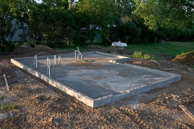

Alan Gage
A few sprinkles this morning but it actually turned into a very nice day. Worked until about 8 o'clock tonight leveling the pad and getting it ready for foam. It was a long day of shoveling gravel but it's good to have it done. Waiting on foam and clear weather now.
20110612_001 copy_web by Alan  Gage, on Flickr
20110612_002 copy_web by Alan  Gage, on Flickr

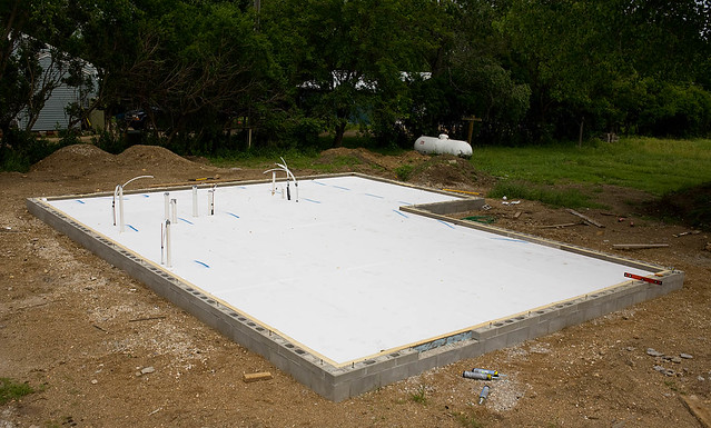

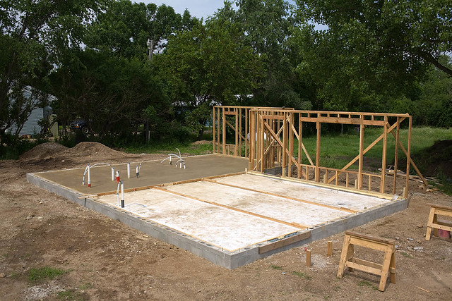

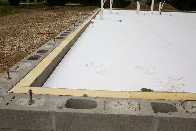

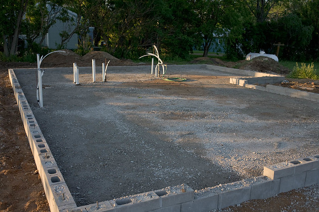

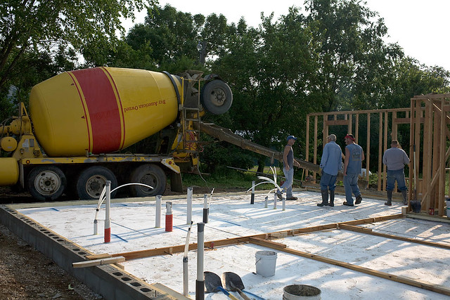

Scattered rain most of last week so no concrete went down. My foam showed up mid-week and I was able to get the penetrations cut and the pieces trimmed so it would be ready to go when concrete time arrived. Then I took it back out and stacked it back in the trailer to wait.
20110617_001 copy_web by Alan  Gage, on Flickr
The perimeter foam was salvaged from the house I tore down.
20110617_002 copy_web by Alan  Gage, on Flickr
Was really hoping to pour on Saturday since the weather was supposed to cooperate but my concrete guy was leaving town for the weekend. There really wasn't anything else to do so I started building walls.
20110619_003 copy_web by Alan  Gage, on Flickr
20110619_004 copy_web by Alan  Gage, on Flickr

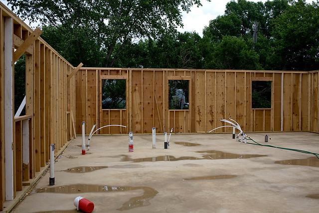

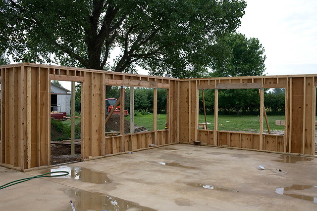

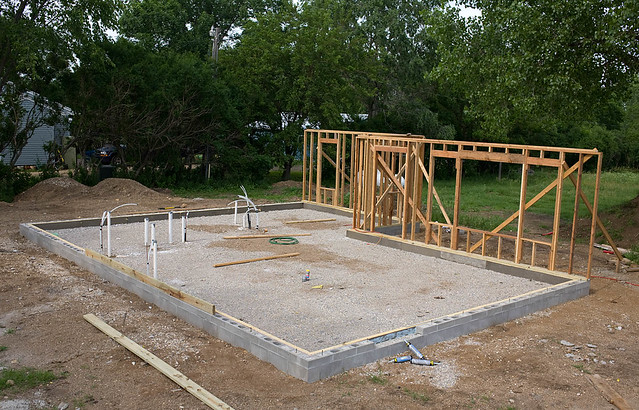

The first section of wall seemed to take forever. Took a long time figuring out the window openings. Went a lot faster after that. It felt really good to be working with wood. Everything except the treated sills is salvaged lumber.

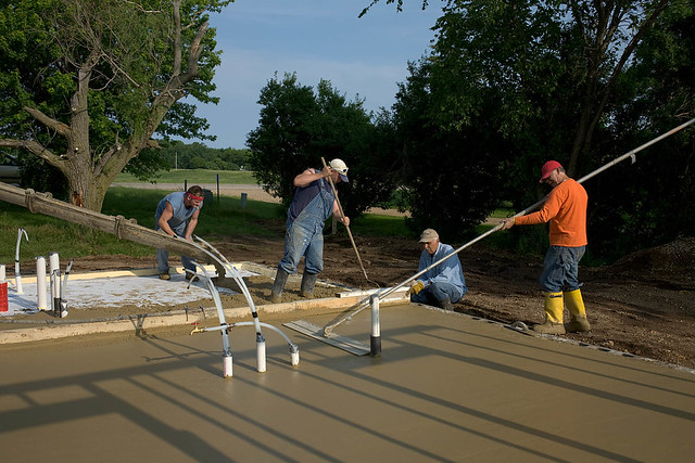

Alan Gage

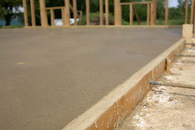

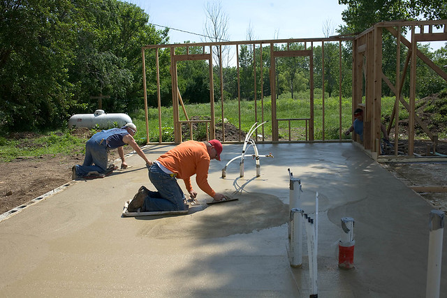

What a relief to finally get some concrete down today. Unfortunately they decided to do it in two pours so only half of it got done. It's supposed to start raining again so if the weatherman is right it will get finished on Tuesday.
20110624_001 copy_web by Alan  Gage, on Flickr
20110624_004 copy_web by Alan  Gage, on Flickr
20110624_006 copy_web by Alan  Gage, on Flickr
20110624_007 copy_web by Alan  Gage, on Flickr
20110624_008 copy_web by Alan  Gage, on Flickr
They're a small and old school crew but the best in the area. They finished it off by hand and the finish is excellent. It will be my finished floor.

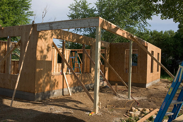

Haven't updated in a while but I've been busy.

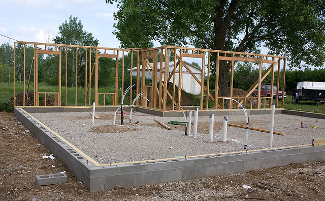

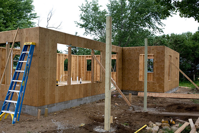

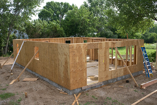

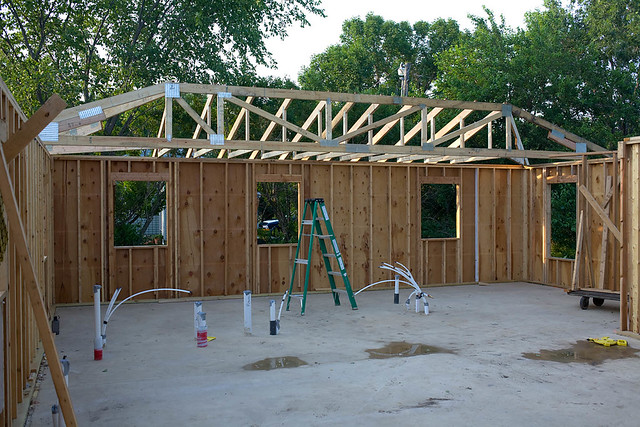

After waiting out the rain the concrete guys finished up the second half of the pour. With that out of way I could get back to the business of framing and sheathing the walls. The sheathing was the first thing that's gone faster than I thought it would.
20110709_001 copy_web by Alan  Gage, on Flickr
From the front door:
20110709_004 copy_web by Alan  Gage, on Flickr
The living room:
20110709_006 copy_web by Alan  Gage, on Flickr
Set a couple posts in the patio area in preparation for trusses:
20110709_002 copy_web by Alan  Gage, on Flickr

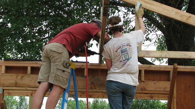

Help showed up Saturday:
20110709_013 copy_web by Alan  Gage, on Flickr
We got the beams up on the posts and then spent the rest of Saturday straightening the tops of the walls:
20110710_001 copy_web by Alan  Gage, on Flickr

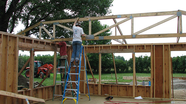

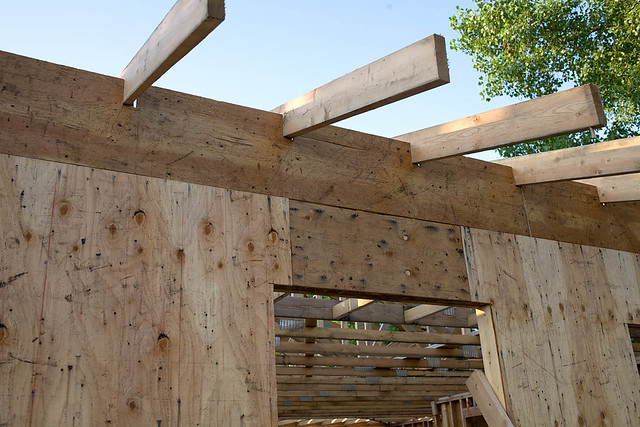

Laid out marks on the top plates Sunday morning and started setting trusses. Thankfully my dad (not pictured) showed up to give us a helping hand. They weighed a little over 200 pounds each and were 37' long:
20110710_015 copy_web by Alan  Gage, on Flickr
20110710_017 copy_web by Alan  Gage, on Flickr
20110710_004 copy_web by Alan  Gage, on Flickr
20110710_006 copy_web by Alan  Gage, on Flickr
20110710_007 copy_web by Alan  Gage, on Flickr
We only got 2 of the trusses up but they were the most time consuming. It didn't take long for the trusses to go up but then 3 hours setting and nailing all the jacks in place. The remaining trusses should all go up fairly quickly since it will just be tipping them up and adding braces. Hopefully I can dodge the weather and get some help during the week so I don't have to wait for the weekend.

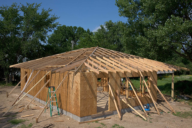

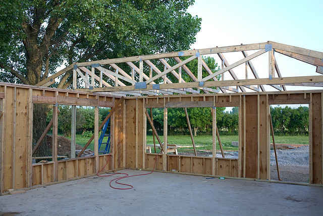

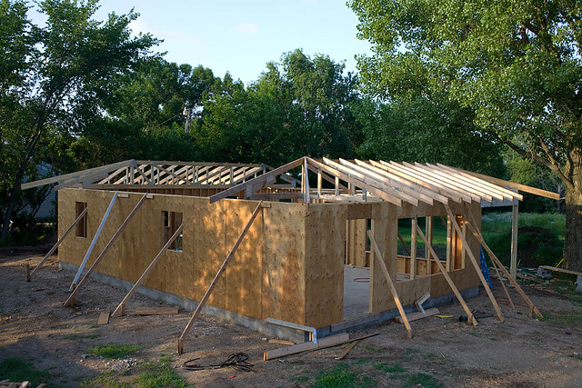

Hooray, the trusses are up!
20110716_001 copy_web by Alan  Gage, on Flickr
Finished them up Thursday night and hoped to start laying down sheathing this morning. But, as usual, it didn't happen that way. As I lay in bed this morning thinking about what I needed to do before putting down the roof sheathing I started to come up with a pretty big list and realized I might not get any down this weekend.
Did lots of little things today and ended with notching some strips of plywood around the trusses to keep the insulation in place. More little things to go tomorrow but hopefully I'll start getting some sheets down.
20110716_003 copy_web by Alan  Gage, on Flickr
