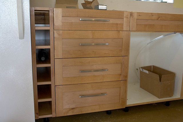

More in progress pictures to come but I just had to share some of the weekends progress.
Cabinets are almost done!
20120415_001 copy_web by Alan  Gage, on Flickr
20120415_003 copy_web by Alan  Gage, on Flickr
Very happy with how they're coming out and very relieved that the gaps came out right when I put on the fronts.

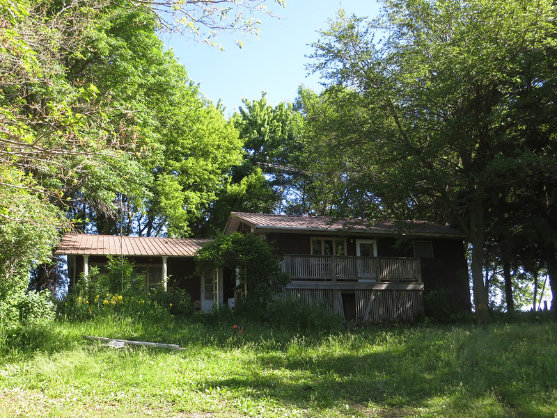

Somewhere I've got some newer pictures of my house build but not on this computer. I'll post them later when I'm on my laptop. But this is a picture of the house I bought last summer:
20170604_018 by Alan, on Flickr

Both the house and the view look better now. It was an overgrown jungle when I moved in. It's only a 1 acre lot but I cut out 45 trees and some very large limbs over the winter and there were still over 40 trees left on the property. Then I planted 80 trees and shrubs in better locations and to fill in some of the holes. Still plenty of shade in the yard but at least grass can grow everywhere now.

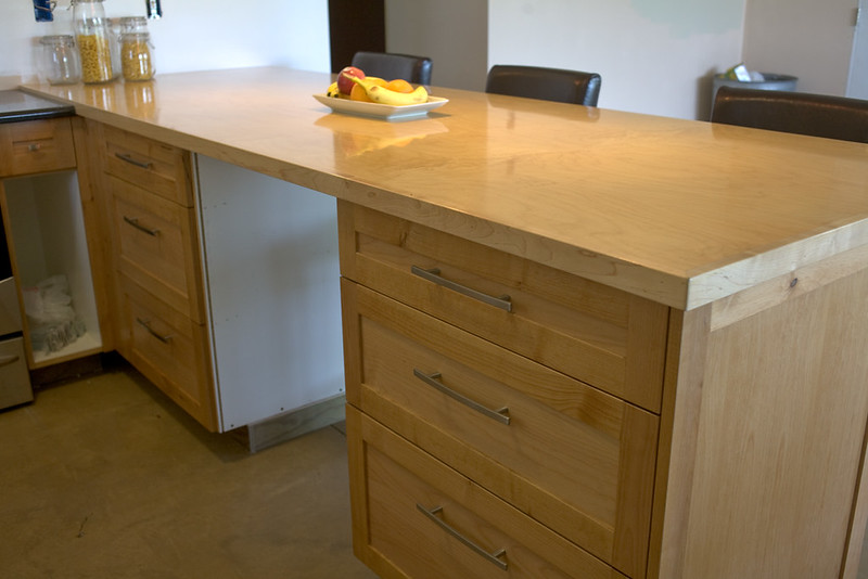

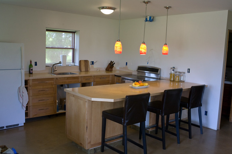

I was very happy with the kitchen layout. Nice to work in. I think I had just over 4' of space between the counters, which most information said was too little, but I thought it felt about right. Enough room to move about but just turn around and you're at the other counter with no walking. I'm 6'1" and washing dishes hurts my back so I made the sink counter either 38" or 39" tall. The peninsula counter is the standard 36" in case I wanted a lower surface and so that standard stool heights would work. It was nice having a choice of counter heights. I sold the house to a gal that must be 5'4" max and when I asked her how she got along with the counter height she had no complaints.
20120513_003 by Alan, on Flickr
The only cabinet door was under the sink. The rest of the kitchen got drawers. This made for lots of easy to access storage. I measured most of my kitchen stuff before finishing the layout design and was surprised how much would fit in a 6" drawer and how few things actually needed a 10" or 12" drawer. I left out a cabinet in the middle of the peninsula so that there would be leg room for me to have one stool inside the kitchen. This let me face my guest(s) but most importantly let me look out my living room windows when sitting at the counter.

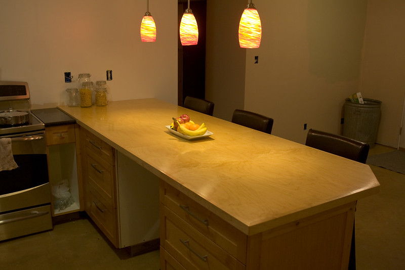

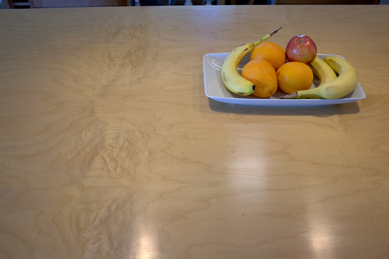

I agonized over counter top material. Go cheap and easy or go fancy and expensive? I couldn't make up my mind and decided to build my own temporary counter to get me by until I made up my mind. Ordered two 10' sheets of maple veneer MDF and it turned out great. What I thought would be short-term counter was still going strong 5 years later.
20120513_004 by Alan, on Flickr

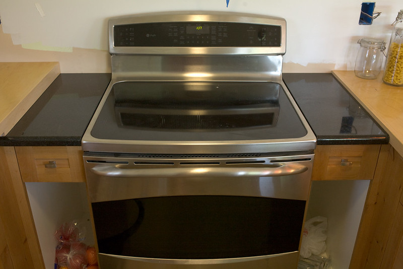

There's a place in the area that does granite counters. I looked through their cut-offs and found a piece big enough to do both sides of my stove. I think it cost me $75 to have them cut to size and the front rounded over. Made a nice place to set hot pans.
20120513_006 by Alan, on Flickr

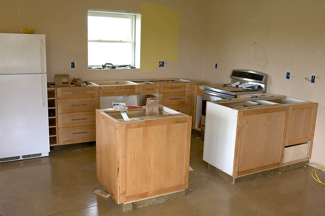

Empty:
20120513_002 by Alan, on Flickr

I love the opening in the peninsula. I could see using it as an area to sit and use as a desk .    [cool]
Alan Gage
Quote from: Rys on October 20, 2018, 08:41:53 AM
I used it as a desk plenty. Was a nice big surface to spread out maps for trip planning.
