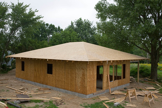

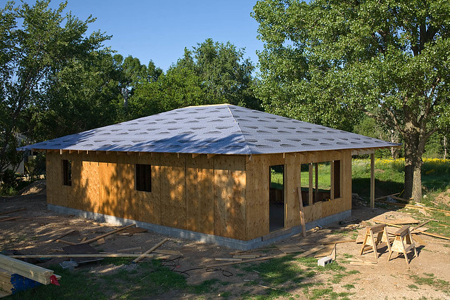

Figured I'd spend half the day putting up the synthetic felt today and then move onto other things. Instead it took all day. But it's done! Went through a box of 2000 plastic capped nails put in by hand. Really made me appreciate the nail gun I can use for everything else.
20110724_003 copy_web by Alan  Gage, on Flickr
It's really starting to feel like a house now. The other night I felt kind of lazy so I just sat on the patio where I could watch the birds and see my backyard prairie. It's going to be a great place. It's taken 3 years but the backyard prairie is really starting to look good this year.

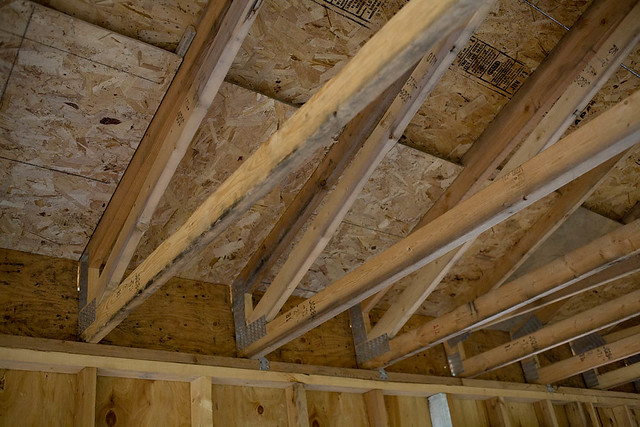

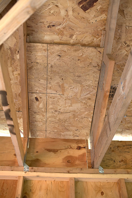

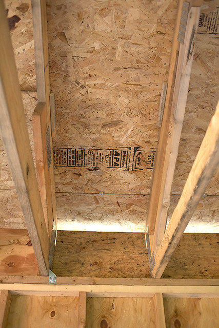

Spent all afternoon yesterday cutting up scraps of OSB and plywood to make attic vent chutes
20110725_001 copy_web by Alan  Gage, on Flickr
A couple 1x2s tacked to the top chord of the truss, just below the sheathing. The vent chute is then nailed to these leaving a 1 1/2" air gap. Pretty tedious work.
20110725_002 copy_web by Alan  Gage, on Flickr

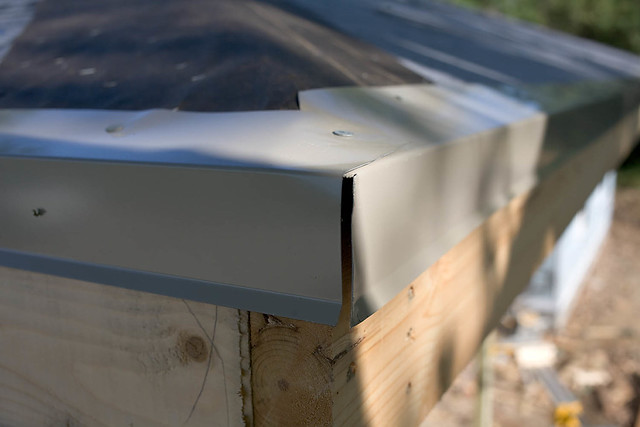

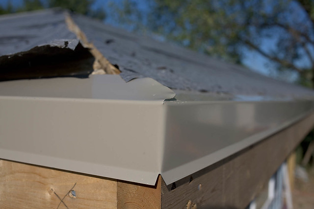

Finished up the fascia the other day and just now realized I don't have a picture of it yet. Went pretty well. I didn't know how off kilter my roof sheathing got in a few places until I put up the fascia. I'm thinking the drip edge and roofing should do a good job hiding that though. I installed the fascia straight.

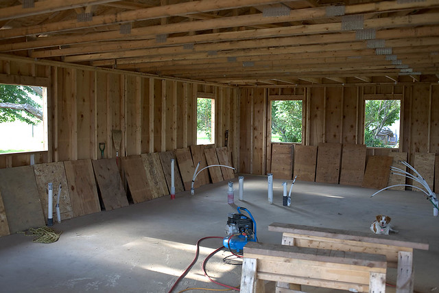

Started putting up the inside half of my double stud wall yesterday. Worked on it all day and got it finished except for the window openings, which I skipped over. Also did some remodeling on the house. I decided to add another window to the west wall to brighten up the entry and give me a better view. It seemed too dark along that wall.
20110730_002 copy_web by Alan  Gage, on Flickr
20110730_005 copy_web by Alan  Gage, on Flickr
Today I spent all day framing up those window and door openings. After a few of them I got a system figured out and it went pretty well. Decided to make one big opening for the two sets of large windows which are about 10.5' total (3 windows each). The wall isn't load bearing but I still put in a double 2x6 header so it will hopefully stay straight and true.

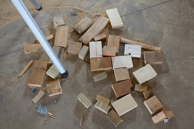

It was a good day for the twisted lumber pile since I needed lots of short pieces. I was at the saw all day long and was surprised at the end of the day to see such a small pile of scraps. I've been happy with how little waste there's been so far during the build.
20110731_003 copy_web by Alan  Gage, on Flickr

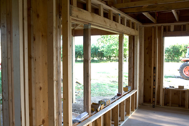

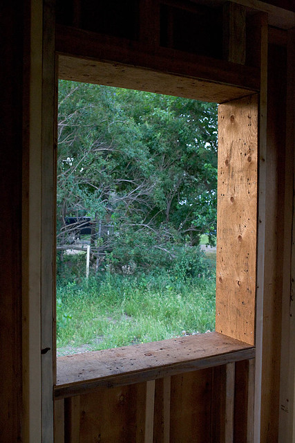

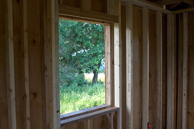

Started boxing in the windows tonight. At 10 1/2" deep they'll make great shelves during the rest of the build.
20110801_001 copy_web by Alan  Gage, on Flickr
Just the two big windows and both doors to go.

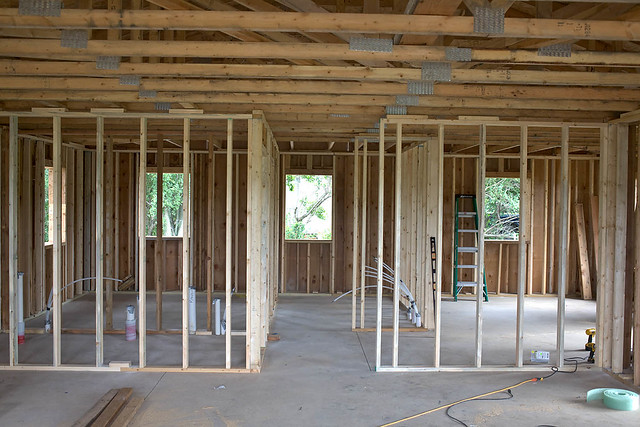

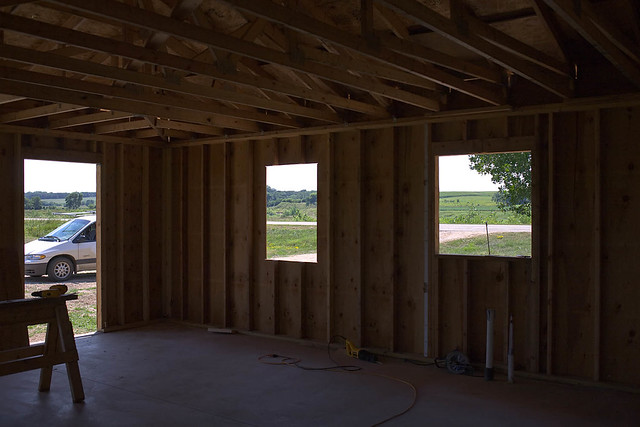

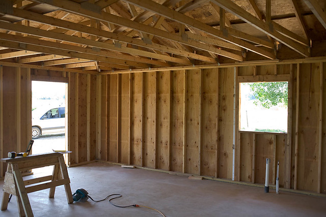

Taken from the living room showing the bathroom and spare bedroom doors:
20110807_002 copy_web by Alan  Gage, on Flickr

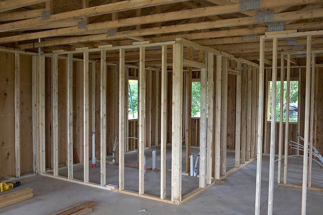

Main bedroom on the right. A pocket door will go in later so the short wall with the doorway hasn't been framed in yet. Utility/laundry is to the rear where the hallway widens:
20110807_001 copy_web by Alan  Gage, on Flickr

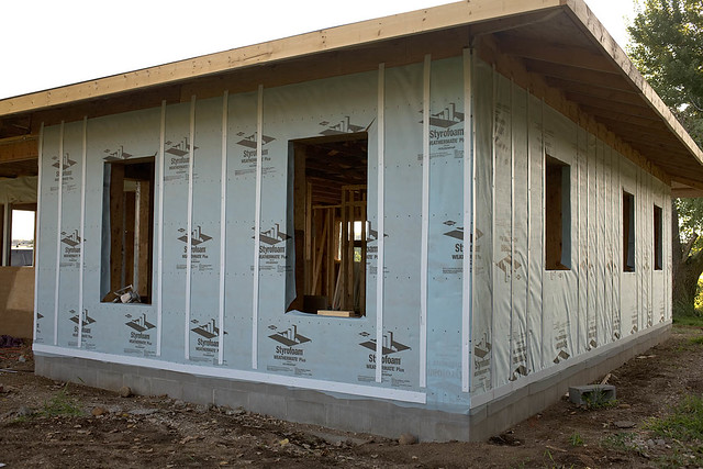

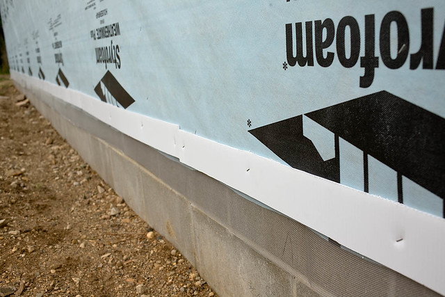

Today the housewrap and most of the rainscreen went up. Both went very well.

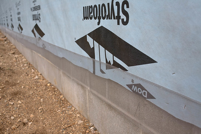

Hard to tell from the picture but the screen extends a few inches below the edge of the wall. It will be folded over and stapled later to keep out the bugs:
20110813_001 copy_web by Alan  Gage, on Flickr
Bottom of the rainscreen installed over the screen.
20110813_002 copy_web by Alan  Gage, on Flickr

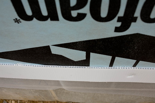

I used 4mm Coroplast (the stuff they make political yard signs with). I would have liked a little thicker but it's all I could find. Should be fine since I've just got a single story with a hip roof and large overhangs. We don't get a ton of rain either.
20110813_003 copy_web by Alan  Gage, on Flickr
20110813_004 copy_web by Alan  Gage, on Flickr

when do you need a rain screen?  and when do you need furring strips?  I'm going to start siding my house soon (hardie plank) and wasnt planning on either.   The guy who's helping me now and who did the other half of my house last year didnt use either.
thanks
Alan Gage
Quotewhen do you need a rain screen?  and when do you need furring strips?
I don't know if anyone in our climate really needs a rainscreen but I figured since I was starting from scratch I didn't want to regret it later. I really started thinking about it when I was contemplating 4x8 sheets of siding. Those would have been pressed tight against the housewrap and sheathing, not giving water a chance to run out. The rainscreen creates a small gap between the siding and sheathing so any water that gets in there can freely run out. Mine will also be vented on the top and bottom so some air can flow through as well and help things dry out. I'm hoping this will help the stain/paint last longer on the cedar. It's probably overkill on my place (single story with 3' overhangs) but it's only another $125 in materials and is going up easy.
Some reading on the subject if you're interested:
http://www.buildingscience.com/documents/insights/bsi-038-mind-the-gap-eh/?searchterm=mind%20the%20gap
http://www.greenhomebuilding.com/pdf/RainScreen.pdf

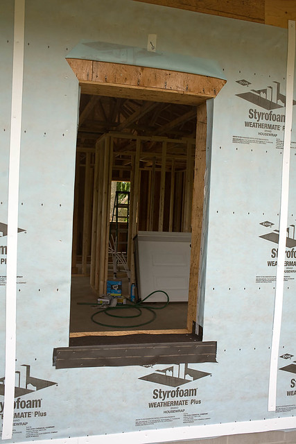

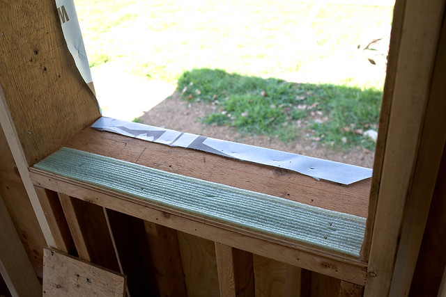

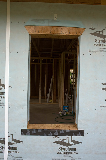

Window day today! First up was prep.
When I framed the rough openings I made them an extra 1/2" tall for some sort of sloped sill. Put some sill seal down on the inside of the opening and then nailed down a piece of plywood on top of that. Seems to work fine.
20110814_001 copy_web by Alan  Gage, on Flickr
20110814_002 copy_web by Alan  Gage, on Flickr

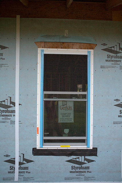

Then I went around and started flashing the sill on all the openings.
20110814_008 copy_web by Alan  Gage, on Flickr
The flashing tape I have isn't wide enough to go over the actual sill so over top of the tape I put down some #15 felt for some extra protection should water get in.
20110814_009 copy_web by Alan  Gage, on Flickr

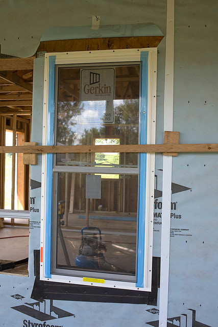

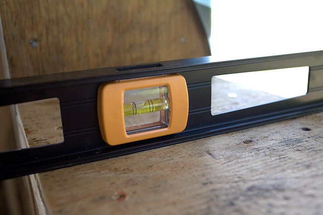

Found an easy way to hold the windows in place while getting them plumb and level:
20110814_007 copy_web by Alan  Gage, on Flickr
Got 8 windows in today and was happy with that. That's just over half of them. I still need to do the flashing tape on the sides and top.

how important do you think the slope is on the sill? i'm just finishing my whole house (two of twenty two left) and didn't do that.
i did put the window tape / flashing on the sill (top outside edge) and then another piece that overlapped the top by 1 inche and wrapped down the outside wall about 3 inches.
Alan Gage
Quotehow important do you think the slope is on the sill? i'm just finishing my whole house (two of twenty two left) and didn't do that.
I don't know just how important it is. This is all new to me so I don't have any other experience. I saw a lot of people recommended it when I was researching how to flash windows and since it wasn't much extra work and no extra expense (already had extra sill seal and plywood scraps) I figured why not.
Quotei did put the window tape / flashing on the sill (top outside edge) and then another piece that overlapped the top by 1 inche and wrapped down the outside wall about 3 inches.
Maybe I'm reading it wrong but I think you'd want the piece that laid flat on the sill and lapped down onto the wall to go on after the piece that stuck vertically to the outside of the wall to get the overlaps right.

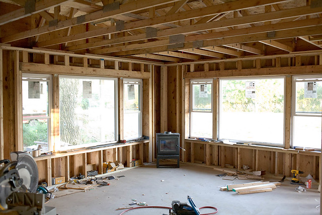

Slow day at work so I got off early this afternoon and got in about 5 hours on the house. Very productive evening.
Finished installing the last of the windows and got all the side flashings on. My dad came out to give me a hand with the 2 big picture windows. The only window left to go is the one I decided to add a couple weeks ago. It hasn't shown up yet. Also got up on the roof to put down some strips of tarpaper over the lower hip ridges where I ran out of synthetic felt.
20110815_001 copy_web by Alan  Gage, on Flickr
While my dad was there we drug the wood stove into place so I could figure out where the chimney penetration will be. Hopefully I'll be putting down the roof later this week so I need to get ready for it. Starting to look like a house.
20110815_002 copy_web by Alan  Gage, on Flickr

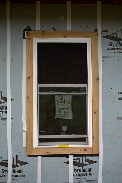

Last I left off the trim was all cut out but not finished yet:
20110820_001 copy_web by Alan  Gage, on Flickr
I decided to do the trim white and thought it might look good with a white tinted semi-transparent stain rather than a solid paint. I was wrong, it looks terrible! Of course I couldn't do something sensible like testing it on a couple pieces, instead I did them all. So now I need to go back and paint them all with a solid white.

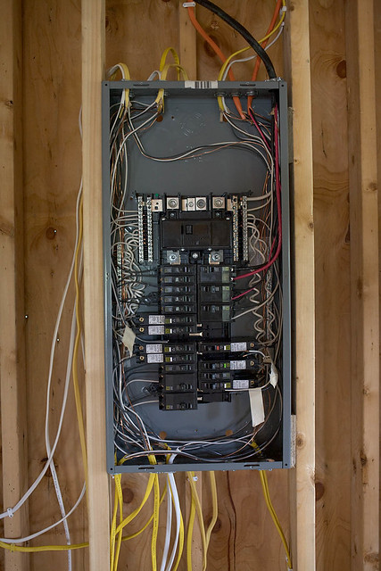

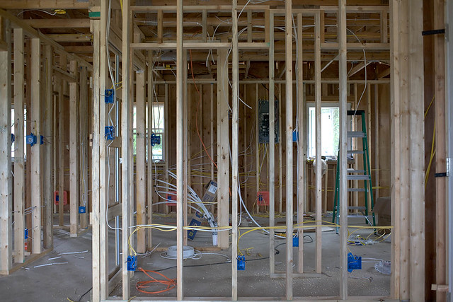

I was fortunate that the guy I was going to hire to do my electrical offered to let me do the rough in and that he would come out and inspect my work, then pull a permit and have the inspector come out. I was glad to be able to do it myself and spent a few days working on it since my roof didn't show up when it was supposed do. The house ate up a lot of wire.
20110903_003 copy_web by Alan  Gage, on Flickr
Lots of AFCI breakers required and they really added up. Spent about $500 on breakers (Still need to add a couple, I bought out the store):
20110903_001 copy_web by Alan  Gage, on Flickr

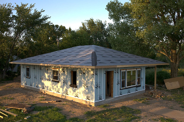

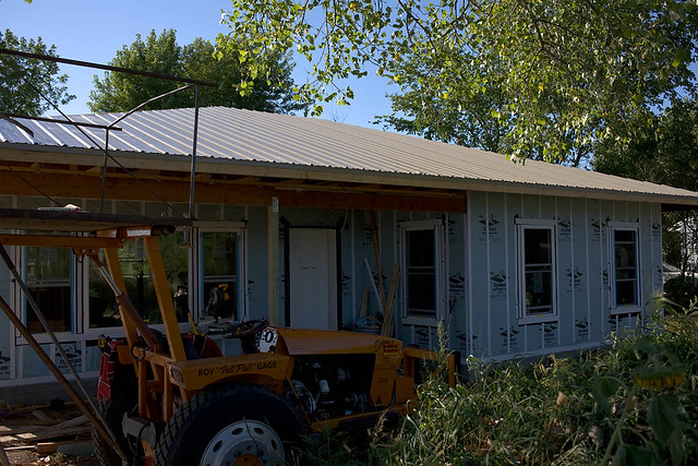

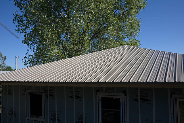

I'd been waiting for the roof for 3 weeks and had hoped to have it done by now but it finally showed up last Saturday, just before it started raining. It dried out later in the day and I was able to get the drip edge put up. I wasn't happy with how it came out and fretted about what to do all night. Went back in the morning, pulled it back off, and redid it. Much happier with it now with the steel bent around the corners and lapping under the underlayment instead of over it (which is what most seem to recommend).
Before:
20110904_006 copy_web by Alan  Gage, on Flickr
After:
20110904_007 copy_web by Alan  Gage, on Flickr
After lots of thinking about fastener location and amount of overhang it was finally time to get the roof up. I got my dad to come out and help and in a few hours we had half of one side done. We put them up with just enough screws to hold them in place and after he left that evening I went up to finish putting in all the screws.
We hit it again the next morning and about 2 hours into it I went to grab another bag of screws only to find out they were different than the ones I'd been using. These were shorter with a different washer. ARG! These were the correct ones. I'd been using the screws for the ridge caps. Never even thought about it, I'd just grabbed a bag out of the box. So I got to pull out all the screws I'd set and put the new ones back in place.
After that things went smooth and when my dad wussed out at 5pm we had half the house done. Happy with the progress and I think we should be able to get it finished up by mid-week working after work. Then it will be time to finish the trim and get to work on siding.
20110905_002 copy_web by Alan  Gage, on Flickr
20110905_001 copy_web by Alan  Gage, on Flickr
Fingers crossed that electrical will get dug into the house this week and that I won't have to string extension cords from the shed.

dug
Great job on the wiring! I am impressed at the quality and speed of your build so far, one of my favorites on this forum right now.   [cool]
