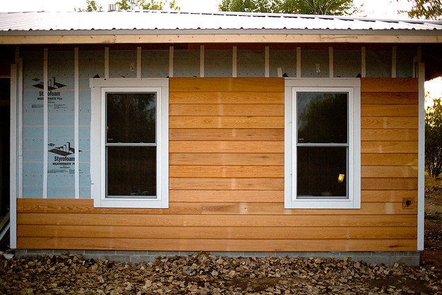

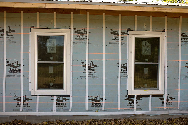

As promised, some pictures:
The last of the siding drying out earlier this week after applying water repellant preservative to all 6 sides. They'll be stained after installation.
20110913_001 copy_web by Alan  Gage, on Flickr

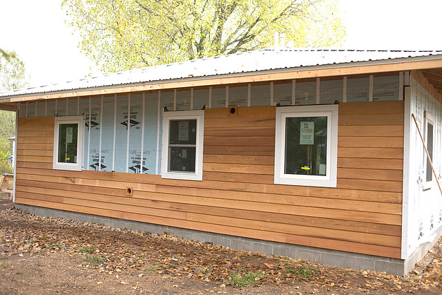

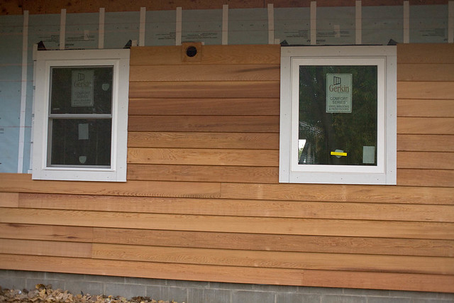

What got accomplished over the weekend:
20110918_002 copy_web by Alan  Gage, on Flickr
20110918_003 copy_web by Alan  Gage, on Flickr
20110918_004 copy_web by Alan  Gage, on Flickr

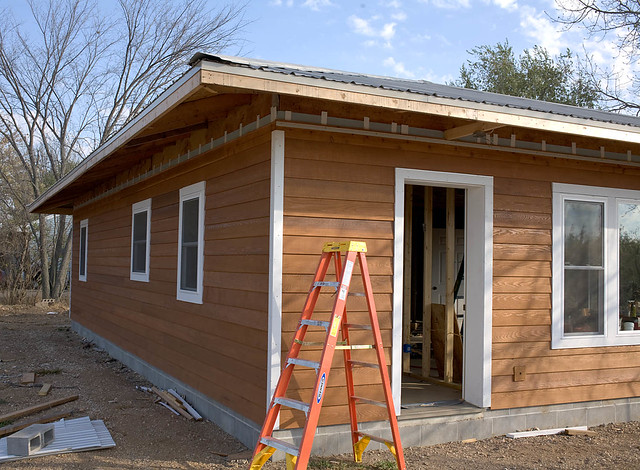

The siding has been going up smoothly but I'm surprised how slow the progress is. The bottom 2 courses were done yesterday and today I spent a solid 10 hours working on the house and did almost nothing but siding. Had a friend to help hold the long pieces for most of the day. When she left I did the short pieces between the windows. Hopefully it will speed up as I go along. At least it's not fighting me.
It's exciting to see the outside start to take it's final shape.
Alan

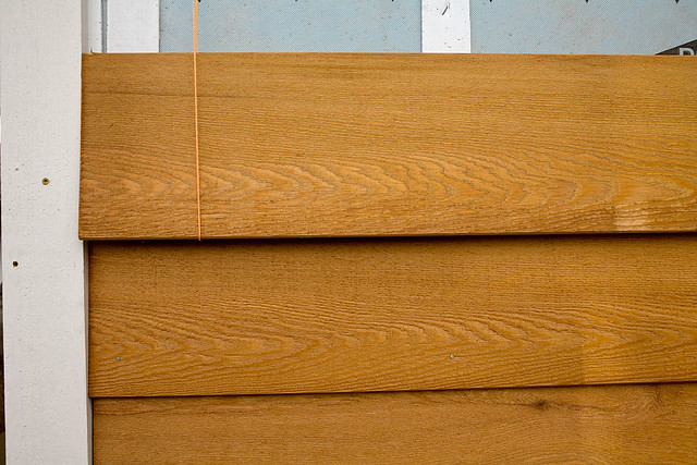

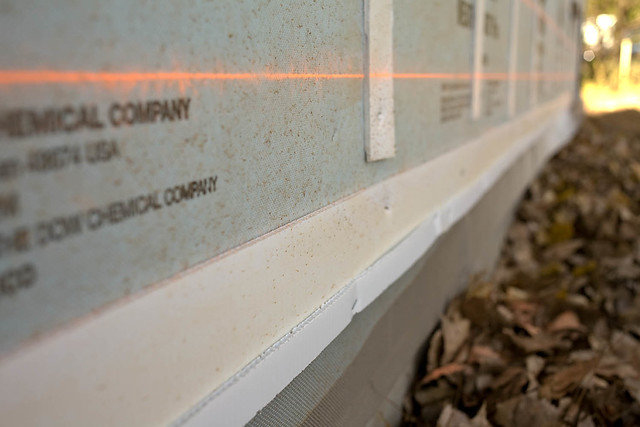

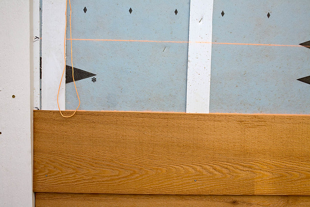

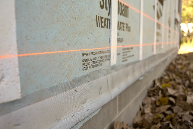

Snapped:
20110920_001 copy_web by Alan  Gage, on Flickr
The starter strip:
20110920_002 copy_web by Alan  Gage, on Flickr
Folding the screen up:
20110920_003 copy_web by Alan  Gage, on Flickr

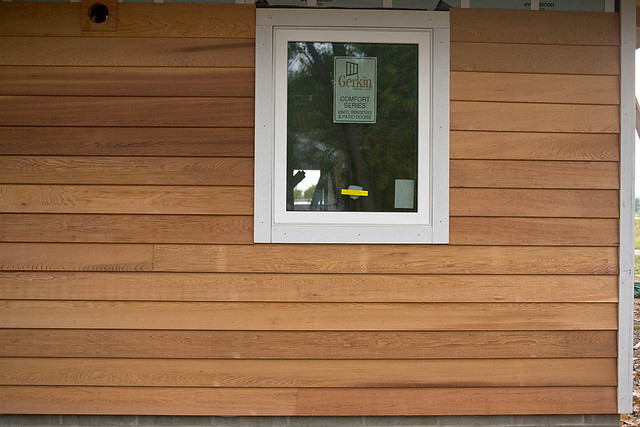

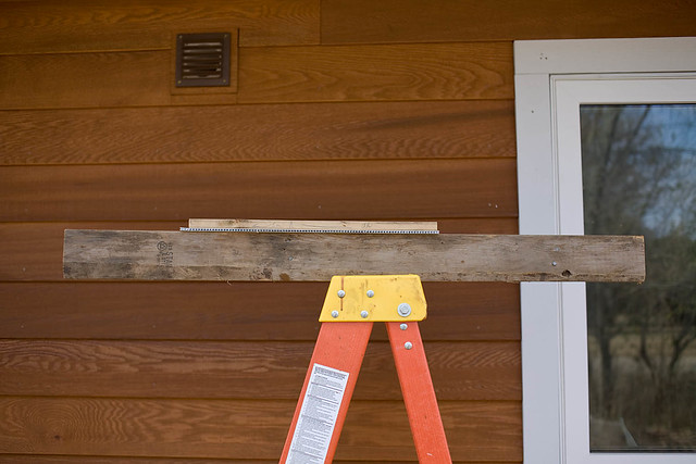

Today though I got out of work around 2:00 and after putting up a couple corner boards I finally started putting up another wall of siding. The first pieces were 17' long and I didn't have anyone to hold the other end so I looped a string around a nail higher up in the wall:
20110922_001 copy_web by Alan  Gage, on Flickr
Slipped the siding through to loop and it held the piece without protest. I'd just shorten the loop for the next piece.
20110922_002 copy_web by Alan  Gage, on Flickr
I'm getting more comfortable with the siding and it seems to be going up quite a bit faster. Less thinking and more nailing. I don't know when I actually started putting up siding today but I think this took about 3 1/2 hours. Notching around the lower windows and the penetration on the right took a fair amount of time.
20110922_003 copy_web by Alan  Gage, on Flickr
Hoping I can get some good time in on it tomorrow and I'll spend the whole weekend on it too. Would be nice to have it wrapped up before next week. The extended forecast looks great and I really want to finish up the outside of the house. My replacement ridge caps showed up today too so I'll have to go back up and have a battle of wits with them again. Hopefully I'll win this time.
I'll end with a shot of my faithful helper catching some rest at the end of a long day. She's been there every hour I have this year.

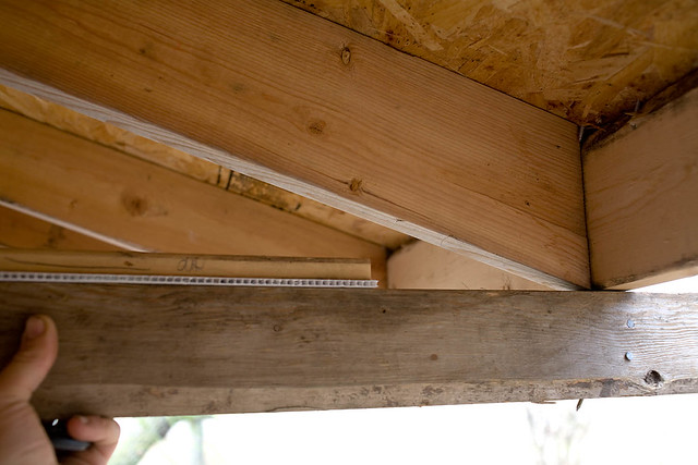

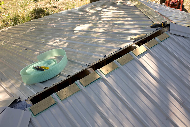

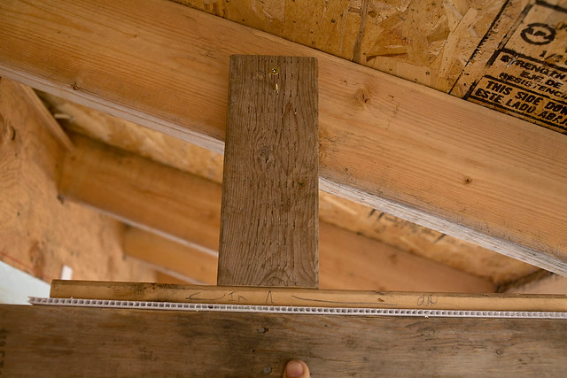

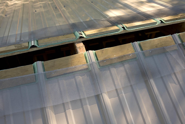

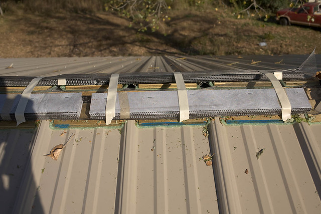

First I had to set up the ridge vent. With a hip roof I have a very short ridge (about 8') and I want as much air flow as I can get. I wasn't too confident the plastic brillo pad stuff would give it to me. So I came up with another idea to use 4mm coroplast (same stuff used for yard signs by politicians). It's what I used for my rainscreen as well. I bought 10 4x8 sheets of it for $120 earlier this summer and had some extra.
First I laid down some sill seal and then 1/2" plywood on top of that. This filled in between the ridges and they were at pretty much the same level:
20110913_002 copy_web by Alan  Gage, on Flickr
Then stapled screen to the plywood to wrap over the coroplast later to keep critters out:
20110913_004 copy_web by Alan  Gage, on Flickr
The other reason for using the coroplast ridge vent was to raise the ridge cap up so it would (hopefully) be easier to detail with the hips. 5 layers seemed to be the right amount. The ridge cap pretty much laid right on top of the hip caps with this thickness. The tape is just to hold things together.
20110924_002 copy_web by Alan  Gage, on Flickr

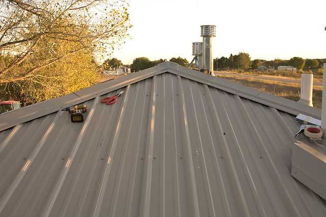

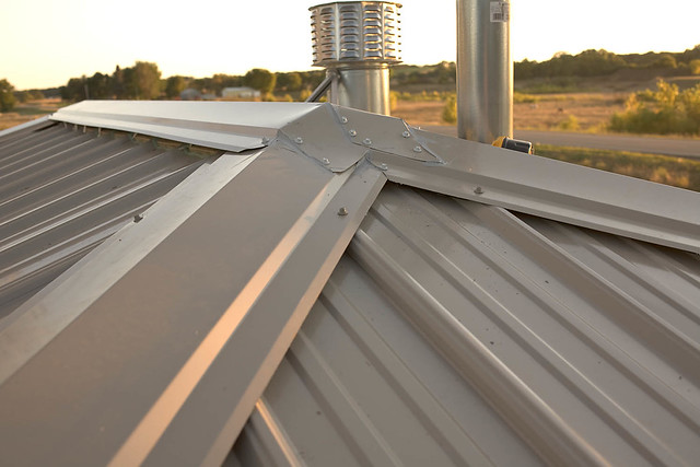

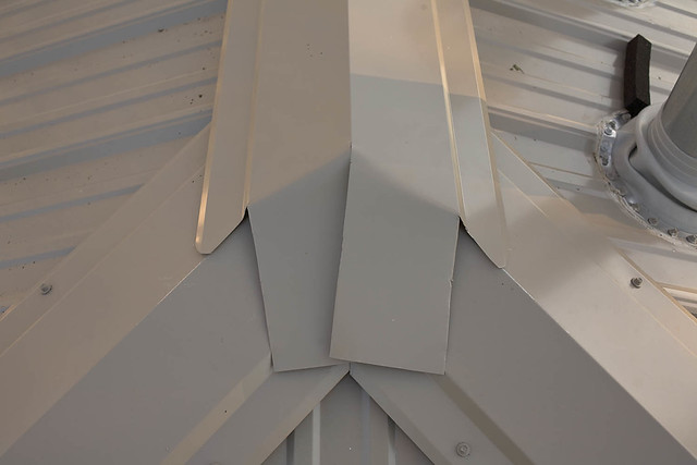

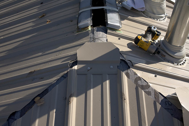

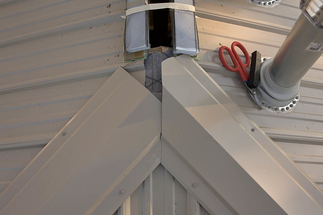

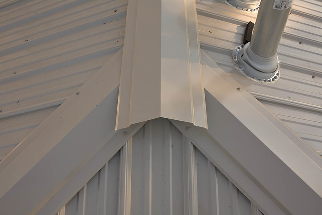

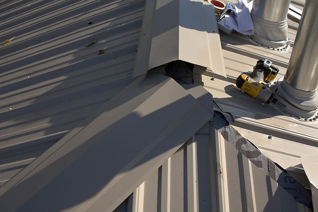

Now onto the hip/ridge transition. I've spent hours looking online for some sort of instructions and found very little, and no pictures. Frustrating. So this is the best I came up with.
First screwed down a piece of scrap to direct out any water that gets through:
20110924_003 copy_web by Alan  Gage, on Flickr
Set the 1st hip cap so the lower edge would be well covered by the ridge cap:
20110924_004 copy_web by Alan  Gage, on Flickr

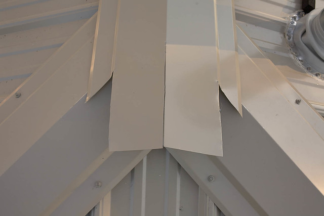

Ran the next hip cap over the 1st and cut it at a 45. They lay together pretty nice this way. I probably could have ran the first one up a little higher but there's plenty of overlap.
20110924_007 copy_web by Alan  Gage, on Flickr

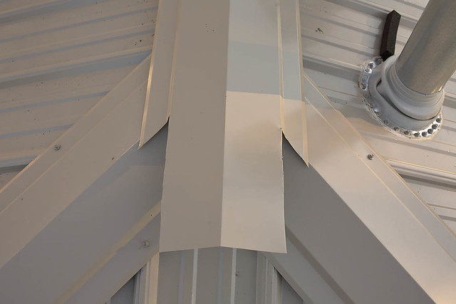

Set the ridge cap over the hips and marked where the edges of the ridge cap touched the hips:
20110924_010 copy_web by Alan  Gage, on Flickr
Cut off the outer "wings":
20110924_011 copy_web by Alan  Gage, on Flickr
Cut it right down the center:
20110924_012 copy_web by Alan  Gage, on Flickr
Now it's foldable:
20110924_013 copy_web by Alan  Gage, on Flickr
After some fiddling, fitting, and trimming:
20110924_016 copy_web by Alan  Gage, on Flickr

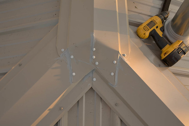

I used 3/4" stitch screws to hold it together. White were the only ones I could find locally but it's not noticeable from the ground.
20110924_017 copy_web by Alan  Gage, on Flickr
20110924_018 copy_web by Alan  Gage, on Flickr
I think it was layered and lapped enough that the butyl caulk wouldn't have been necessary but it's just such fun stuff to work with I figured I'd use it anyway.  d*
I have no idea if this is the "correct" way to do this or not so feel free to point out how it should have been/is usually done.

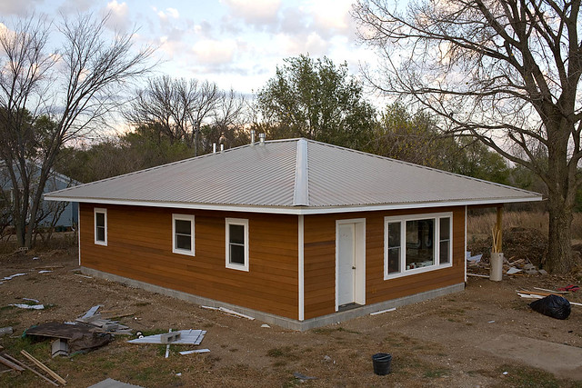

And finally, after a couple weeks of waiting, I can finally post a picture of the roof now that it's finished:
20110924_019 copy_web by Alan  Gage, on Flickr

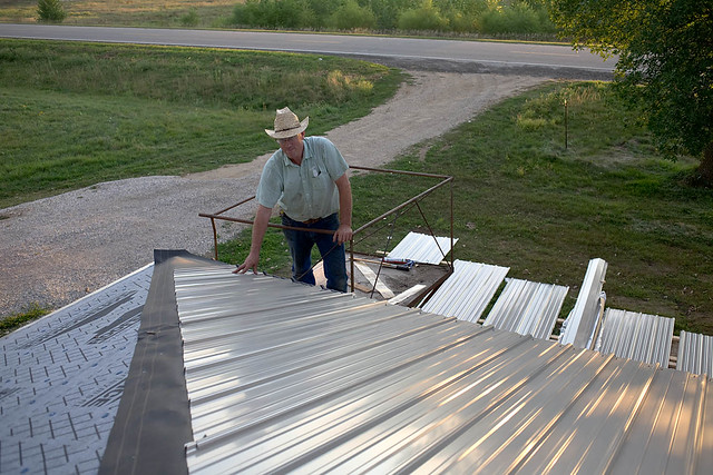

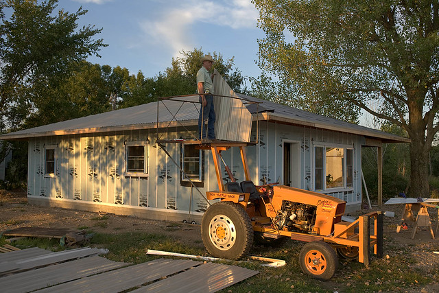

Someone asked about the monkey cage on the tractor my dad and I used to install the metal roof.
20110906_001 copy_web by Alan  Gage, on Flickr
My dad made it to go on his homebuilt tractor years ago when we were remodeling the shop. Once in a while it gets pulled out of the weeds and put to good use. It's very handy! There's plenty of room for two people (4x6 platform I think). Not only is it nice to work out of it's a nice way to climb up and down from the roof. Feels much safer than a ladder and with the railing you can really lean to reach something.
Perfect height:
20110906_002 copy_web by Alan  Gage, on Flickr

Quote from: Alan Gage on September 24, 2011, 09:58:15 PM
Looks like terrific metal work to me! I know how tricky that can be, and I doubt most people would bother to be as thorough or tidy as your job!
That butyl is fun stuff... Ruins your clothes takes a week to come off your hands.

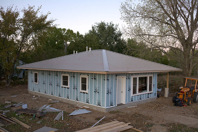

This is where things sit after today:
20110927_001 copy_web by Alan  Gage, on Flickr
I'm out of siding now. I intentionally ordered too little so I wouldn't get stuck with a bunch extra. Everything is done with the exception of the patio area (and that small section you see by the door and the long pieces above the windows/doors on the walls you see). Tomorrow I'll try to figure out how much more I need and get it ordered.
In the meantime I need to figure out for sure how I'm doing the frieze board and see if there's any way I can start getting the soffit installed before the rest of the siding shows up (probably a week). Also need to box in the beams over the patio with cedar 1x material. Oh, and I suppose I can start putting the final stain on the siding and grading around the house too. I'm sure there are about a million other little things that need to be done before I can consider the outside buttoned up.
Really hoping to see the electrical inspector this week and to get power dug into the house. I've been waiting for both of those to happen for 3 weeks now. Thankfully it's been good weather so I've been working outside but soon I'll need to start getting those walls insulated and some lights in the house would be nice now that it's getting dark so early. That would allow me to extend my workdays a couple hours, which would make a big difference.

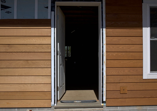

Got the siding stained a couple days ago. I'm quite happy with the color. Pretty close to natural and helped even out the tones (some were quite dark). The stuff on the right has been stained. The siding on the left has only been treated with a WRP.
20111002_001 copy_web by Alan  Gage, on Flickr
Today I spent most of the day wrapping the porch beams with 1x cedar. I'll do the posts another day. Also started putting up some of the siding in the patio. The last of the siding I ordered should show up next week.
20111002_003 copy_web by Alan  Gage, on Flickr

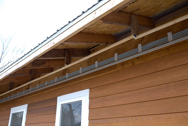

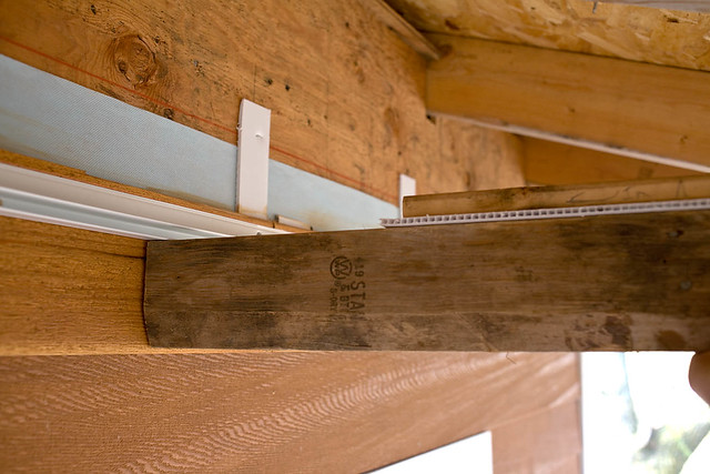

Spent the whole weekend working on the soffits (vented aluminum). Another 30 minutes of daylight and I would have had it whipped. It started off pretty slow trying to figure out how everything was supposed to go. Reading through the installation instructions I found that my overhangs are wide enough that I'd need to build a center support. They recommended hanging a short piece of 2x4 from a truss every 8 feet and then attaching 1x2s or 1x4s to these. I decided to use 1x2s but hung a 2x4 every 4 feet for support instead of 8.
Did some thinking on how to make this process fairly quick and painless and came up with a nice solution. First I hung one of the 2x4 supports with a level and tape measure and used it to make a little jig. Just a straight piece of 2x4 with a chunk of 1x2 nailed to the top and a spacer to set the correct height.
20111008_001 copy_web by Alan  Gage, on Flickr
One end goes under the F channel:
20111008_002 copy_web by Alan  Gage, on Flickr
The other under the fascia:
20111008_003 copy_web by Alan  Gage, on Flickr
Set the piece of 2x4 over the center mark and nail into place:
20111008_004 copy_web by Alan  Gage, on Flickr
Then nail the 1x2s to along the length of the house:
20111009_003 copy_web by Alan  Gage, on Flickr
Worked out great but still pretty tedious work. The tedium didn't end there either. Installing the soffits was no thrill ride either. Lots of climbing up and down the ladder and cutting. Cut, climb, nail, repeat. Finally hit my stride around mid afternoon today and really started to cover ground. Night came just a bit too soon though. I'll post pics of the soffit when it's done.

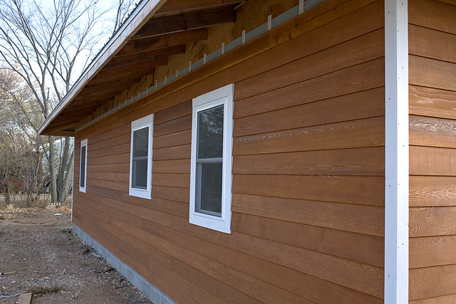

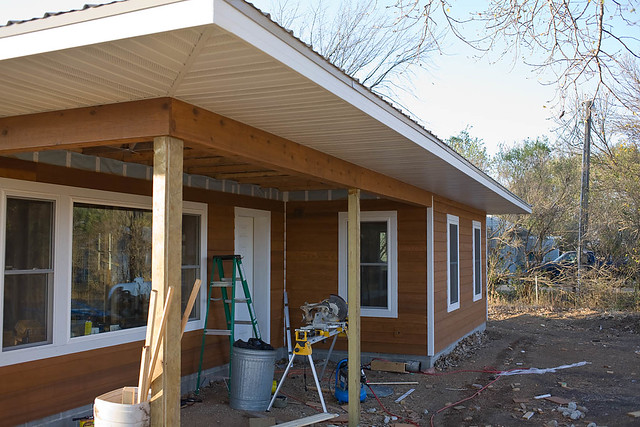

Finished up the soffits yesterday and almost got the fascia cover done but I came up one piece short. Finished it all up today. I'm happy with how it turned out. That pretty well buttons up the outside of the house except for the ceiling over the patio. I've got those boards cut already and they just need one more coat of paint before they go up. Started putting up the strapping on the patio ceiling today and framing in an attic access.
Pre and post soffit:
20111009_002 copy_web by Alan  Gage, on Flickr
20111011_001 copy_web by Alan  Gage, on Flickr
20111009_001 copy_web by Alan  Gage, on Flickr
20111011_002 copy_web by Alan  Gage, on Flickr
20111010_001 copy_web by Alan  Gage, on Flickr

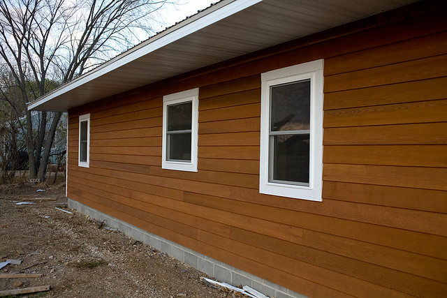

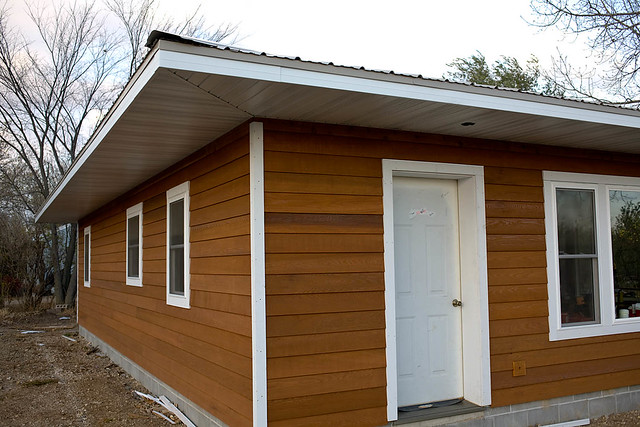

And the finished view of the exterior. The only changes will be swapping out the beater exterior doors for the final doors and cutting the chimney through the roof for the stove.
20111011_004 copy_web by Alan  Gage, on Flickr
The weather is supposed to stay nice the rest of the week so I'll probably spend it outside finishing up a lot of little things. Then it's time to get back inside and start insulating.
