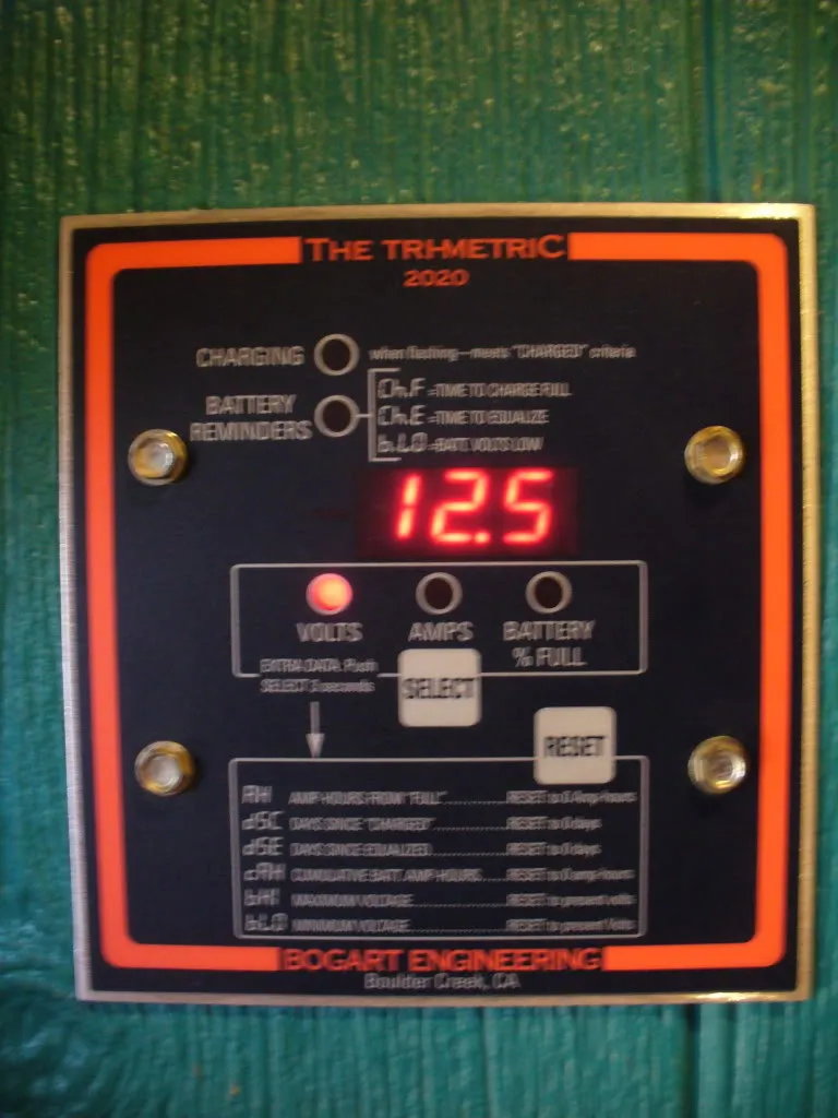

Thought I would post a few more pics of life here at the place we now call home. Not much progress. I have been cutting and splitting alot of wood. Planted a ton of cedar trees up on both sides of the drive leading down and all along the front border of the property. Built a composting bin, chicken coop and went and picked up my chickens from my dads. He had been keeping them in with his chickens for me. I have collected several eggs the past few days and I have just recently begun to supplement their day with artificial light. (3.5 watt LED spotlight on timer) Also added a Trimetric battery monitor, waiting for my shunt to come in to get accurate readings. Also picked up 5 more MAXX-29 batteries. Brings me to a grand total of 1875 Ah. And then below the house you see my temporary set up for the diesel generator we currently use to charge the batteries until we can save up the funds for our solar panels. I also added a dryer vent and a 80mm high efficiency fan for ventilation in the battery room. I was amazed at how much air it moves. And it only uses 1.44 watts!
I tied all my batteries together with a 1/2" copper pipe flattened out and then drilled holes for all the screw on post. This is ALOT cheaper than buying cables to connect all of them. Probably going to cover them with foam pipe insulation to prevent any tool mishaps from stopping my heart. Also upgraded all the battery cables and inverter cables to 1/0 size from the 4 gauge wire. i have noticed an extreme performance gain in my system. I am working on making a heat shield for the wood stove and will post pics when done.
Here are a few pics to supplement all my talking. Two are of the view off the back porch or the small pond stocked with bass. And the other is of the table I built to feed the critters off of.

   Neat trick - using ½ copper pipe for cabling.

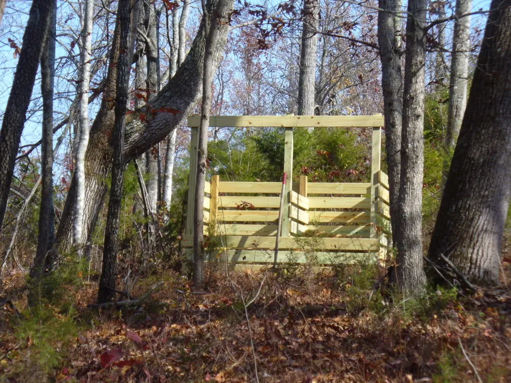

I have kind of a engineering question for you all. Lindsay and I were wanting to stack fire wood in between all the concrete piers because 1. we have to stack it somewhere and 2. it will keep the wind down and hopefully not hit the water pipes as bad. Question is this: Will it cause severe stress on the piers with the wood "leaning" against them?
My thoughts are this:
"if thats all it takes to bring the house down then I didnt have much to start with"
"maybe all the wood stacked in between them will sort of brace them"
and last but not least
"if it does cause a problem and they lean and collapse then  Ill have a nice firewood foundation for the house to rest on"
What are some thoughts from you all? Keep in mind this will just be for this year. Next year when it gets warm again I will brace all the piers with steel cable and underpen the house normally to keep the wind out. I just ran out of money this year.
Offline dug
  • Senior Member
  • Posts: 762
  • SW New Mexico
Re: 20x32 A frame cabin Central KY
« Reply #121 on: November 16, 2010, 02:34:49 PM »
I'm going to throw out a guess here and say that if anything it would sort of brace the piers more than anything else. I can't see how it could cause any damage with the footers in the ground and the piers attached to the beams on top.
A bigger concern would be the potential infestation of bugs, wood rats, rattlesnakes, etc., but probably not a worry over just one season.
