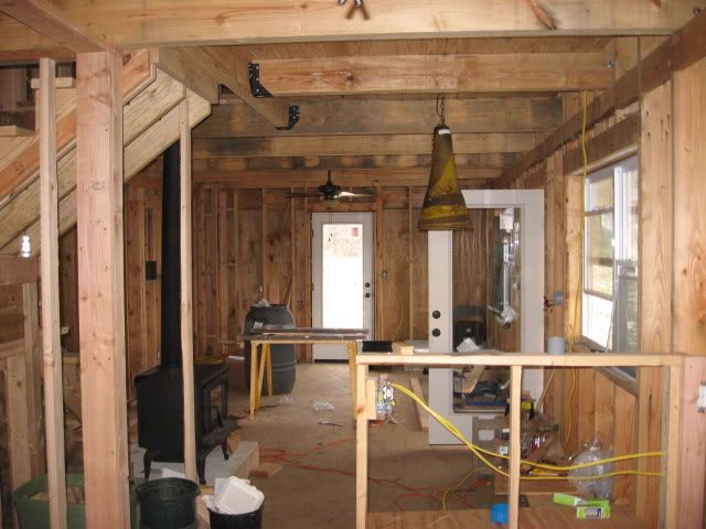

That's great, that's really great. Can I ask the approximate dimensions of your bathroom downstairs, and the two rooms upstairs?
Great placement of the stove. This is just perfect. Thanks so much for the photos.

Muldoon- I like the woodstove too!  I've only had closed woodstoves and the addition of the window is really nice.  I can't believe how well a high efficiency stove works!  The air movement is very controlled and allows all the wood to catch very easily.  The secondary burn chamber almost completely rids the stove of smoke.  I suppose any stove would be an improvement over the giant, very inefficient stove I currently use!

Raindog- thanks for the compliment.   As you can imagine, the bathroom is long and slender at 12x6.  Actually it's a little less than 6 ft.  It feels sort of like a hallway with bathroom fixtures!  The house that I'm living in now has a bathroom with similar dimensions so I know it will work for me.  The rooms upstairs are 13x16 and 13x12.  I can stand within 32 inches of the outer wall so I only net 8x the long dimension.  I was surprised by how large the rooms feel.  I really was expecting it to feel cramped but I'm very happy with it.

Another question on the stove.  Is it necessary to put a hearth on the floor in front of the stove?  With the stove so close to the edge of the platform, it might be a good idea.
jdhen
Poppy- Just an old but trusty Canon power shot that I've dropped several times. Just used the basic zoom feature.  I did study photography for several years at an art school in Boston but that was many years ago!  Digital wasn't even being used yet by the masses!
As for the hearth, yes, I do plan to place either a removable tiled/framed hearth or I've also been looking into the 100% wool hearth rugs.  That might be an easier way to go.

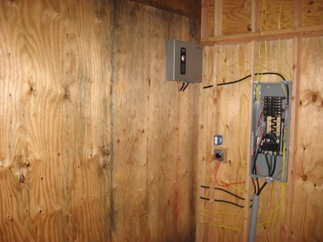

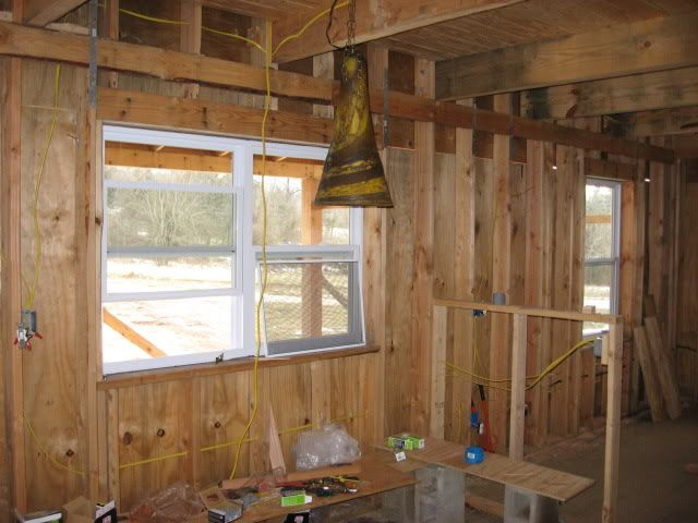

I'm still here.  Just came up for air after spending the last 2 weeks or so busting my knuckles on studs while trying to thread long runs of 6-3 wire for the stove and the hot water heater....arrrrrgggghhhh.  Just finished wiring the last 3way switch and hooked up the water heater today.  I'll have the electrician come in and check our work sometime next week and hook us up to the grid.   Hooray!  No more schlepping the 100 ft extension cord from the meter stand!!
Not much to see....the place is a mess......but at least I get to start tackling the plumbing....I think pex is a little easier to bend  ;D
Here are a few shots of what's happened lately...

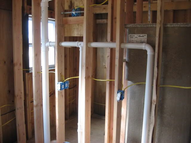

We've started in on the the plumbing.  Still a few more electric details to work out like running some wire to a future sub panel that will bring power to an addition that we'll add in a year or so.  Also, I added a whole house fan by Tammarack.  It's not suppose to create a breeze but the reviews are good when it comes to cooling things down a few degrees at night in the summer- especially upstairs, I hope.
Here's a few plumbing shots- everything's just dry fitted so far.  I need to look at it a while before gluing  :-\
The plumbing wall for the bathroom and kitchen.
Drains under the wall-  We'll be using the gray-water but I've plumbed it so that I can turn it to the septic tank if conditions are too wet for additional orchard watering.  Only the toilet is plumbed directly to the tank.
These two ball valves control the flow to either the gray-water or the septic tank.
I got the idea from "Building with Awareness"  a book and DVD by Ted Owens http://www.buildingwithawareness.com/
I'm also using this book http://oasisdesign.net/greywater/createanoasis/index.htm  by Art Ludwig.
It's a bit unconventional but I'm hopeful that it will work!
Jesse

However, I did notice in your plumbing photos (reply#192) the it appears that the "T" fitting in your main vent stack is upside down.  It's hard to tell from the pics, and I could be wrong, but if that is your main vent (dry) then you should turn that fitting around.

Darrell- The sleeve for the sewer pipe is in the footer.  It's in the top quarter and since it's 18 inches deep there I'm not too worried about cracking.  It's reinforced with rbar and I think it's standard practice around here to place it there.  The greywater sleeve (the higher one) was knocked out with a hammer before the core fill was completed.  You'd be surprised how exact you can be with some gentle knocks of the hammer.
For the sleeves I used 4 inch pipe with an appropriate slope to it.  I'm just attaching to in with a 3 to 4 reducer and my septic installer just glued 6 inch outside the foundation for the run to the tank.
