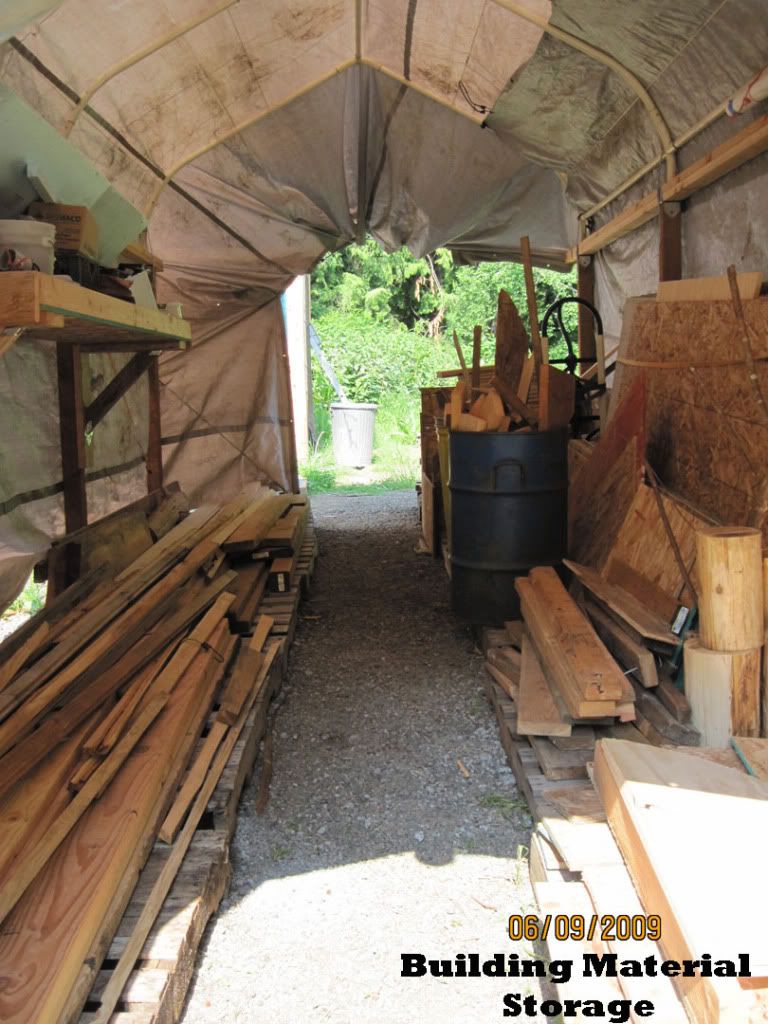

Don't kid yourself, this is about the most organized I've ever been.

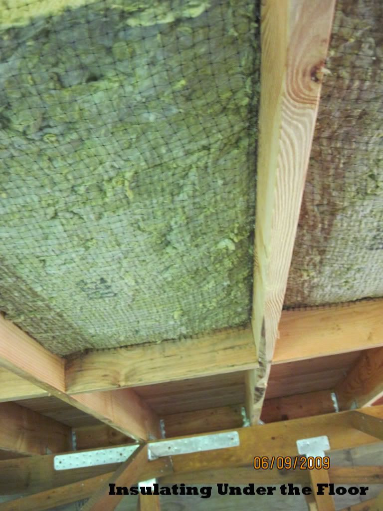

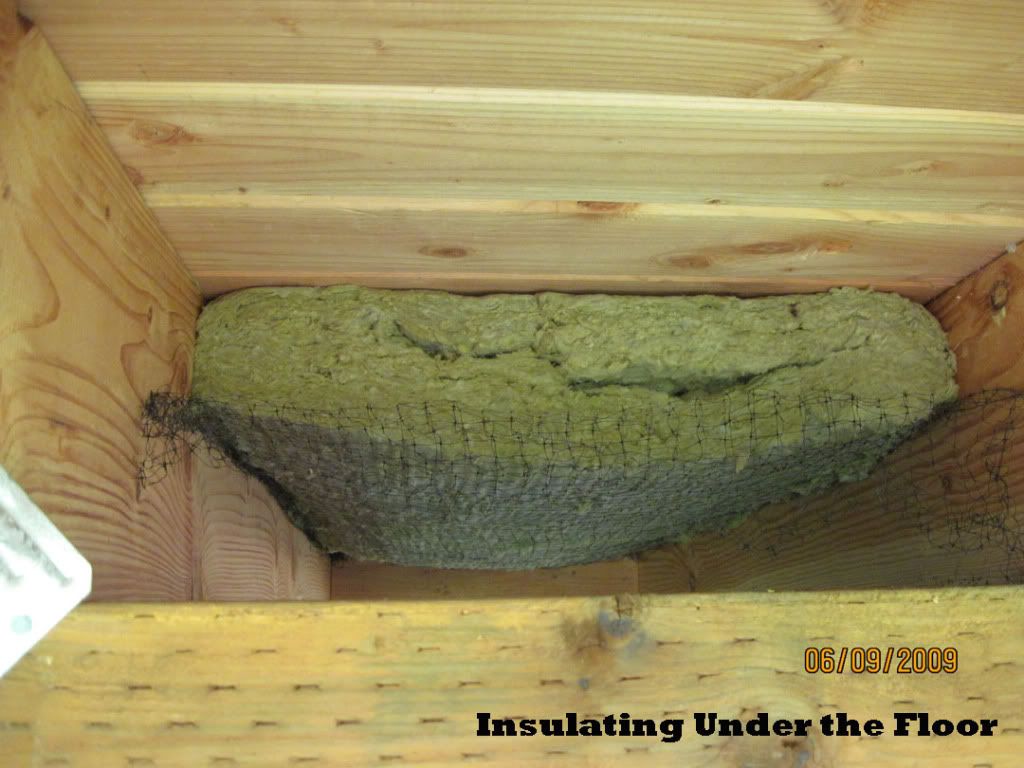

Current project...insulating under the floor.  Roxul and bird netting.  Great job if you are a contortionist.

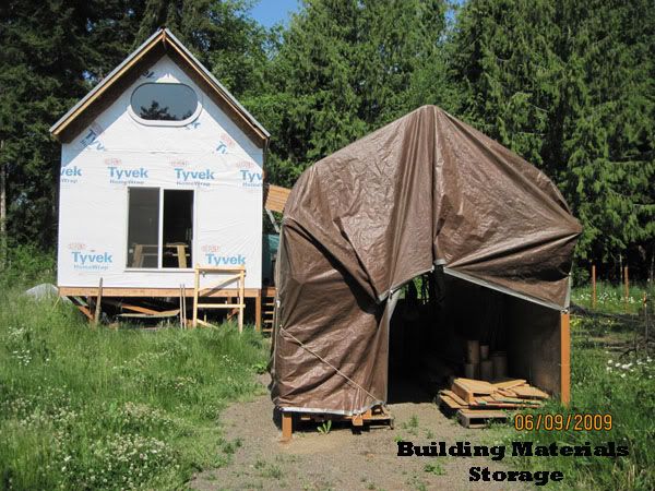

What did you use for the 'rafters' on your material storage shed?  It looks like pcv pipes?(like they use in greenhouses alot).
Also where did you get the Roxul insulation, I just saw that on TV, it was a show about all the new stuff at the International Building Show.  I did a search, found the co. but it sounded like you could only get in Canada.  That stuff is suppose to be awesome, fire proof to something like a million degrees  ;D , repels water and mold.
Luv your home - it's so cool, and congrats on a tremendous job!
considerations That's not unorganized.  You can still walk between the piles.  When you have to jump and climb over to get to the back then that's unorganized.  Good job.  Just wondering about the insulation. Is there a moisture barrier?
Looks pretty tidy to me. Do you have a problem with cat hair now that it's getting warm or does the cat stay outside in the summer. We made our last cat stay outside but something ate him. Our new cat sleeps on the bed.
"What did you use for the 'rafters' on your material storage shed?  It looks like pcv pipes?(like they use in greenhouses alot)."
I used what was left of 2 10' x 20' carports that I bought at Costco for about $200 each about 10 years ago.  They have enameled metal tubing for a frame, including "legs", and tarps for cover.  They both got pretty much wadded up in balls a few years ago when we had a major windstorm.  Being the heir apparent to the King of salvage (Glenn), I could not throw away the undamaged parts. I had enough for a roof.  Before the weather goes bad this year, I'll sheath it in metal.
"Also where did you get the Roxul insulation, I just saw that on TV, it was a show about all the new stuff at the International Building Show.  I did a search, found the co. but it sounded like you could only get in Canada.  That stuff is suppose to be awesome, fire proof to something like a million degrees, repels water and mold."
Well, not a million, but since it is rock/steel wool it takes a lot to melt it. I asked the local building materials supplier to order it.  It didn't cost any more than the fiberglass stuff. I was suprised.  I like it because of the fire retardant properties.  Its easy to handle and won't "settle", its just too dense. I'm doing the rest of the house with it too.  There is no "vapor barrier" on it, however.

"Is there a moisture barrier?"
No, but there will be.
