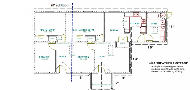

Maggie:
The Grandfather Cottage could be easily extended to the left hand side of the plan. This could add a couple of extra rooms and another bath if desired.
All I did here was copy a section of the existing plan and move it over about 20' but you get the idea. I expect you could find a better layout than this for the rooms. :D
None of the interior walls are load bearing. I think the scale of the GC will probably work better for an extension of this size than the 14' Builder's Cottage would. It has a more family sized kitchen, dining and bath/utility room.
As far as shipping costs for the plans, they are the same to CA or HI (via Priority mail).

John thank you so much for the preview! :)  I really hope I'll have no problems with getting a building permit with those plans. Hawaii is more lax than CA but not as lax as AK...

Let someone local help you with this permitting process. In many places you need the help and "heads up" from someone who knows the local particulars. See the "Taking your plans to the Building Dept." overview that comes with the plans.

Thanks again, John!! I wonder if the GC can be built for $10,000. I think the house itself might be possible...just not the plumbing, wiring, and interior cabinetry...thought??

I don't know lumber prices there, Maggie, but that is close to the cost some have listed on materials for a similar to larger shell.  Shop carefully and find bargains if possible

Maggie I doubt it (shell) can be done for less than $15k
