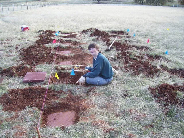

I like to draw and plan and work, but Dan has an uncanny facility with patience and attention to detail.  We have 21 pavers that need to be dead level and she can do it.  Quickly or slowly, it doesn’t matter make any difference to her.  Drew lift rock.  Dan make rock hold up lodge.
You can't quite see it, but Dan is holding this great leveling tool.  It has a three-pronged fork on one side ofthe head and a narrow hoe on the other.  She says it was perfect for chipping and leveling the soil.  She also made the footing holes wider and longer.  instead of 24"x24" for a 16"x16" paver she made them closer to 30"x30".  That gave her more room to move dirt out of the way and back in for leveling.
We only got one day of work in.  The rest of the weekend is 4H and all kinds of kid stuff.  If the weather holds out we plan to go up again 12/22-23 to finish the pavers and get as far toward building and placing the beams as we can.

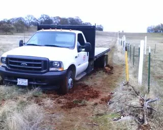

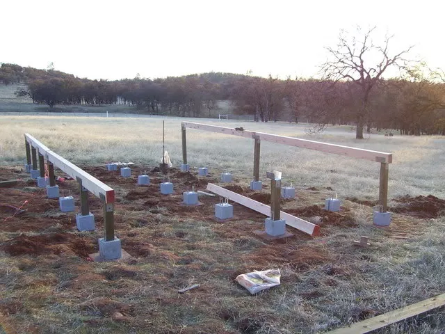

The building supply store brought in the beams, posts, and Simpson brackets.  While I took the Montero up and down the hill a couple of times,  the F-550 dualie got caught the first time.
They spent the rest of the day trying to pull that truck out of the mud.  I felt really bad about that, but Brian, the driver, took it in stride.  At least it wasn't raining.

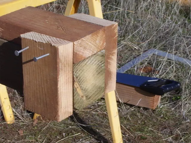

I don't have a chop saw and didn't want to make the post cuts with a circle saw (along with the attendant hauling of the generator), so I brought a nice miter box with us.  Unfortunately it got broken in the back of the Montero, so I had to get a replacement.  The replacement was a cheap plastic box with a dull saw.  The saw was also about 3 1/2" wide, so it wouldn't cut a 4"x4" in one cut.
Instead of another trip to HD (ugh), Dan made what she calls a "miter H" out of some 2"x4" and it worked like a charm all day.
We got all three beams up just before sunset at 4:45, but need to do a little more work on the middle one.  Here's a picture before we finished.  We were too busy to take pictures at the end.
I think it will take us another day to finish the leveling and the rest of the posts, them some work mixing and pouring concrete on the footings.  We'll probably hit the beams with some deck paint to protect them from the rain.  We don't get much, but it would make me feel better.
I would like to have done the floor before the ground got too muddy, but I think we were lucky to get as far as we did.  I can't ask my family to walk in all that lumber and I know the building supply store won't until late spring!

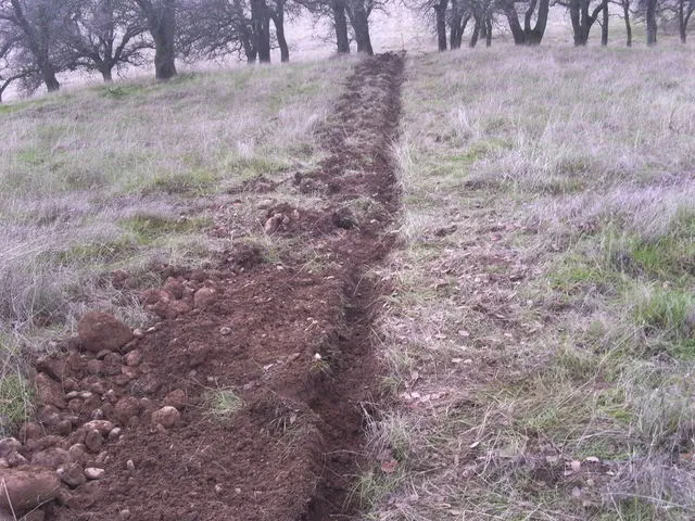

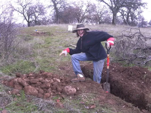

And what a mighty fine trench it is.  I chose this picture from 78 others, just for you.
Here's the hill after the stringing but before the trenching.
We got about 260' of the 750' started.  About 60% is at the proper depth and the otehr 40% needs more work.  The earth on the flat is a lot easier to work with, which makes sense since the soil would have been washed downhill over the years.
My dad, a former farm boy, marveled at our choice not to use a trencher.  I told him we a.) didn't want to have to get that thing back up the hill in the mud, b.) didn't want to wrestle a 920 pound machine for the first time in less than ideal circumstances, and c.) we actually like kicking our own butts now and then.  One thing is for sure.  We are getting a good idea of the different soil qualities all over the farm.
