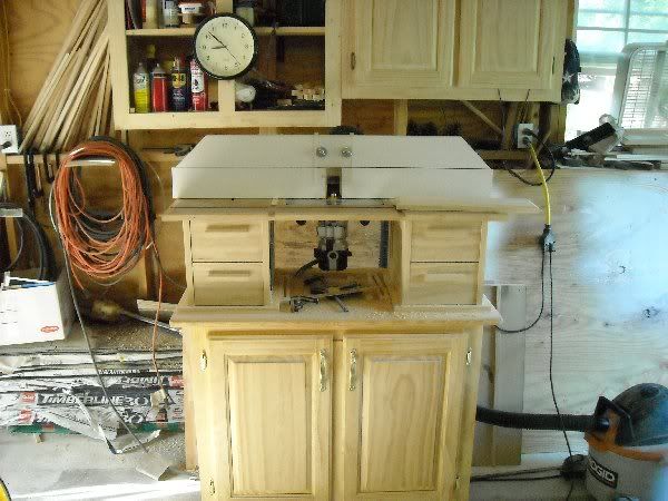

  Here is my attempt at a router table . . . I built it higher than a normal table so I don't have to bend over.  Top drawers hold various clamps and feather boards.  Behind lower doors are two drawers that hold various bits and the area on the bottom for jigs.
  I used Lexan for the router plate.  The fence is adjustable for the various widths of bits.  Vacuum port out of the back.  I didn't box in the router, though.  It is easier to adjust height.
  Clear pine for cabinet, mdf for table top, laminated pine for fence. . .

That's more than an attempt!  That's a nice looking table!!
Very nice. I made mine high too. It's actually a portable table that sits on top of a wheeled table that began life as a projection cart 25 years ago. Doesn't look as nice as yours though.
Bayviewps it appears that you do a good bit of woodworking. Do you have a shaper as well?  I used to use my router as a stationary but since I got the shaper the router is more of a portable tool now. But since I got going on the cabin I have gotten away from the shop tools for several years and went mostly with portables for the construction.

Pretty fancy router table!  Did you build it all?  Nice job!

   Yes, I did build it myself . . . :)
   Thanks for the compliment!
   I built this table using another smaller router table that I had previously built.  I would clamp it onto my workbench.  It would take up valuable workspace.  So, I built the larger one.
   I can remove the top portion of the router table.  It is the same height of my table saw.  It comes in handy when cutting large pieces, like, plywood on the table saw.
