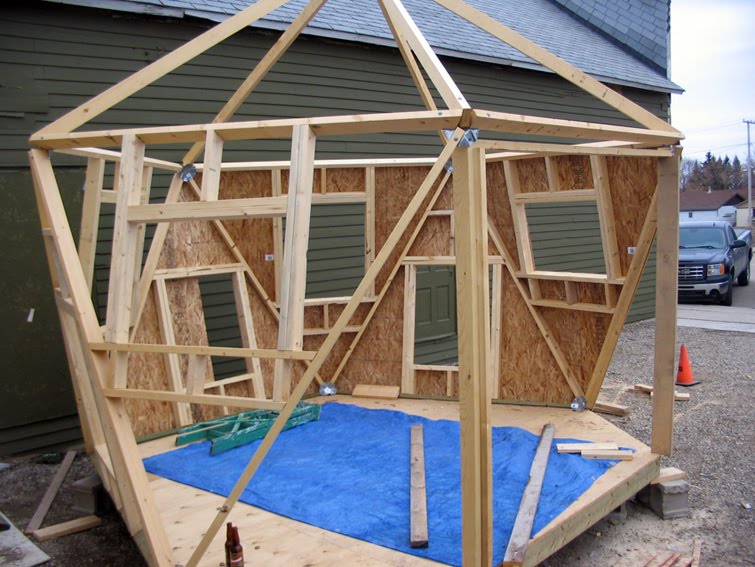

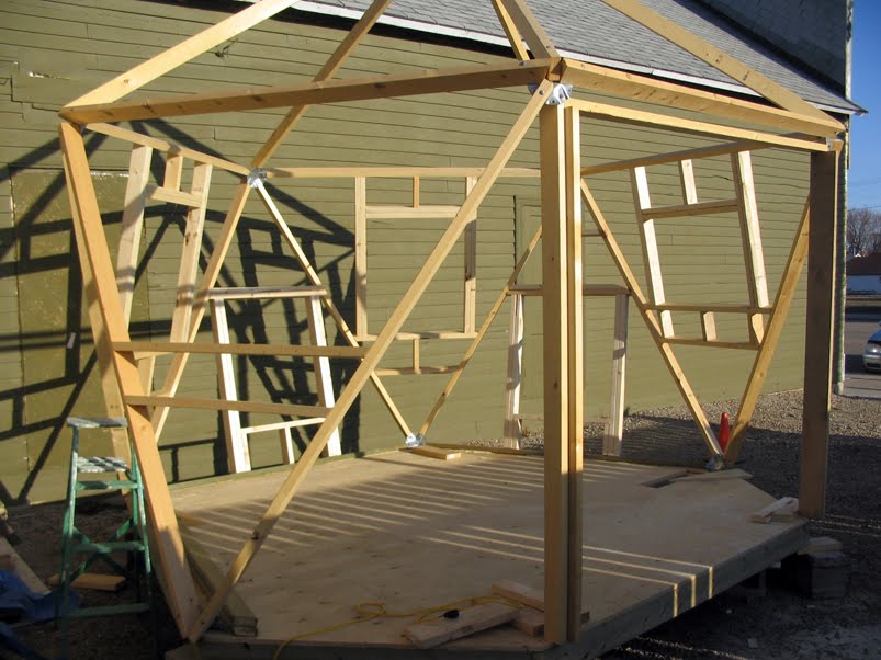

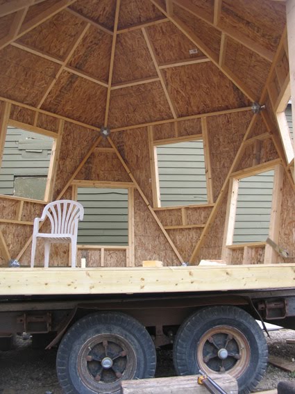

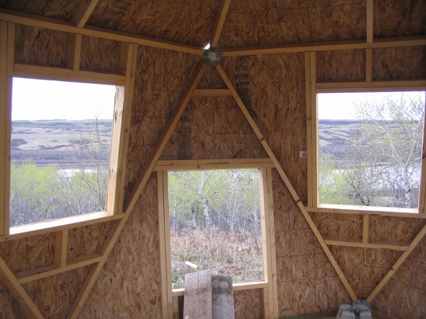

5 windows framed up.one more to go..i think the change in heights will make this part of the cabin really neat when its on site.
i am doing 4 sealed units and 2 sliders for air flow....

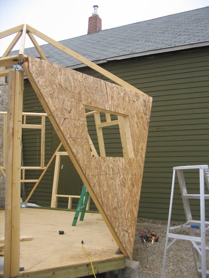

i started the walls....the very custom walls.....ha ha...
fishing_guy
Do those brown bottles(bottom left) help you visualize the angles in your head?
Cool looking project!
A bad day of fishing beats a good day at work any day, but building something with your own hands beats anything.
Kris
with a project like this, i need all the help i can get...ha ha

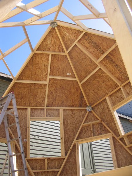

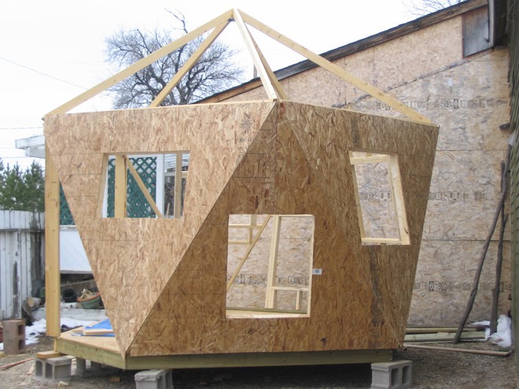

ended up doing 7 windows...5 sealed and 2 sliders..{rough cuts until on location}...

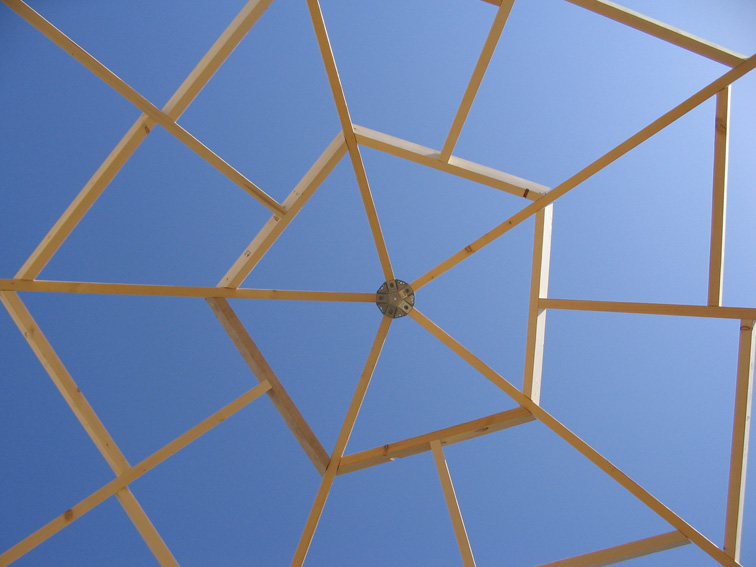

i put the roof struts and braces in today,,,and tomorrow i will start on the roof....
Ebony, my building inspector....
Jeff922
Sooo cool!  Looks like a sculpture.  I'm curious, are you figuring out all fo those funky angles mathmatically, with computer software, or just on-the-fly construction style?  Can't wait to see more.
"They don't grow trees so close together that you can't ski between them"
Kris
my calculator and i have tried to figure out some angles,,,otherwise i just kinda figure it out on site..trial and error....the parallel struts are all based on about the same measurement..the hardest part is setting 2 angles up  for a single cut and then making sure the board's next cut is done properly..or you get 2 nice cuts but one is opposite of how it should be,....the harderst of all the angles have been figuring out a strut from the parallel wall struts to the first level of the roof board..{the boards that run along the windows}....

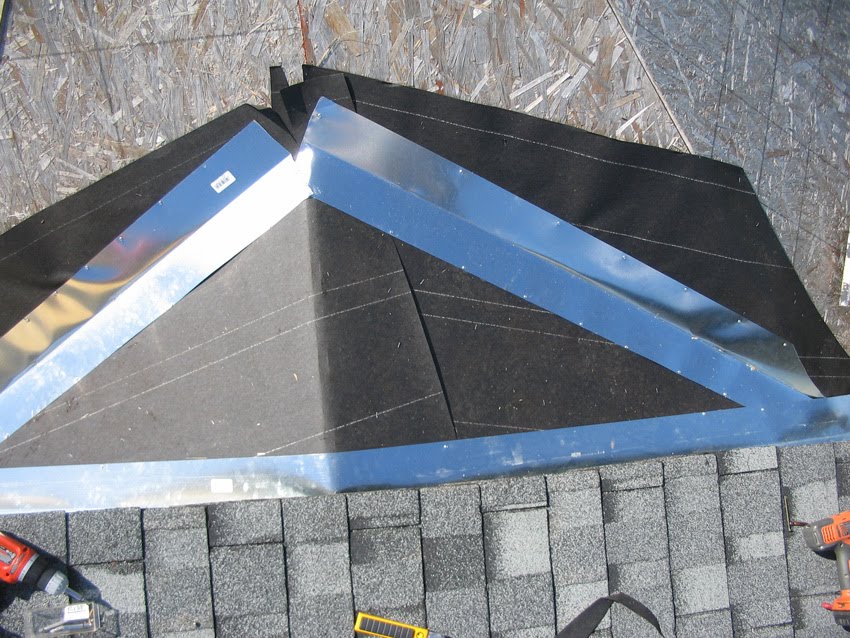

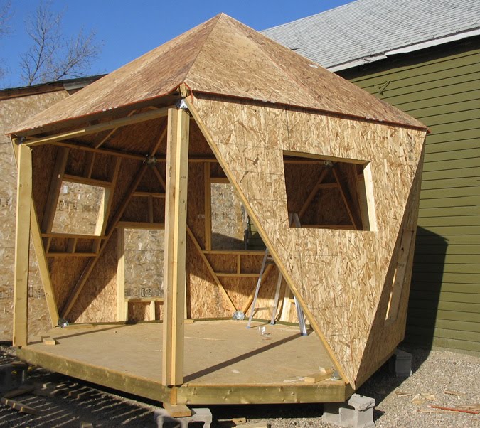

well......today is roof day...time to get to work.......
Kris
well....it was a very hot day..keep in mind that there was ice on the project 2 days ago.....
anyways...i got the roof on today,,,it was tricky in some spots but over all it went smooth..the bottom overhang will need to be adjusted a little, but i am happy with the progress.....
thanks to my dad for lending a hand..roofing alone would not go so smooth......

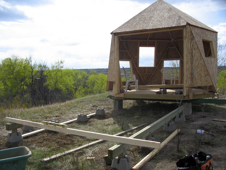

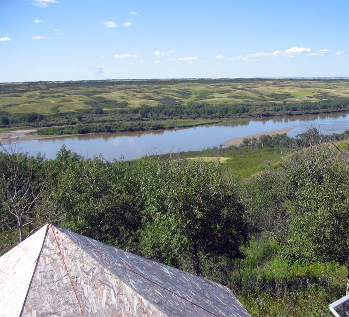

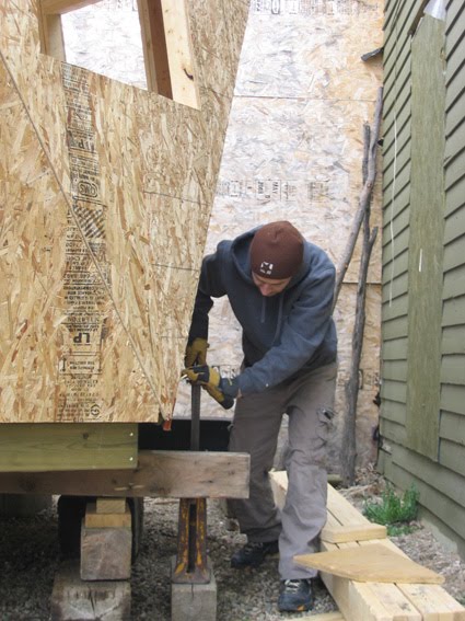

the icosa moved to its new home,,,,,...here are some pictures...
Kris
speedfunk
awesome!  that is all  ;D
Kris
well...thanks for that..there is more to come,,,i now need to join it somehow to part 2... i am thinking of building something kinda like the "manshed", of which is posted in the forum..the join is kinda odd  since the icosa has a 8ft square opening and the attachment will be a 12 x 14 {plus roof differences}.....hmmmm.. something for me to ponder..

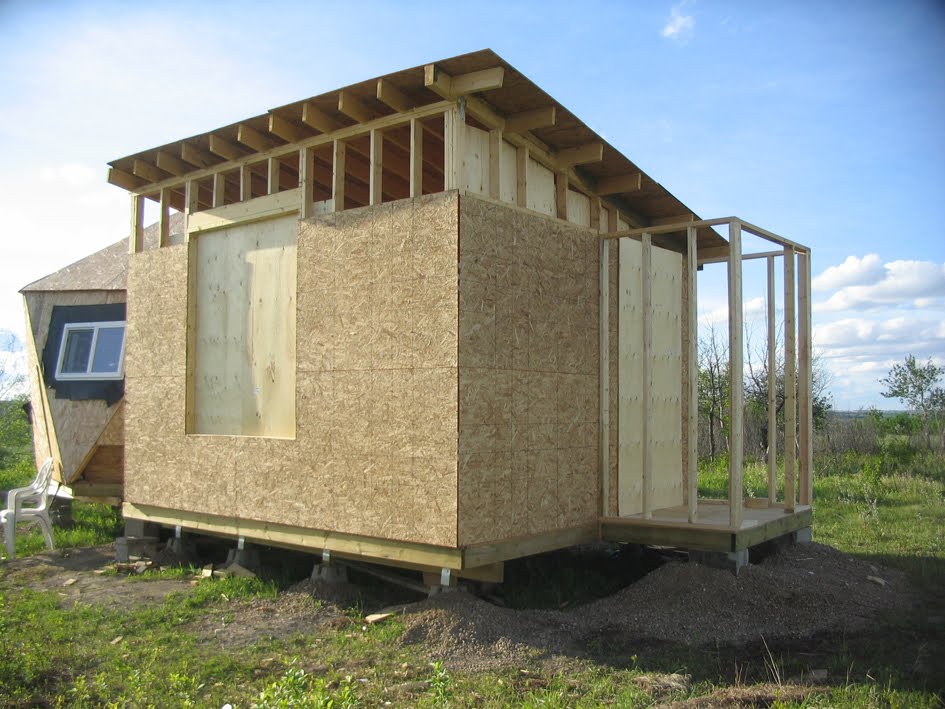

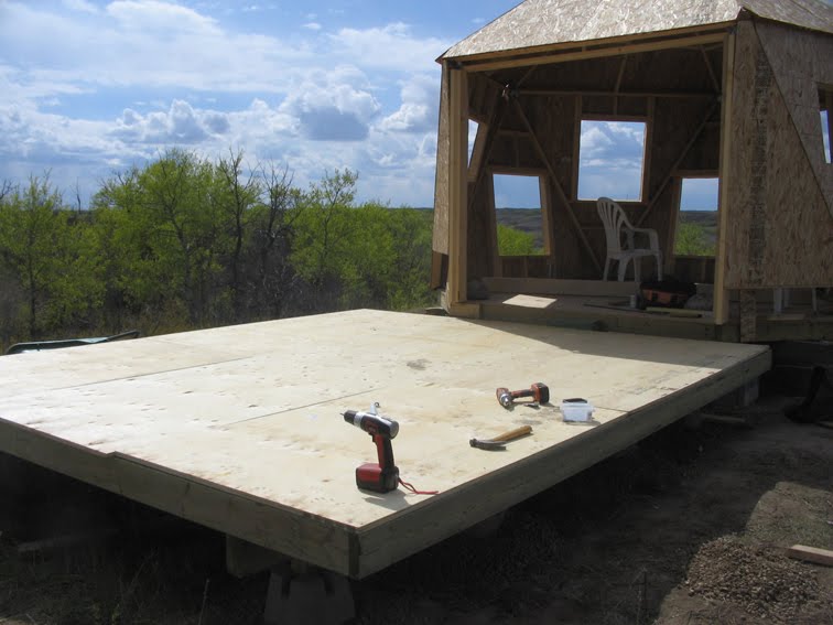

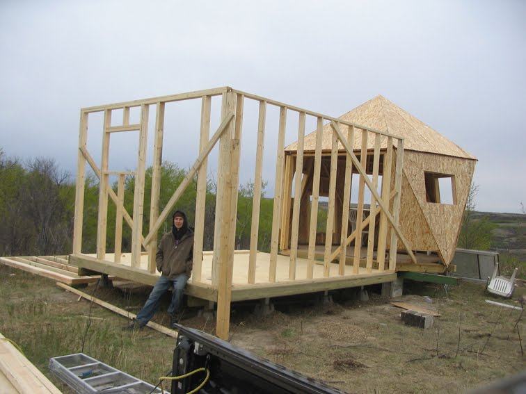

 start of part 2 of the project....12 x 14 ,
lots of work but she is coming along........
i think i read on here somewhere that it always rains when it is time to sheet your floor..well instead off rain i got hail.....and then the sun came out.........
Kris
well..its been a sunny week..i have been camping over and working hard...
the rafters are mostly all on..kind of a birds-mouth thing happening on both sides..and then fastened with those h1 simpson brackets.  next on the list is to add a rafter extension{overhang on the east} and then connect the roof to the icosa.......and then go fishing..ha ha

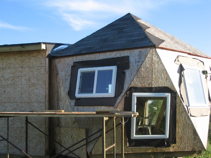

ive been away for a month, so she has been sitting and waiting for her tin roof to go on..,,,....and getting the rest of the windows in....,,,,slowly but surely.....
Kris

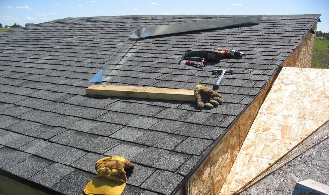

i got the roof joined to the icosa and i went with shingles this time around instead of tin...
