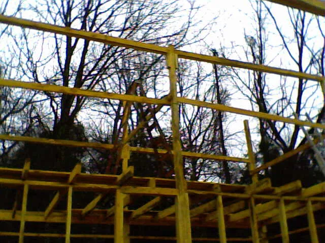

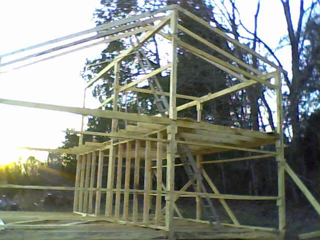

NIGHTOWL
My try at posting pictures!
NIGHTOWL ;)

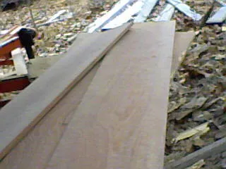

NIGHTOWL
That log sawed some good lumber,here is a little of it.
NIGHTOWL ;)

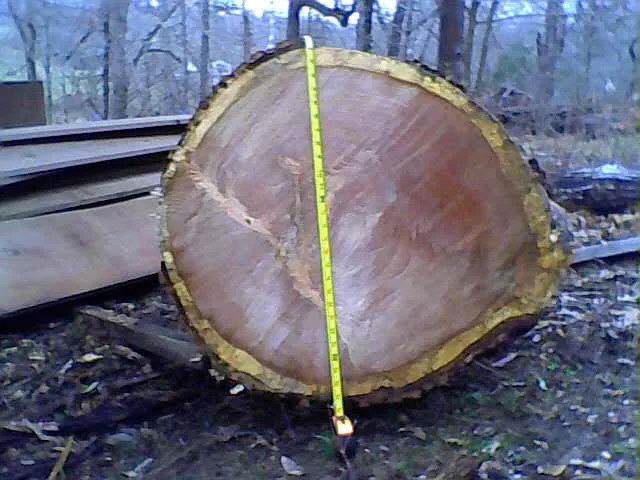

NIGHTOWL
This is the first pictures of my attempt to build a low cost cabin out of trees that were damaged from
the 2009 ice storm on my farm.
NIGHTOWL ;)

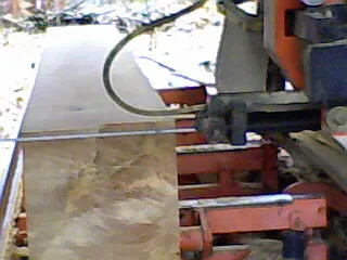

NIGHTOWL
Getting it squared to a 12 x ,this will be my siding  of board and batten.
NIGHTOWL ;)
That is a cherry looking log Nightowl, quite a building.
John, that's my shop. still a work in progress. I wrapped the sidewall girts outside the posts and in that middle bay I doubled the 4x7 girt inside between the posts. The X's are a double layer of 4x5's lapped and infilled. I did that on each side wall, made for a pretty rigid panel. Old German frames are full of X's and diagonal braces, its a nice look as well as being quite stout. I could prefab you a frame  ;D
