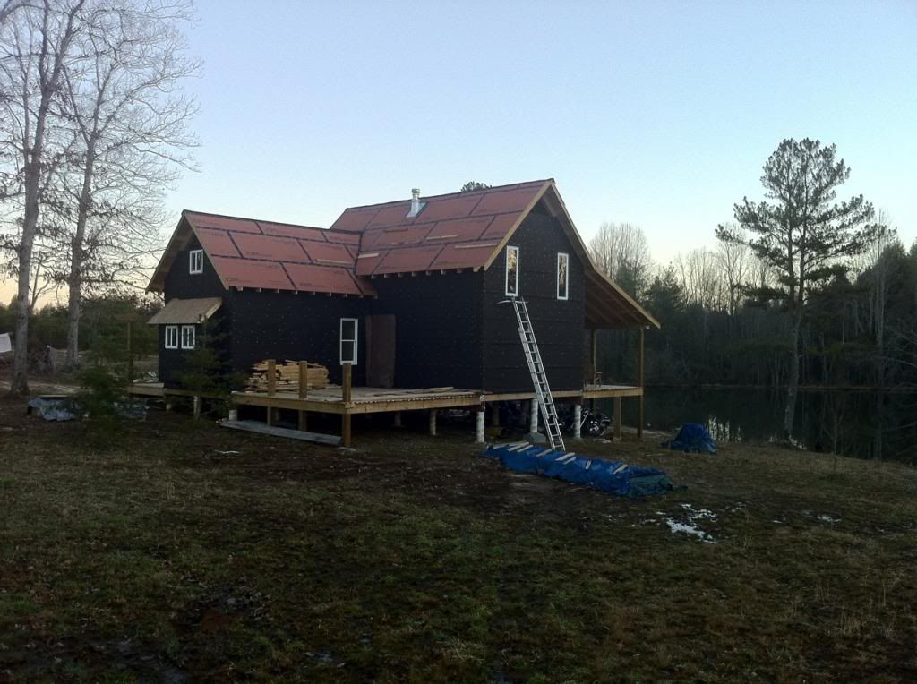

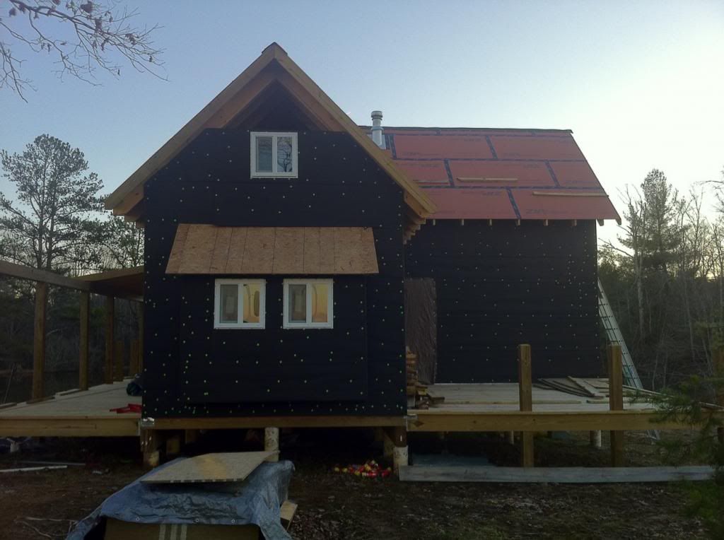

We made some more progress this week. Got the felt on the East gable end, finished up sheathing the roof, installed the Zip tape and layed a strip of felt paper (temporary until the metal goes on) over the roof peak where it vents. I worked all day yesterday taping seams and got it done right before the rain started. I have a couple drips on a few nail holes that i'll have to seal up (was warned by Rich2Vermont that this might happen) and have a leak where the main roof funnels water around the bedroom peak because i didn't tape the felt on the peak on that corner. Once those couple issues are taken care of I should be nice and dry!
tried to tape as much as I could reach by sitting on the peaks.
loft support beams staged on the deck. will start hanging them after Christmas.

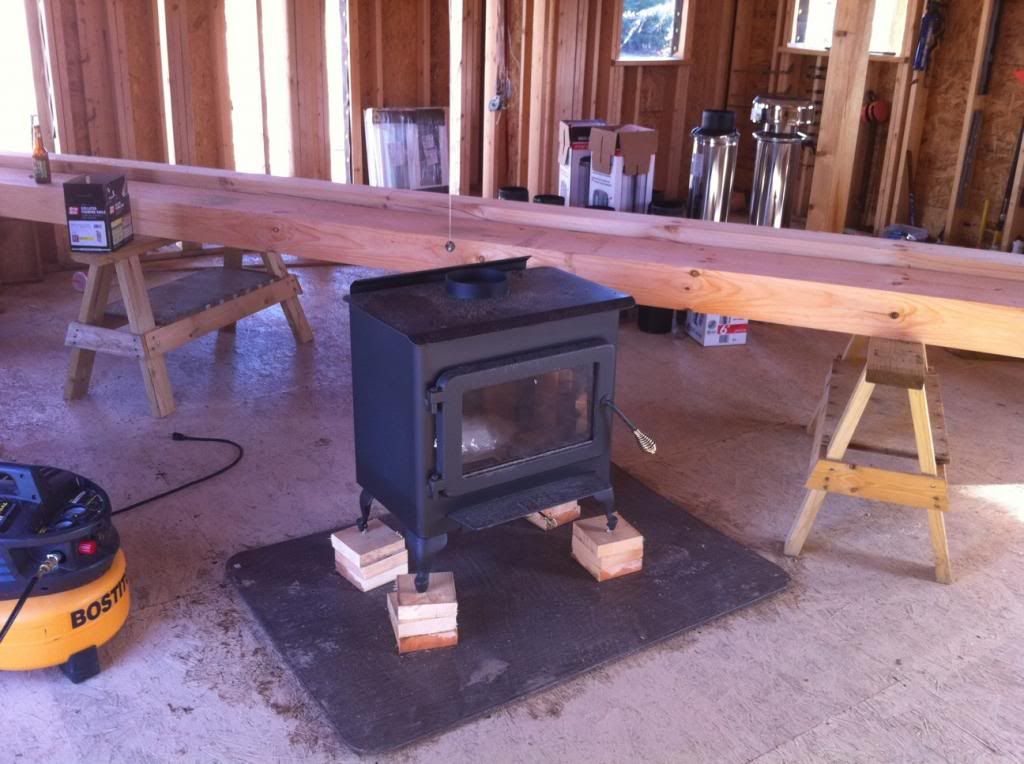

We'll be using an Englander 17NC model wood stove for heat.

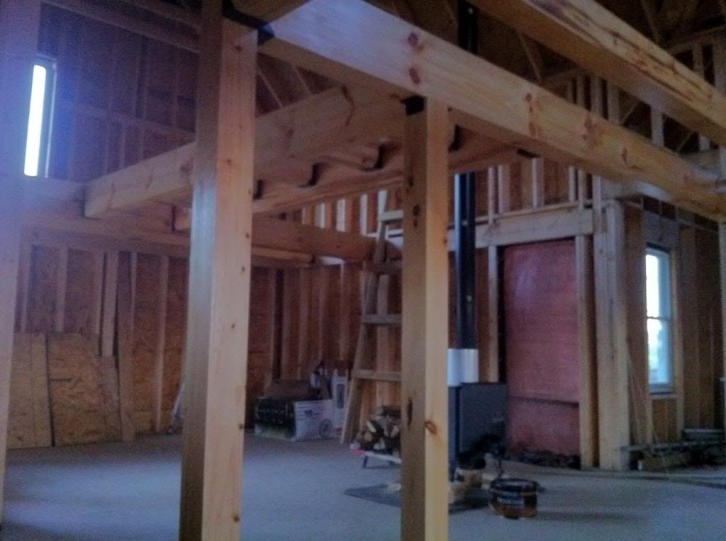

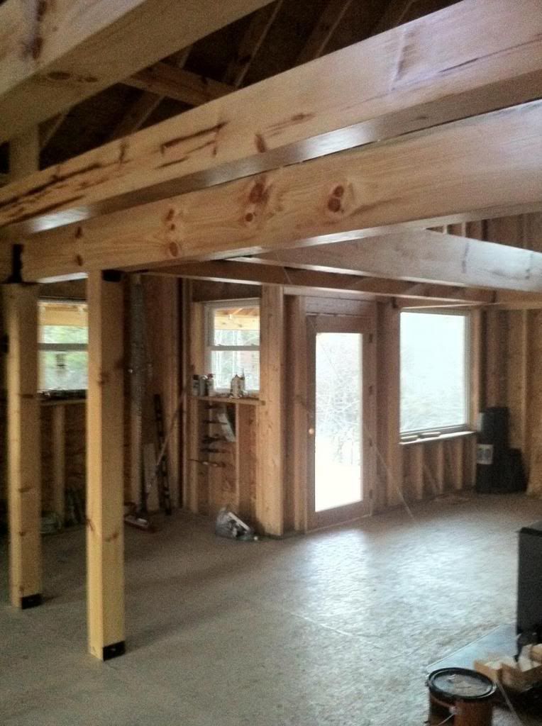

Well the holidays went well and we've been working for a couple weeks getting the house sealed up so it would hold some heat from the wood stove. Since my last posting we've:
installed the wood stove
Installed the windows and 2 of the 4 doors
Polyuerethaned the interior beams and hung them
built a set of stairs and a deck landing with septic tank access hatches.

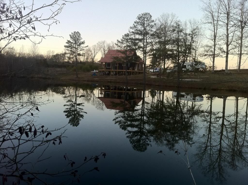

East side of house
North side. The chimney is installed but i'll be raising it an additional 2 feet once the metal roof goes on.
North and west sides
South side. Nice view from the 57 inch picture window!

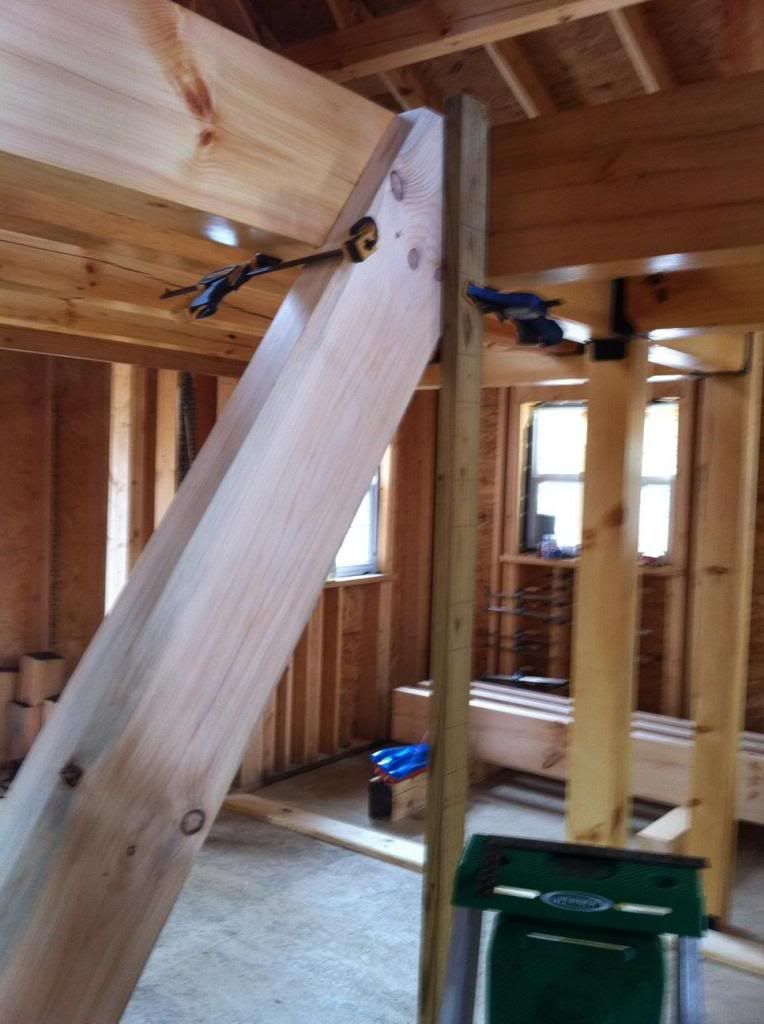

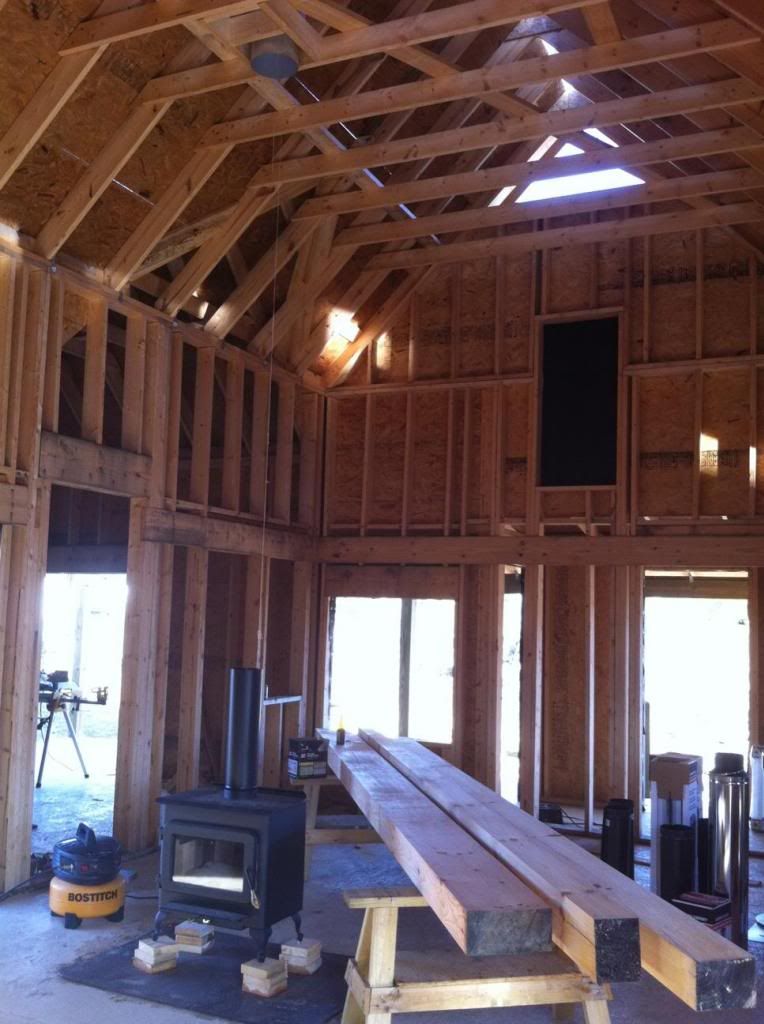

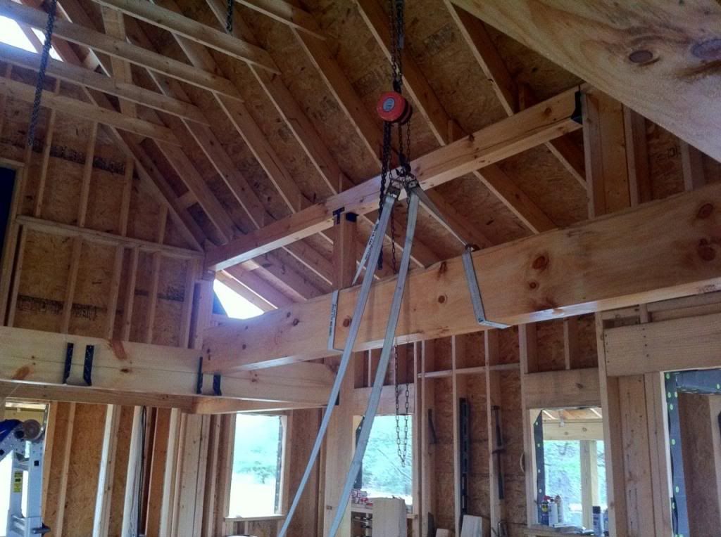

We used a block and tackle and a chain suspended from the collar ties to raise each beam into place. 2 coats of polyurethane on each one. The hardware is primed and painted with semi gloss black.
6x12s and 6x8s

Thanks for the interest Nathan i'm trying to document things as best as I can. Here's a couple pics of the setup that we used to raise our beams.
this system simplified the lifting process and once the straps were balanced along the center of gravity of the beam we were easily able to lift them into place.

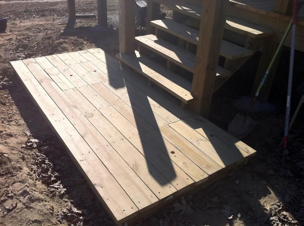

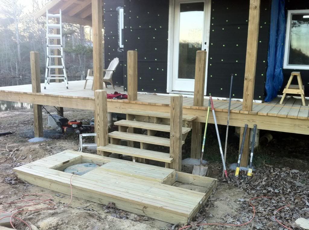

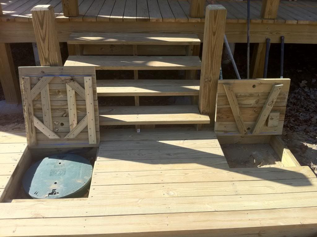

Today I finished the stairs and stair platform and built the 2 flush mounted access hatches for the septic tank openings.
I used a 1 1/8" bit for finger hole pulls on the hatches.
The hatches are propped up to show how they were constructed. They aren't connected with any type of hinge, they just lift off the platform.

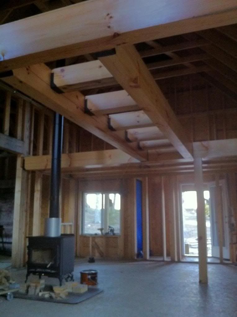

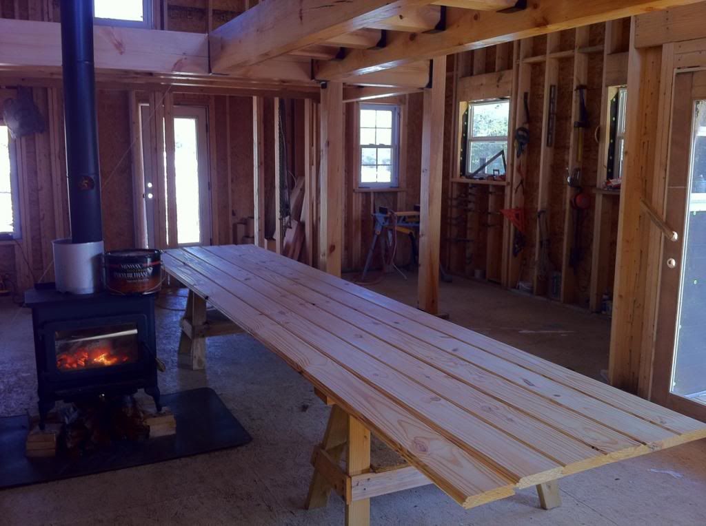

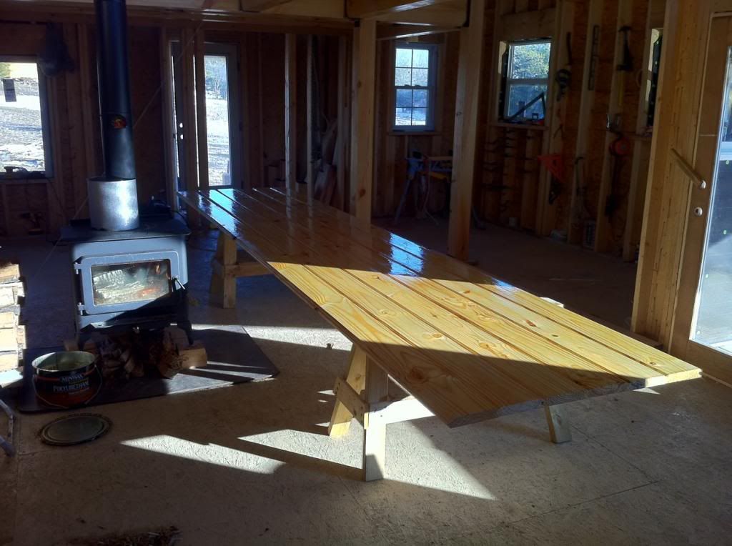

I've started working on my loft floor. I'm using 2x8 white pine V-match tongue and groove stock with Semigloss polyurethane on the bottom portion (ceiling) and a finish yet to be determined for the top (loft floor)
Prior to the polyurethane
After the poly
The wood stove is keeping the place at about 55ish degrees with the outside temp in the low 20's. No insulation yet and LOTS of gaps still in each window and door frame.

John, I pondered drilling pilot holes in the tongue of my 2X stock and nailing them in place with spiral nails but after some review and discussion via Private messages I am leaning toward screws so I can use the screw to pull the tongue into the groove completely. Prior to fastening the floor I'll be routing channels and laying wire into the top of the beams for electrical fixtures that I'll later hang from the bottom of the tongue and groove. I appreciate your shared experience and insights via PM. You've probably saved me quite a bit of time and given me info to produce a better project overall. Thanks.

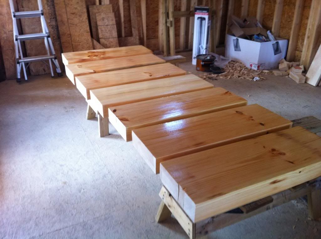

Polyurethane! Polyurethane! Polyurethane!
The picture below represents 6 days of work with 3 coats on each board. They dried sloooow with the temps mostly in the high 20's to low 30's. I think it was Mountainlady that mentioned how tedious this part was....boy was she right, but a wise man once told me that "slow and steady wins the race". If that statement is true then I'm surely gonna win!  d*

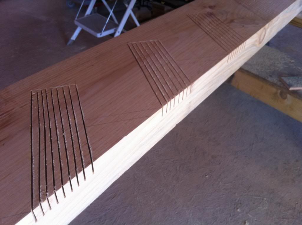

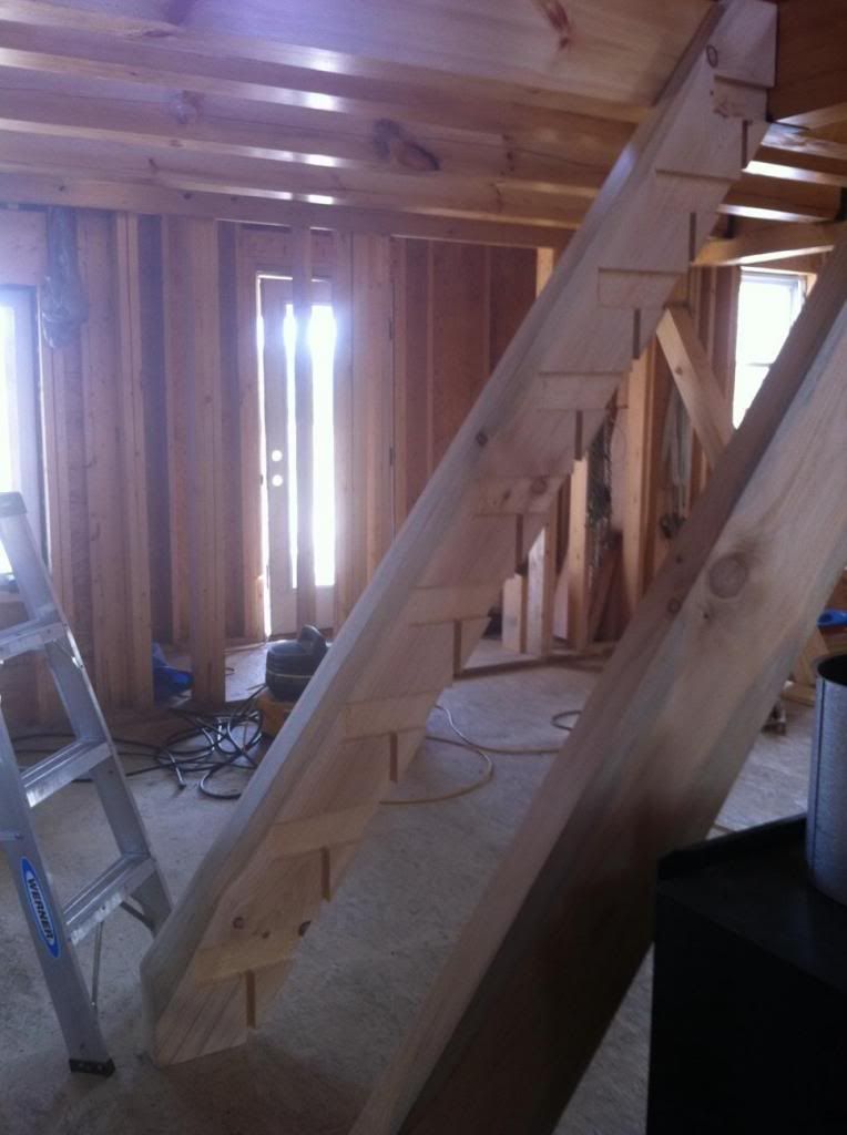

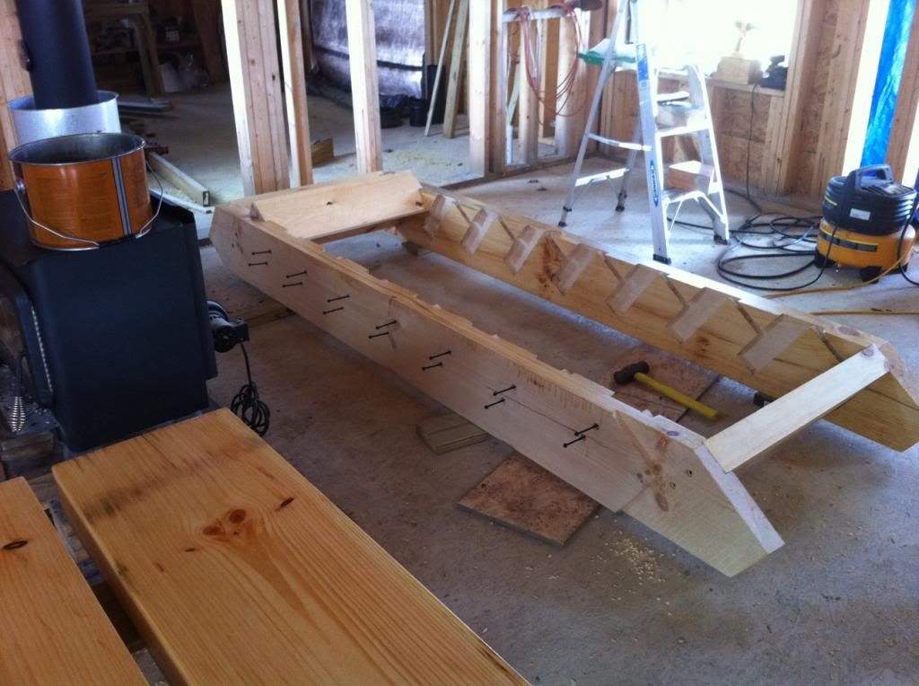

Took almost two weeks to get to a finished point on the stairs but it's been a really fun project. All in all I have about $325 in lumber, hardware and polyurethane and 45 hours into these stairs. They are steep at 54 degrees but very functional. 9 treads and 10 steps with a 9 7/16" rise and a 6 1/2" run. I ended up using the entire 4x12 for each step which gives 4 3/4" overhang. Here's how I built them:

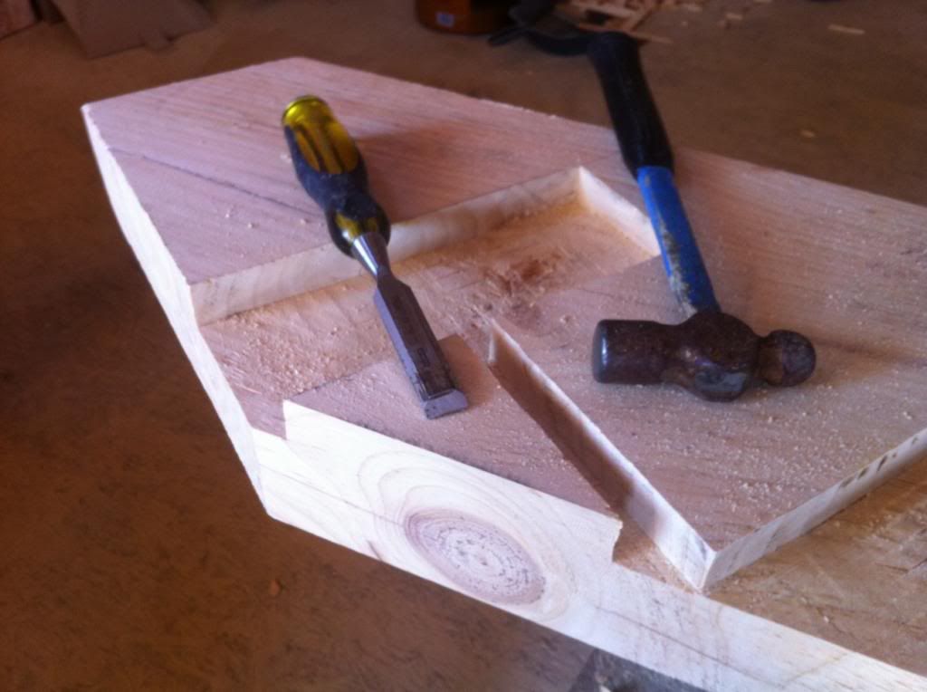

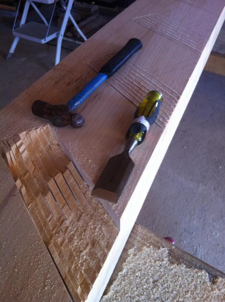

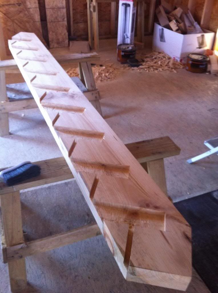

I first cut each runner, set them in place and used a 2x4 as a storypole to help lay out the treads and risers.
I used a level and carpenter square to mark where i'd later chisel the tread and riser notches.

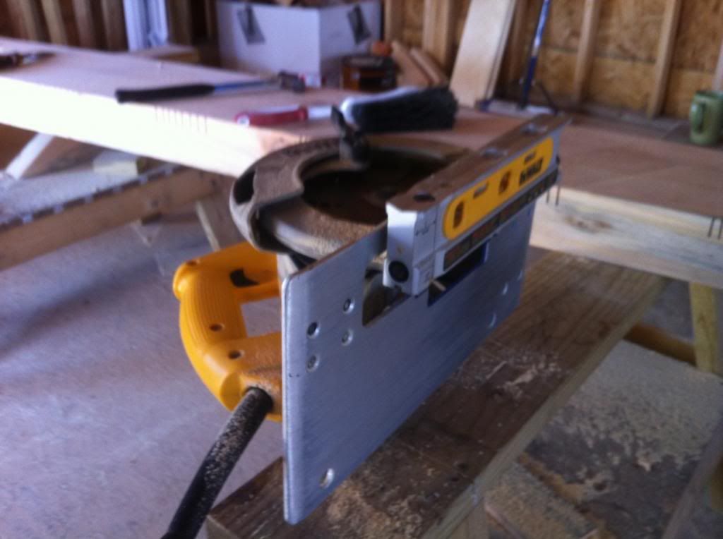

I used my level that is exactly 1" thick to set my skill saw depth.
I CAREFULLY ran my skillsaw up the layout lines and then at every 1/4".
Used a 1 1/2" inch chisel to remove the notched out material.
I used the same 1" thick level to check the notch depth that I used to set my saw with.
used a 3/4 inch chisel for my riser notches to accommodate the 1x10 risers.
these notches were quite tasking. over a day on each runner.
it was worth the work though. They turned out real nice.

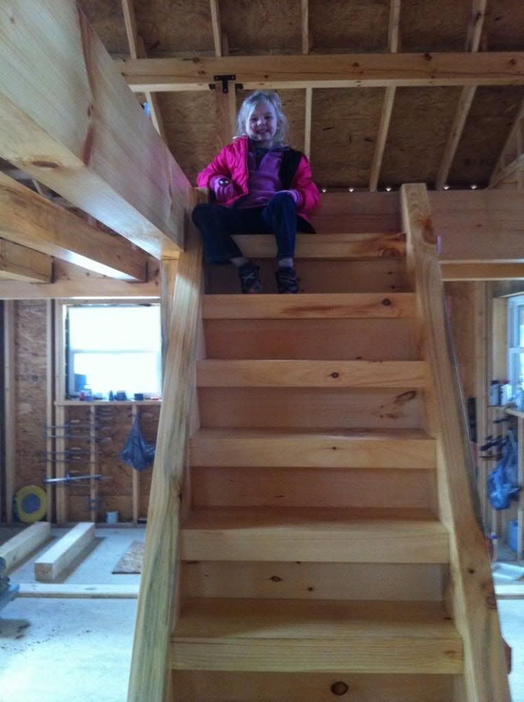

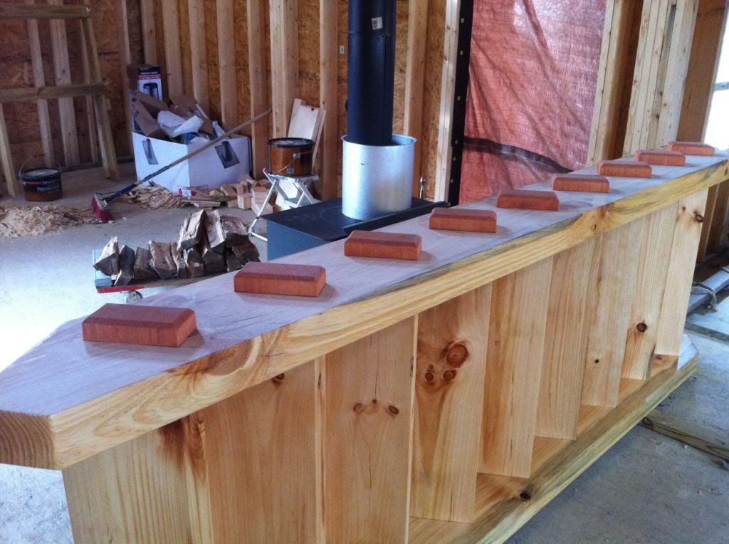

then the polyurethane work started, 3 coats. Luckily I had help on this part.....it may have taken a bit longer with my helper but she's a lot of fun :D
stair treads are exactly 32" wide giving 30 inches of usable tread with the 1" notches.
I drilled a 1/2" countersunk hole and used 2 - 4" timberlok screws on each side of each tread.
all assembled and stood up for the screw cover accent pieces to be glued into place and a final coat of polyurethane.
screw covers glued in place.

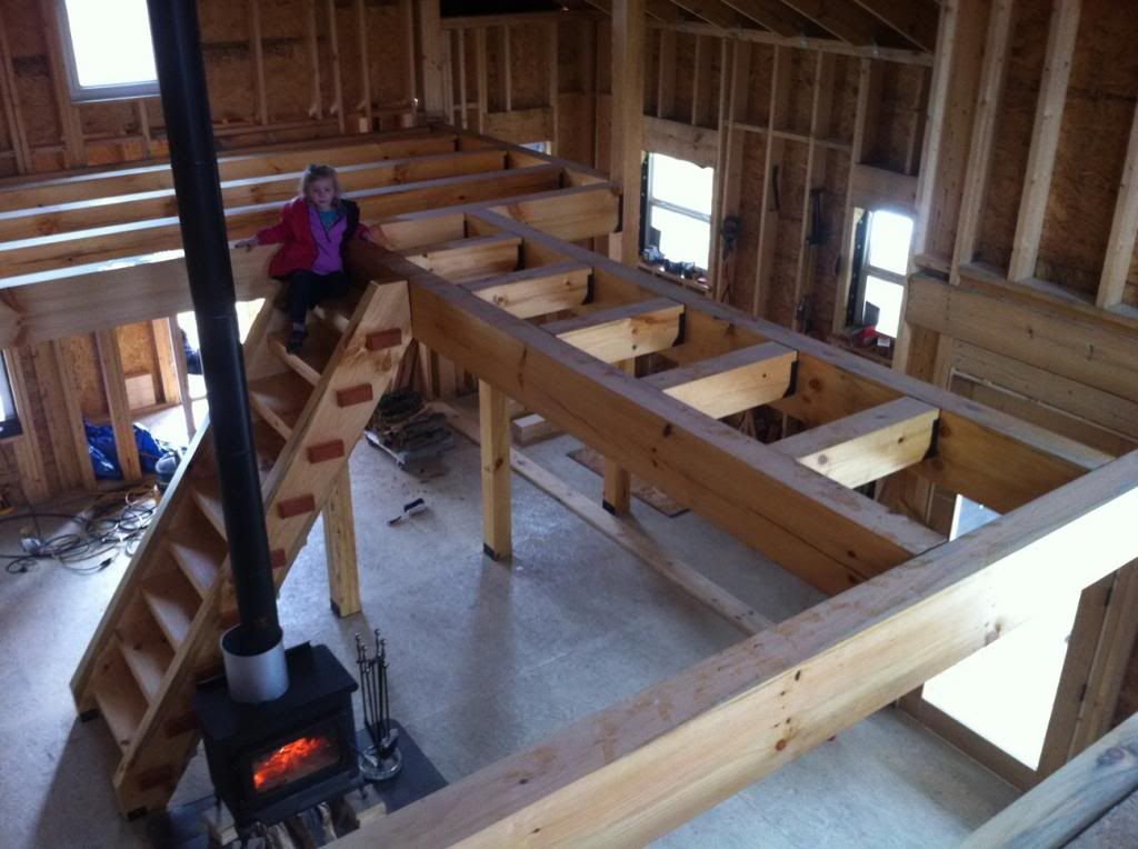

Up and secured. This pic is taken while standing on the loft beams on the west side of the house.
A happy helper!

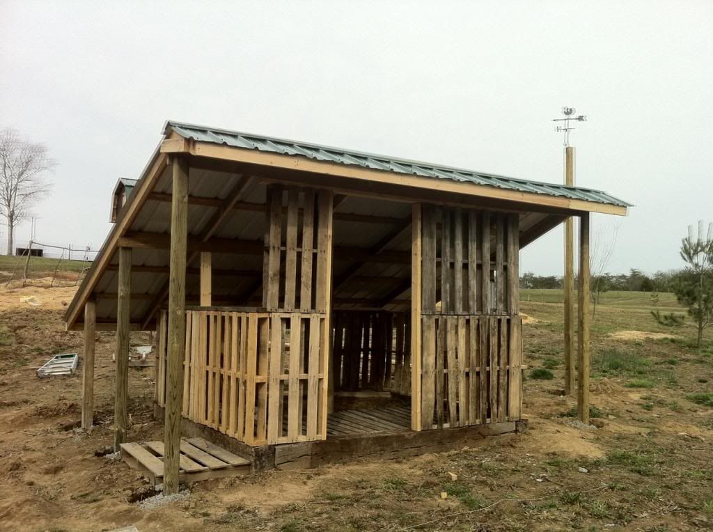

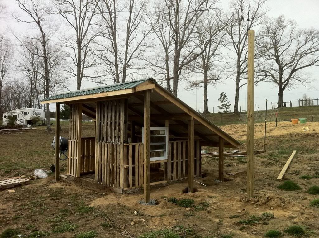

Anyway, this site is about building so one of the projects that i'll share (also in my garden area) is an 8X9 chicken coop (framing pictured above). I used railroad ties as a foundation and pallets for the wall framing, which are surprisingly strong. The roof overhangs 3 feet on the sides and about 2 feet in the back for the chickens to always have a shady place to escape to. I'll be using some poultry netting that is 24x24 to use as the top of the chicken run (more to follow on that one). Here's a couple pics of the almost finished coop:

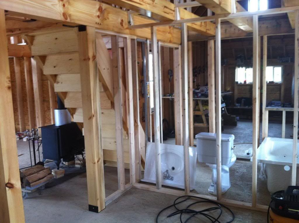

OK so back to the house, I've made some progress on the interior wall framing and dry fitted the bathroom for plumbing measurments.

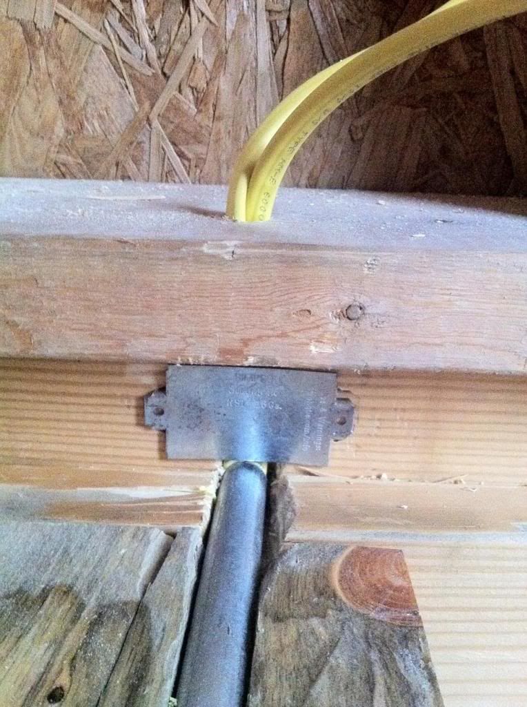

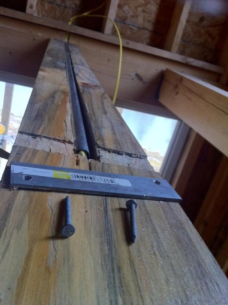

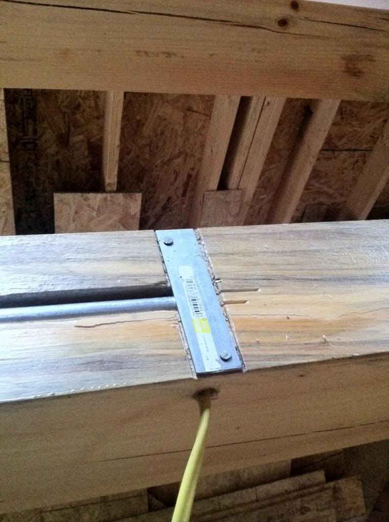

I also figured out (after lots of pondering, and some very helpful advice from Redoverfarm) how I was going to run wiring through my beams to meet local electrical code prior to my loft flooring going in. Here's a pictorial:

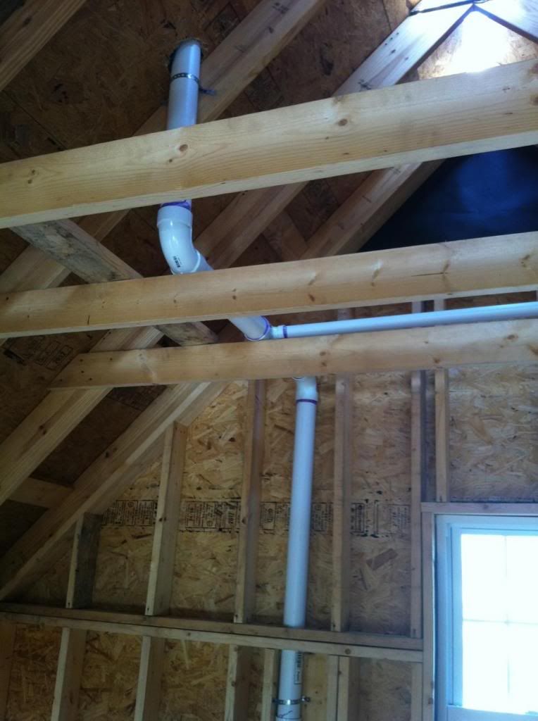

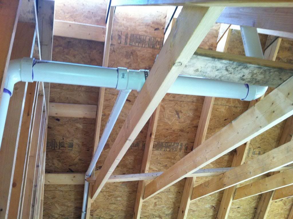

In preparation for the metal roofing I had to plan my plumbing vent system so I could figure out where the roof flashing would be located. I used 3 inch PVC for my main vents.

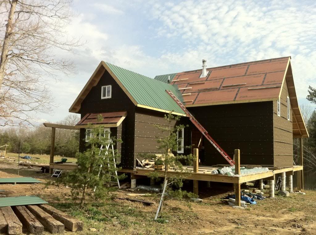

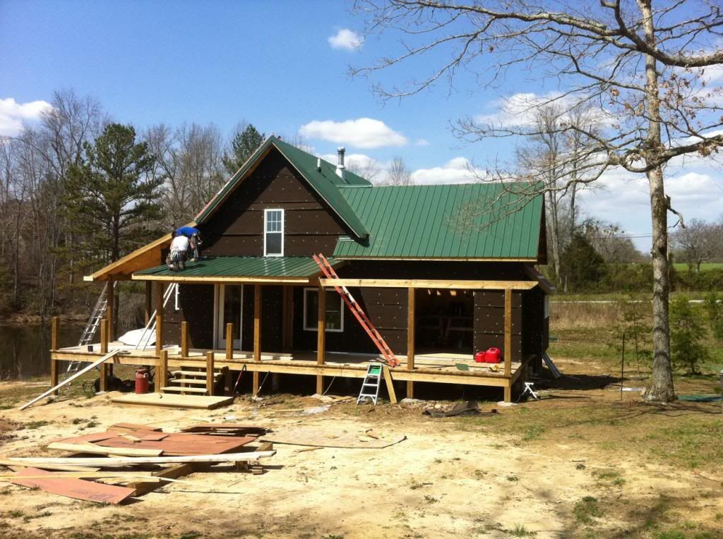

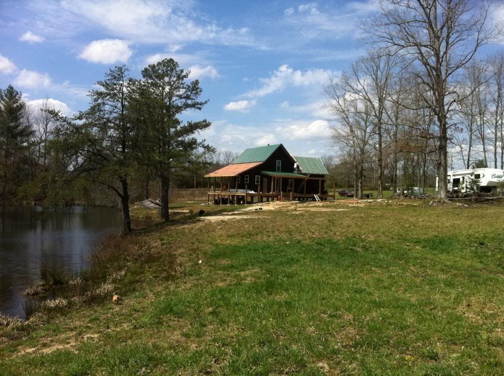

And speaking of the roof, here it is:
The OSB that I used as the subroof for my end bedroom bumpout was replaced by the better zip roofing. Partially because it's a better product and partially because the winter that it spent without the benefit of tar paper cover left it weathered and deteriorating.
The roof is the only area of the build that I've used hired help. The cost using help was $3100. it would've been $6250 if I decided to contract the entire job out.
I was short by 2 sections of ridge cap so we had to call it quits until my ridge caps come in. Very happy with the color (Hunter green)
